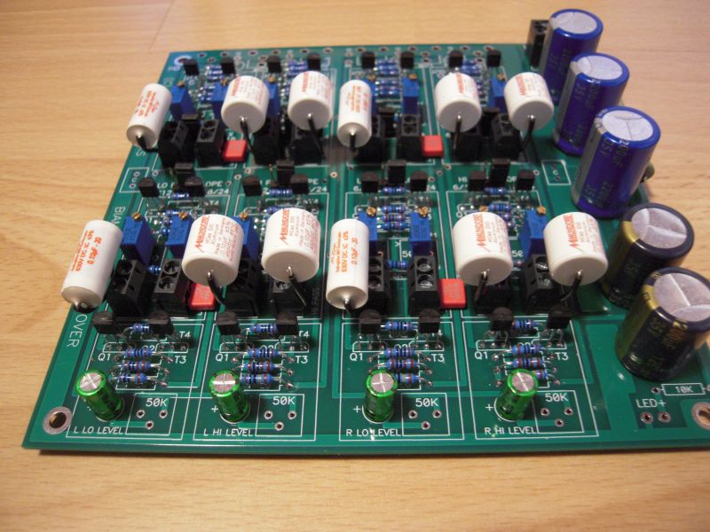

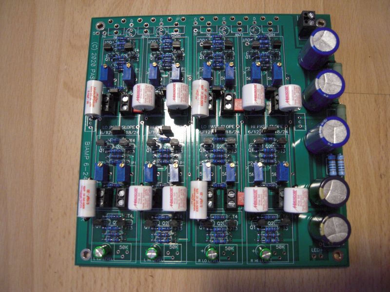

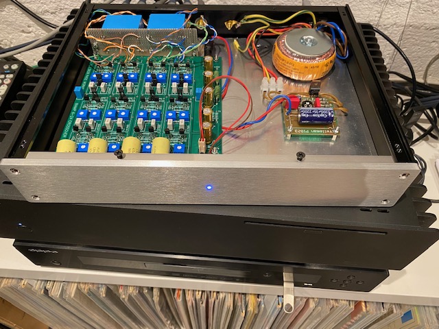

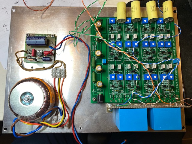

6-24XO experience - part2
Hello, out there!
Yes, I did it again! 🙄
My second 6-24XO build. This time for use between main speakers and subwoofer (crossover frequency around 80 - 100 Hz).
I will also try to to make the two sub-channels bridgeable to 'mono' with an
output-transformer. I have an EDCOR XS1100 (quadfilar). We will see.... 😕
I like this active crossover!
Greets
Dirk
Hello, out there!
Greets
Dirk

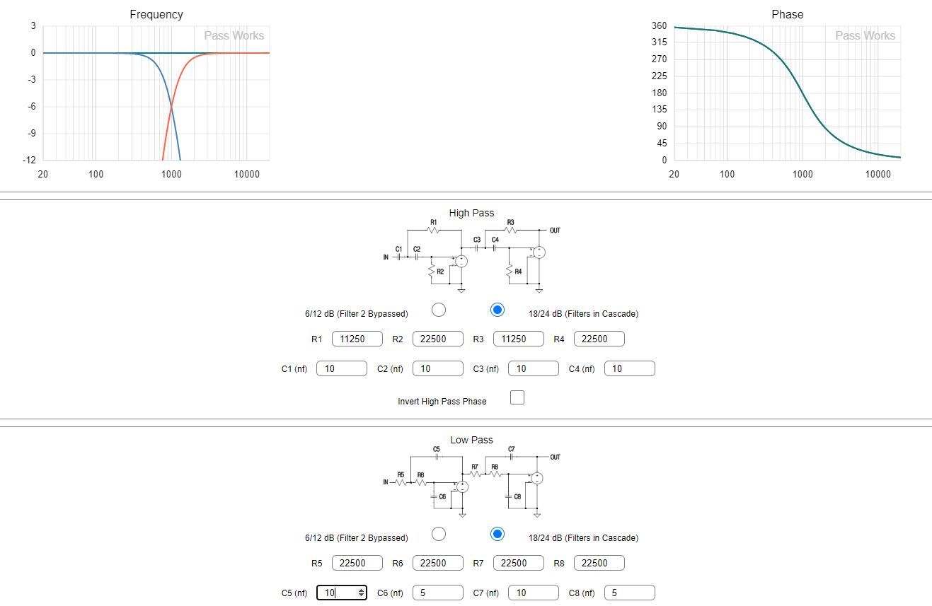

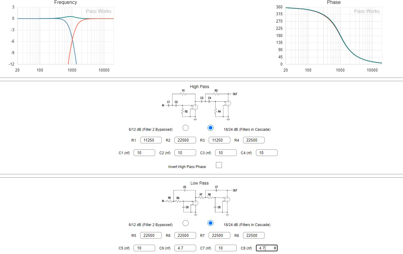

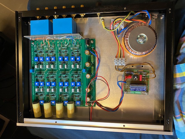

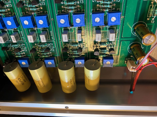

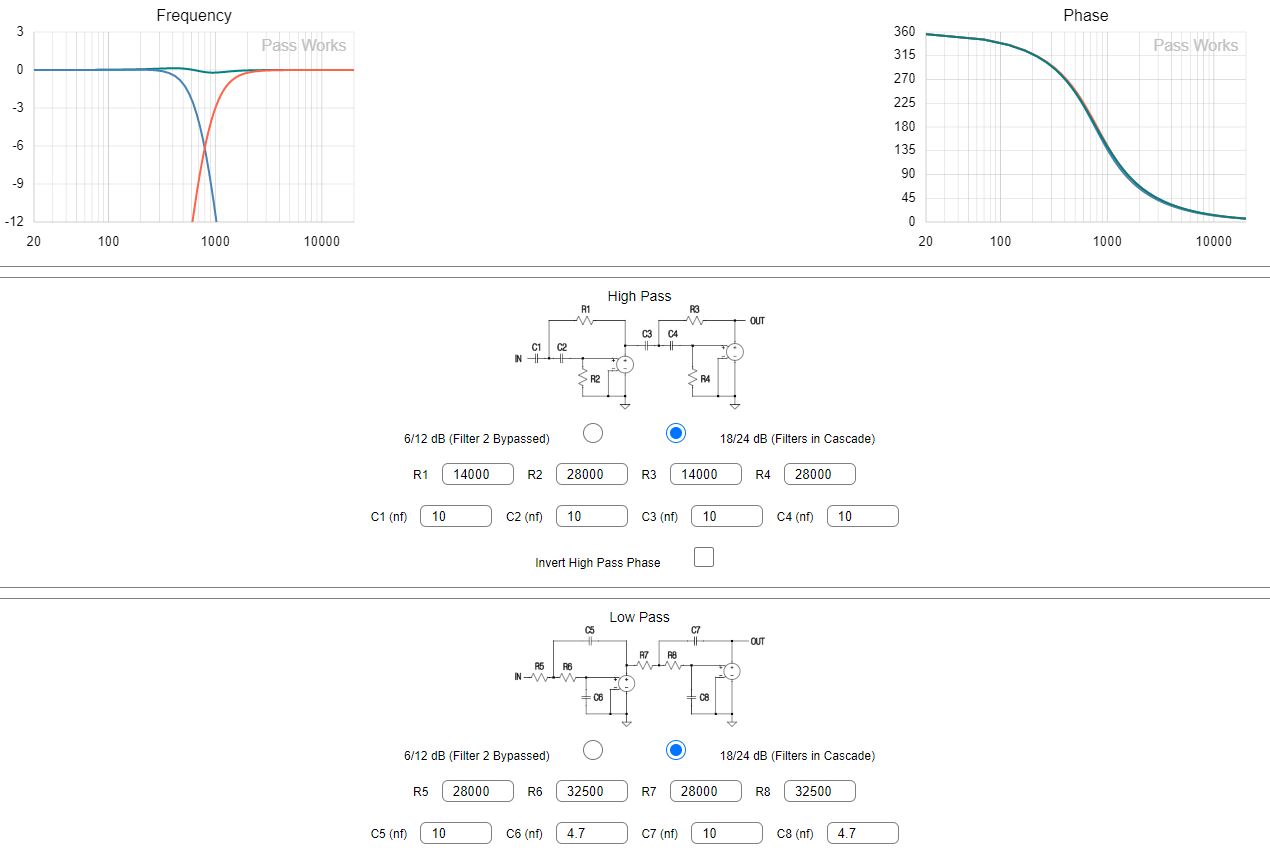

24 db for ESl-2905 and SB-2000
It took some time to "finish before adjustment", but now the crossover is playing. It has been conceived to cross between Quad ESl-2905 and SVS SB-2000 subwoofers, two of both.
Michael (Rothacher) has provided this wonderful XO calculator for us to use. Standard is 1 kHz crossover with values of 5 nF and 10 nF for the capacitors, and 11250 and 22500 Ohms for the resistors. By scaling the capacitors to 50 nF and 100 nF respectively, one get 100 Hz crossover. I purchased 47 nF instead of 50 nF, and the summed frequency response shown in the calculator is not flat anymore. I wanted 80 Hz so I adjusted the resistances, and then some to some degree flatten the response somewhat. Shown in an attachment. (I will probably change from 47 nF to 50 nF in the future to get it "correct".) I subtracted 10 kOhms from the numbers and wrote down. I did first a course adjusment of the trimmers, turned the PCB and measured for the correct value (minus 10k) and then fine tuned the values to approximately what I wanted (what I calculated).
The next step will be to adjust the level of the bass system relative the electrostatics. The subwoofers are located somewhat behind the Quads, however the Quads simulate å point source located some 12 inches behind the diaphragm so I guess it is good enough for rock'n'roll (and all other genres as well).
To the rest of the implementation.

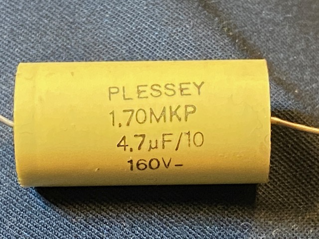

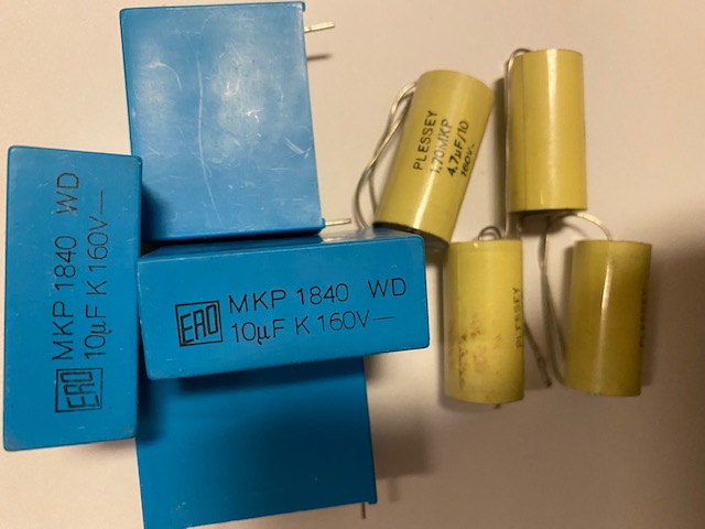

I used a 30VA 2x12V transformer Nuvotem Talema 0030P1-2-012 (RS Components 2237822) and the Velleman K1823 kit power supply (LM317). I changed the rectifiers to soft recovery types. It might deserve some capacitive multiplier between the K1823 and the filter PCB. I have real estate for a more advanced regulator.

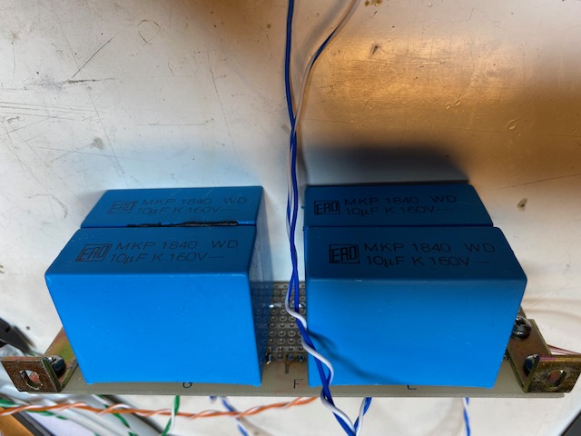

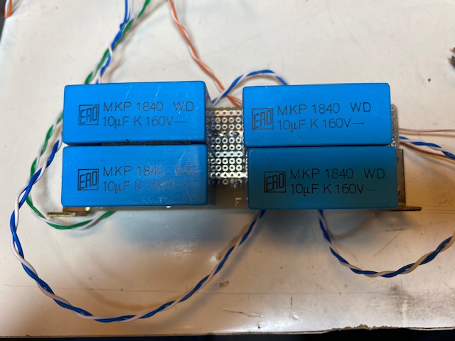

I decided I wanted film coupling capacitors, so I dug out some 10 uF ERO and some 4.7 uF Plesseys. 4.7 at the inputs and 10 uF on the outputs. Wire with zero distortion wires from CAT6 cabling.
. The 10 uF blocks are placed on a experimental PCB with brackets found in an old collection of things.
The enclosure is from eBay - large enough and nice enough. I located all the PCBs, transformers etc on an internal aluminum plate to avoid drilling in the bottom plate. (Except for the four feet.)

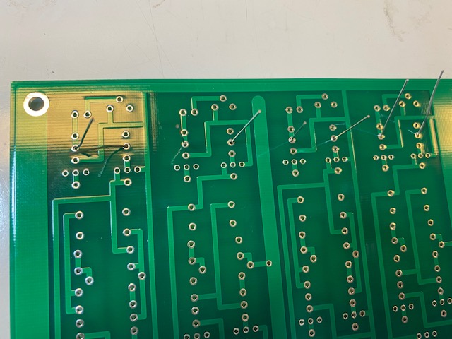

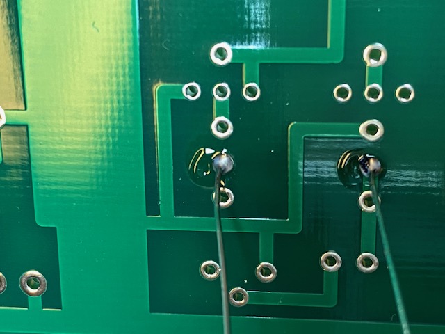

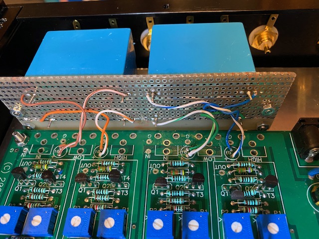

24 db for ESL-2905 and SB-2000 part 2
A few more pictures. Showing soldering etc.
24 db for ESl-2905 and SB-2000 part 3
Pictures.
Pictures.
Nice work! The XO calculator shows the electrical response of the crossover. Have you measured the acoustic response of the speakers with your crossover?
Thank you.
No, no measurements so far. That will probably not happen before 2021.
BTW the bump from using 47 nF instead of 50 nF would not have been large and maybe totally swamped by the non-linearity of the speakers and the room also. Also, 47 is within +/-10% of 50.
