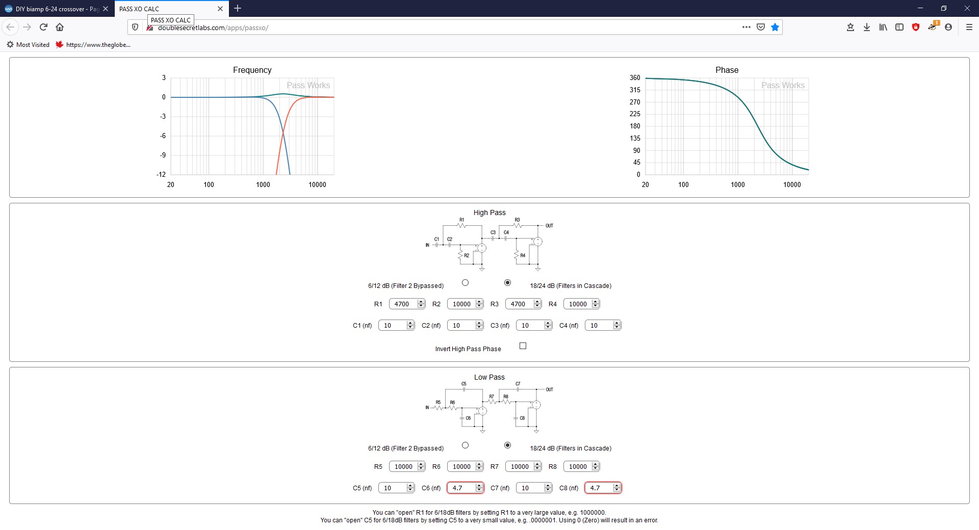

Hello 6-24XO builders,
in my first build of the 6-24XO I also divided at 2500 Hz with a slope of
24dB/oct.
My values were the following - and it is proven to work great.
I lowered the 10 kOhm resitsors to 4.7kOhm.
But there are many ways to do it. 😉
Greets
Dirk

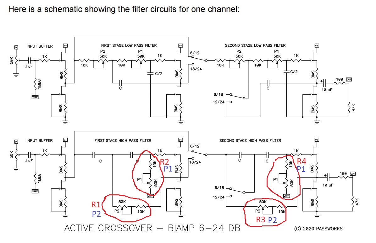

Are you referring to this part of the 6-24 PDF?
If you are dedicated to the 24 dB/oct L-R alignment, you can extend your frequency
adjustment range on this filter if you replace the high pass P2 50K pots + 10 Kohm resistor
with 25K in series with 4.7K resistors.
Dan 🙂

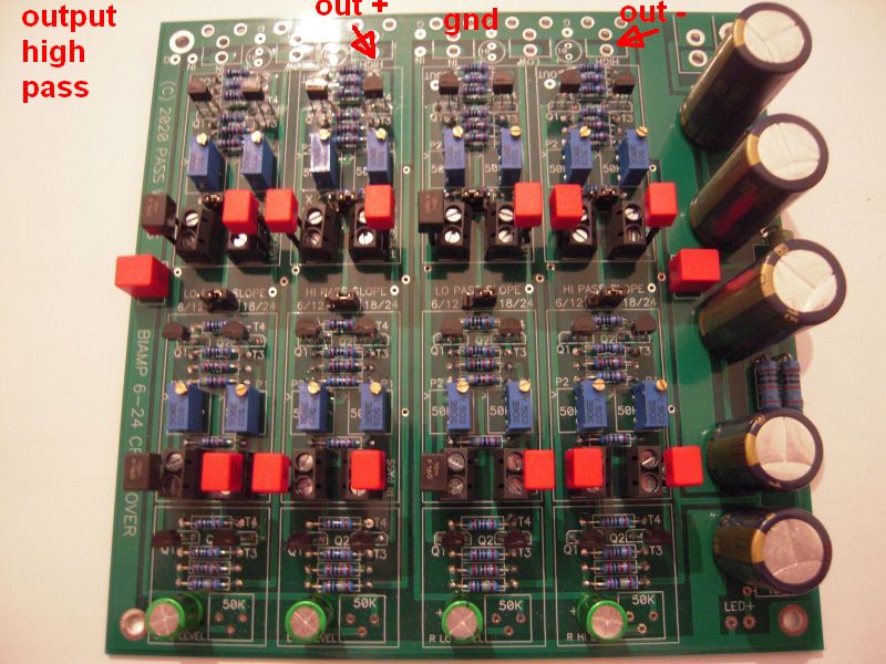

Balanced operation
Dear all
I am very new here and I am looking for a solution to create an active 2 ways crossover that operates in balanced mode.
Would that mean that 2 boards (kits) could be used for that task?
Any wiring directions?
Christophe
Balanced operation
Dear all
Christophe

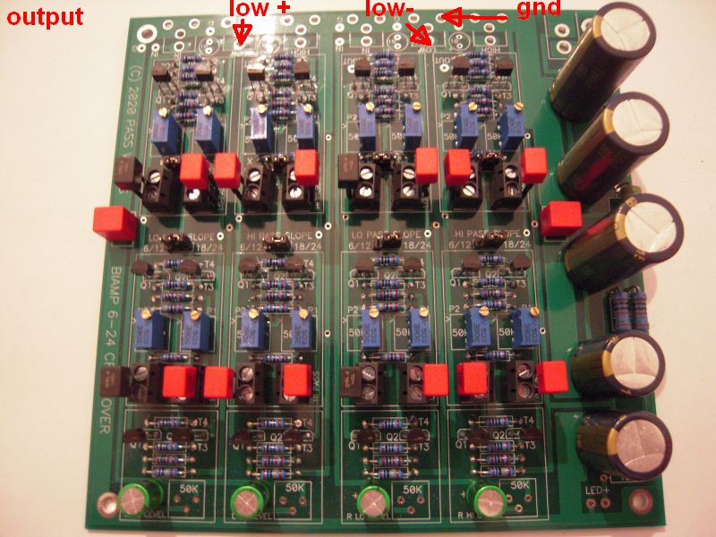

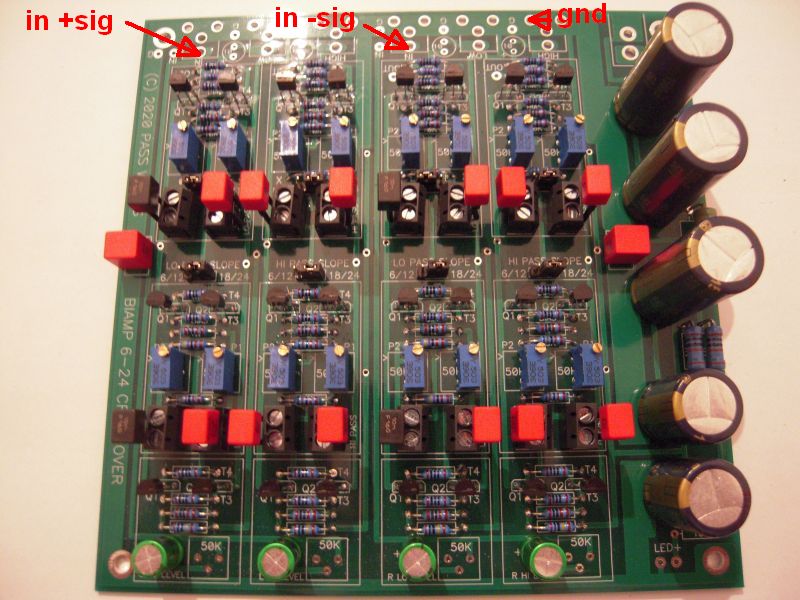

to chris 64
Hello Chris64,
Start reading from post #526 in this thread. There is some information about going balanced with the 6-24XO by converting the signal from balanced to single- ended and vice versa.
If you want to go balanced (without changing the signal) you need two 6-24XO.
Your balanced signal consists of a positive and a negative signal (and ground).
You send your positive signal through the low pass and high pass filter and
negative signal through another lowpass amd high pass filter (with the same values in C and R for positive and negative signal.
So one complete 6-24XO-board for one channel balanced / two way crossover.
You should read through this thread.
I hope this helps😉
Greeets
Dirk
to Chris64
It could look like on the pics.
Your adjustments at the pots should be very exact from positive 'channel' to negative 'channel'.
Greets
Dirk

Till now I only played with the values in the simulator of Michael Rothacher.
I am focused on a 24dB crossover characteristic (steep slope).
I compared the schematic in the article of Nelson Pass with the schematic in
the Simulator of M. Rothacher.
I attach some screenshots.
You can play with the values of the C's in the simulator.
I am not 100% sure which values I wanna use yet (the C's).
I changed the values of the resistors (original 10kOhm) to 4.7kOhm (in the low pass filter) and from 10kOhm in the high pass filter from 10kOhm to 6.8kOhm. Because they are always in line with the pots.Still enough adjustment range with the 50kOhm-pots.

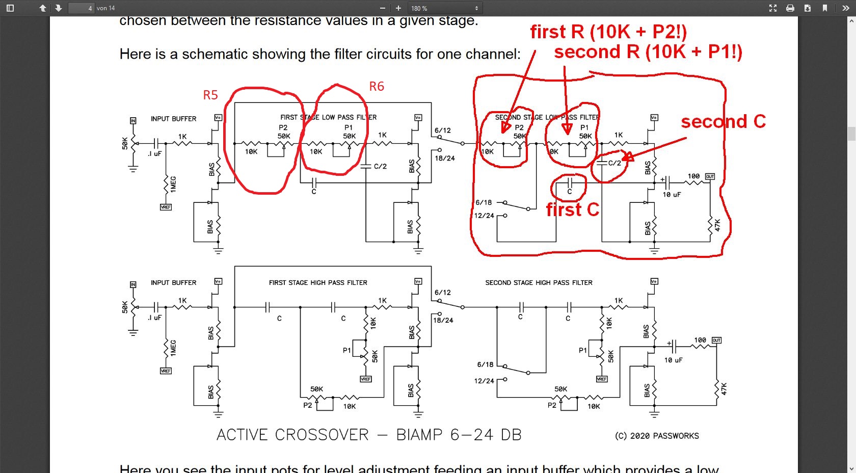

Dirk,
I've edited one of your previous screen captures to make things clearer for my self. I've labelled R5 and R6 from MR's calculator to your image. Correct?
Dan

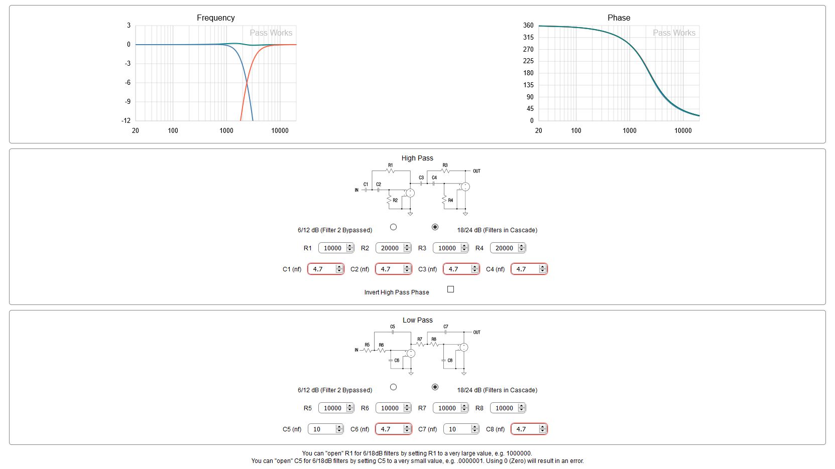

Thanks to Dirk's explanation, the manual, and MR's calculator. Here's where I'm going to start my 2.5Khz crossover.
Dan 🙂

to Dan
Hello Dan,
a happy new year!
Your simulation looks very good to me. You also got it with the Rs and Cs in
the simulation and to 'translate' it to the pcb. 😉
The curves are looking good. I would try it. Perhaps you will have to try
to reverse polarity at speakeroutput of the highpass or lowpass.
I have reversed polarity in the highpass (Mid-Tweeter) in my setup.
Greets
Dirk 😀
