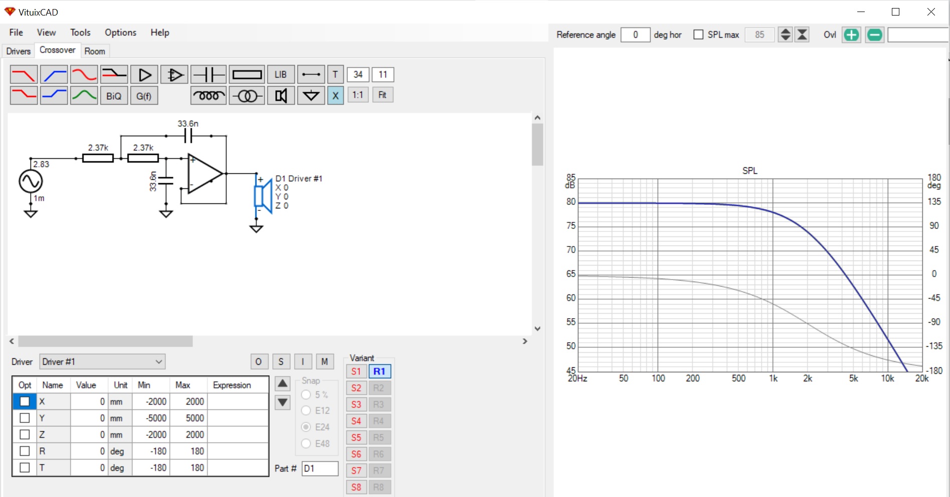

Better Crossover with driver measurements
Real world speaker drivers do not match up the theoretical crossover values presented on the calculator. the results are not ideal PASS XO CALC
I would suggest the use of vituixcad software to substitute real drivers and the calculate the crossover. you could use 2nd and 4th order blocks from the library, only difference would be that opamp is replaced by jfet.
you could do the same with Xsim as well.
Cheers
I have written that too in earlier posts. You need the use the real acoustic response of your speaker drivers. That is also why there are trim pots for setting the response of the crossover. In most cases the acoustic response of the two drivers will be the same, more rarely the electrical response.

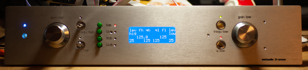

Here are first pictures of my "microcontrolled" Xcross-6-24.
9k=

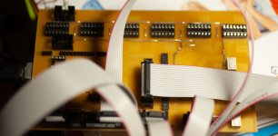

The plan was simple: replacement of the trimmers by digital potentiometers (MCP42050) and replacement of the jumpers by relays (omron G6).
Rest was planning the software and 3 circuit boards.
A first board has an arduino 2560 as microcontroller and the potentiometers on board. My goal was, to reproduce the values of the potentiometers exactly and possibility of storage of different setups (10).
The connection digital potentiometer-> Xcross board is realised with flat cable over short distance. The same procedure between relays and jumpers.
A second board contains 3 rotary encoder, 4 push buttons and "information"-LED for the left side and the third printed board for the right side.

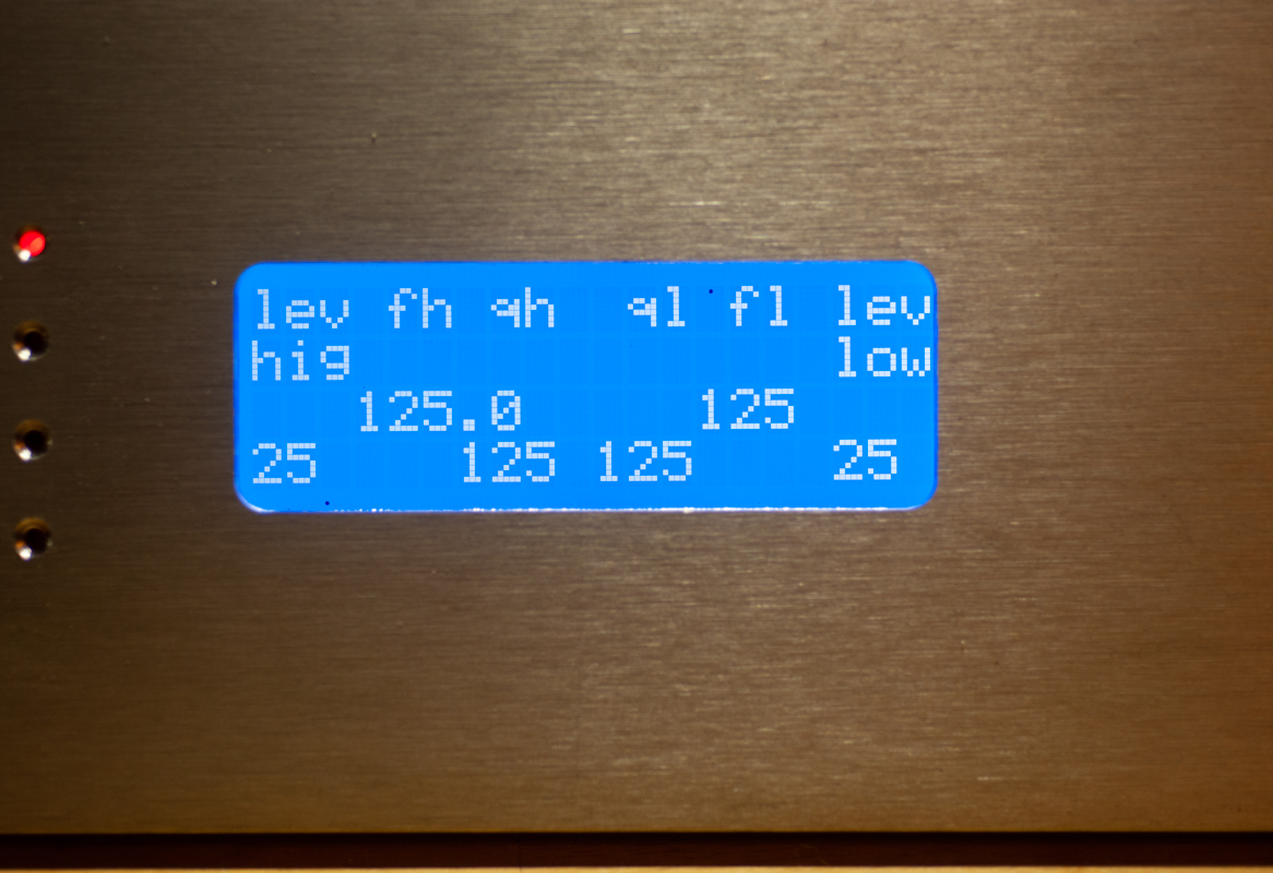

Information about actual setup comes via 20x4 oled display.

Picture Nr.1: the complete front, not milled perfectly but it represents the idea
Picture 2: diplay with different informations

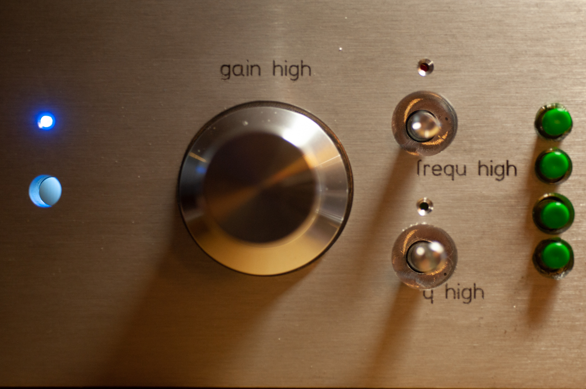

Picture 3: big encoder for gain high, 2 small encoders for frequence and q high, 4 buttons 6-12-18-db with logic use of the potentiometers. Same process on right side for gain-low, frequnce low and q low.
Picture 4(not sharp): the controller board, the arduino "hangs" on the bottom side, free places for MCP42050.
Pressing the encoders you take 3 informations: - gain/frequence/q as a bit information (1-255), a resistance information (0-50k) and calculated gain(dB), Frequence(Hz) or q information.
A choose of channel (left, right or stereo) is possible per parameter.
If both big encoders be pressed, the actual setup can be stored or restored.

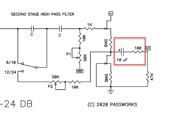

Hey all - quick question about the output stage in the schematic.
I'm using some fairly large output caps, so am going to mount them off board, and solder the 100ohm and 47k ohm resistors directly to the rca sockets. I need to make sure I'm tapping the correct point on the board.
However, when looking at the PCB itself, it seems that the 10uf output cap is actually after the 100ohm resistor, not before. Is there a mistake in the schematic, or the board?
I've attached an image of the schematic, highlighting the section.
See post #369. Pull the 47K resistor off the board and put it on the output jack. Bypass the coupling cap with a jumper. Connect one end of the coupling cap to the board and the other to the output jack.Mounting the cap and the resistor worked for me.
