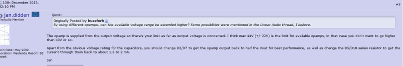

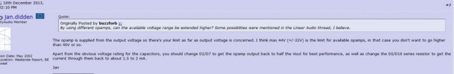

to RogerGustavsson #649
Good Morning Roger Gustavsson,
the Superregulator is normally intended for voltages up to 18V.
If I remember right, it can be tweaked to go up to 24V. Don't ask me what parts have to be changed. I don't remember anymore. Sorry!
Greets
Dirk
It depends on the Opamp you want to use.
Greets
Dirk
