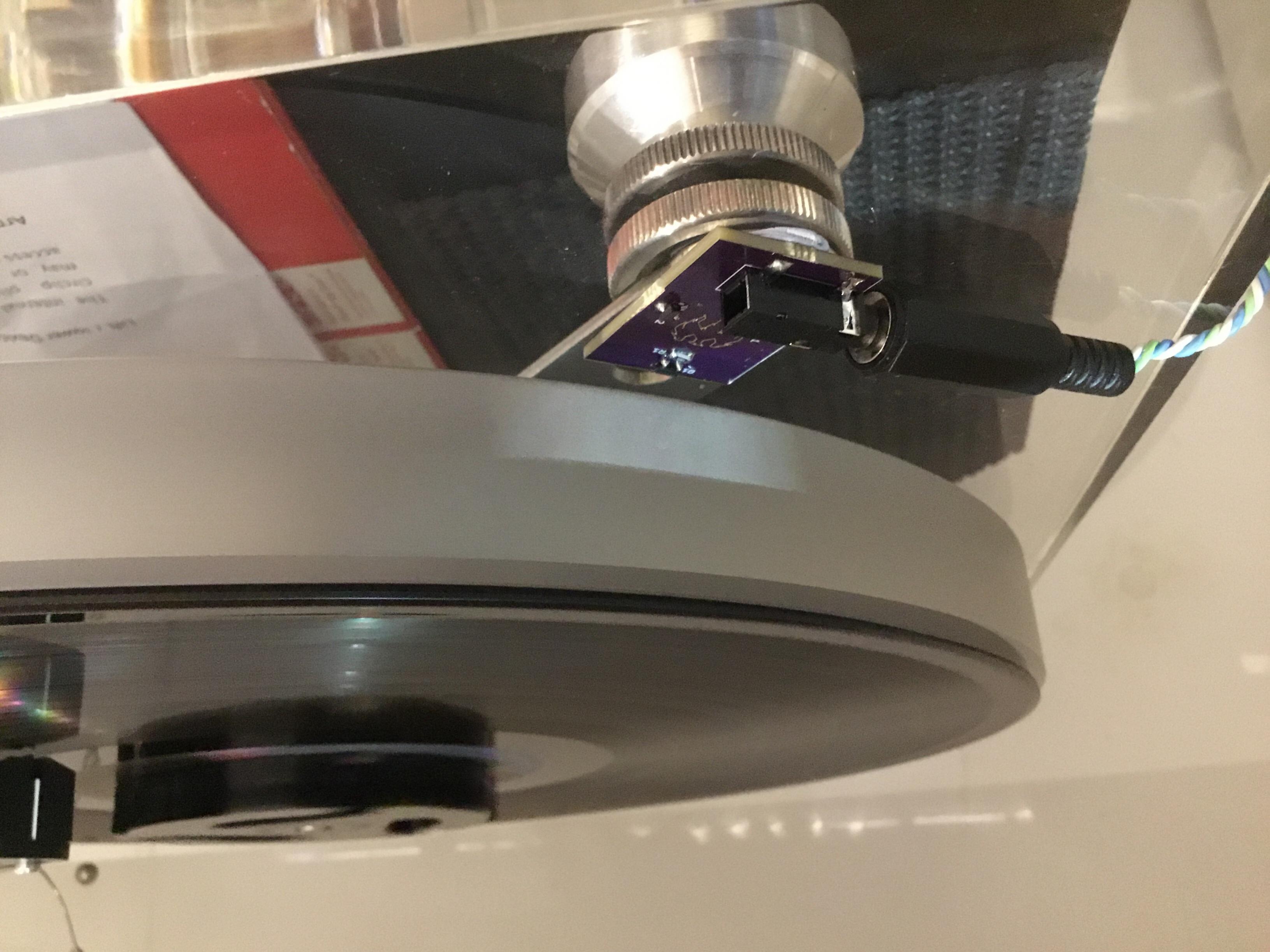

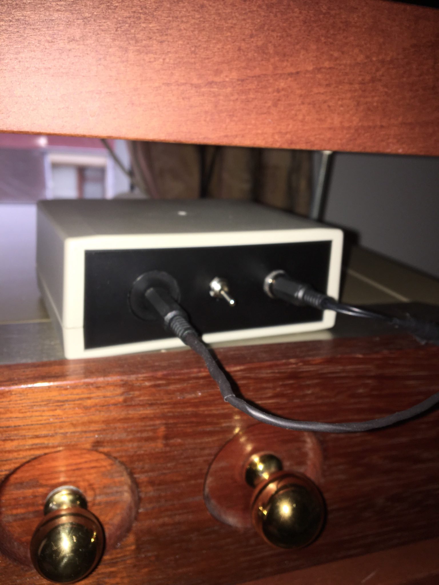

I thought I would post pictures of my implementation. Thanks again Pyramid, Tauro and all those who assisted getting this done for us.
I have 2 inputs at the back which are switched from the upper toggle switch on the front panel. The battery at the back is for when I move it to the other system. I use a wired snap on 9v connector wired to a female DC plug to go to a 9V plugback for normal use. I use a proximity sensor with a 3.5mm stereo plug.
The arduino clone, display and sensor cost me AUD30 The box and plugs another $20 or so.
Sorry about the display but it got lost in the glare. The display cutout was a bit of a hatchet job.
I can post links to the parts I bought to help Aussie builders if any one is interested.

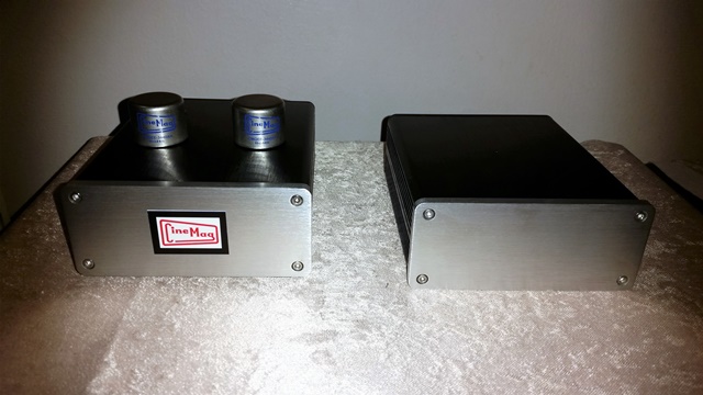

Great implementation.
I guess we both used the same case.
Here is mine:

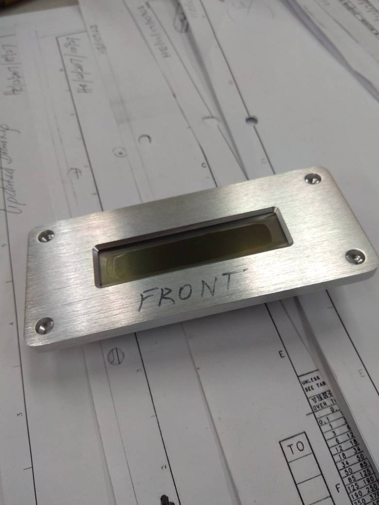

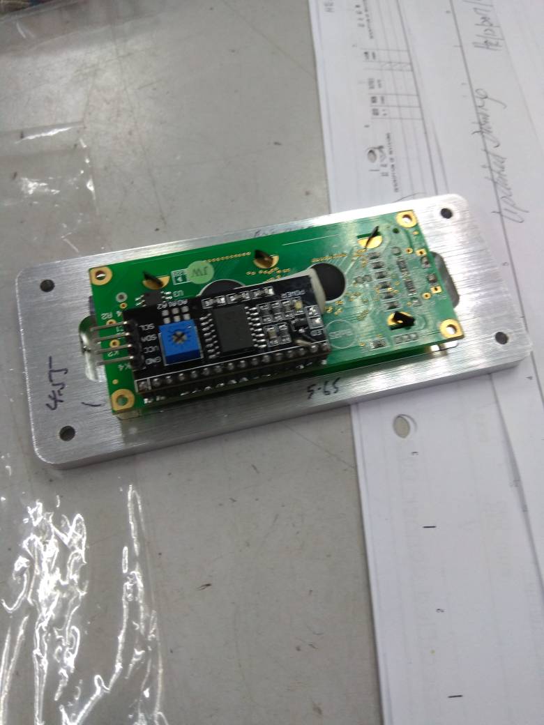

I recently purchased these aluminum enclosure from China and just completed remounting my MC Step ups from an old project box and it looks good. I'll use the other one for this Arduino Tachometer. I will have the front panel machined to mount the LCD display.

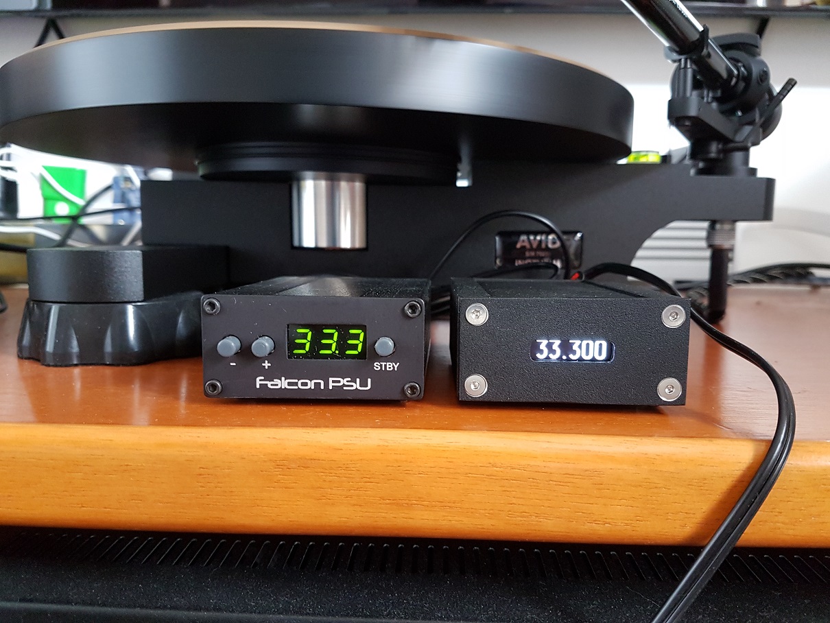

Definitive version is complete, didn´t managed to make it "talk" to the Falcon PSU, but the speed stability is so much better with the Falcon that using the tachometer just to set proper speed is enough to achieve an excellent result.
I don´t know if my TTL>RS232 board is not working properly, I tried all combinations and no way to see the decimal point blink on the Falcon..
Maybe I will get another board in the future, but it was so hard to squeeze everything inside this little case that now I want to leave it as is.
Thanks everyone for all the help and for sharing this great project with us!!!

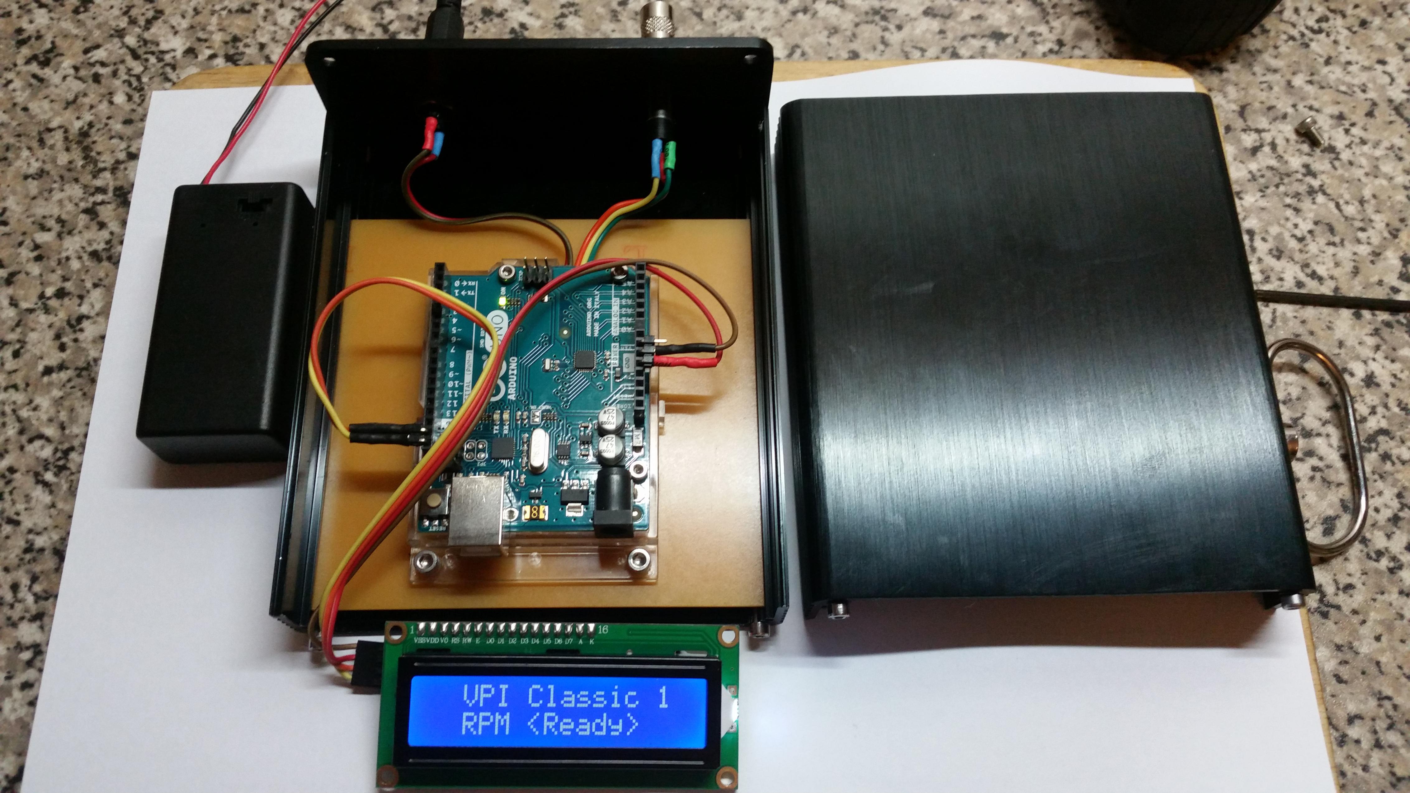

This is how I'm mounting the Arduino and display into a nice aluminum enclosure. (the same type I used for mounting my MC SUT earlier) I mounted it on a blank PCB which I can slide in to fit.I soldered the power, sensor wires directly underneath the Arduino to be permanent. I may do the same for the display wires after I get the front panel machined out for the LCD.
