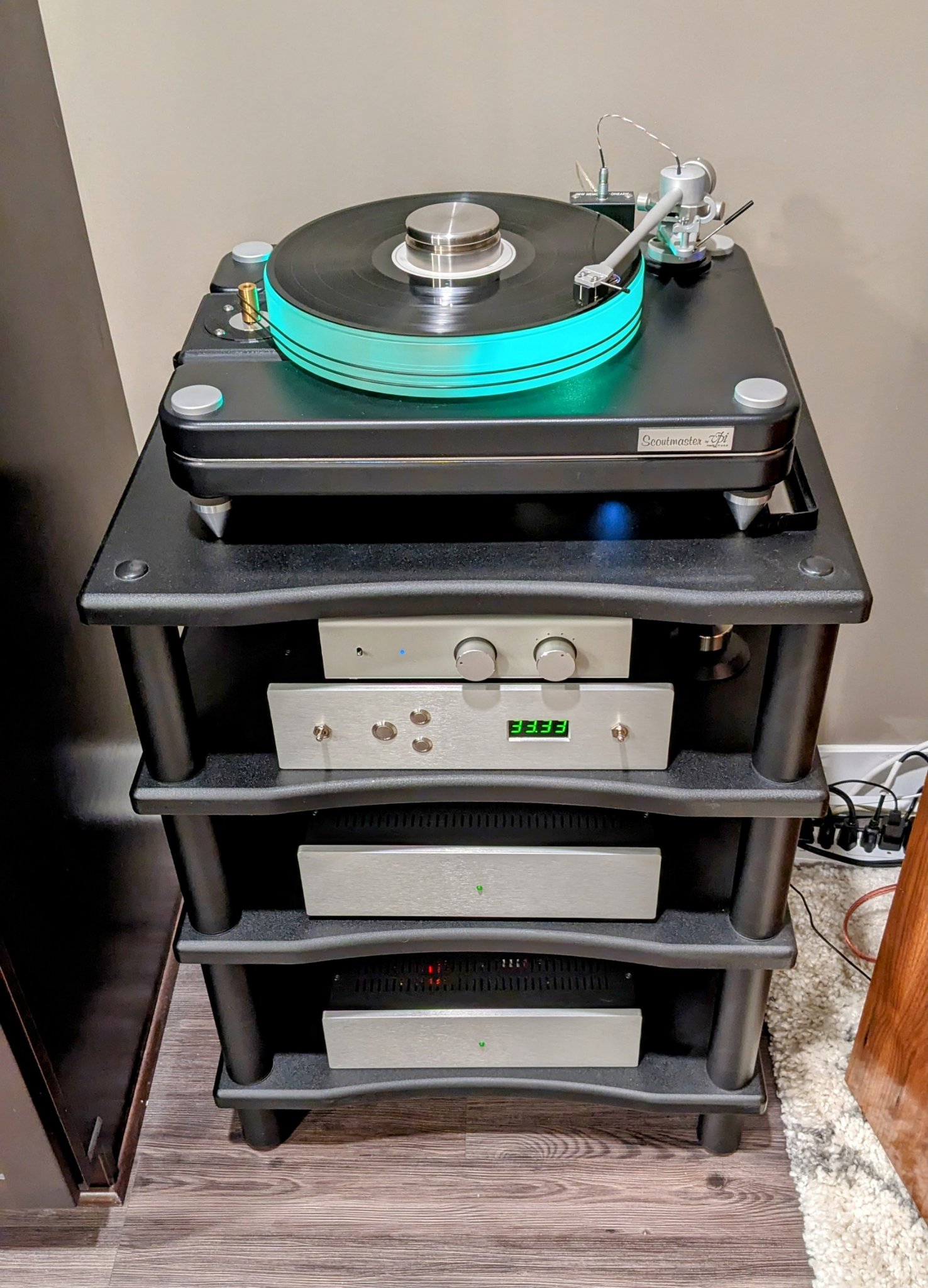

Thanks for the really cool project to all of those involved! finally finished!!
Getting back to my turntable project - SG4 and MA3D with the intended motor to replace the motor on my LENCO. Only thing left is the idler arm!
I have greatly improved where I was when I put this aside to work on my loudspeakers but there is still a slow drift in speed and I would like to try the ARDUINO to stabilize this. The width of the drift is less than 1 rpm.
I am using ROADRUNNER to monitor speed - what I am wondering is whether the ROADRUNNER sensor could drive both the ROADRUNNER and the ARDUINO or will I need to use two separate sensors?
Hoping the great PYRAMID is still looking here.
Thanks and take care.

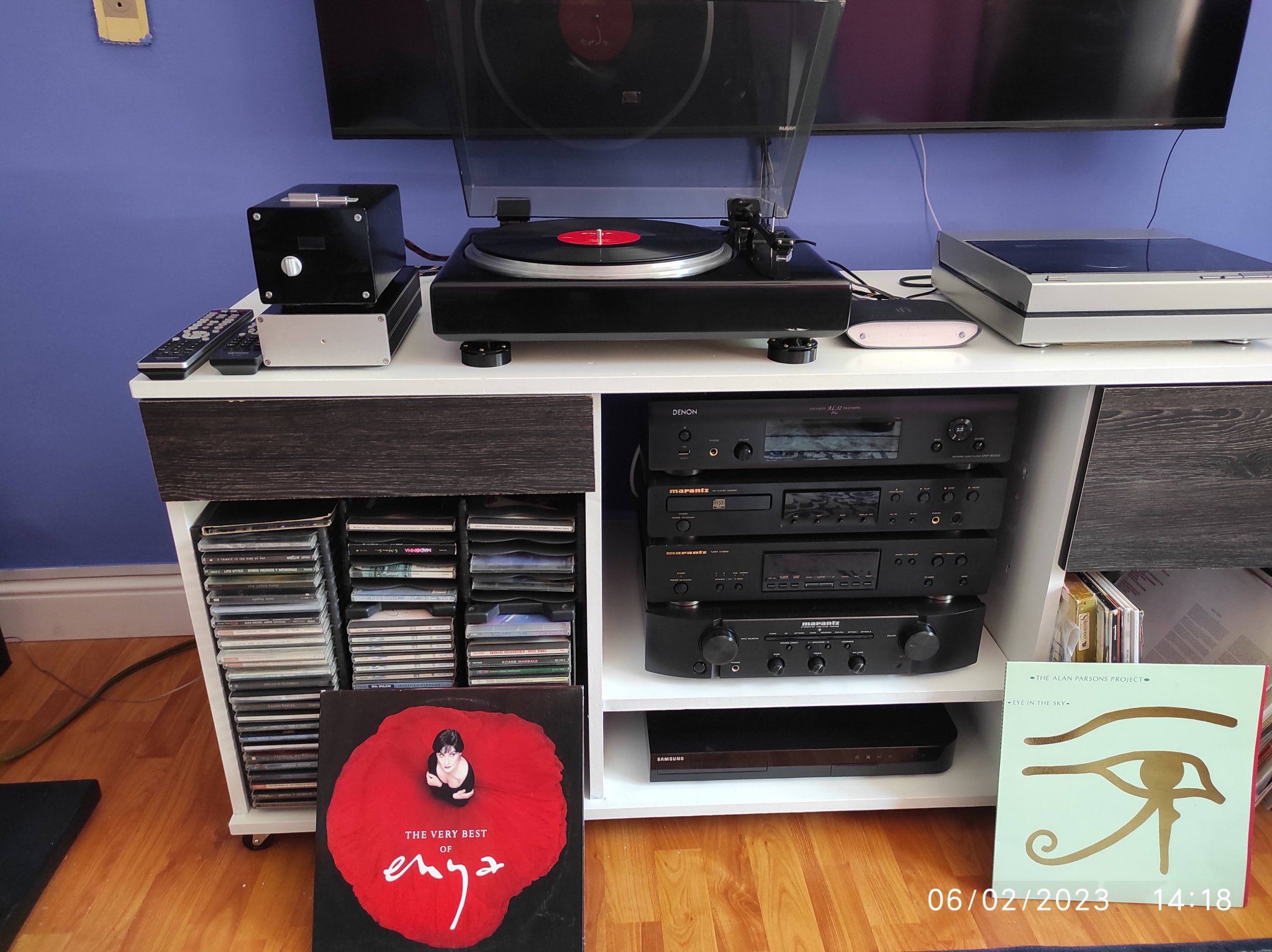

AIWA AP2400 MODIFIED WITH DIGITAL TACHOMETER AND ARM LIFT WITH SERVO.
Hello. Looking around the forum, I found this thread.
I always wanted to make a turntable with a digital tachometer.
I show you a crazy thing that I did with an Aiwa turntable from the year 1980 direct transmission, which made the plinth with MDF, removed the power supply and speed control and placed it in a separate box. I added a digital tachometer with arduino, and also with arduino driving a servomotor and relay I made an arm lift at the end of the vinyl with engine shutdown.
I have tried to upload the tachometer and servo files. I haven't managed to do it.
