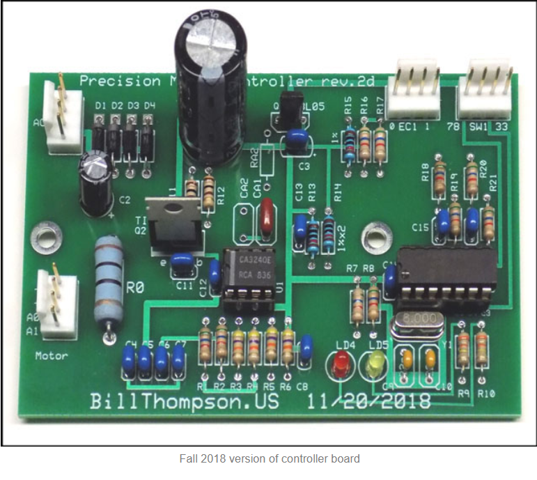

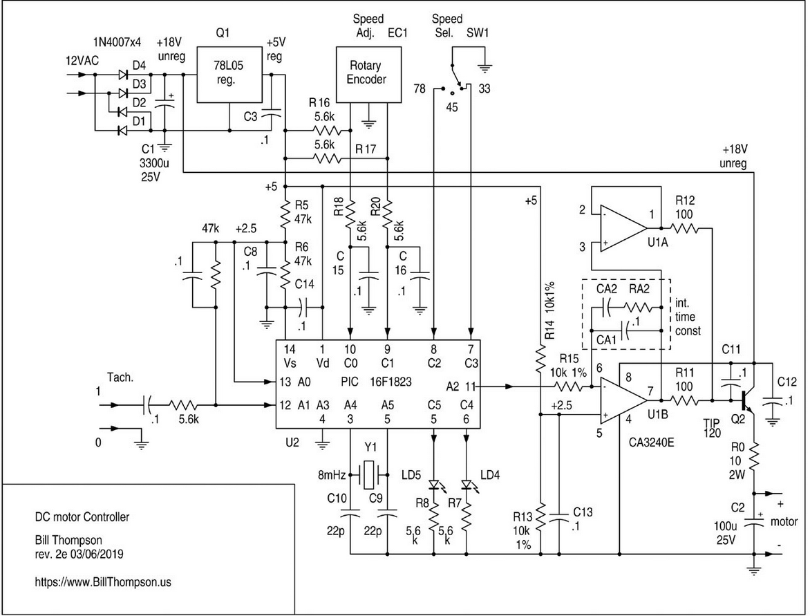

So first off everything I post below was from Bill and not myself (just want to make sure of his credit). Also below is the link to his page where he discuss' the motor controller and such. I hope this is in someway helpful/usefull.
Turntable DC Motor System – BillThompson.us
"My goal was perfect speed stability and no audible motor noise. The approach is simple in concept; the tachometer on the motor fires a one-shot with a fixed pulse width. This pulse is fed to an integrator the output of which drives the motor. When the duty cycle is less than 50% (slow) the integrator ramps up raising the motor voltage and speeding it up. If the duty cycle exceeds 50% (fast) the integrator ramps down lowering the motor voltage and slowing it down. The system reaches stability when the duty cycle of the pulse is exactly 50%.
The first version of this controller was completely analog using a 555 timer for the one-shot and this worked very well. However it required high quality resistors and capacitors for the one-shot timing and the variations in individual 555 chips made re-calibration necessary upon replacing chips.
In the current version of the motor controller the 555 timer has been replaced by a PIC microcontroller for the one-shot. This opens a whole new range of possibilities. The time base is an 8 mHz. crystal and the speed adjustment is accomplished by the encoder. Whenever an adjustment is made the new timing information is stored in an EEPROM in the PIC chip so the speed settings are remembered when powered off. A purist might have taken the time to replace the analog integrator and output transistor with something digital as well but the motor takes so little power to run and the analog output works so well that I didn’t bother.
I did several updates to the hardware and software in the Fall of 2018. The 16F1823 has a nice built-in comparator which the tachometer can drive directly. I now use that rather than the external comparator that was a holdover from the analog controller design. This left me with an unused opamp section in the dual opamp so I used that as a “current doubler” driving the pass transistor. I also did a bunch of work on the rotary encoder software. Encoders can be noisy and sometimes give sporadic false readings. A combination of software de-bouncing and input hysteresis makes the encoder much smoother.
The hex file can be used to program a 16F1823 controller chip using a Microchip PicKit 3 programmer or equivalent.
My motor pulley is a little larger than the one on the original motor and I always run the turntable’s own speed selector at 78 RPM and set the motor speed to get the rotational speed I want, usually 33.33 RPM. This lets the motor run very slowly, about 600 RPM, lowering the motor vibration frequency from the original 30 Hz. to about 10 Hz. and this is much easier to deal with. With a little gentle filtering the turntable contributes no significant L.F. noise at all.”"

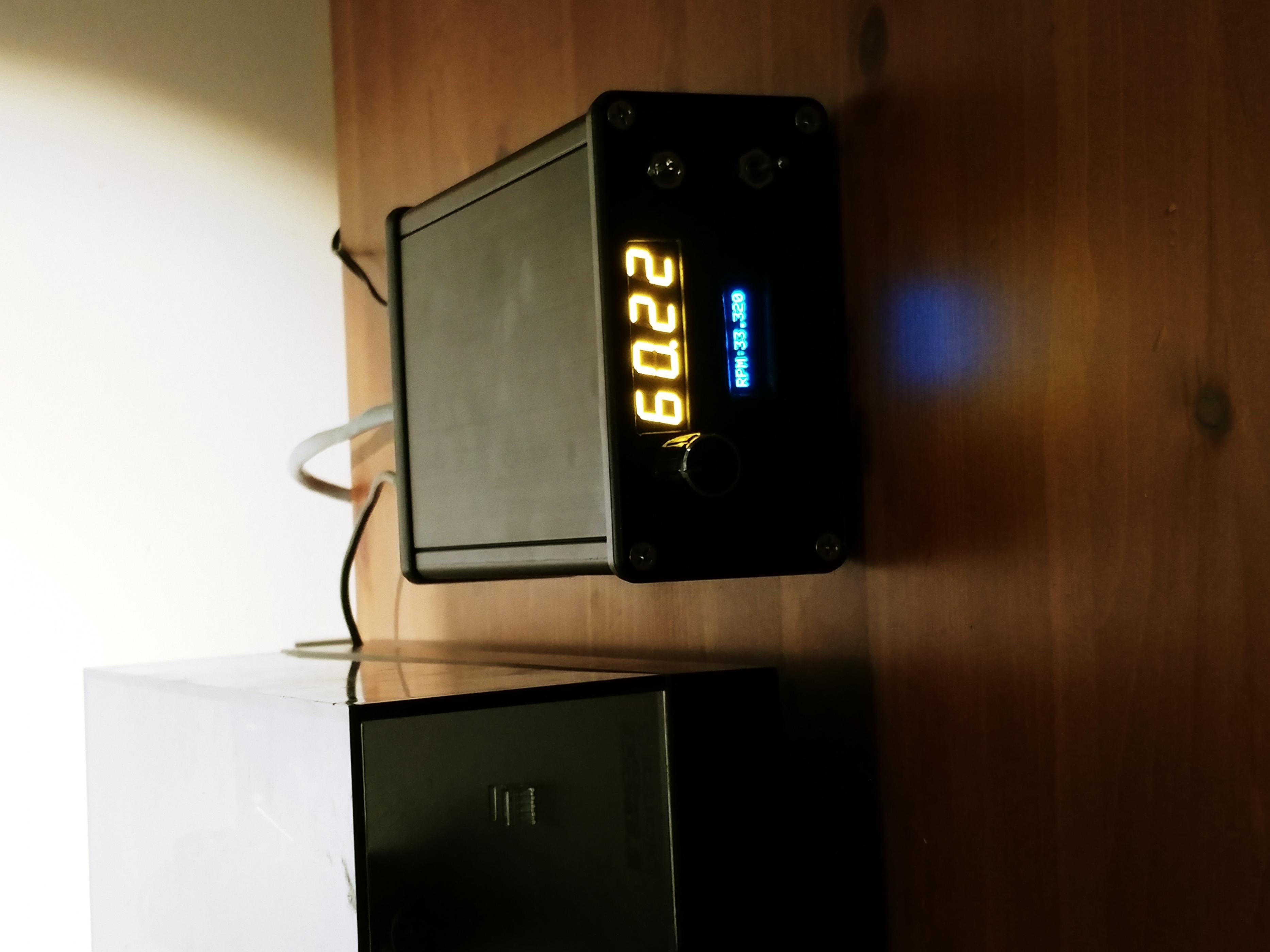

128x32 OLED display
60Hz setup with that correction is working flawlessly.
**I did set it with 60Hz:
ADJFREQ = PIDOUT * 180; //* amount of frequency adjustment needed in 0.01 Hz
SG4 with PID - YouTube
Hello,
Greggan posted earlier some code that uses a small OLED display, which I have and it works with his code, however trying to comment out the code for your display, and adding in Greggans display code results in compile errors.
Maybe you have an idea how to substitute the display in the code?
The CNY17 reflective IR-sensor works great with 1K on the IR-diode and 47K on the collector. Emitter and cathode to ground, 5V to the "other" end of the resistors. Emitter to pin3.
Thanks!
update
I did find out how to substitute the display with a very small OLED 128x32, after some trials and errors.
The Tachometer with a feedback to the SG-4 is working OK. Thanks all! :cool:

128x32 OLED display update
The feedback system works great. I'm using a CNY17 for reflective optical feedback via a Schmitt trigger buffer. The Arduino Nano clone has the .3% 16MHz resonator removed and a substituted with a ±1.5 ppm TCXO.
The ~ 3W motor is driven by a stereo Class-D amp capable of 20+W driving a couple of "Flathead" 6VA transformers.
The Hammond case is hastily put together, as this is a "prototype".
The rotary encoder flip-flop's output has been converted for open-drain drive on the complementary outputs (!QA and !QB) , and can be used simultaneously with the feedback MCU.
The D-flop is not a Schmitt type so I will change that later for better noise immunity from the rotary encoder.
I would have preferred a i2c display for the SG4 like the 128x32 OLED. Those LEDs are a are bit big for my taste.
I know a 32bit processor is not necessary for this job, but they are small and inexpensive and can do it.
A feedback signal with more data points can be averaged for better accuracy, keeping the once per revolution correction. Not sure how a say ~30x more data used to correct every AC cycle would play out, the audibility may also depend on the strength of the correction.
Some turntables may be a challenge to implement this but my REGA looks not so hard.
Flutter may be hard to tame, but wow could be improved maybe. Non-perfectly center drilled LP's would need some other method of correction. I have a few of those, annoying.

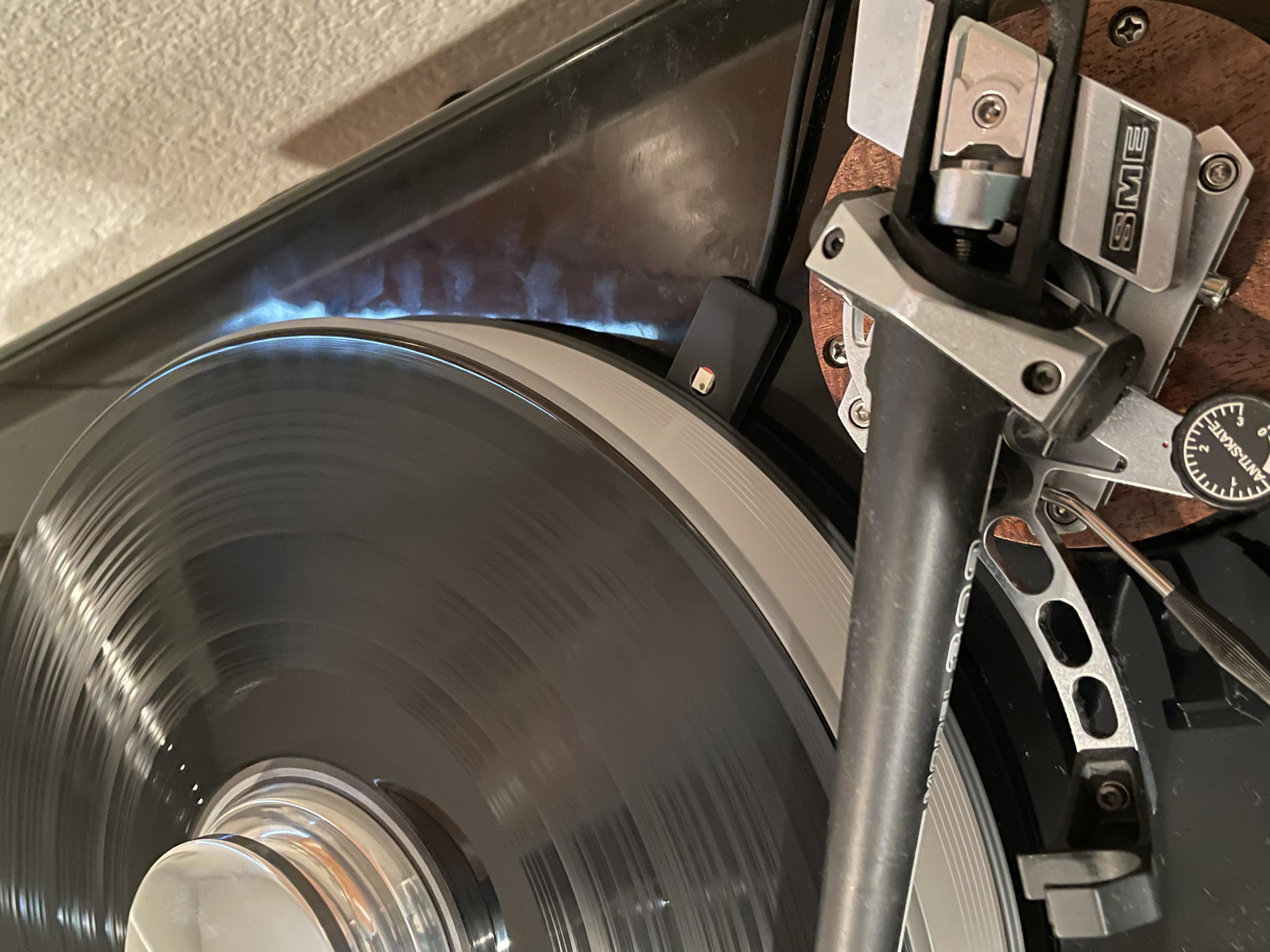

white sticker
I used a 1cm^2 aluminum foil, and it detects at a great distance. The CNY17 is a low end part, I know. I don't have much daylight by by TT so no problem.
I designed a 0.6mm PCB that would fit under my sub-platter, with 30 precision spots for a higher feedback frequency. The problem with a single spot is that it may fall in a peak or valley of a low frequency wow. Possibly a divide-by-N chip could be used for data reduction, to 1 pulse per rev. but software would be better.
The picture was taken with my LG phone and looks much worse than the real thing. The camera has problems with the light contrast of the LED and OLED, and I cannot get a good pic :-(

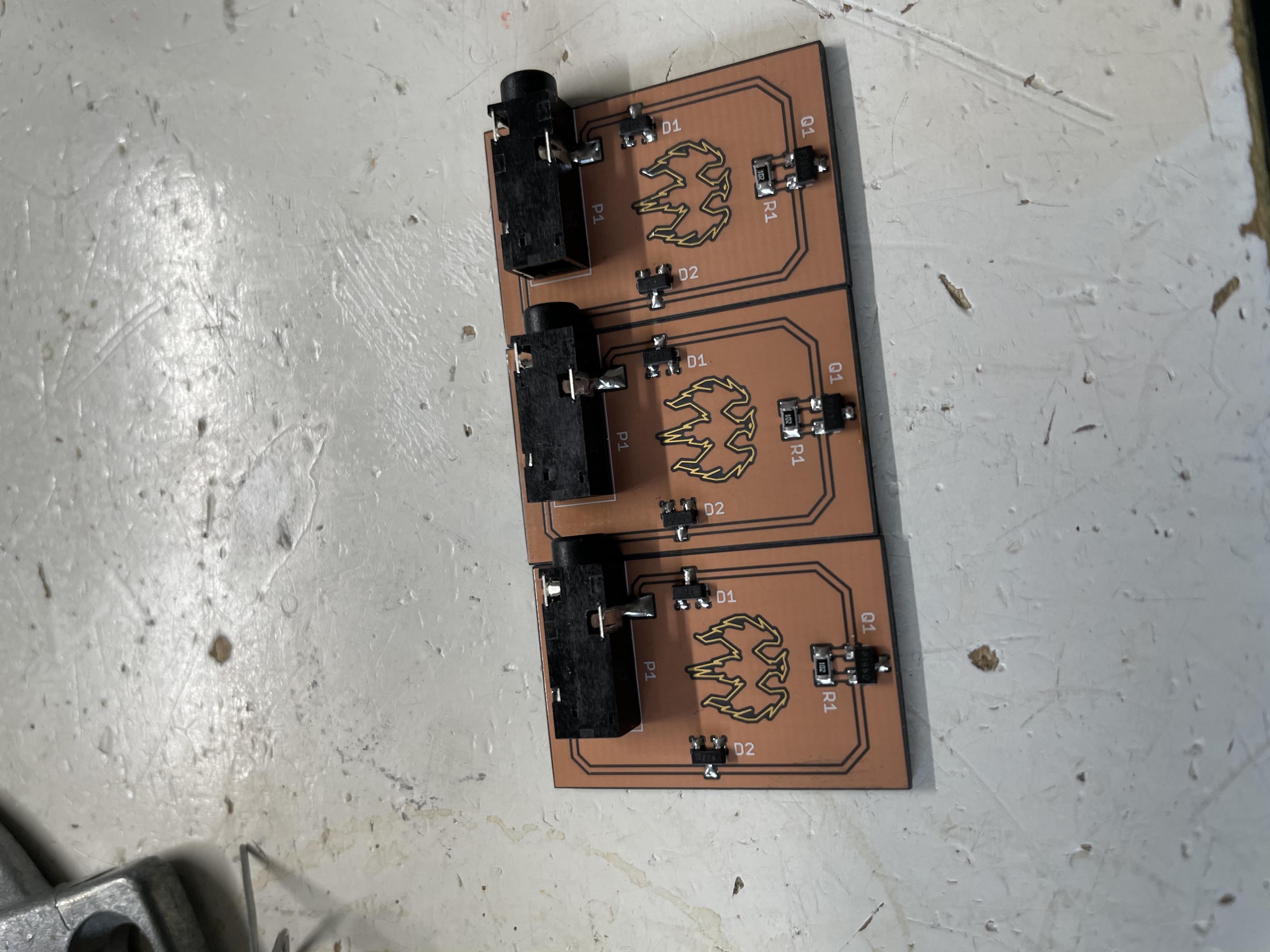

Unfortunately I am still having issues with overhead recessed incandescent bulbs.
Would increasing the current through the diode help - maybe there just isn’t enough IR light. I am using the white sticker dot. The datasheet says the osram part has a daylight filter, but perhaps I need something different to combat the bulb?
...sorry I meant I use the CNY70, not the -17.
One photo sensor the 1KOhm series resistance was not enough from 5V, so a lowered it to 500Ohm, which worked.
1KOhm would give you approx 3.9mA for an IR diode that is rated for up to 50mA, so maybe a bit optimistic.
So you ended up with around 7.5mA (5-1.25)/500? Yeah, I am at only 1mA - maybe that’s my issue.
