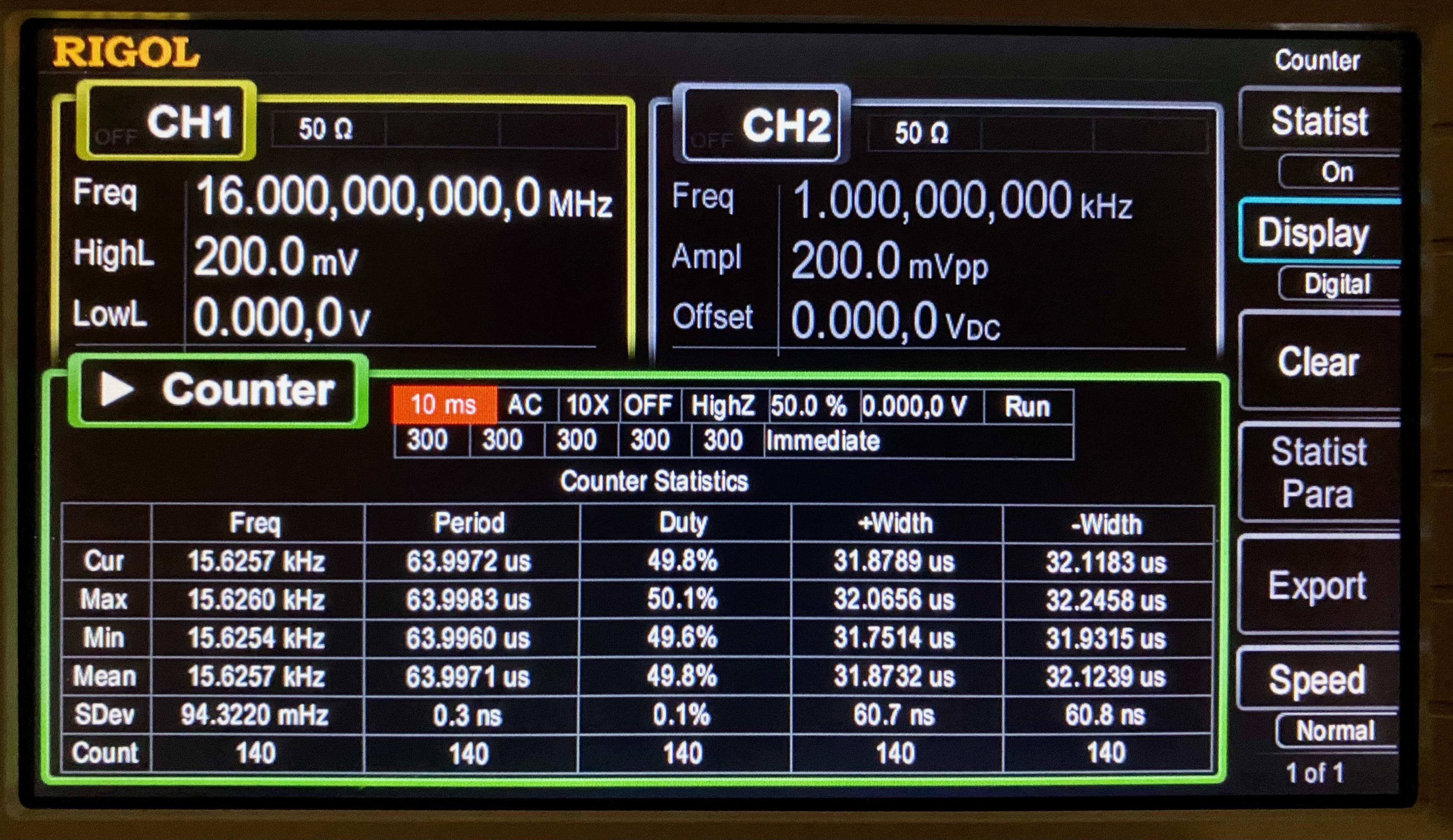

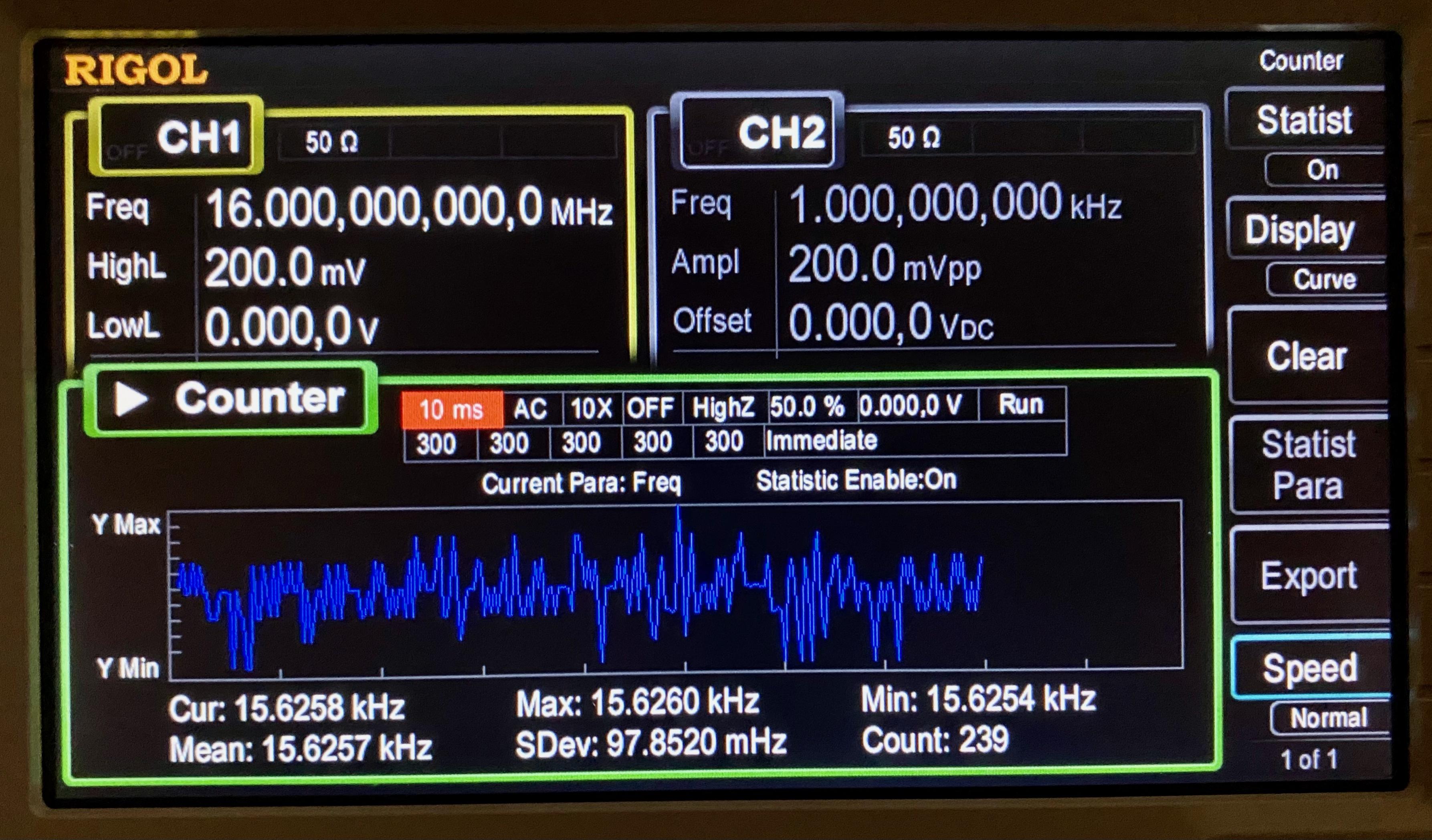

Images for PB2 freq. measured on my Arduino Uno PIN #2. It is not an Italian made unit. My board is made in China and purchased from eBay.
So, it is relatively stable during first 3-4 min, and then it starts to dance quite significantly. Please see video taken after about 10 min of warming time.

Why did I posted these images and video? So, I troubleshooted my case when I had some delta (-0.030) with RPM readings between our Arduino Roadrunner and some alternative tacho based on different principals. I consulted with Pyramid and he quickly helped me to find the reason. Straight to the end: 15.625kHz is translated to 1875000 in code for:
onst float CALIBRATE = 1873440; //*equals freq @ PB2 x 120
As you see, I had 1873440 in my sketch and that was too off. Have no delta with 1875000.

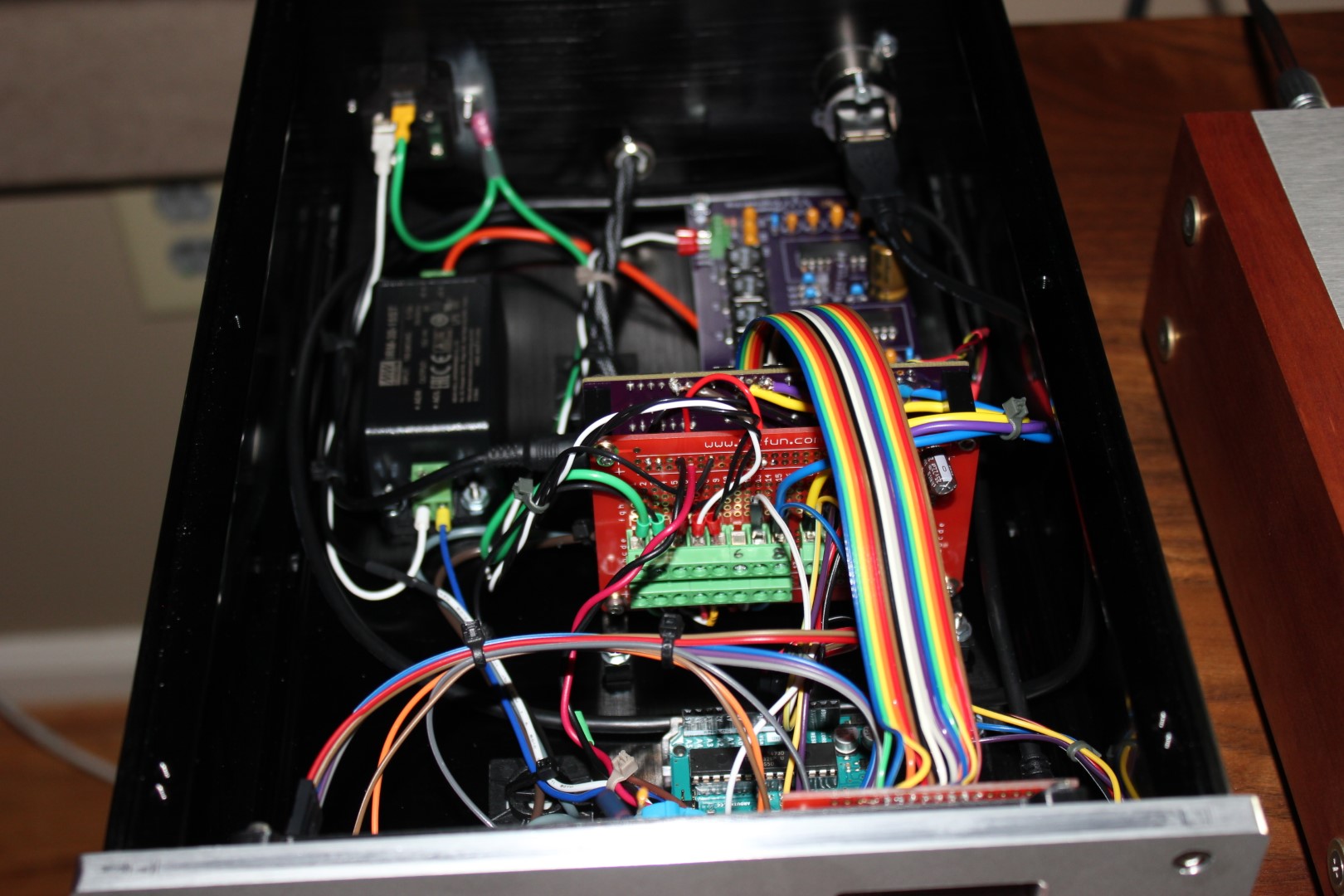

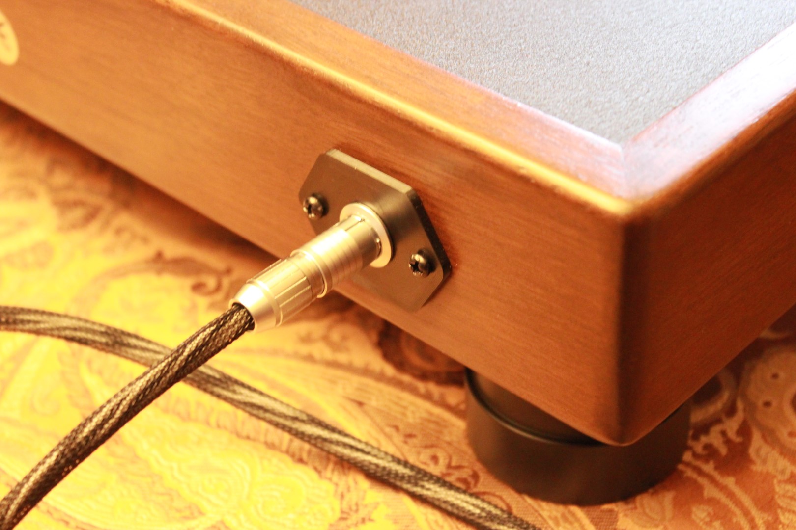

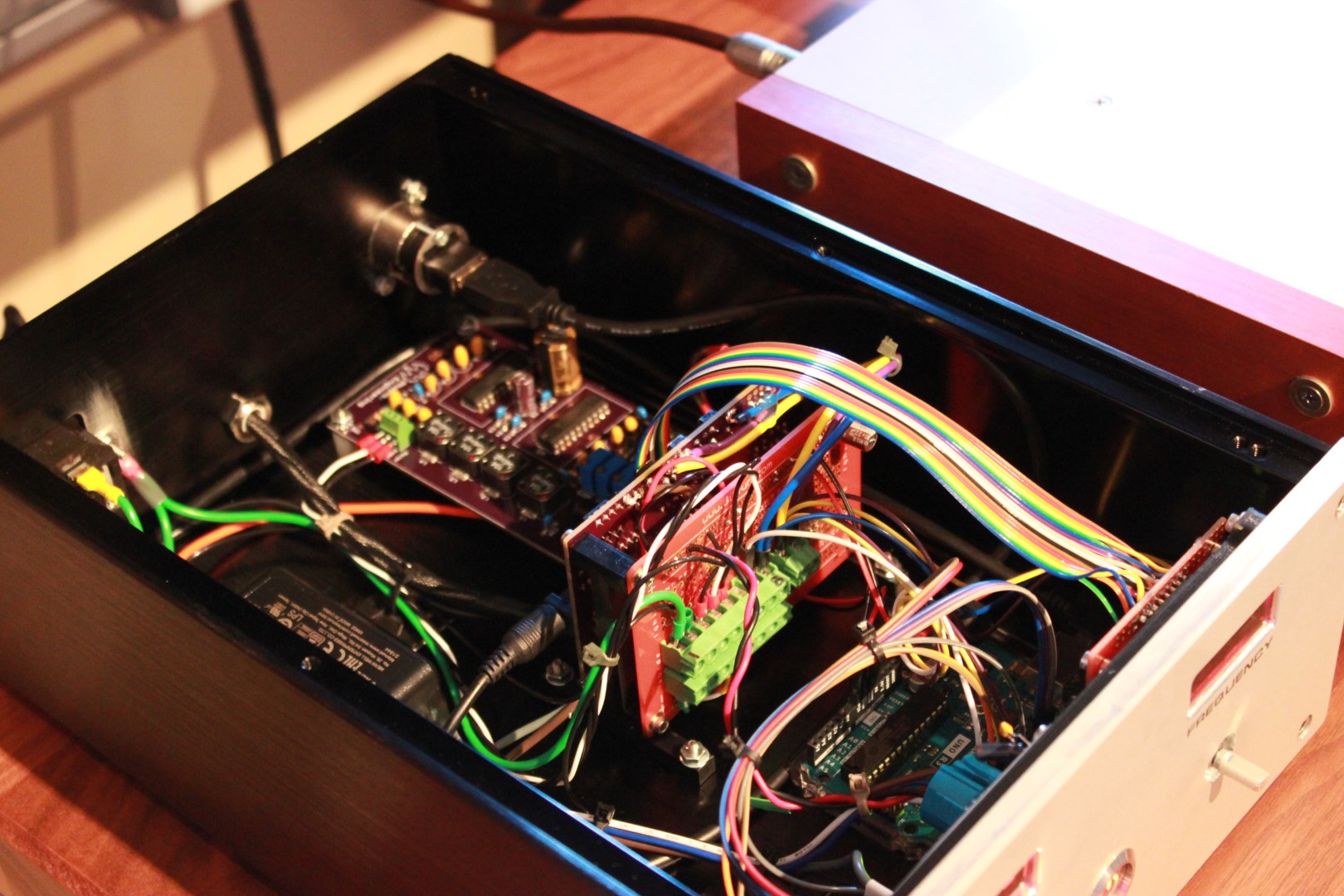

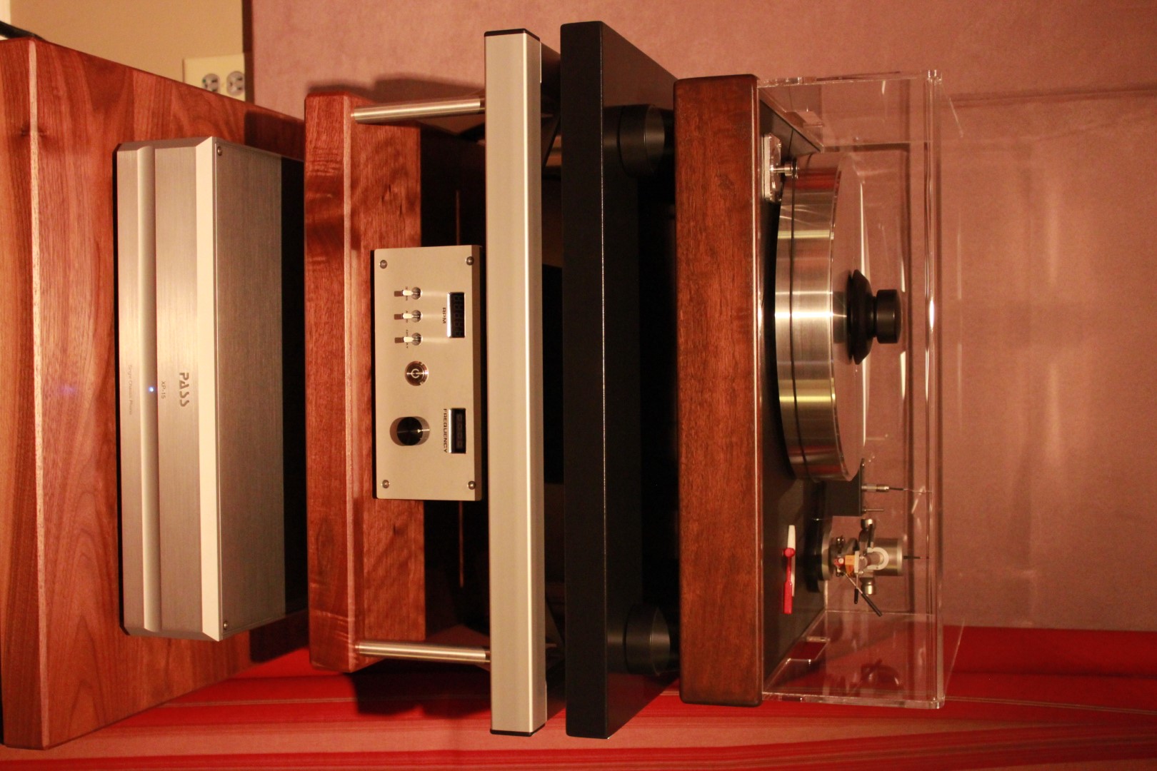

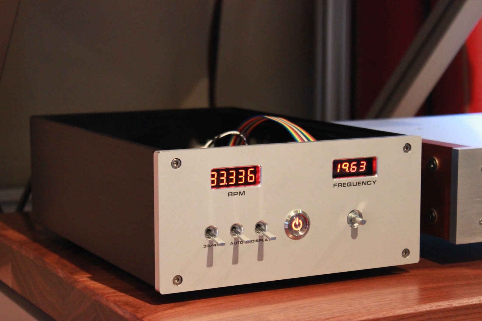

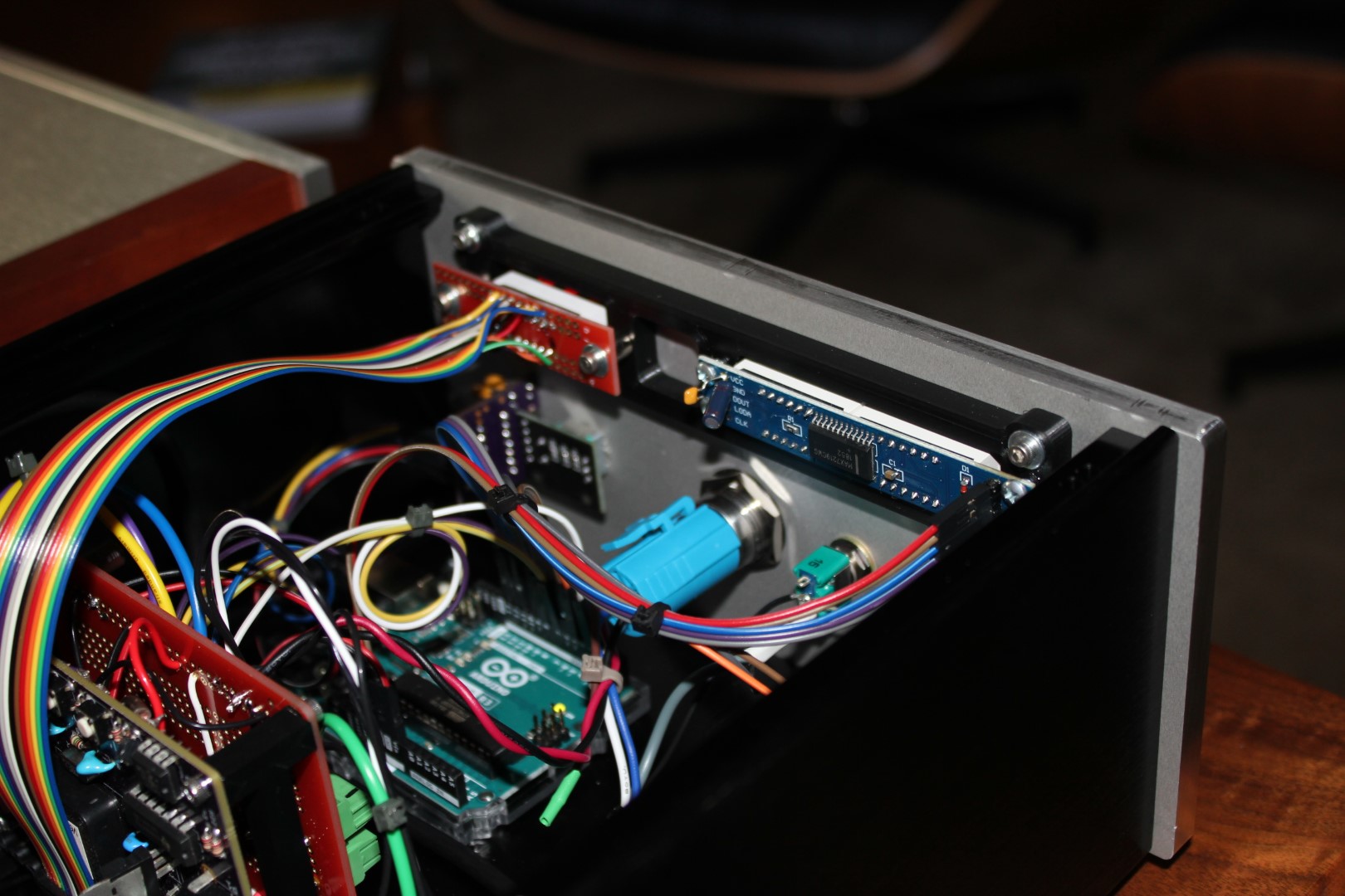

Working on implementing the auto correct along with the BLWS231S-24-2000 BLDC motor, so I am running much lower frequencies (~19.6X hz @ 33.333). Couple questions:
1 - Anyone have any different PID tuning values? I have it working with the values in the base sketch (kp = 1, ki = 0.6, kd = 0.4), but it quickly starts to over-correct with these. In my setup, it should only be tweaking +/- 0.01 hz every few mins to adjust for any drift as things warm up, etc.
2 - After I implemented the sketch with the auto correct, my encoder on my SG4 no longer works for up/down. Standby still works. Buttons on the SG4 board still work. Not sure if sending the 5V with "digitalWrite(UP, HIGH);" to the up/down pins hurt it? Is there a way to change that to "not LOW"?
Regarding #2 (obvious Arduino noob, but I'm learning), I did not have any resistors between the Arduino and the SG4/Encoder. So with the UP/DOWN held at 5V on Arduino, when I was turning the encoder it was shorting that UP/Down assigned pins. When I pull the cables from the arduino pins, the encorder works again with the SG4. Now the tach pin does not work either as it is also stuck in an indeterminate ~3-4V. Lesson learned (I Think). ordered another arduino, will add resistors between everything.
I did eventually get everything working. Will probably write some different code for the Auto adjustment as with the BLWS motor every .01 Hz adjustment is about .015 rpm, so i think I just want it to adjust for long term drift (i.e., up or down .01-.02 Hz over a listening session.) based on an average reading.
Why not just connect the Arduino to the other side of the resistor on the up/down buttons and send “low”?
That first question really was my not understanding the whole thing at the time. I missed the code if keeping those pins high and pulsing low. So you can connect it to the buttons on the SG4, but I did need the resistors between the Arduino and the encoder chip otherwise the encoder was always held high on up/down and did not work.
