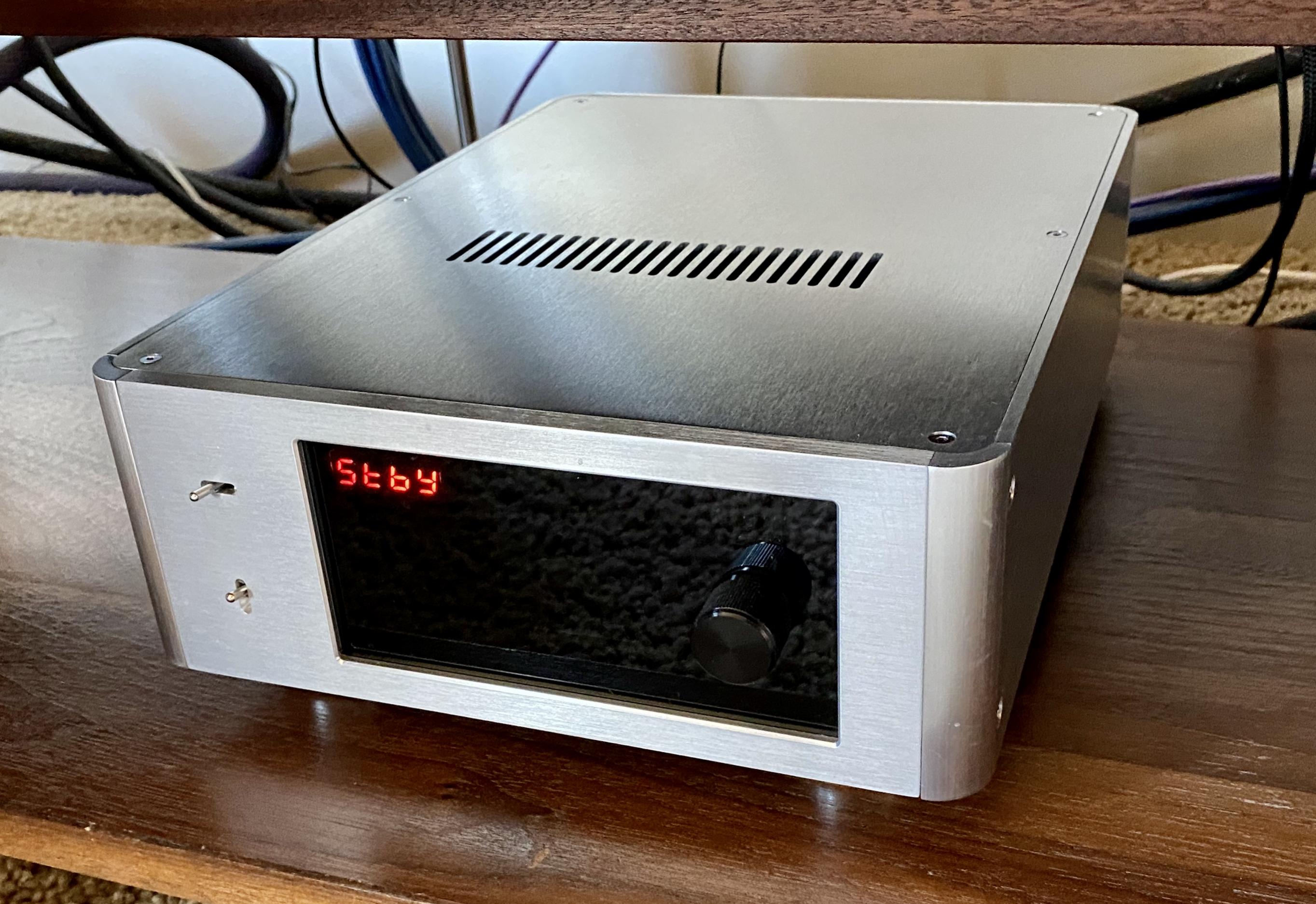

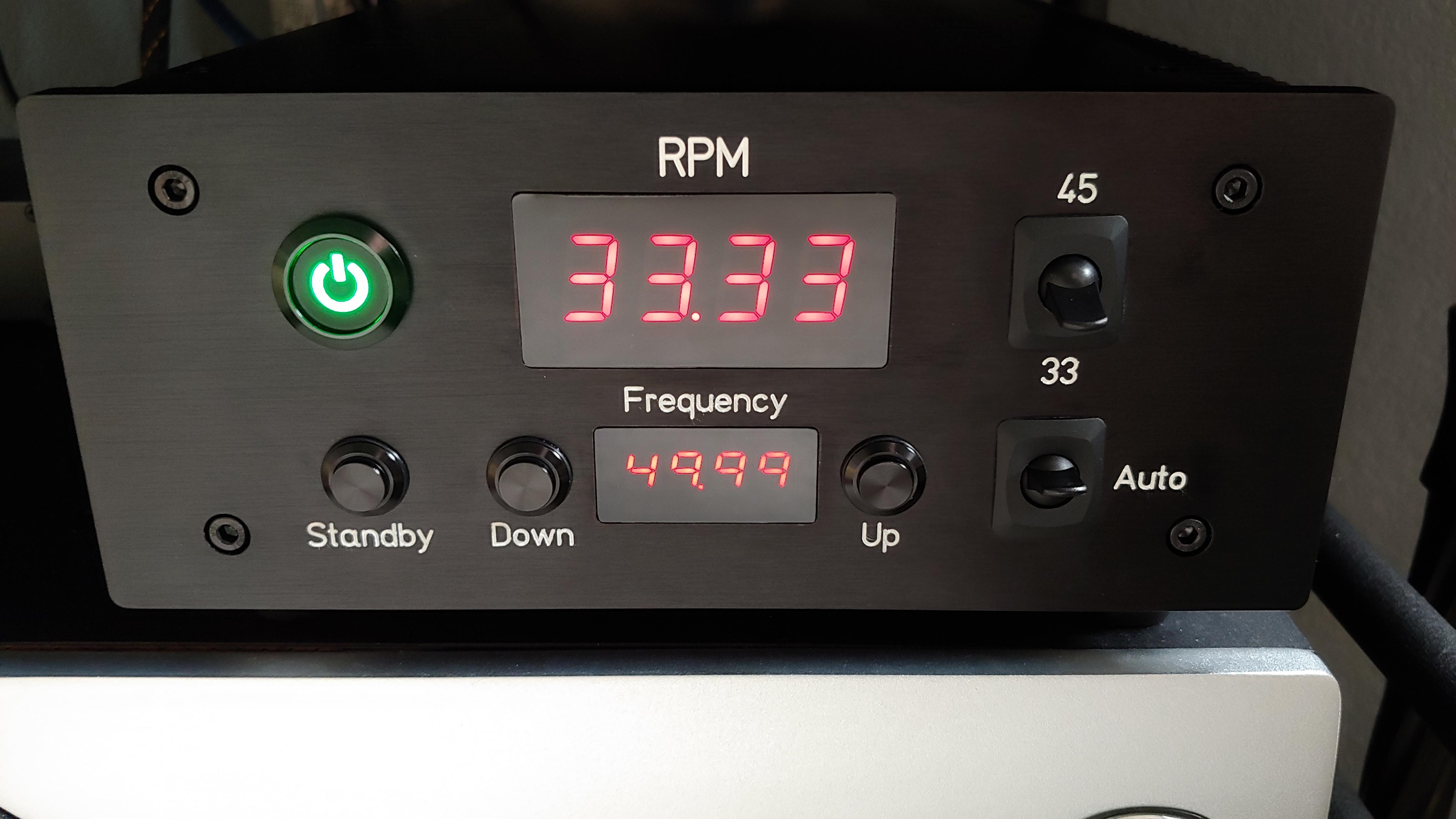

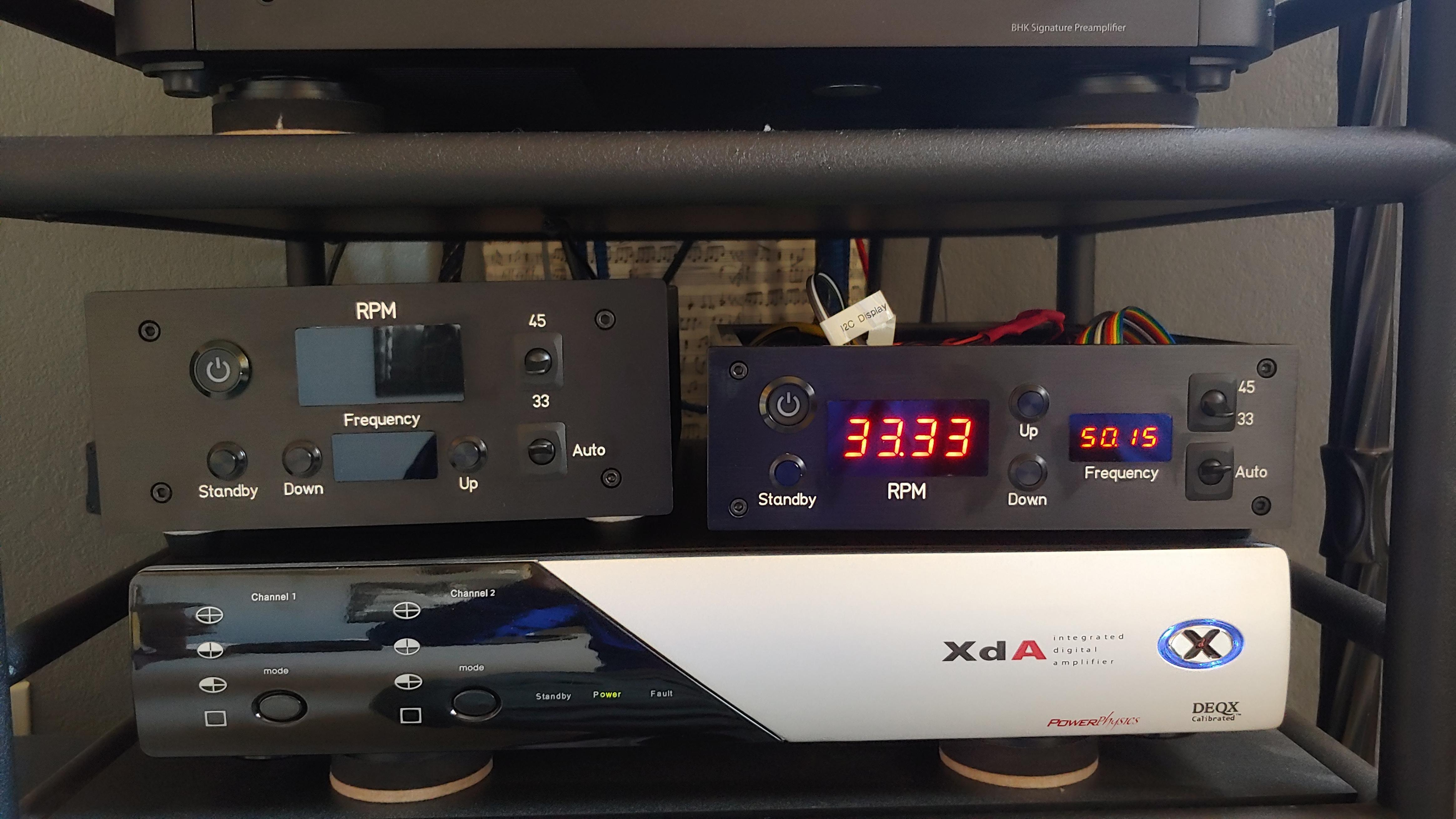

Finally finished my combined tachometer and SG4 motor controller! Got the front panel back from Front Panel Express. The enclosure I used was overkill with heatsinking, but it sure was nice to have an 8mm thick front panel that I could countersink 3mm acrylic for the displays.
It runs cool and works great managing speed. Thanks again to Bill and others who contributed time and code.
Anyone want to tackle adding a stylus timer?
I have also attached the latest code (Tach_7Seg_R7) consolidating changes covered in various posts.

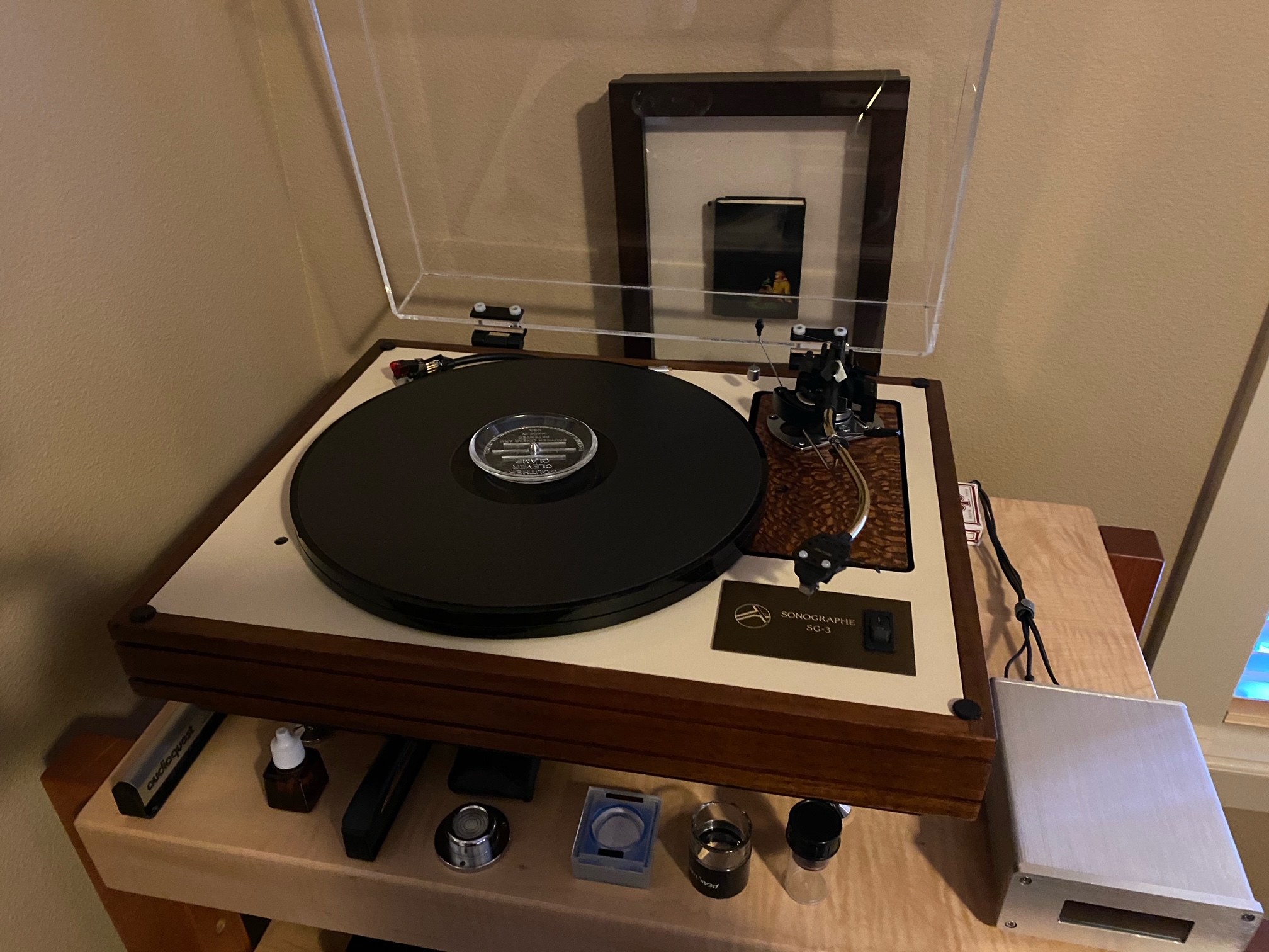

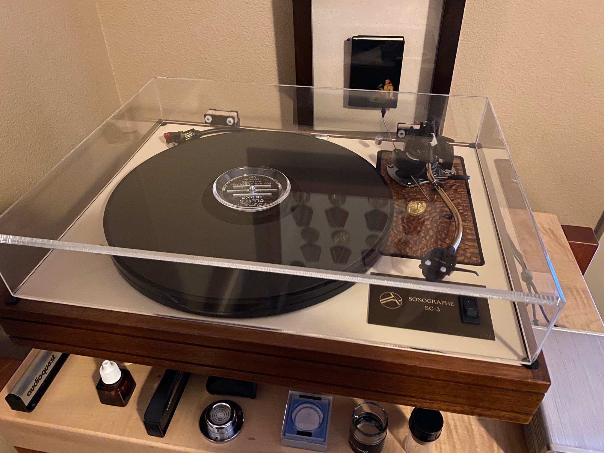

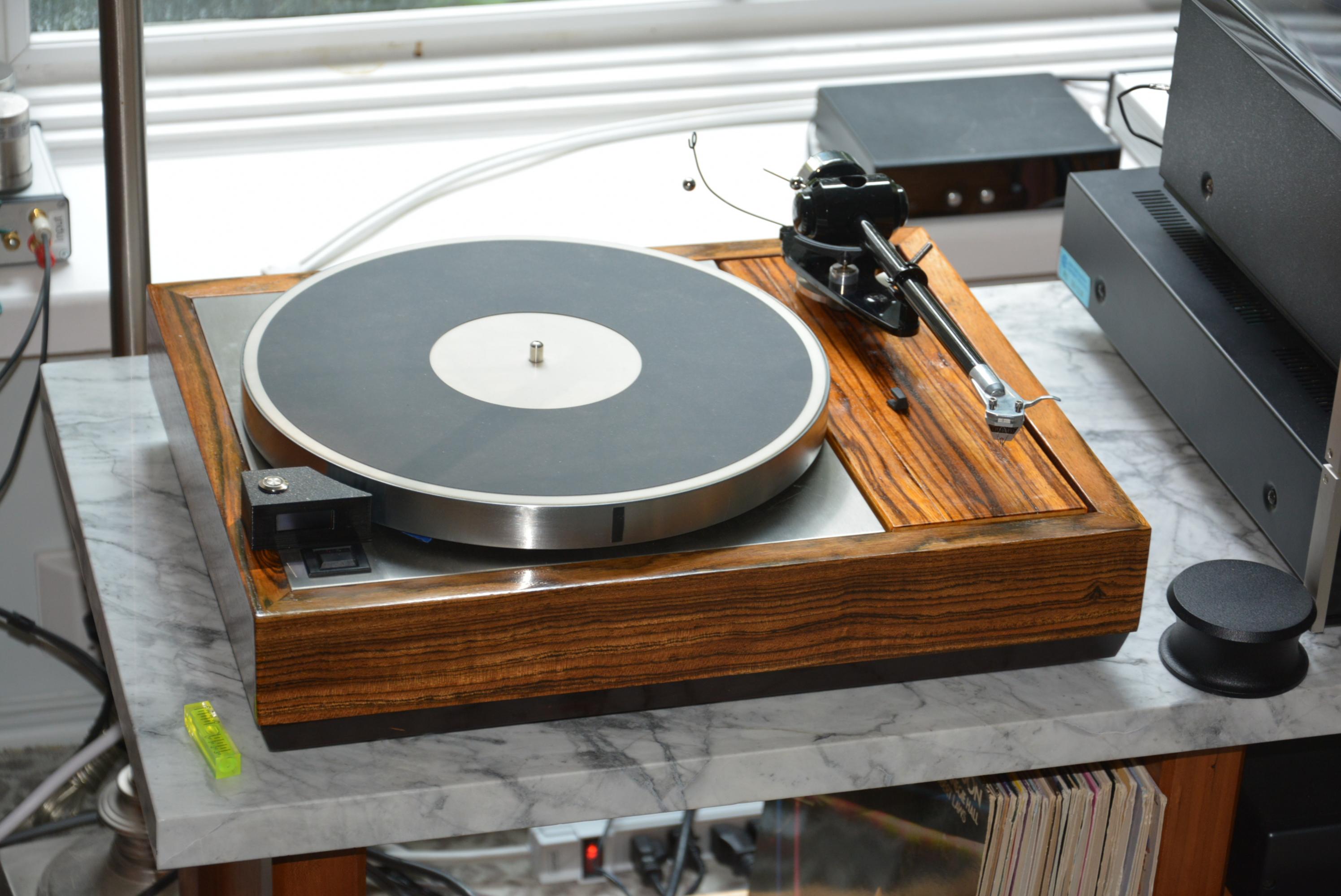

Hi Robert,
My TT is Conrad Johnson Sonographe SG-3. I fully rebuilt it and Premotec 31813 motor replaced old Hurst. I use kp = 1, ki = 0.4, kd = 0.2 now. It is Ok, but I see some overshoot time to time. I assumed that 0.9 or 0.8 for Kp might help.

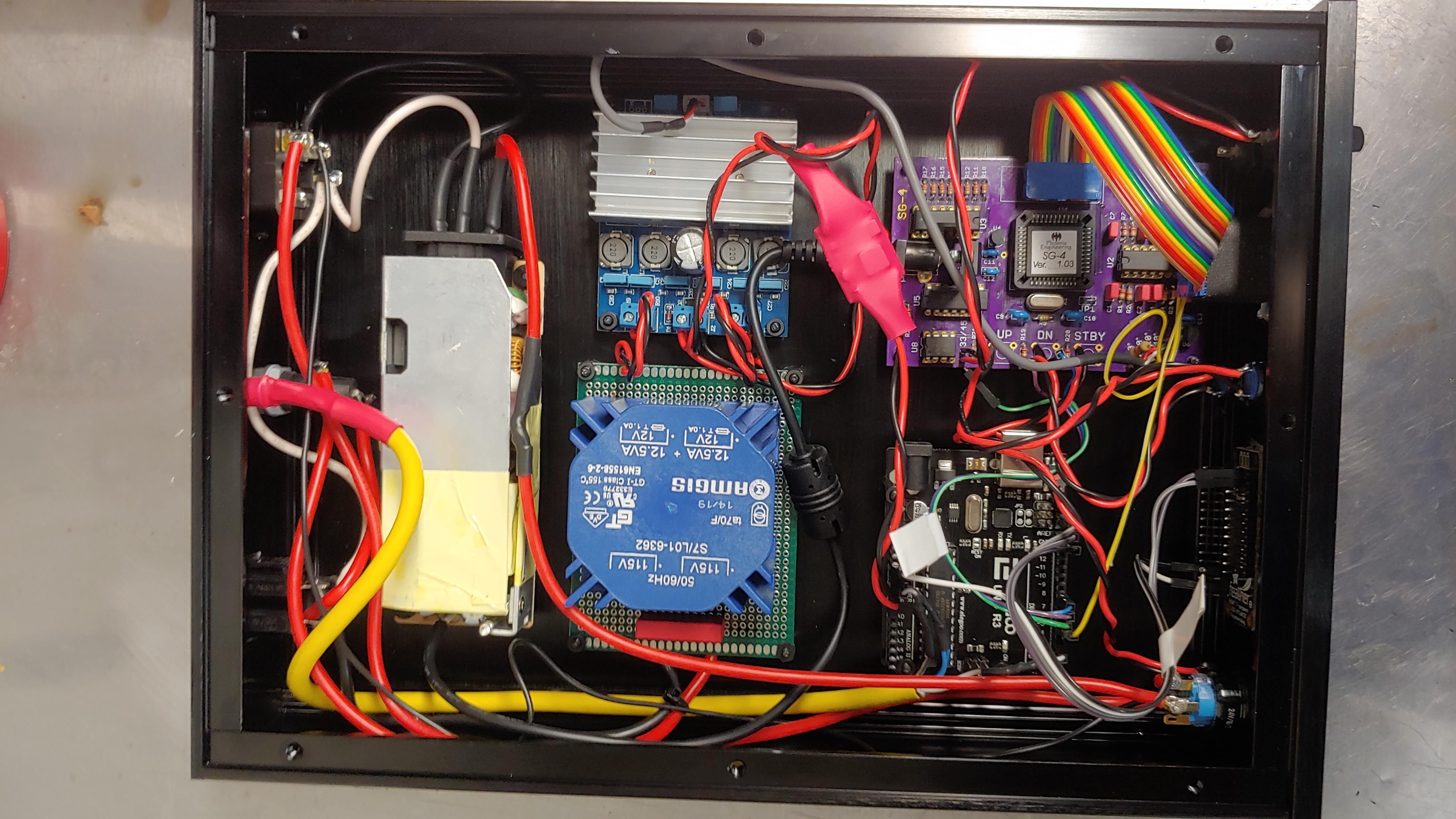

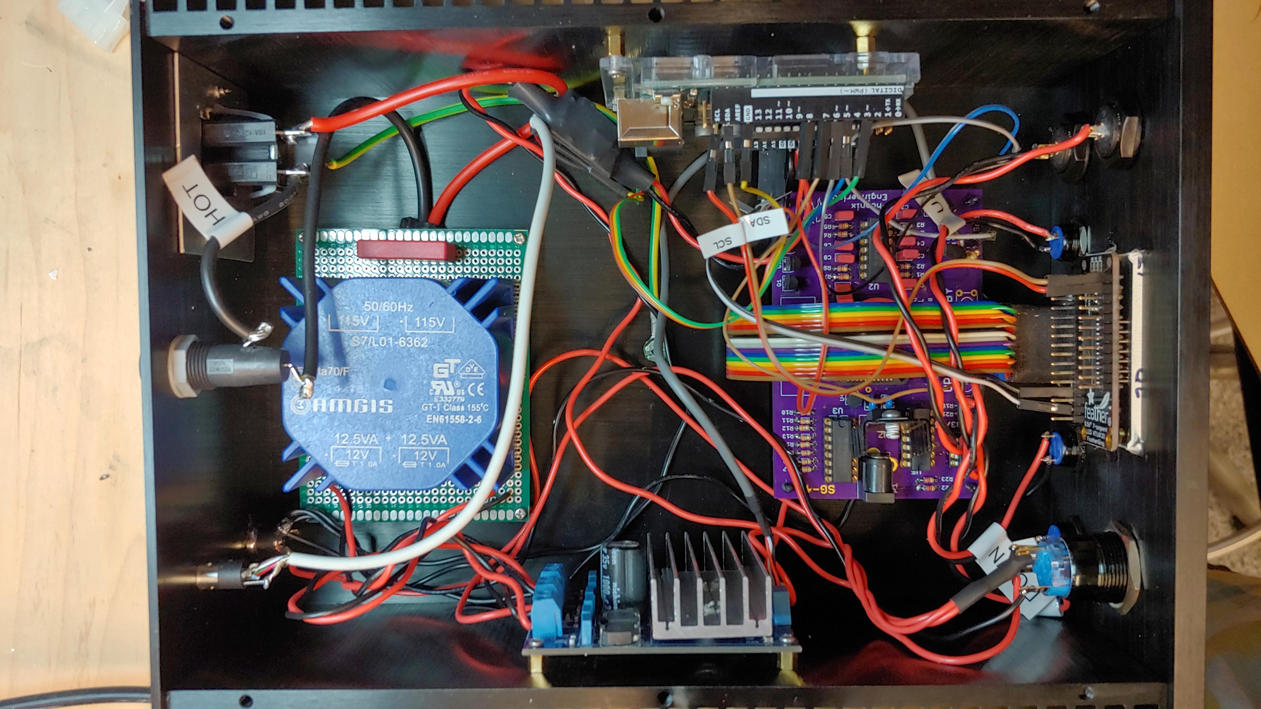

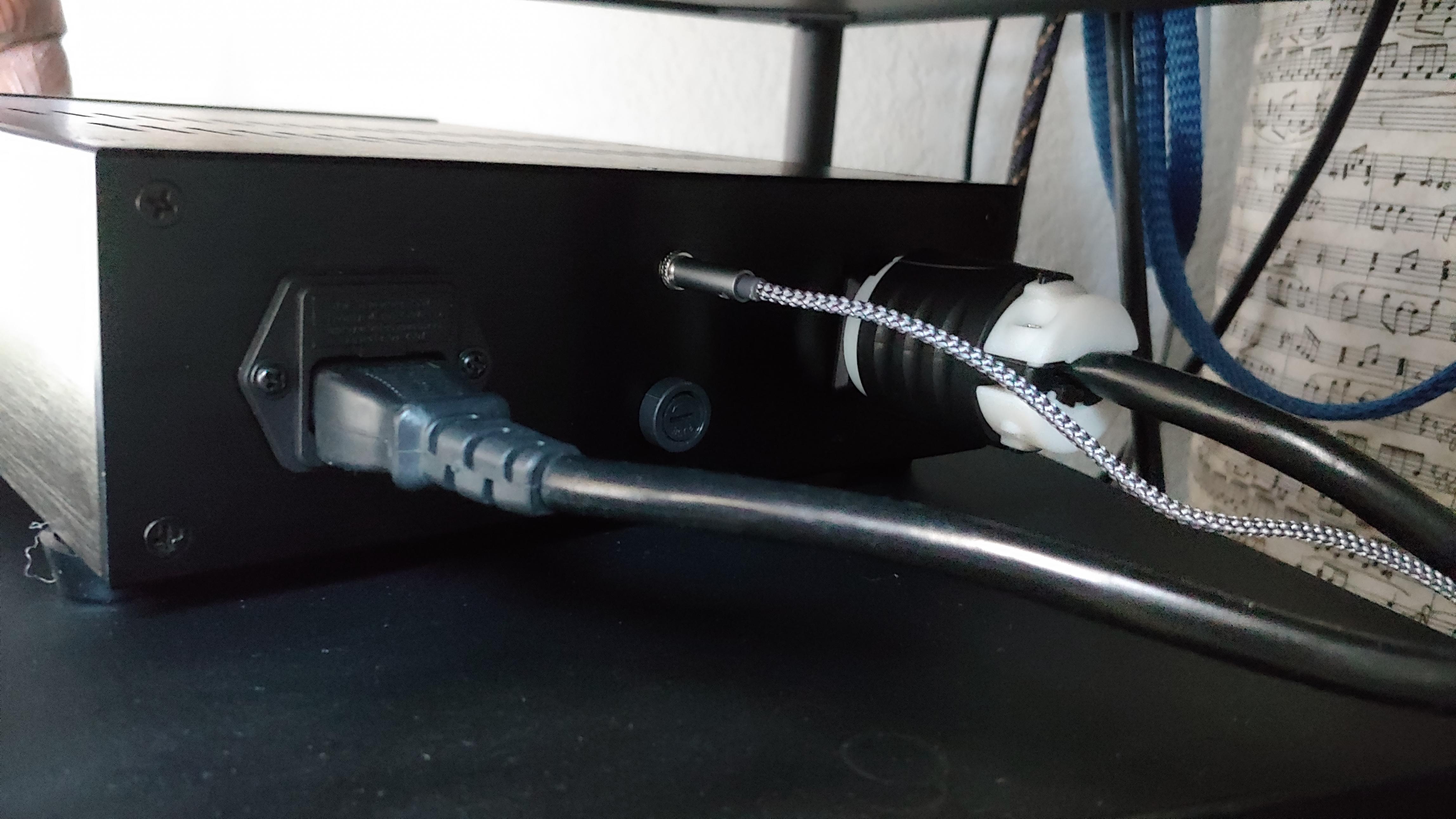

So I decided to build a second unit and refined the physical design a bit more. I stripped the covers off and built the power supply into the chassis so now I have an IEC connector for input power. The rest of the internals are the same. The case is slimmer with no unnecessary heat sinking. I used Front Panel Express again for a professional look.

Excellent implementation. I wish to have company near me witch can be dealing with front panels millings. I use local machine shop and they are doing an excellent cuts, but quite pricey ($80 per hour).
Here is my box attached.
