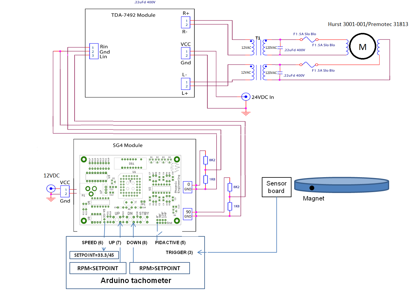

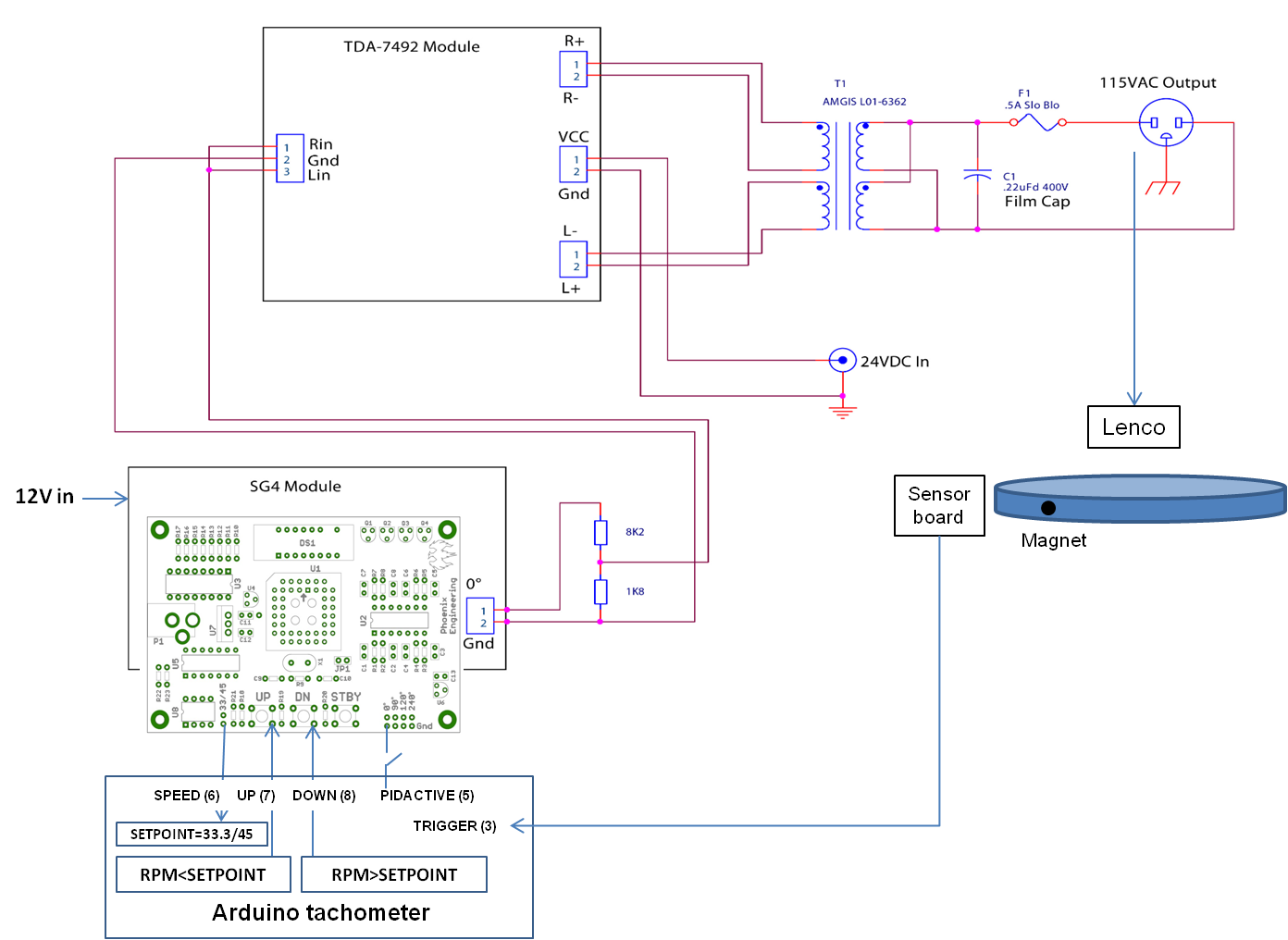

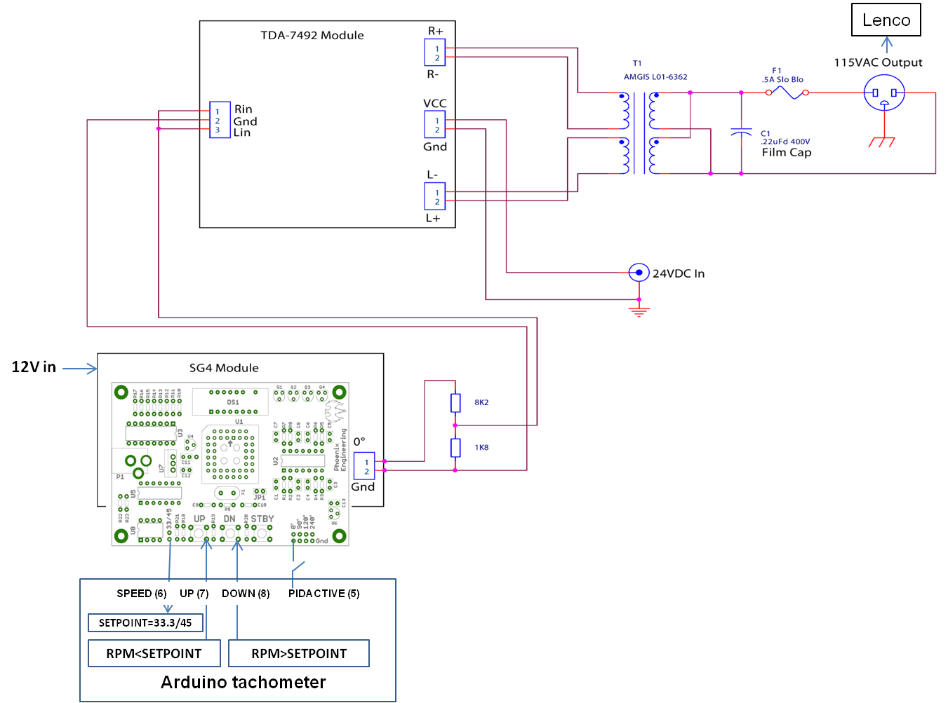

See attached. I use 4 Arduino digital I/Os, wired to the SG4 as shown in the diagram:
PIDACTIVE (Input, 5): I added a switch to be able to turn the auto correct software routine on/off
SPEED (Input, 6): Reads the status of the 33/45 switch to determine the desired SETPOINT RPM (33.3/45)
UP (Output, 7), DOWN (Output, 8): Arduino outputs that apply the speed correction pulses to the UP/DOWN switches on the SG4 board to correct to the SETPOINT.
Note that the pads to connect to are on the outermost edge of the board.
You can still use the SG4 switches to manually adjust the frequency, either when the autocorrect is running or switched off.

I revised the diagram, adding the tach sensor for completeness
I updated your diagram for phase-shift split motor run setup.

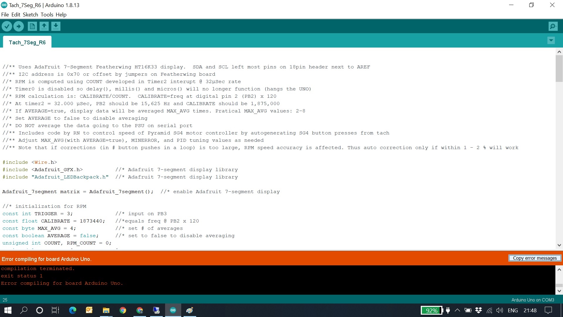

Also, have an error on your sketch during "Verify" (please see attached). What Arduino board is used there? I have Uno.

I think your sketch is updated correctly with my OLED display setting now, however I need to find some way to avoid lock due to interference with optical encoder circuit. Any advice is welcome. I can install some“OR” type of toggle switch, but it might be some more elegant solution already exist...
I added toggle switch to turn off encoder and enable PID. All is working fine now. Very promising and my compliments to you, robnik33!!! Excellent work!!!
