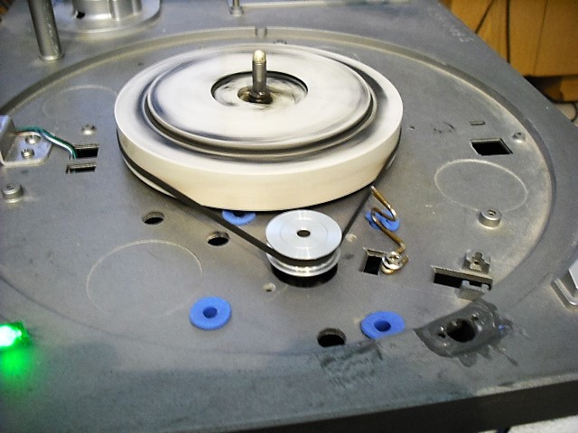

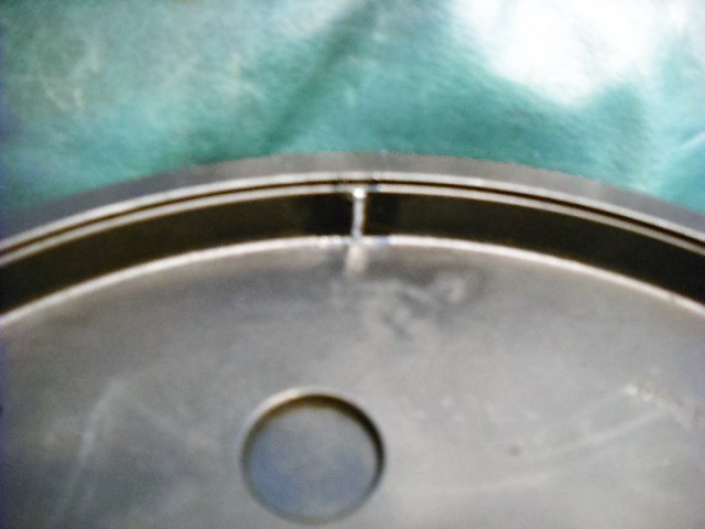

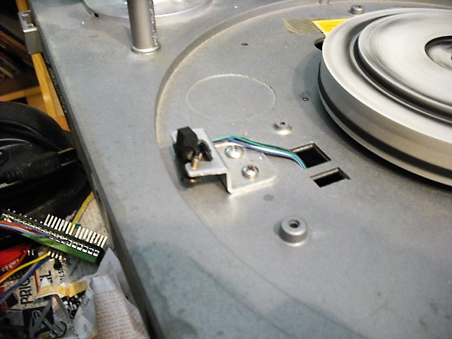

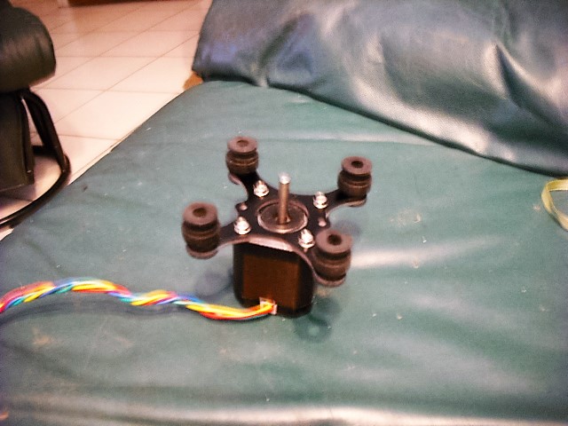

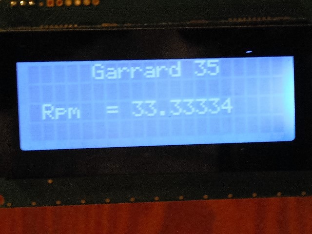

I built one controller to control the speed of a Garrard 35 turntable and it worked very good until I tried to paint it. It end the trash can. I used an optical infrared optical sensor to read the index reflection from a strip glued to the inside rim of the plate. I tried the hall effect but the magnetic field radiated from the stepper motor had some conflicted with the pulses. The way it works it is to read the time it takes one revolution and calculate the rpm then display it in the lcd display. The sound was very good and it keep the rpm on target. I used the stepper motor because they are cheap and easy to control using the pwm control. The only problem it is that I used the Zbasic micro and their software for the programming. It is an easy project to do using the optical sensor. Attached rea some pictures showing how I built it.

I used the Zbasic micro. They use the 328 same as Arduino but with a different bootloader. I think if you do not use the speed control you can modify the program for Arduino. I used the Photologig reflective object sensor part number OPB761 from Mouser to read the index pulse and then calculate the rpm by the time it is taking to completed one complete revolution. It is a TTL output sensor. I developed the software. It is a simple equation.

Correction the answered post was the function I used while doing the development. The following it is the final for more accuracy.
GetElapsedMicroTime(timeBuf)
GetElapsedMicroTime(timeBuf, timeBuf2)
The return value has units of the period of the frequency at which the TCNT register of the RTC timer changes, i.e. 1/F_RTC_TIMER (typically about 4.34uS for ZX devices). The value of Register.RTCTimer Frequency may be useful for converting the return value to seconds. The array must contain at least 5 bytes (6 bytes for xmega devices), populated by a previous call to
GetMicroTime(). The return value will range from 0 to the equivalent of about 15,000 seconds. A return value of &HFFFFFFFF indicates that an overflow has occurred, i.e. an elapsed time that is too large to represent.
Please accept my apologies for the wrong answered.
According to the ZBasic manual:
"If the RTC is not enabled in your application, the resolution of the delay period is 1mS. If the RTC is enabled, the resolution is the same as an RTC tick period, i.e. 1/F_RTC_TICK (typically 1.95mS for ZX devices)."
I'm assuming you don't have the RTC enabled so the resolution is 1mS; that seems to be the only way you would get a reading of 33.33334 (RTC ticks=1800). That would make your resolution ~0.0185 RPM (next highest reading is 33.3518, next lowest is 33.3148)?
If RTC is enabled, then the resolution is 1.95mS. Your readings would be 33.3913 / 33.3550 / 33.3188 for RTC counts of 920 /921 /922.
Edit after your last post: Using RTC_TIMER would definitely give you better resolution (~0.00008 RPM).

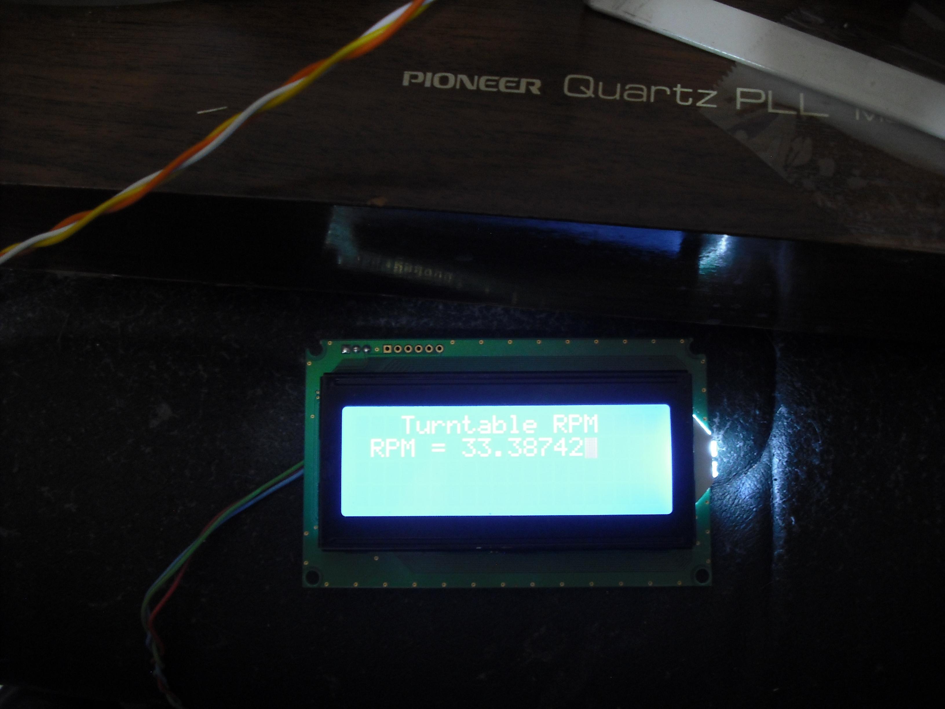

It is possible that the reading of 33.3333 was because I was adjusting the rpm to 33.3333 rpm by increasing /decreasing the pwd frequency. By controlling the rpm I was able to get the reading. I double check the reading with a tachometer and it was betting the of reading 33.333 since the meter just has 5 digits. Also when I reached the 33.3333 the neon strobe was locked showing that I was at 33.3333. I am not trying to show that your are wrong I just reporting the readings. Now, It is too late to try your suggestion since I dumped the turntable in the trash. I still have all the parts less the display in case somebody it is interesting to use it.

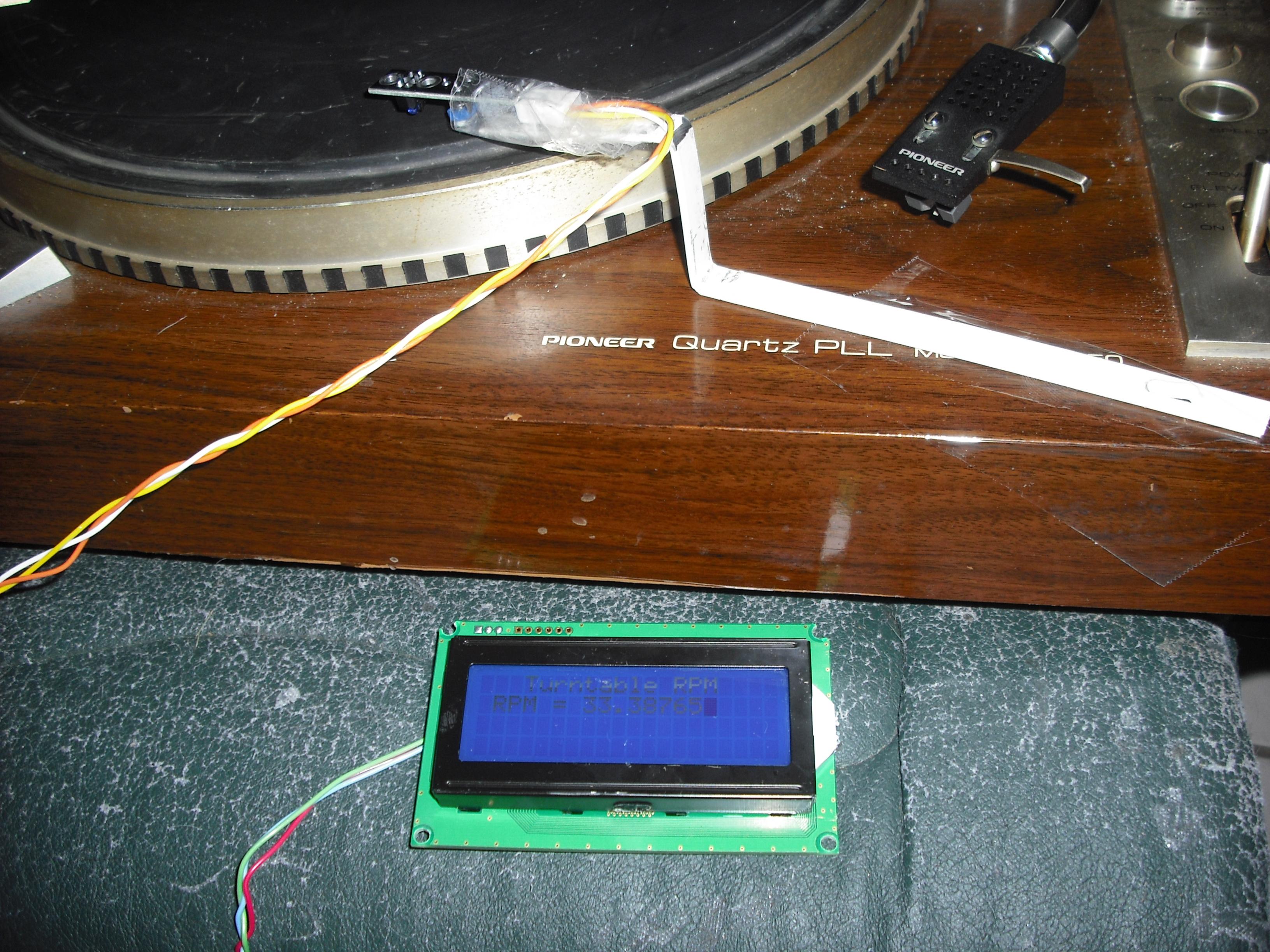

This is to let you that I converted my Turntable rpm display to run from Zbasic to Arduino UNO. For the sensor I used the TCRT5000 Single Channel Line Tracking Sensor Module and for the display from Mouser part number : 763-0216K3ZNSWBBW-V3. It is a 2 lines 16 character serial interface display. You can use any display since the display output can be modify/customize for the desire output message format. To get the pulse from the platen it require a reflective strip stick to the platen.
Attached are some pictures show my test jig using a Pioneer Turntable.
If your are still interesting please send me a PM so I can email the program.
