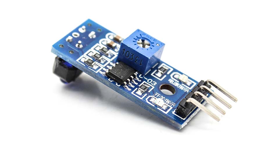

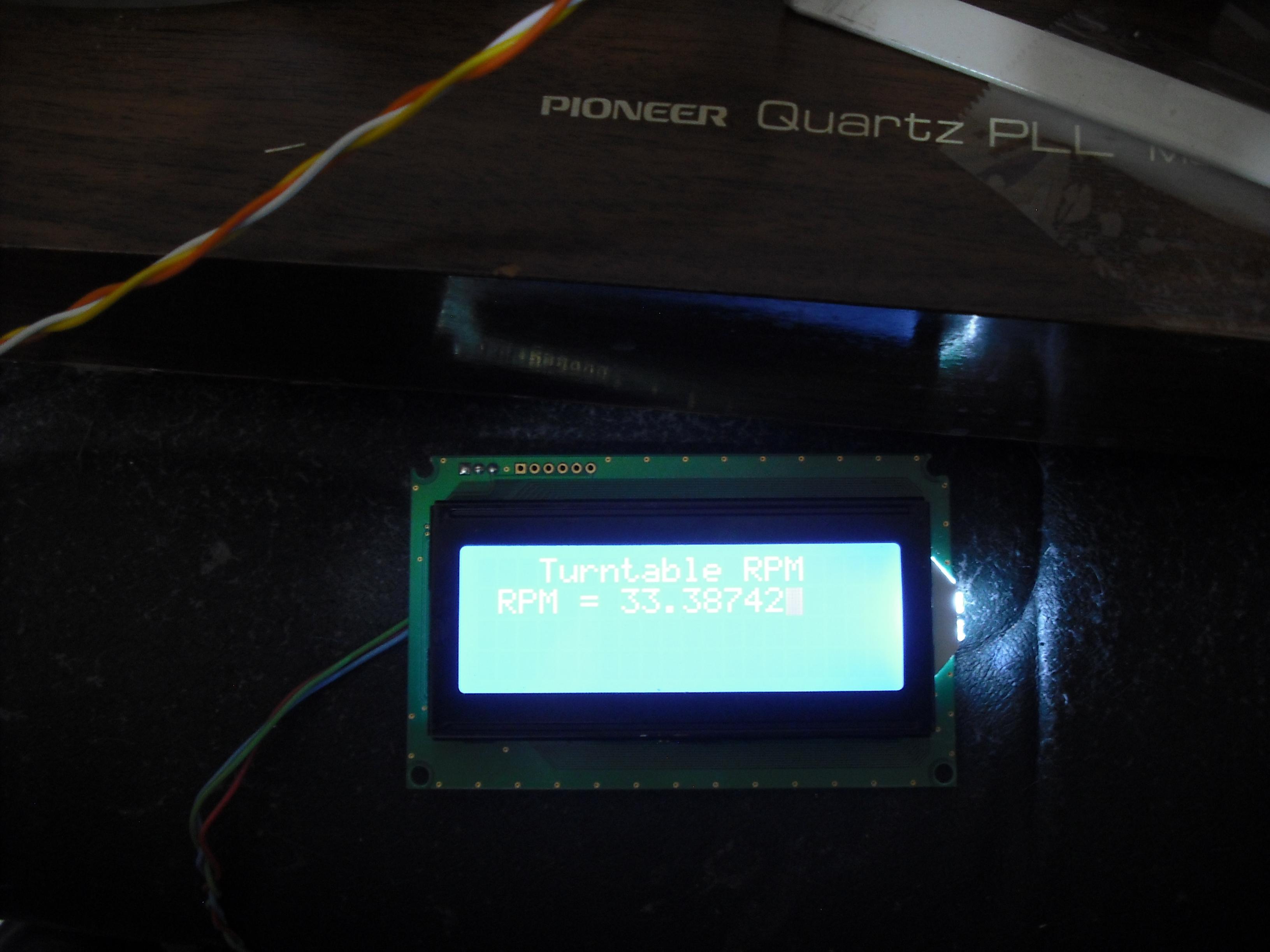

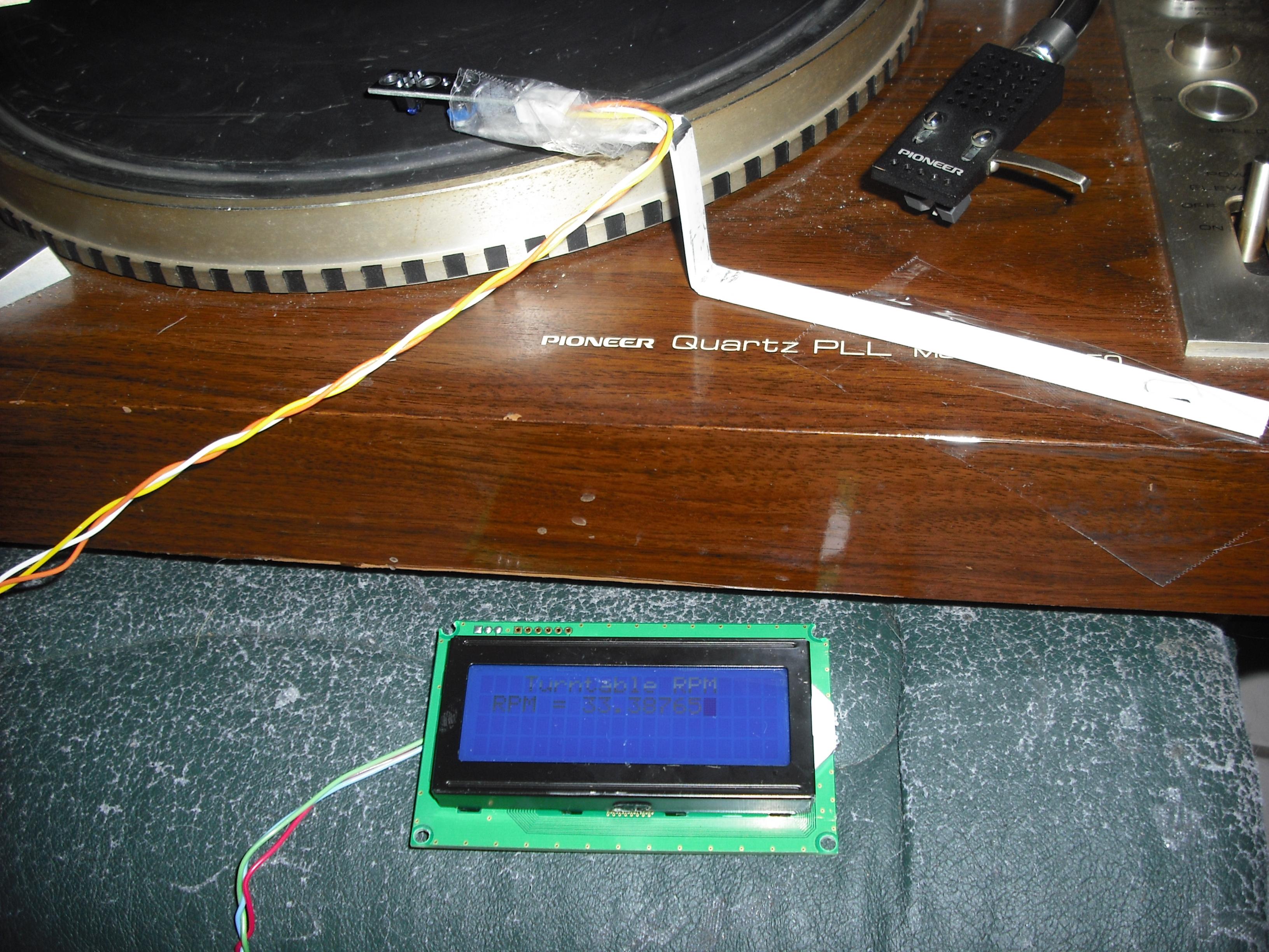

This is to let you that I converted my Turntable rpm display to run from Zbasic to Arduino UNO. For the sensor I used the TCRT5000 Single Channel Line Tracking Sensor Module and for the display from Mouser part number : 763-0216K3ZNSWBBW-V3. It is a 2 lines 16 character serial interface display. You can use any display since the display output can be modify/customize for the desire output message format. To get the pulse from the platen it require a reflective strip stick to the platen.
Attached are some pictures show my test jig using a Pioneer Turntable.

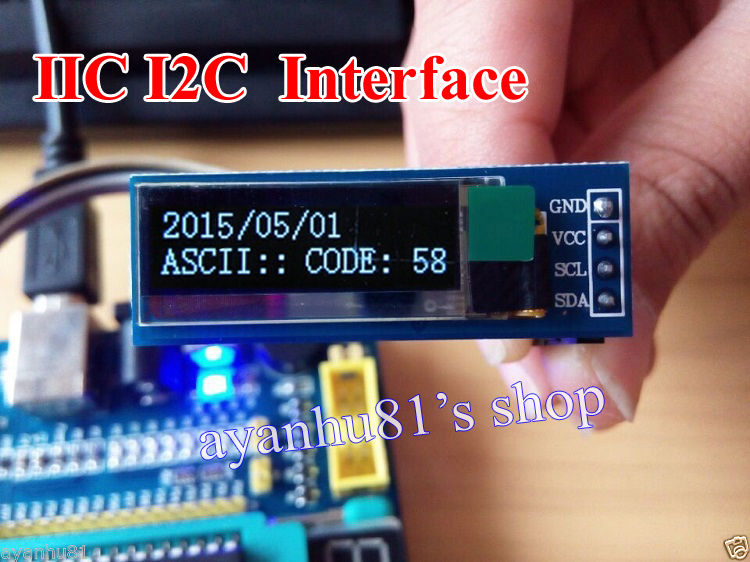

Hi All,
Very interesting project. I already have an Arduino Uno in hand and want to put it in use. Can anyone let me know what kind of sensor I need to get? And, I am wondering if I can use OLED LCD display like the one below.
0.96" I2C IIC SPI Serial 128X64 White OLED LCD LED Display Module for Arduino | eBay

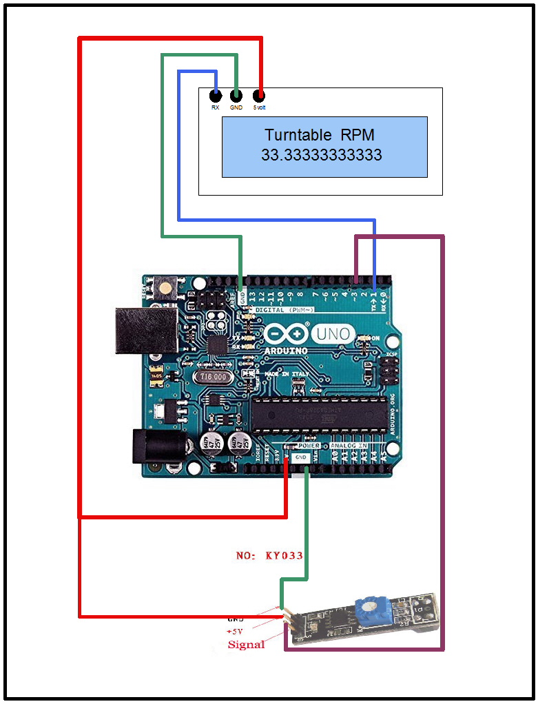

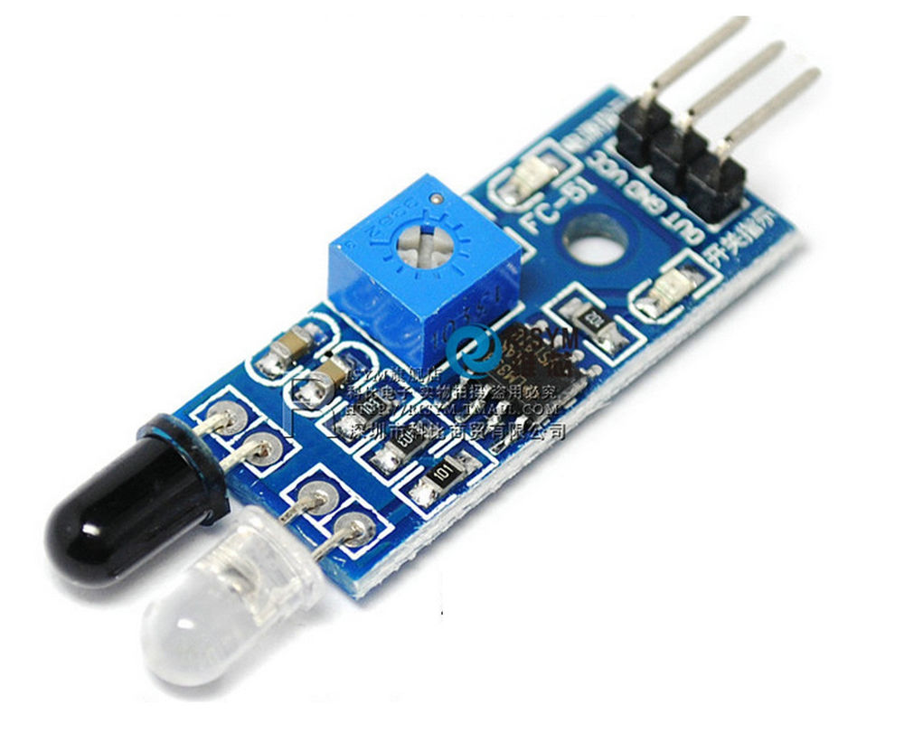

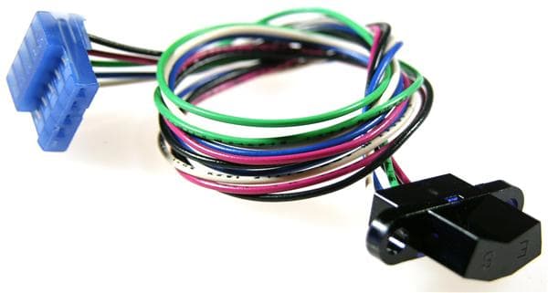

You can use any LCD display as long they have the Arduino library. The only problem it is how many character you can be display. There is another one that hold more characters in Ebay. Attached are 2 pictures showing the sensor and the display. You can use any IR Infrared sensor like tracking sensor tcrt5000 Arduino in Ebay. Some you can adjust the sensitivity some don't. I used the one from Mouser but the ones in Ebay are cheaper.
In the original project design using the Zbasic micro I used the Mouser Part No. 828-OPB770TZ $6.32. Now in the conversion from Zbasic to Arduino switched to the IR infrared obstacle avoidance sensor module for Arduino. It's cost just 2.00 dollars in Ebay. Do a Google or Ebay using the above description for the IR. Also it's easy to interface it to the Arduino just 3 wires. The one from Mouser it is 5 wires. My recommendation is to use the 3 wire and you can adjust the light sensitivity. Later will post the program upgrade version using the 1 inch display.
Attached are some pictures showing the prototyping for the Arduino conversion.

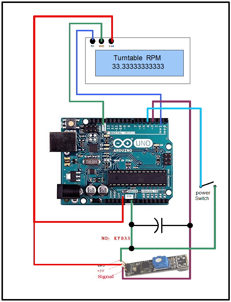

Dear Tauro,
First thank you for sharing the prototype with us.
As I plan to give it a try, could you please be so kind and give us also the value of the capacitor involved in the wiring diagram. Obviously a low voltage one will suffice.

The capacitor is a .04uf. for cleaning the pulses. It used an op amp to amplifier the pulses. The sensor from Ebay it is a little more noisy when you compare it with the one from Mouser. Try it at first without the capacitor and if the reading are not too stable make some adjust to the sensitivity to decrease the noise. If it does not fix it then proceed to add the capacitor. The Mouser sensor it is a schmitt trigger and it will put out a cleaner pulse. That it is why the difference in cost.
