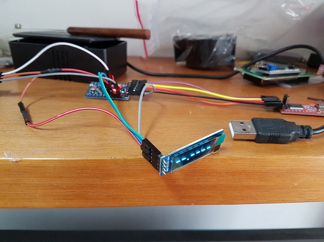

Now completely assembled into a small case, wireless, using a 9V battery and the sensor is also attached to the case.

Sorry, I forgot to explain about the four decimal digits "precision"...
When testing the OLED display I wanted to know the maximum number of large digits possible to show and ended up with 4. So, it has nothing to do with an enhanced resolution.
I will reduce to 3 digits when I assemble it in a definitive aluminum case to pair with the Falcon.

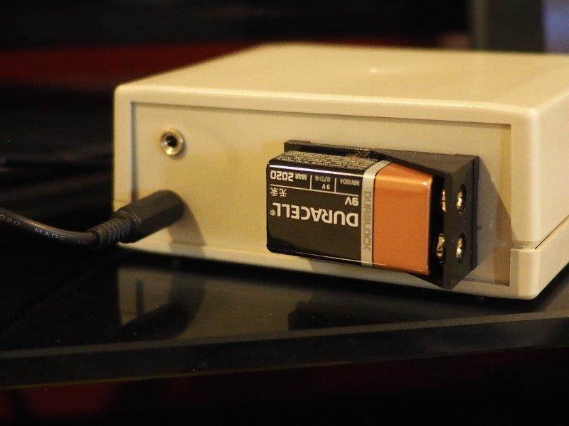

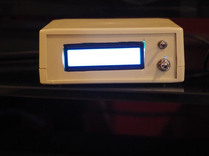

I thought I would post pictures of my implementation. Thanks again Pyramid, Tauro and all those who assisted getting this done for us.
I have 2 inputs at the back which are switched from the upper toggle switch on the front panel. The battery at the back is for when I move it to the other system. I use a wired snap on 9v connector wired to a female DC plug to go to a 9V plugback for normal use. I use a proximity sensor with a 3.5mm stereo plug.
The arduino clone, display and sensor cost me AUD30 The box and plugs another $20 or so.
Sorry about the display but it got lost in the glare. The display cutout was a bit of a hatchet job.
