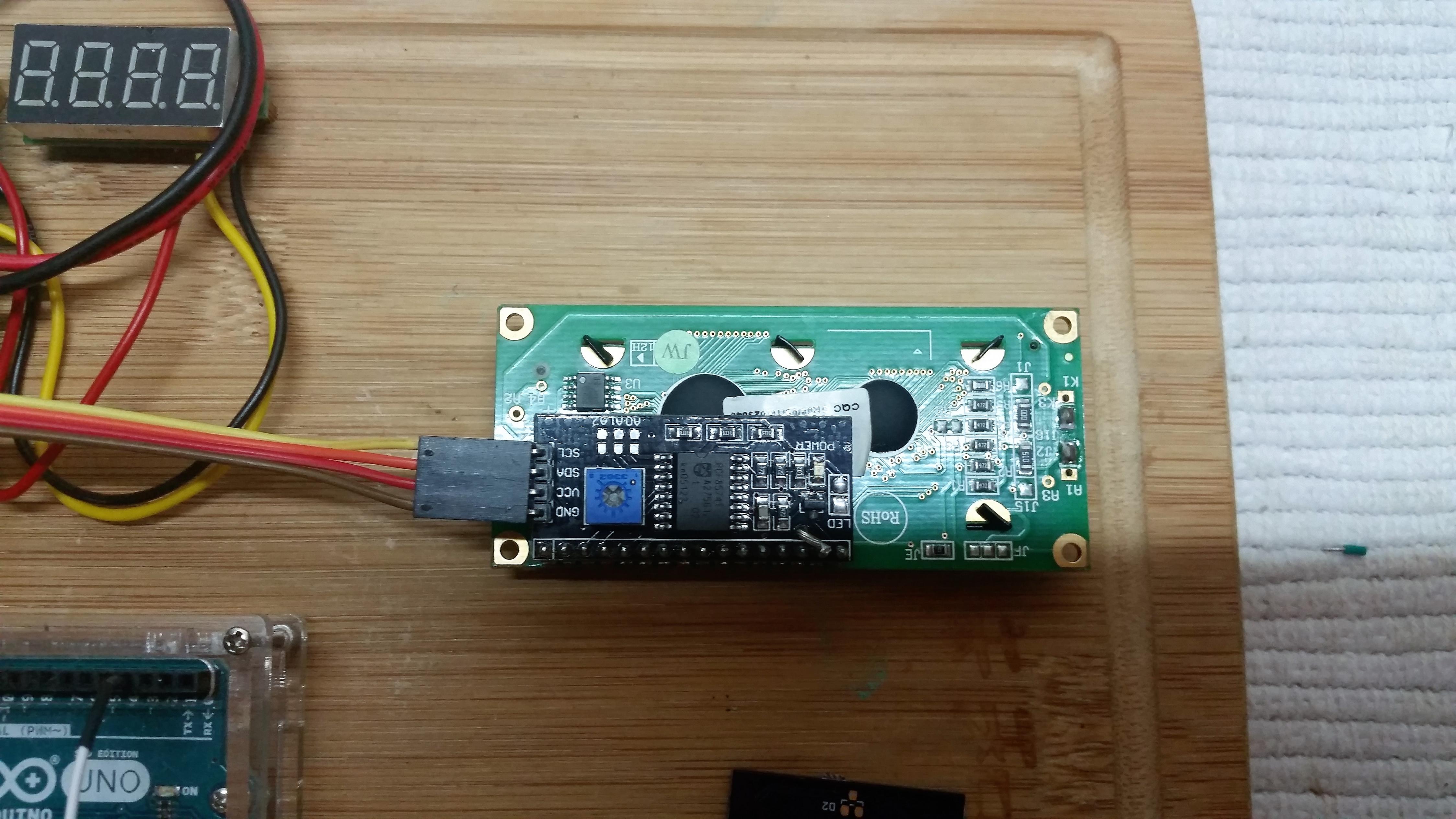

This is how I rigged up the Arduino/LCD with serial interface piggybacked to LCD/Phoenix Hall Sensor on a test bed. Its powered from a used old modem wall wart through a general purpose LM317 adjustable regulator.
I prefer the I2C Serial interface as it cut down on the number of wires needed to interface to LCD module. I bought a high quality LCD module and found it a little differently configured, I had to mod the I2C module to adapt to this particular LCD type referring to LCD product data sheet. If I had slapped it on without the mod, the LCD module would have fried in 10 seconds.

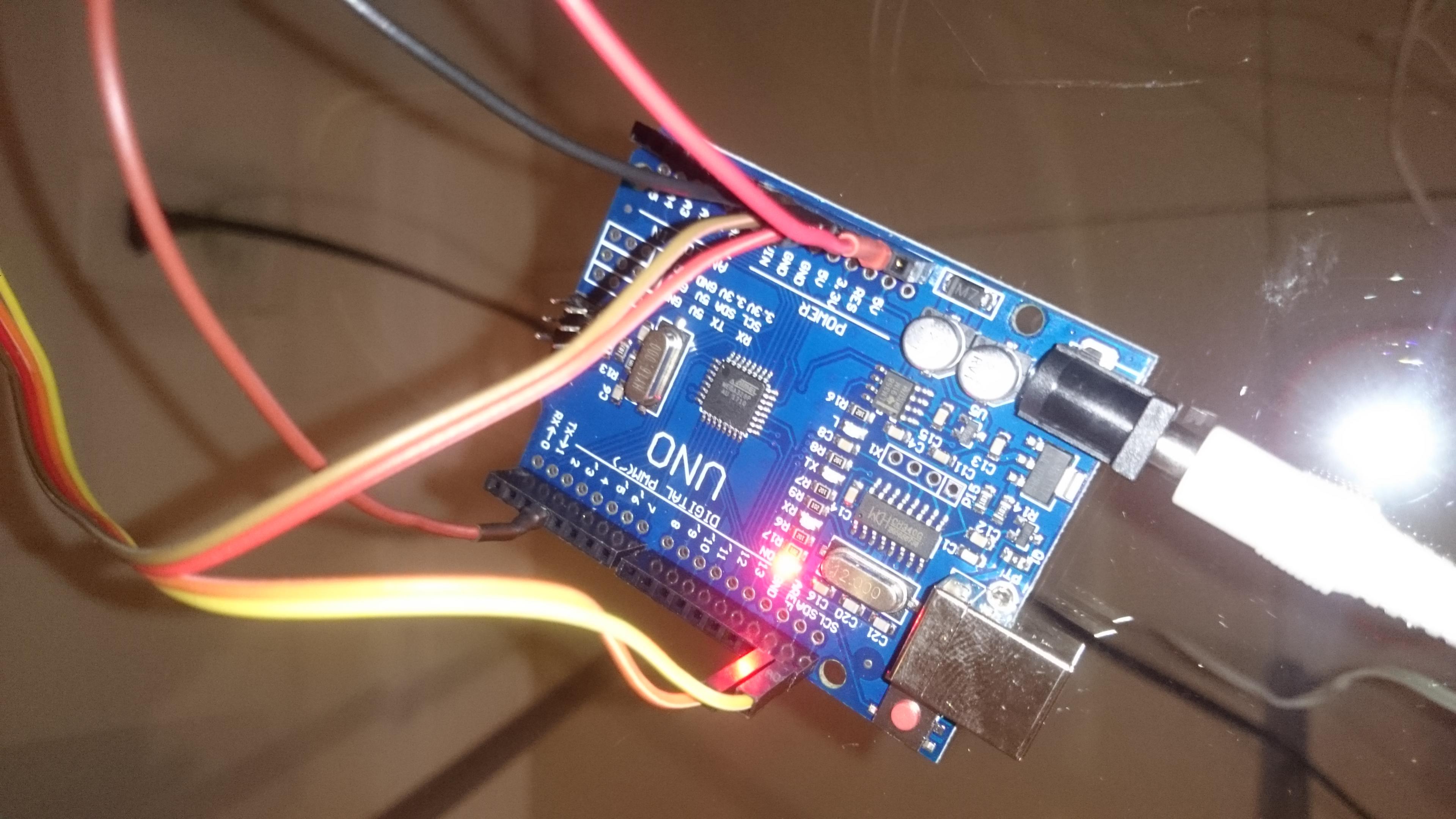

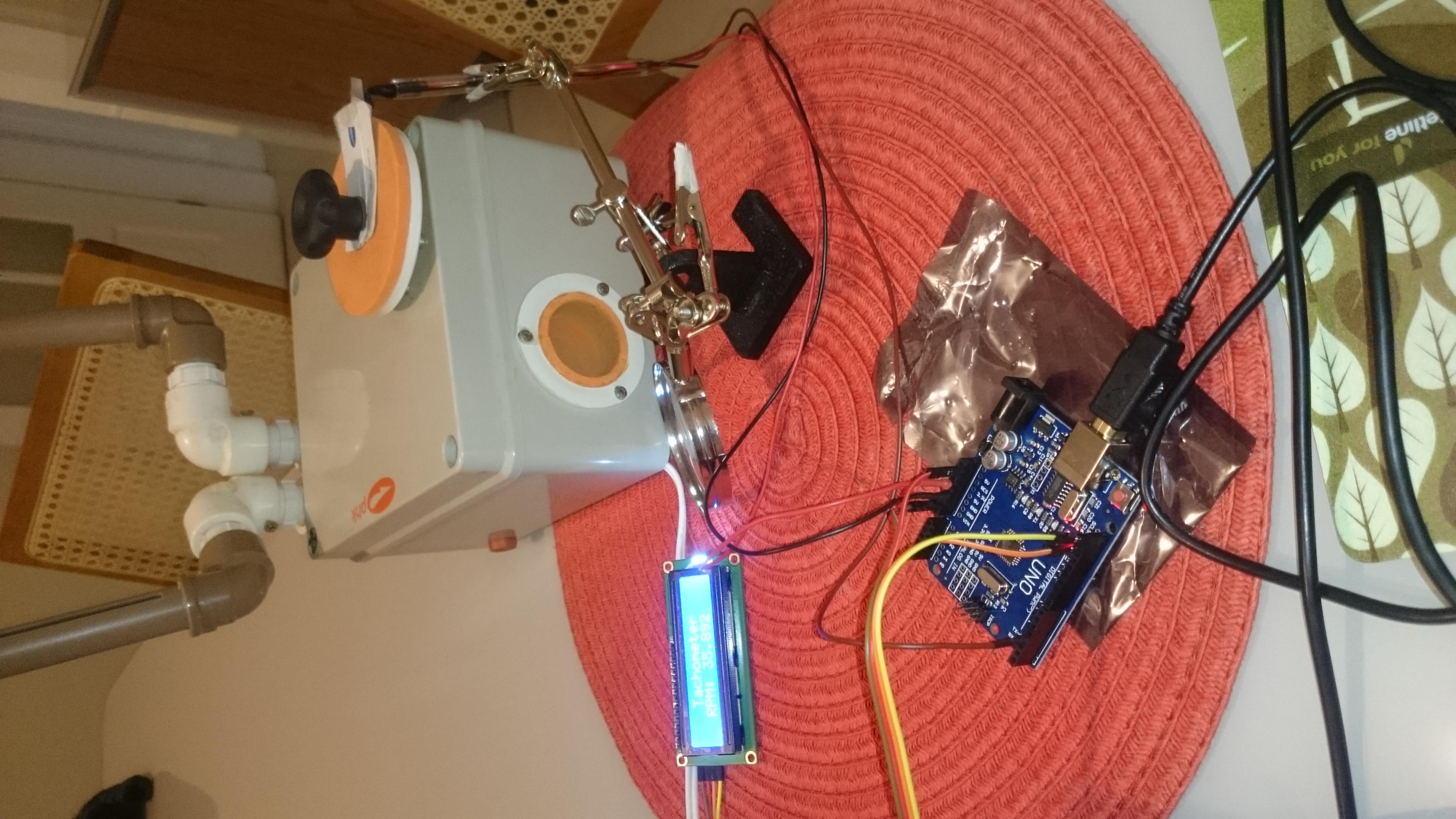

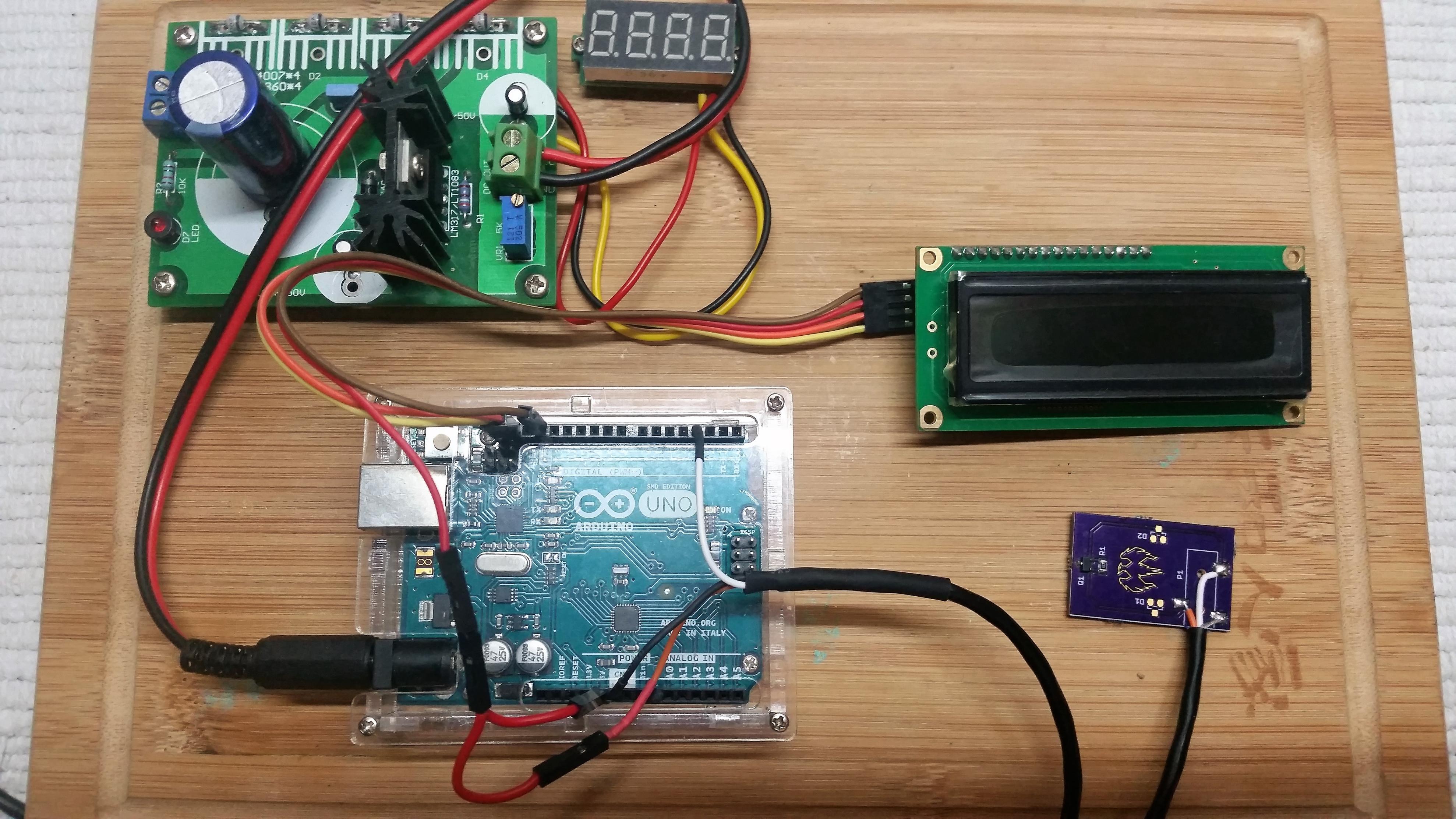

Hello,
I'm trying to build this tachometer but I'm getting wrong readings.

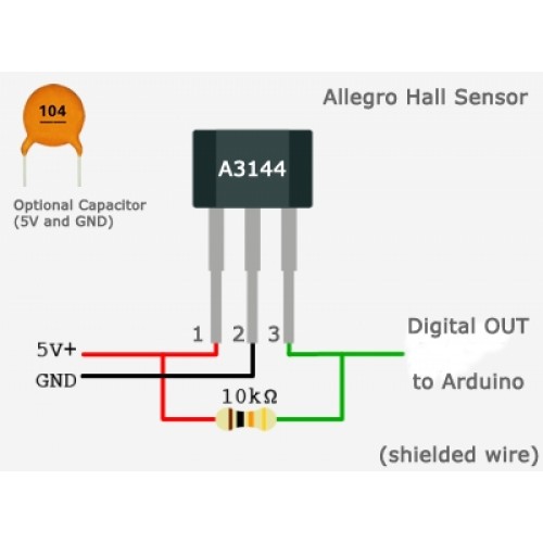

I've build the sensor using a A3144 hall sensor, a 10K resistor and a 104 capacitor, just like the picture attached.
I'm using a 16x2 LCD with a I2C module, connected to SCL, SDA, 5V and GND on the uno board.
The sensor is connected to digital pin 3 (signal), 5V and GND from the uno power section.
I'm using a low RPM motor (from a record cleaner machine, because my VPI motor isn't operational right now). Using a stopwatch and the RPM calculator app I get around 6 RPM (from both methods) as you can see on the picture attached.
The arduino tach displays an average RPM of 35.7
This is the code I'm using:
The arduino UNO board I'm using is a clone (UNO R3 MEGA328P CH340G), with 2 cristals: one rated 12.000 near the USB port and one rated HY16.000 near Mega328P chip.
I tried to find how to get the frequency at pin 2 but I could not find anything online (this is my first time with arduino and programmig).
What can I do to fix this? Thanks!

You need a faster motor. The timer ISR is incrementing a 16 bit counter 31250 times per second. It assumes the platter is turning between 28 and 100 RPM. If it is turning 6 RPM, that is 10 seconds per rev. In that time, the 16 bit counter will overflow and wrap around several times giving a false reading. If you are reading 35.7 RPM, it is taking 10.068928 seconds to make one rev (5.9589 RPM). The 16 bit counter is overflowing 4 times plus a count of 52521 which creates a reading of 35.7 RPM. This could probably be trapped to prevent this from happening, but just use a motor that produces a reading in under 2.5 seconds and the display will read correctly.

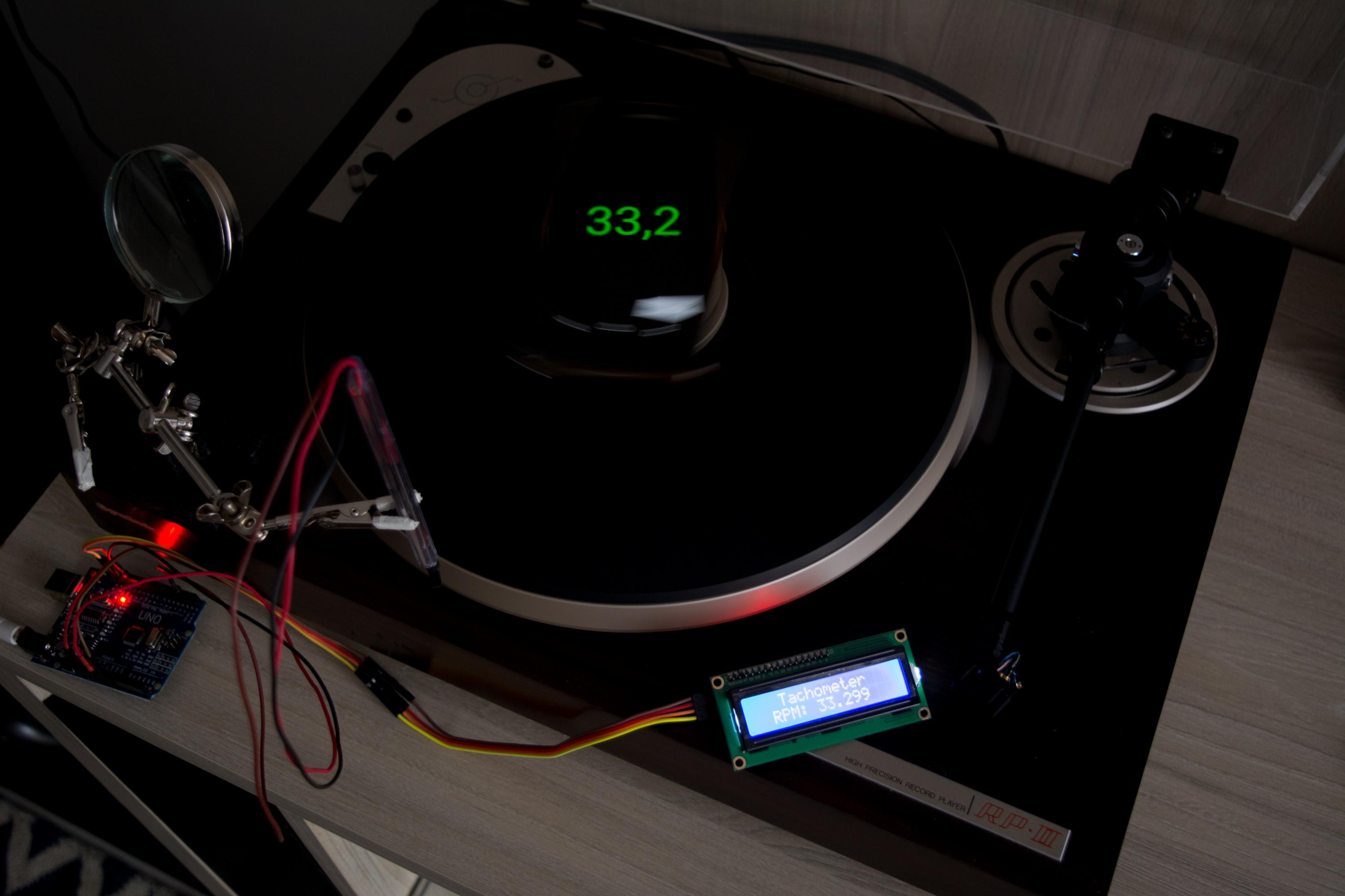

Thanks Bill! For a moment I thought something were wrong with the arduino I bought!
I took my previous turntable from where I had it storaged and tested! I'm now getting right measurements! At 33.3 rpm the tachometer displays 33.299 and for 45 rpm it displays 45.1.
This turntable does not have pitch control, so I fine tune its speed by passing electrical tape around the subplatter... I'll see what I can do to get a little more precise!
Now all I need is a nice case and some tweeks like a on/off switch.

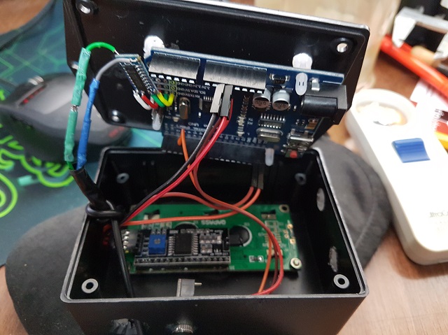

Thanks for the suggestions, Packgrog.
I already bought a case, it will be a simple black project case made of aluminium. For the switch, I'll use a toggle SPST!
You could also use the RR sensor with Hall Effect IC.
Q1 is the AH337 sensor IC SOT23 package. Digikey PN: AH337-WGCT-ND
D1 & D2 are 5V zeners SOT23 package Digikey PN: BZX84C5V1-FDICT-ND
R1 is a 1.0K 0805 resistor Digikey PN: P1.0KJCT-ND
P1 is a 3.5mm RA socket Digikey PN: CP-3523SJCT-ND

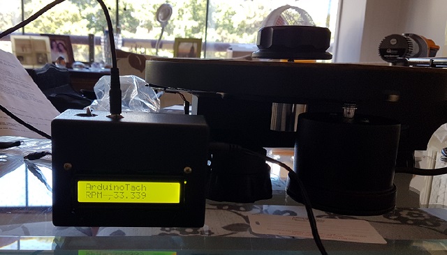

Hello Bill,
I finished the tachometer, just need to find a good case for it now.
But I noticed something on the sketch, at the lines that send the data to the serial output, the compiler showed an error that was easy to correct to this:
"Serial.print('\n');"
"Serial.print('\r');"
But, if both commands are sent, as expected, the serial output shows like:
33.333
33.333
33.333
But if I leave just the first command "[Serial.print('\n');]", then it´s like:
33.333
33.333
33.333
I guess the correct output for the Falcon is this last one, or do we need to have a blank line before each new measure?
PS: Now I noticed it´s a problem with the forum text editor... it "eats" some characters at the end of some lines!?!

Hello,
At last I managed to attach the completed prototype to my AVID Ingenium.
The results were suprising, I had no idea about how sensible is the adjustment of the belt tension, any "micro" adjust has a great influence in the measured rpm.
My Falcon PSU is still in transit from US, I hope the rpm data function from the TTL>RS232 board will work. One odd thing I confirmed about these Arduino boards is that unlike our audio equipment, where the output (usually marked as OUT) of a source must be connected to the input of the other equipment, with the Arduino boards (at least the one I tested) the TX signal must be connected to the TX of the destination board, not TX->RX. I don´t know how will this TTL>RS232 board work, must test with the Falcon when it arrive here.
I ordered a PRO MINI to miniaturize the project to match the Falcon size, when I tried to program it with a USB->TTL board, I realized that the only way is to connect TX->TX and RX->RX... strange...
Thanks to Bill and all other forum members for all the help with this project.
I consider it an essential device for anyone with a turntable that allows fine adjustments to the RPM, usually the strobo lights use the frequency of the AC line as a reference and this tachometer actually measure the rpm independent of the AC line frequency.

Hi Bill,
I did run the scanner sketch and got "'I2C device found at address 0x27 !
The board is actually a IDUINO UNO - pdf attached. It says A4 is SDA and A5 is SCL but also has SDA and SCL pins that are near to the AREF pin.
I will have another try when I get back from work today.

Are you aware that the sensor detects only one of the magnet poles?
Also, there are different kids of sensors, mine looks just like your picture but is labeled A3144.
It must be a unipolar (non latching) sensor, that sends a signal to the digital input of the Arduino every time it senses a south magnetic pole, and stops sending the signal when the magnet is removed.
The latching kind of sensor is different, it sends the signal when it senses a south magnetic pole, but only stops sending the signal when it senses a north magnetic pole.
Your sensor has other number, so it must not be unipolar, better check it´s specs.
