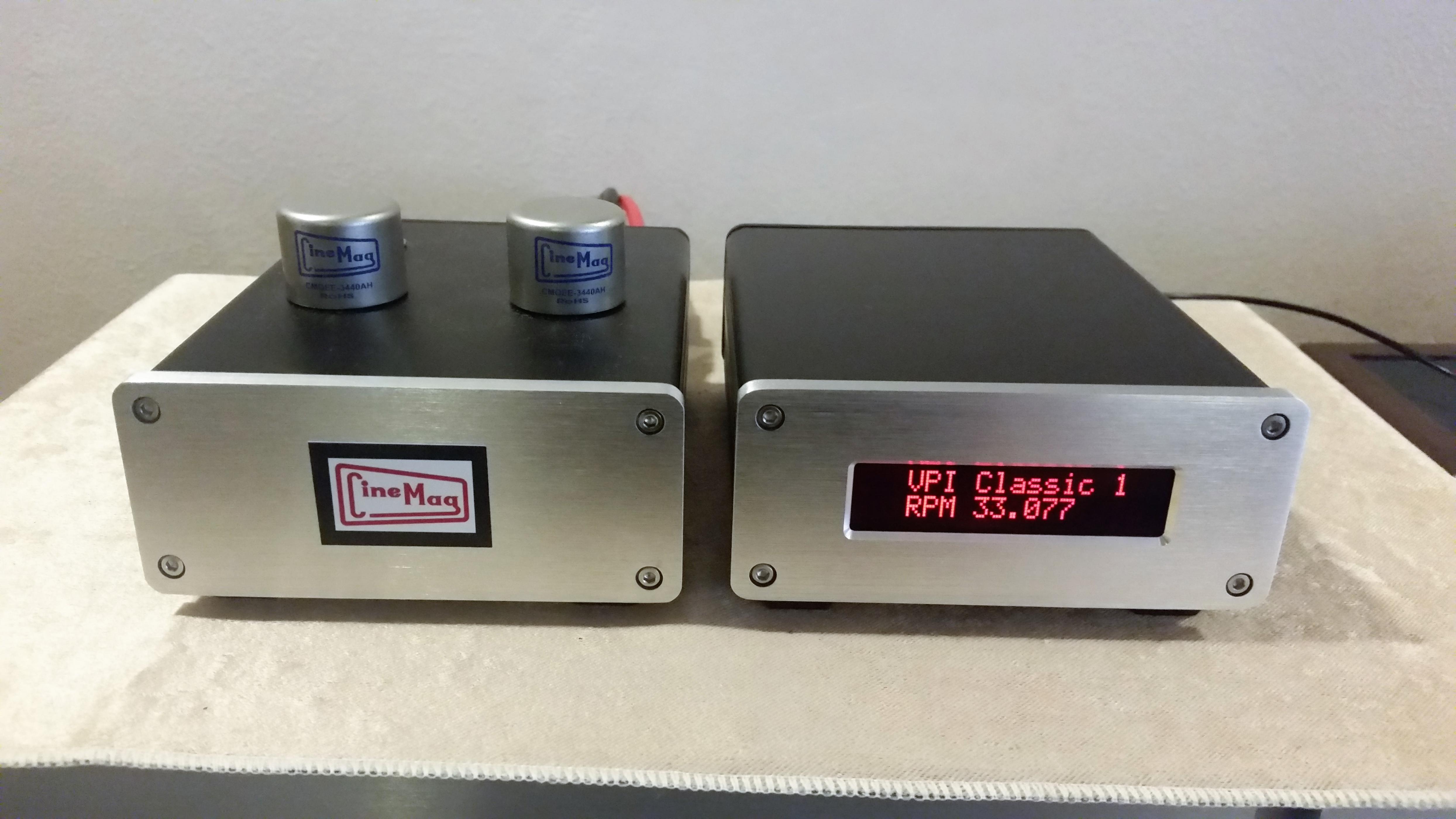

At last! its completed. Looking forward to SG-4 in January 2018.
That's the best looking tachometer I've seen to date.
What kind of display is that? Did you use a neutral density window in front of it?
Classic 1 table? You should post pics on VPI's forum....
Bill, Thank you very much for your kind praise. I'm very proud of my achievement and posted a picture of it on Facebook "I love my VPI turntable" group.
The display I used is a Midas MC21605G12W-VNMLR http://www.newark.com/midas/mc21605g12w-vnmlr/lcd-alpha-num-16-x-2-red/dp/52Y1050 Its a high quality display compared to the common and affordable China made LCD modules that I used during the course of construction and learning all about how it all tick. I was having 2 different displays that seemed similar, 2 different I2C modules that also look the same but they're not, learning what makes it tick and getting them to work. This involved changing hardware parameters in the code and modding the I2C to suit. It all worked out later on.
I didn't use anything on it and just glued the display module to the panel. I've found the display to be quite easy on the eye and have always liked red characters. I had to mod the LCD pin out to piggy back a common I2C module for serial connection for it to work. Its been a great learning curve with no past experience with any Arduino, LCD modules or programming these stuff.

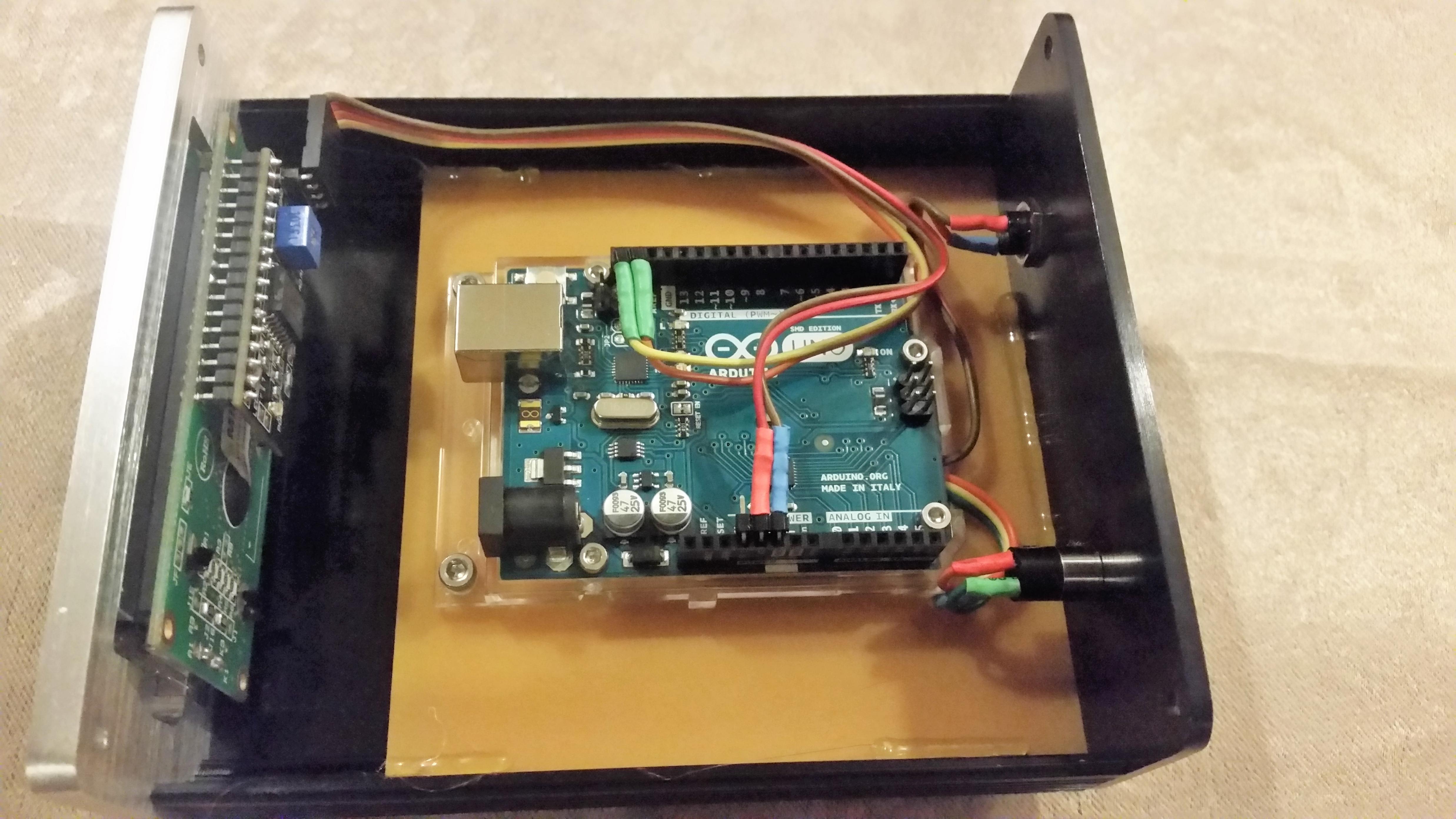

Here's a picture of the innards. I bolted the Arduino to a blank piece of pcb and slide into the enclosure. The DC power and sensor wires are soldered to the underside. I only have to remove the front panel for USB connection if need to program.
Nice work indeed, coolmaster! Giving me more ideas for boxing mine up so that I don't have the mess of wires sitting next to my motor. 😛
Maybe at later time, I will also solder the LCD wires to the Arduino underside, will look cleaner at the top side.
