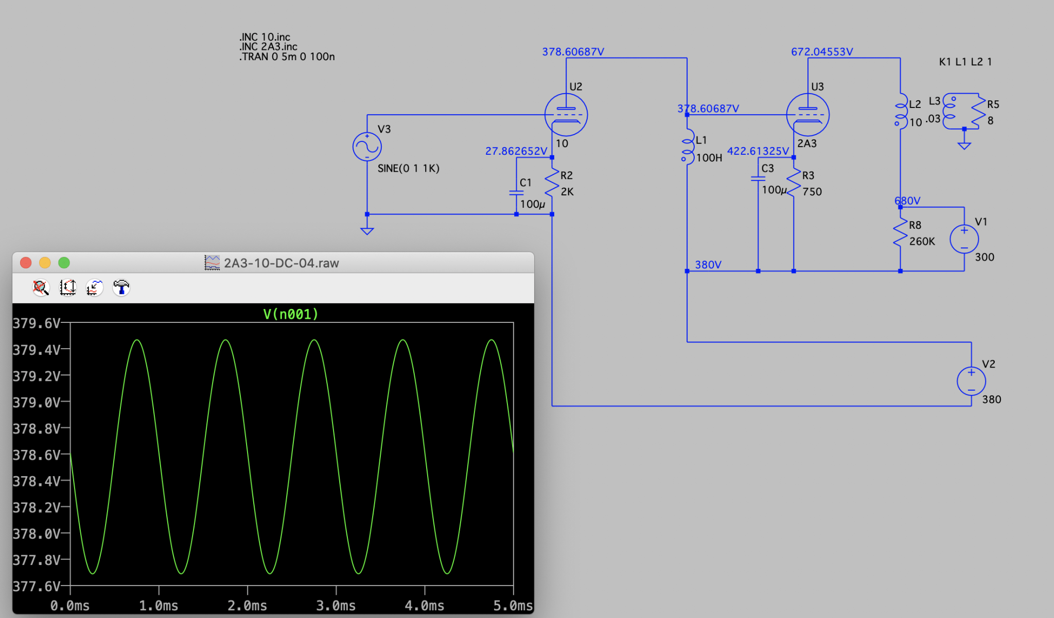

Playing around with the idea of direct-connecting a choke-loaded #10 to 2A3 with a stacked power supply, similar to the Komuro 300B circuit that choke-loads a 6V6 triode driver into a 300B. The operating voltages in this sim check out, but the amplification factor of the #10 is only about 2. In post #415, which had a choke-loaded #10 cap-coupled to 2A3, the amplification factor was 14.5.
Clearly I don't understand direct-coupled circuits yet. 😆

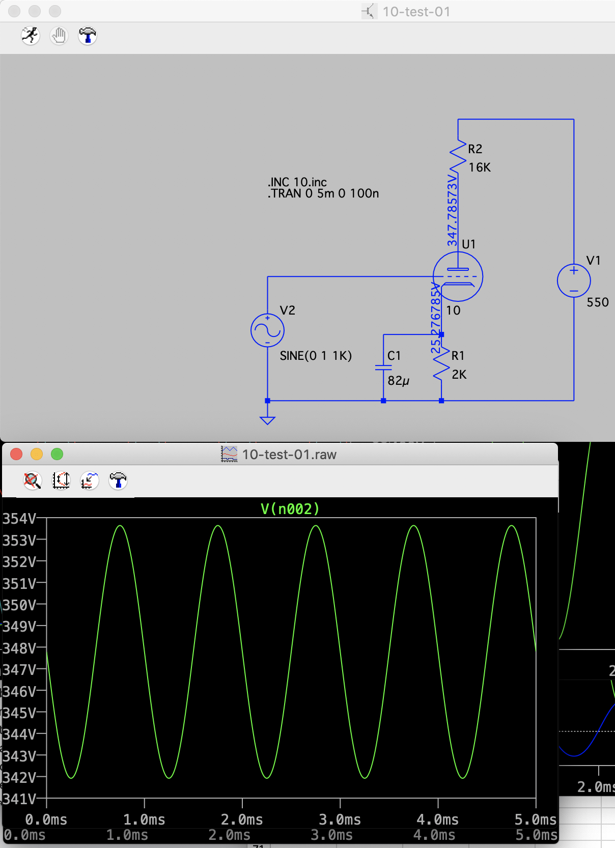

I thought #10 tube only has gain about 8 according to tube manual. Where did you get 14.5?The operating voltages in this sim check out, but the amplification factor of the #10 is only about 2. In post #415, which had a choke-loaded #10 cap-coupled to 2A3, the amplification factor was 14.5. Clearly I don't understand direct-coupled circuits yet. 😆
Are you sure it's not the overall gain of #10 AND 2A3?
I looked at the two circuits side by side and it baffles me why such discrepancy in gain.

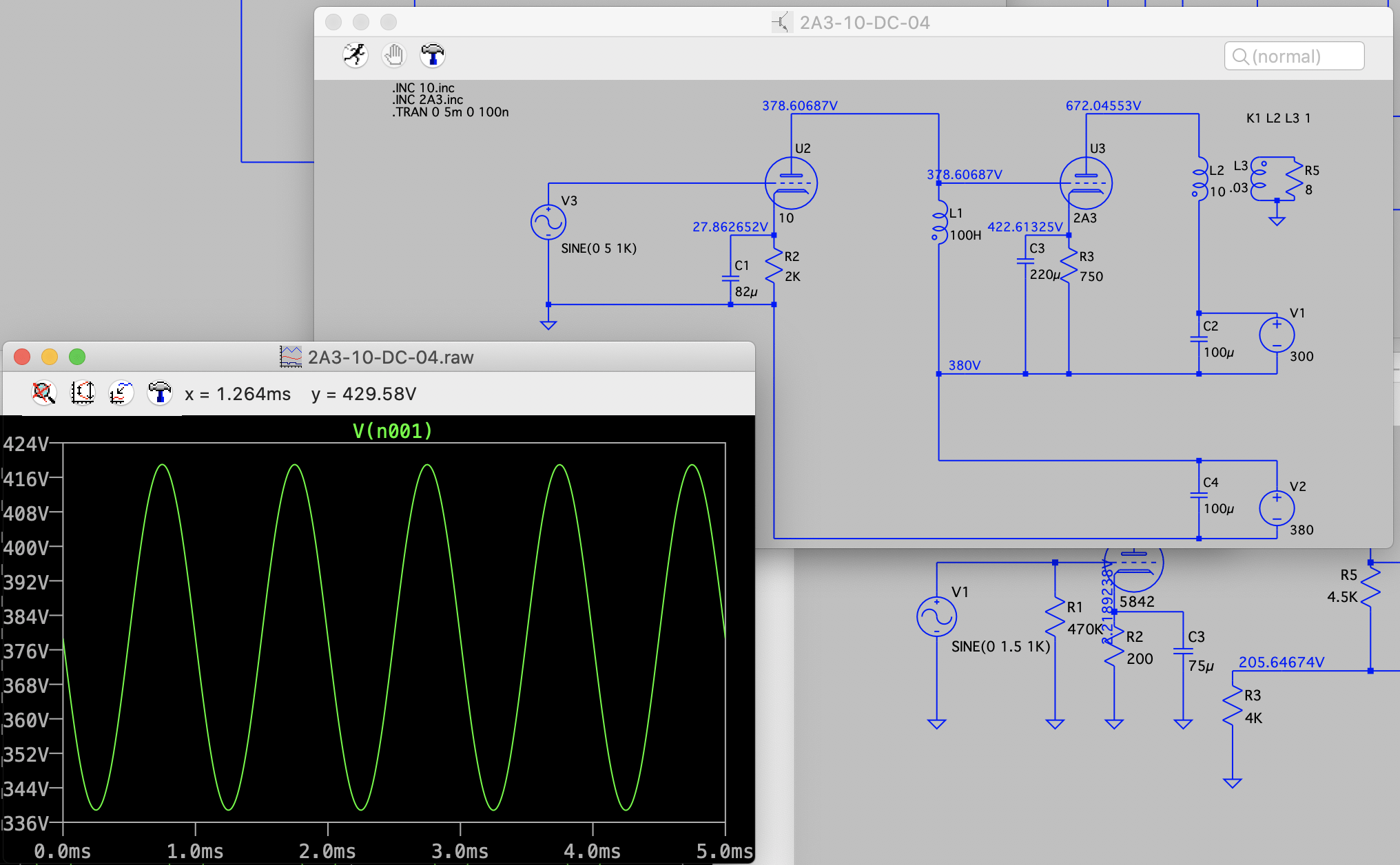

Choke-loading elicits more gain in LTSpice. At least with cap-coupled circuits. A while back I was breadboarding variations of a 6N6 amp using 27 on input. Another member had done the same, with 26 and 27, but he also breadboarded them with plate chokes and measured more gain than when they were resistor-loaded. So it seems to be real. I think it has something to do with the inductive load.
Anyway, given the #10's standard amplification factor of 8, I have no idea why in the direct-coupled circuit it would be 2. My best guess is that it has something to do with the ~680V tension between the 2A3 B+ and the negative leg of the lower PS.
Maybe I'm missing a ground connection somewhere.
But BOTH circuits in question are choke loaded and basically identical in DC relationship. It's baffling because the cap coupled circuit SHOULD have tiny bit lower gain since it has a 470K load compared to direct coupled with practically no load.Another member had done the same, with 26 and 27, but he also breadboarded them with plate chokes and measured more gain than when they were resistor-loaded. So it seems to be real. I think it has something to do with the inductive load.
What happens if you place high value caps, like 100uf, parallel with the two supplies for decoupling?Maybe I'm missing a ground connection somewhere.

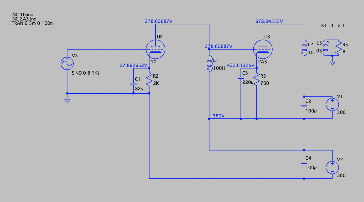

Never mind, I figured it out! I'd incorrectly coupled the inductors in the output transformer with the wrong part numbers in the Spice directive. The primary winding of the OPT was scripted under "K1" to couple with the plate choke on the #10! 🧐
I corrected it and now it works as it should.
A 5V input signal swings 80V on the 2A3 grid. This could potentially work well with that stacked power supply using two rectifier tubes off the second winding, which euro21 shared in post #421 just above.
I guess the question is whether this would sound better than the plate-choke and cap-coupled version, but I suppose there's only one way to find out. 🤓

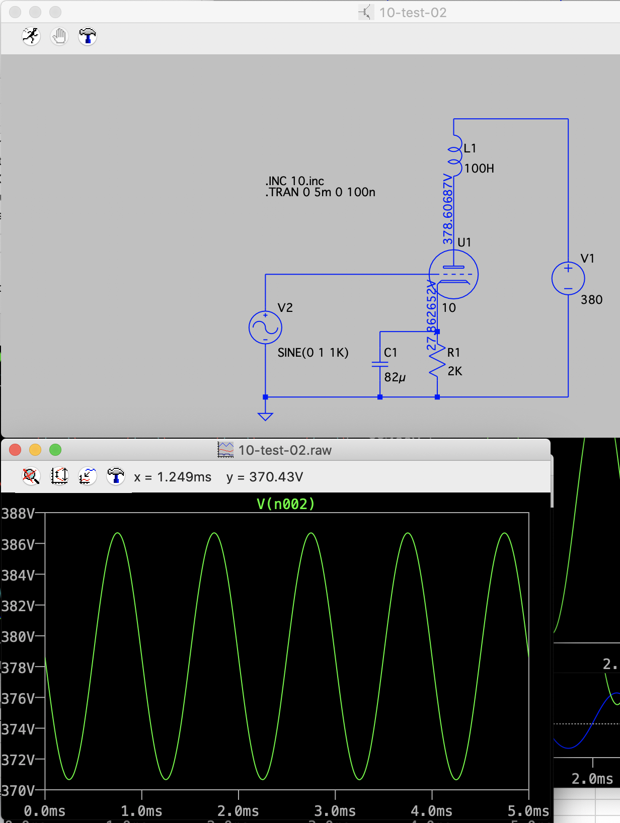

Bizarre! What's the gain with just the #10 input stage by itself with no load, treating it like a preamp? That should tell you if there's any interface issue.

Very cool! What I like about this "Komuro style" direct coupled circuit is that the plate choke is also acting as a grid choke for the 2A3's grid, providing a low DCR grid leak to ground or virtual ground.

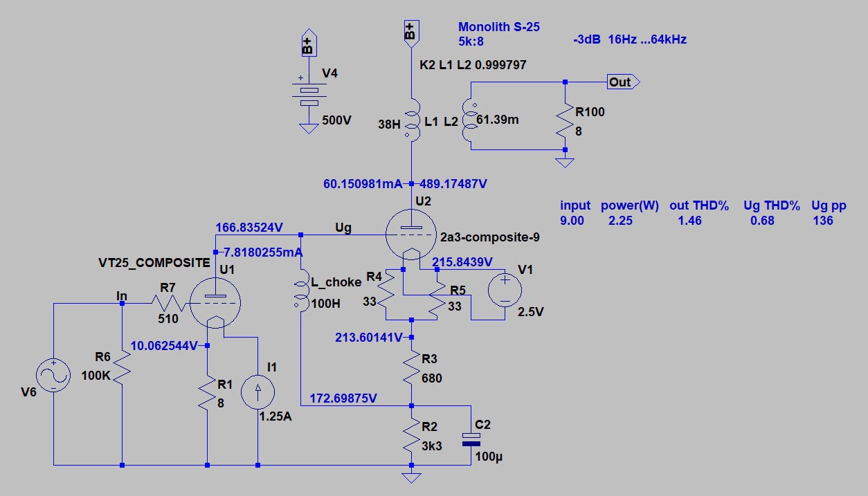

No offense @jdrouin, but here we have 22 pages of thread to end up with 3 stages anyway plus some aggravating transformers along the way that are notorious for being unfriendly above 10KHz.
In the end much simpler, better performing and better sounding amplifier could use the modest 6SF5+driver+2A3 in a much more compact unit. Considering a 2A3 amp is a 3W to max 5W amplifier it doesn't sound like heresy to me.
The driver could be different things according to the 2A3 requirements and overall gain without mirror climbing: from a cathode follower if gain is enough to low gain driver with enough current. A true wideband, ultra-low distortion, noise effective input step-DOWN transformer with floating primary (i.e. it goes to ground into the source) could also be used together with lower value than usual, lower noise volume pot, high input impedance and easy to drive for the source. A 3-stage Komuro style amp, as suggested, can be all this.....

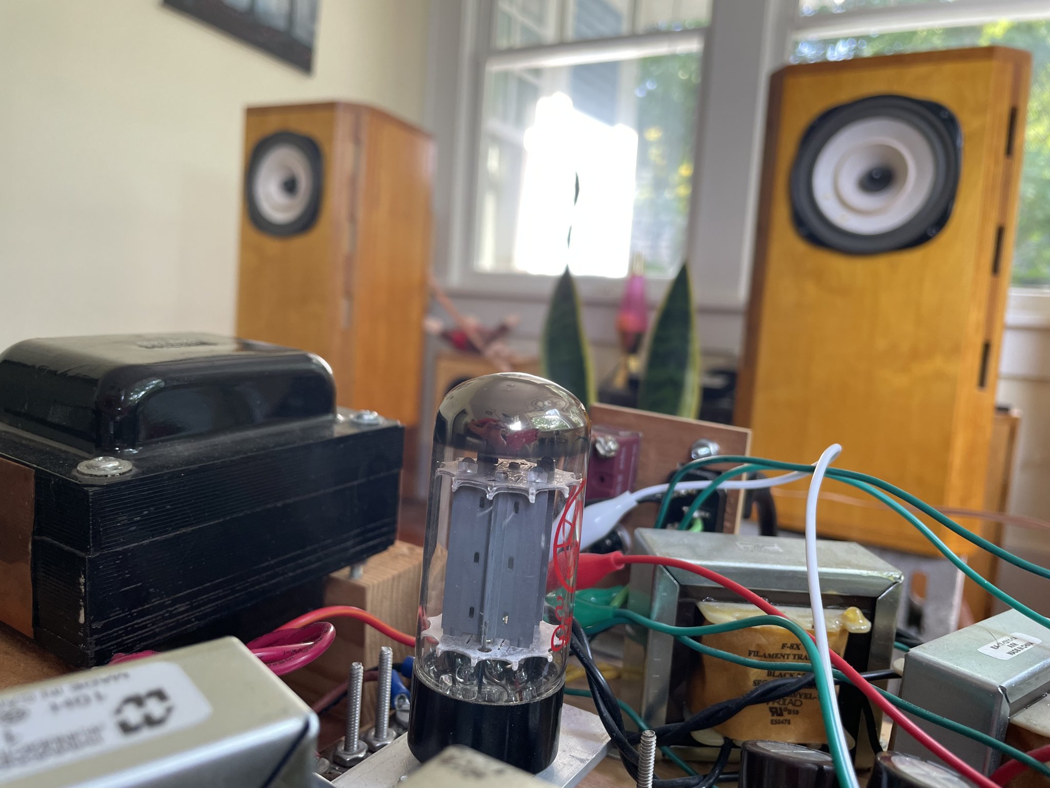

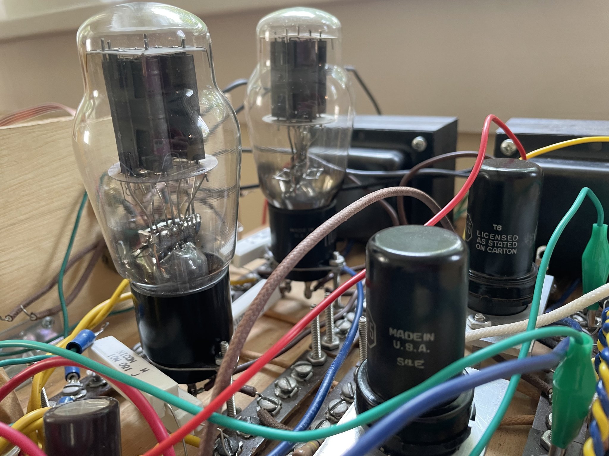

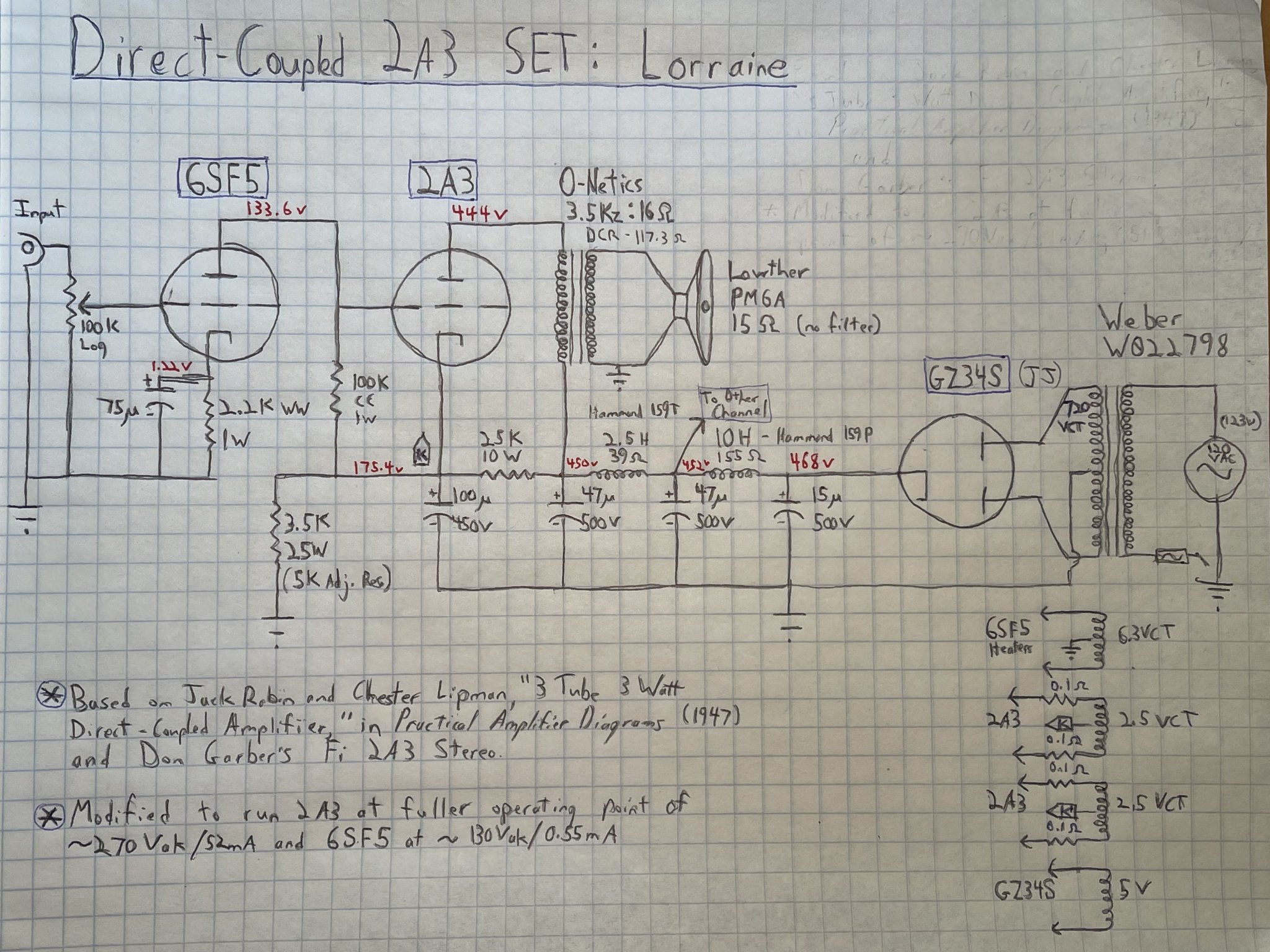

Today I hand-drew the schematic and notes for the direct-coupled 2A3 circuit I’ve been tweaking and listening to for a few weeks. While finishing the drawing and needing a name for it, I racked my brain for something witty from Proust (the necromantic memory of vacuum tube circuit design is vraiment à propos). Françoise, the inimitably funny cook? Léonie, the aunt whose furniture the narrator donates to his favorite brothel? The answer was closer to home in the francophone district of Lewiston, ME.
My great-aunt Lorraine died peacefully last night. It’s no wonder that she was my dad’s favorite aunt. Like the circuit that’s named for her, she was a direct, no-nonsense person whose pithy speech cut to the core of every matter, especially if it was the sort of thing that made other people prim. She would sneak the kids candy before dinner and never lost her mischievous spirit or sharp wit. When I spent some time with her in Maine 30 years ago, I told my brother she was “64 going on 17.” That’s probably why, when my uncle Bubbles died, he generously bequeathed his pornography and sex toy business to Lorraine and my grandmother, her sister Gilberte. My grandmother was mortified, of course, but the shop did very well under Lorraine’s auspices until she was able to close it responsibly.
Just as the bumble bee “shouldn’t” be able to fly, this circuit “shouldn’t” sound as exquisite as it does. A paltry 0.55mA of current goes from the 6SF5 into the grid of the 2A3, yet it has an openness and effortlessness that creates a spooky intimacy with small ensemble arrangements. You can hear the musicians’ clothes creaking as their bodies create the music. Probably the high-efficiency Lowther PM6A single full range driver has something to do with that. The circuit is based on the classic Robin/Lipman one from 1947 that Don Garber tweaked for many of his Fi products during the 1990s. Those versions sounded brittle because the 2A3s ran lean at 30-40mA, so I modified the bias and raised the voltage to put them at ~270Vak/52mA for a night-and-day difference. The power supply is 720Vct into a GZ34S, cap-input to a 10H choke, after which the channels split into 2.5H choke each and then the resistor networks and all around higher value caps than in the original designs. I used what I had on hand and would design the PS more purposefully if I do a final build. Like Lorraine, this circuit is imperfect and all about character.

jdrouin,
Nice pictures, and nice write-up.
I bet it is real good sounding too.
One thing that should be noted:
The 6SF5 has 0.55mA DC current . . .
But a working 2A3 grid in class A1 does not draw any DC current, it only draws AC current due to the grid to filament capacitance, plus due to the (1 + gain) times the grid to plate capacitance (1 + Miller Effect Capacitance).
There is only AC current into and out of the total grid capacitance.
Slew current.
If the 2A3 goes into Class A2, then the load on the 6SF5 becomes too heavy, and we get distortion (Ugh).
I am only trying to make it clear for Newbies who read this very nice thread.
