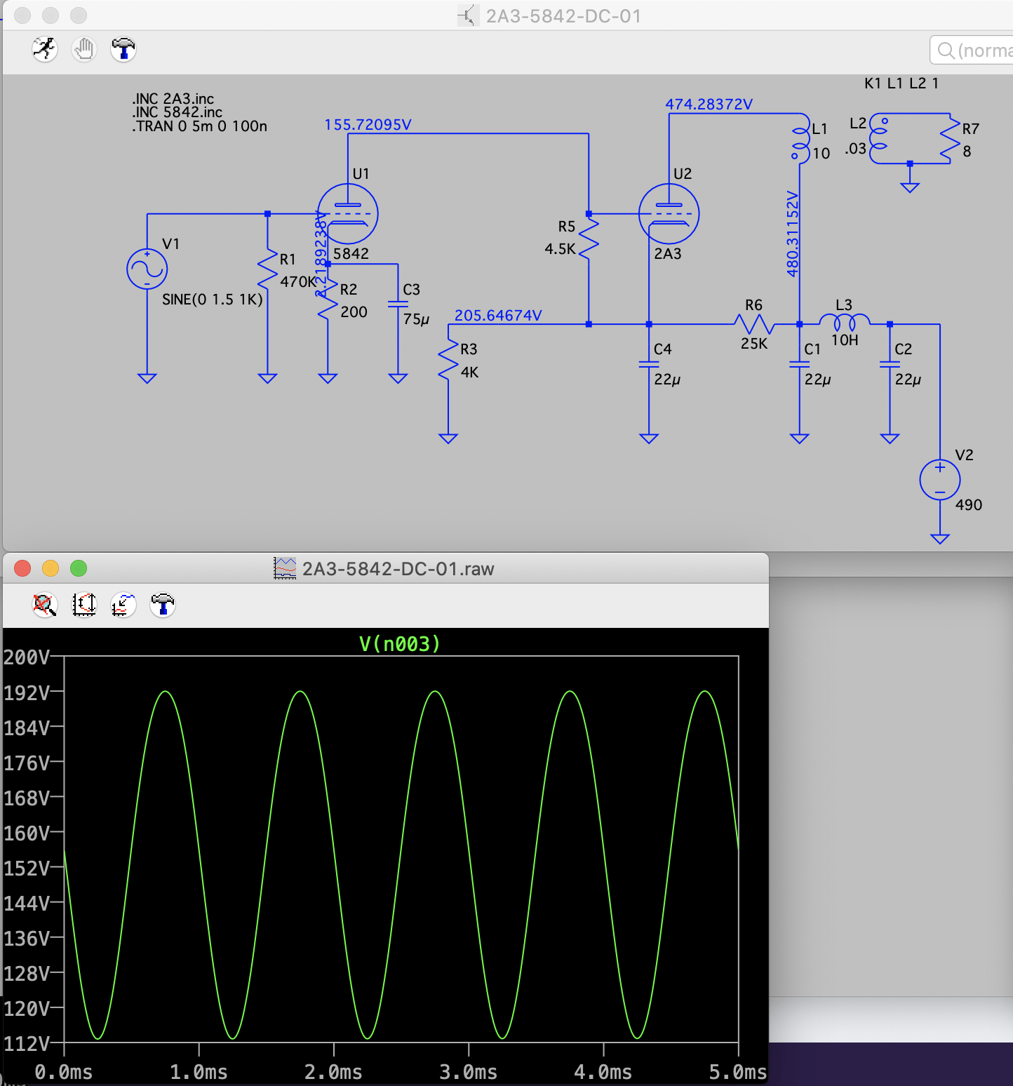

It seems a couple of people have become frustrated by the procedure I've been following, so let me just reiterate the intention I laid out at the beginning of this thread, which was to breadboard well-known published circuits, report on them (mainly for beginners, because of the lack of measurements available online), and use them as a reference point for making adaptations. In this case, I am moving on from capacitor-coupled circuits to try direct-coupled ones for the first time, so I started with the old Robin/Lipman and Garber circuits and will be adapting them to try other things, such as adjusting the operating points and bias to achieve better results. I wasn't trying to "sell" the adapted circuit posted just above, but rather to say 'here is an interesting point that others might find worth trying.' And, I like to write, and had a little moment of inspiration, and decided to put it a certain way because it's worth thinking about the meaning of what we do, too.
That being said, we had recently been discussing how to calculate the amount of current needed to avoid slewing in the output stage, etc., so I completely understand why this shift might have seemed like backpedaling. As I said, it was the starting point for a new phase of trying direct-coupled circuits, so perhaps I should have made that more clear.
Since we've established how and why a 2A3 needs 8-9mA from the input stage, I will next be swapping in a 5842 running at 150V/10mA. Should have an input sensitivity of about 1.5V. I might not get to it for a few more days, but attached is a screenshot of the LTSpice simulation. Will need to take into consideration that a LOT of heat will be dissipated at R3 and R6.
FYI, the breadboard is on a dedicated table in my small home office, out of reach from the dog. My kids are old enough to know not to touch it. The alligator clip is merely holding together three connections on the tab of a ceramic wirewound adjustable resistor because I need to manipulate it frequently, else I would have soldered them. I am always extremely careful around it, do not work on it when tired, etc.

That low current drivers like 6SL7 and 6C6 not just work, but actually sound good is a surprise. My 2c: slew rate is important at higher signal levels, but at 0.1 - 0.2W output, the actual power needed to drive efficient speakers, a 0.8 mA driver will not limit slew.
Another important consideration is driver's plate voltage, which is the key factor in driver distortion. My rule of thumb is that driver's output voltage swing should not exceed about 20% of driver's Ua. So, for 50V peak, driver's Ua should not be considerably lower than 250V.
RC-coupling and DC coupling put serious constraints on driver's Ua. LC and transformer coupling don't.
Reactions: TR00 and 6A3sUMMER
Agreed. It's weird. 6SL7 SRPP (only 0.7mA) cap-coupled to 2A3 might still be my favorite circuit evaluated here so far. The DC 6SF5 can fall apart on some of the more complex or challenging music material, in ways that the SRPP doesn't, but it has a more capacious sense of space and is generally more relaxed and natural.
I also found, contrary to the wisdom a couple of you have posted recently, that increasing the signal drive in the 6SF5 DC circuit resulted in much better performance. The other night I listened to Kenny Burrell's Guitar Forms after the amp warmed up for an hour and decided to crank up the volume quite a bit, and boy did the orchestra sound great. But then I played Miles Davis' Sketches of Spain, which is similarly composed and orchestrated, and it really crapped the bed. But then I put on Jimmy Smith's Root Down and the bass was super authoritative and tuneful and the performance space, instrument separation, etc., were spot on.
The 6SL7 SRPP is more forward and bright sounding (not irritably so), but performs consistently well across music types. Actually, I think I'll try 6SL7 in simple and then SRPP topologies next, since I won't need to change much on the breadboard.

No, just disappointed. But I guess it's all good. I started by designing more or less established circuits that worked and "sounded good" but with time I realized they didn't perform that great after all. I guess this is just the route you are taking. You can see from my old thread that Bugun found that I did this kinda thing too at one point. I thought I would save your some of the hassle. Guess not.
The 5842 should work. I prefer triode strapped pentodes because I got them when they were still affordable. Personally I would not use the monkey topology (again). I would call it a "compromise" circuit. But I will let you discover that for yourself! 😎
Or, you could simply do a classic design running 5842 at around 16mA with 160V on the plate using a 20k load resistor and a 125 ohm cathode resistor. Aim to bias around 2V on the cathode.
You will get better gain if you use a larger load resistor on your 5842. Don't think you will get an amplification factor of 55 with that little 4.5K load resistor.
Then use 3.5k ohm cathode resistor on the 2a3 - you will discover that you probably need something like 50uF cathode by-pass cap there. Your posted circuit is only running 2A3 at 50mA. You can push it up to 60mA and it will sound a lot better with lower distortion too.
You will find that 8-9mA is not going to be enough - unless you use a source follower with much lower output impedance. Sure it will sound better than the "wimpy" triodes, but still - go for the gusto! Test it out at least. 5842 is good for 4.5 Watts. Feel free to experiment around if that seems worth doing.

One can still use the 6SF5 without any slew rate issue if a DC coupled cathode follower is added in the middle. Starting from the Komuro style circuit and using a proper input transformer it could be done without coupling capacitors. And it would be an integrated amplifier.
The input transformer has to be able to work with relatively high DC differential between primary and secondary. The new Hammond 1140 Studio Series can do that. I have asked info directly to their technical department. In this case one could use the 1:1 model 1140-LN-B and could put a 10K ALPS RK27 volume control across the secondary. Then have 2 supplies: +/- 270V DC (using a voltage multiplier to keep the power transformer simpler) and 250V + OPT primary drop for the 2A3. The 6SF5 has 1.5K bypassed cathode resistor and 320K anode resistor ( 1 mA anode current) and directly coupled to a half 6BL7GT cathode follower with 12K cathode resistor. Both these tubes are supplied with the dual +/-270V. This way the cathode of the 6BL7 should be around the right -43-44V bias for the 2A3 that will have its cathode grounded. The circuit is also safe on start-up as the grid of the 2A3 will see -270V until the cathode follower draws current. Of course, one can refine the supply as desired but without having to accept any worrying compromise. With different 2A3 operative point only small adjustments need to be done to both supplies. The dual supply could use a cap multiplier that also serves as fine adjustment for the actual output voltage or one could regulate both supplies with dual one still adjustable.
The cathode follower will bias at about 310V/19mA. It's near max for the tube but still ok (just under 12W for both plates) and should work in very linear conditions......
With lower anode voltage for the 6SF5 (it could be something like 180V instead of 210V and 1.2K cathode resistor) or using other lowish current (less than 5 mA) input tubes the circuit could be less "extreme" and possibly a 6SN7 cathode follower could be used.
N.B. The values for the various voltages and resistors are just a quick guess but should not be far off.....

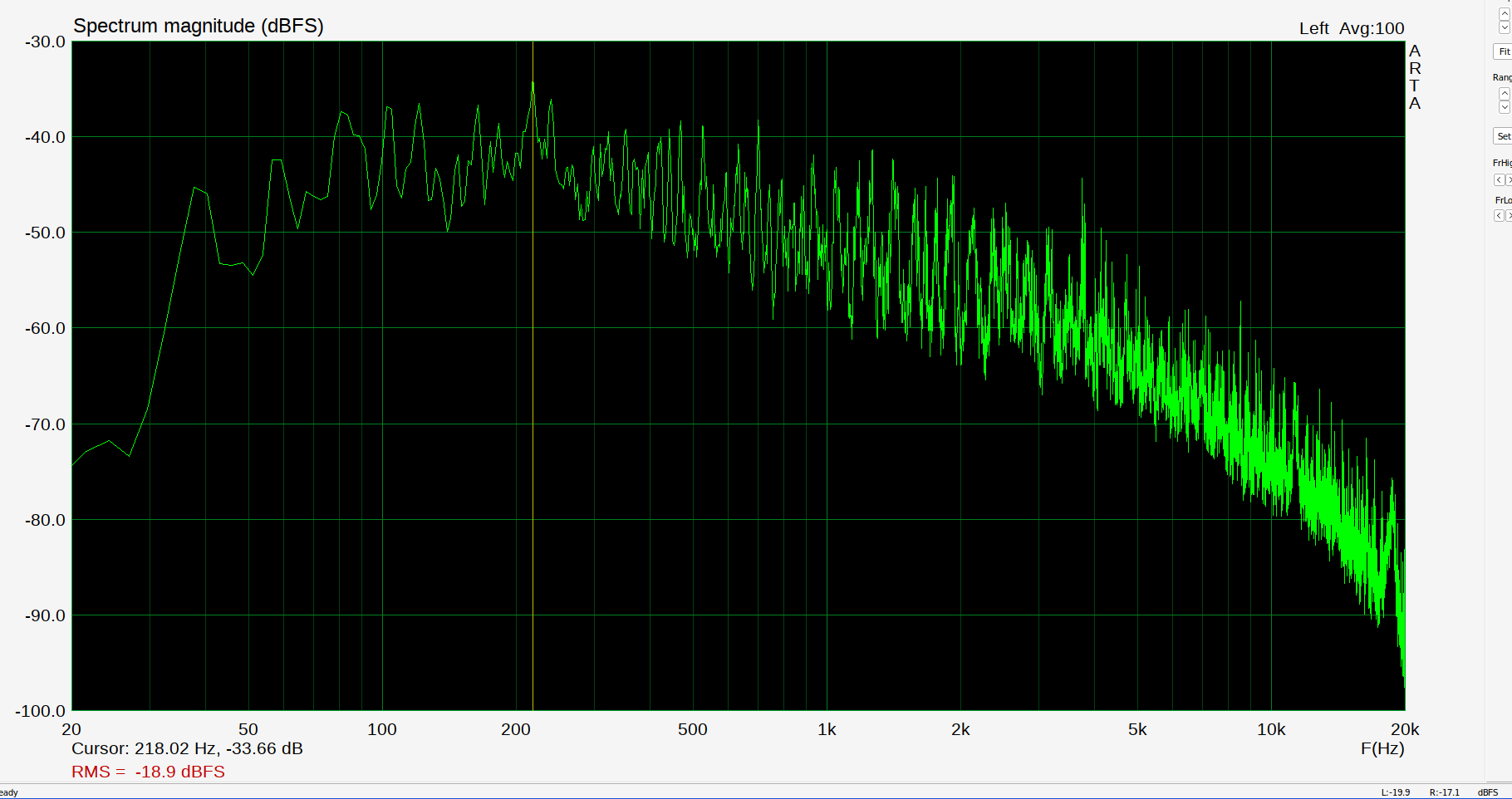

Purchase a digital scope, and set it to FFT to cover 0Hz to 25kHz, and activate the scope's Max Hold function.
Connect the scope to the output of your CD player.
Put in a music CD that has lots of high frequency energy and play the CD all the way through.
You will notice that the higher frequencie's amplitudes drop off rapidly;
That is exactly according to natural fall-off rate of both the instrument's harmonics and the voice's harmonics.
For those that don't have a scope with spectrum analysis, you can see this effect without any hardware, other than means to loop your PC soundcard (line out → line in).
Take your digital audio music file, and play it (With Audacity for better visualisation of the time domain of the music).
You can then use Arta software to perform the FFT spectrum analysis.
The Max. hold function is achieved by Arta's Avg → Peak Hold. Increase the number of Peak Hold samples to cover more of the Track, if desired.
The screenshot is a hundred 16k FFT samples (@44100 smpl/s) of the 'Invasion Theme' (D. Shostakovich: Symphony №7: I. )
Arta can be installed in Linux, with WINE, for a somewhat-FOSS solution. (launch Arta with sudo, for USB soundcards).
Personally, I use a USB soundcard with some simple protection circuit added. I wouldn't want to fry the soundcard on my laptop - its on the motherboard.

this test doesn't measure the tube amplifier. It justs connects the PC's (analogue) line out to line in. I just put a 3.5mm male→male jack lead across my old desktop's audio card.
The playback of the audio file simply routes to the FFT software, which is waiting for it at line in. It's safe to use with internal or external cards, though I suspect you may need a USB soundcard to get analogue signals in today's laptops.
