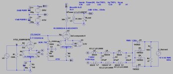

E euro21 Member Joined 2004 Paid Member Wednesday at 9:12 PM #641 Wednesday at 9:12 PM #641 jdrouin said: Does (1) seem like a reasonable and safe way to connect an ammeter to measure and adjust output tube plate current? Any alternative suggestions? Click to expand... If you use virtual cathode for power tube, on R8 current sensing resistor can measure voltage proportional to current.
