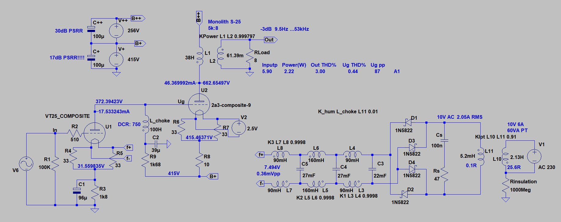

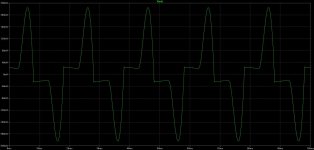

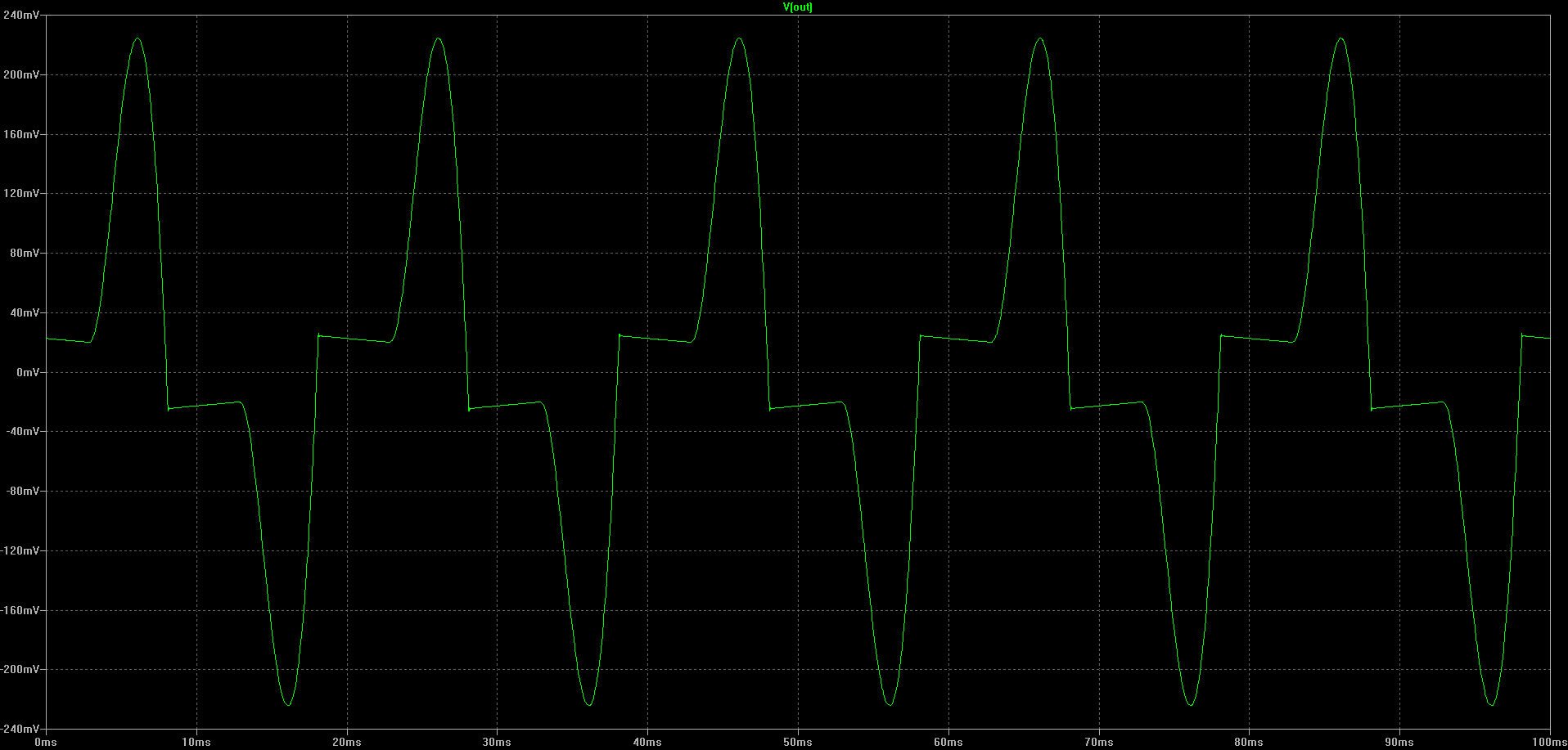

I simulated what happens when anode choke penetrated EMI from filament transformer (K=0.01).
10Y DRD 2A3 SE_jdrouin_Lchoke hum.jpg 10Y DRD 2A3 SE_jdrouin_Lchoke humming.jpg
Reactions: jcalvarez
Those are some serious Spice skills, euro21! I had no idea that LTSpice could model things like EMI interference due to physical proximity. It's certainly valid to deduce that the filament PT could have been inducing hum in the anode choke, since the hum disappeared when the DC bench supplies were swapped in (and the AC PT removed from the breadboard). Hum also disappeared instantly when the 10Y filament power was cut, but not when either of the two high voltagerails or 2A3 filament power were cut. When the transformer was on the board, it was about four inches (10cm) from the right channel anode choke, and rotated 90 degrees. The hum was in both channels evenly. I can put it back on at a further distance and see if that changes anything.

I zipped the necessary files for simulating:
  • 10Y DRD 2A3 SE_stacked PSU_jdrouin_2.asc
  • dmitry_composites.lib
  • triodedht.asy
I hope that it's enough for testing.
Try it.
p.s.
Because it has AC filament PSU, only "Transient" and "AC Analysis" simulating command working.
It's works with 9 second delay, 1s run, because extra large LT PSU capacitors charging slowly.
If you want to test amplifier with tighter parameters (must to change LT PSU with 7.5V DC PSU), change the
" .tran 0 10 9 " line with
" .tran 0 {ncycles*period} {(ncycles/2)*period} {period/1e4} ".
Must to set input (peek) voltage of V6, because now 'Amplitude(V)' is zero (for testing hum).
The amplifier with these parameters at 5.9V Input (peek) reaches A1 limit.

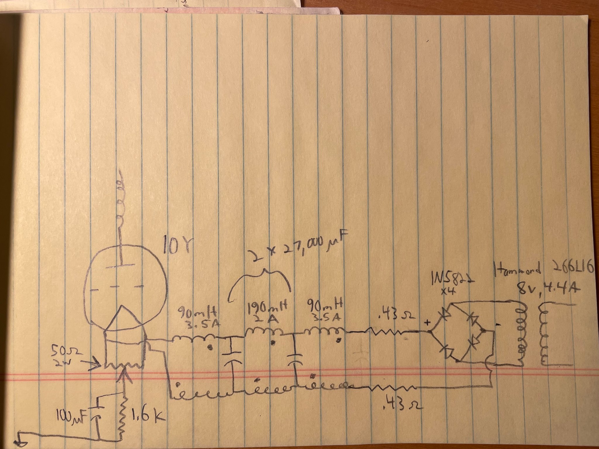

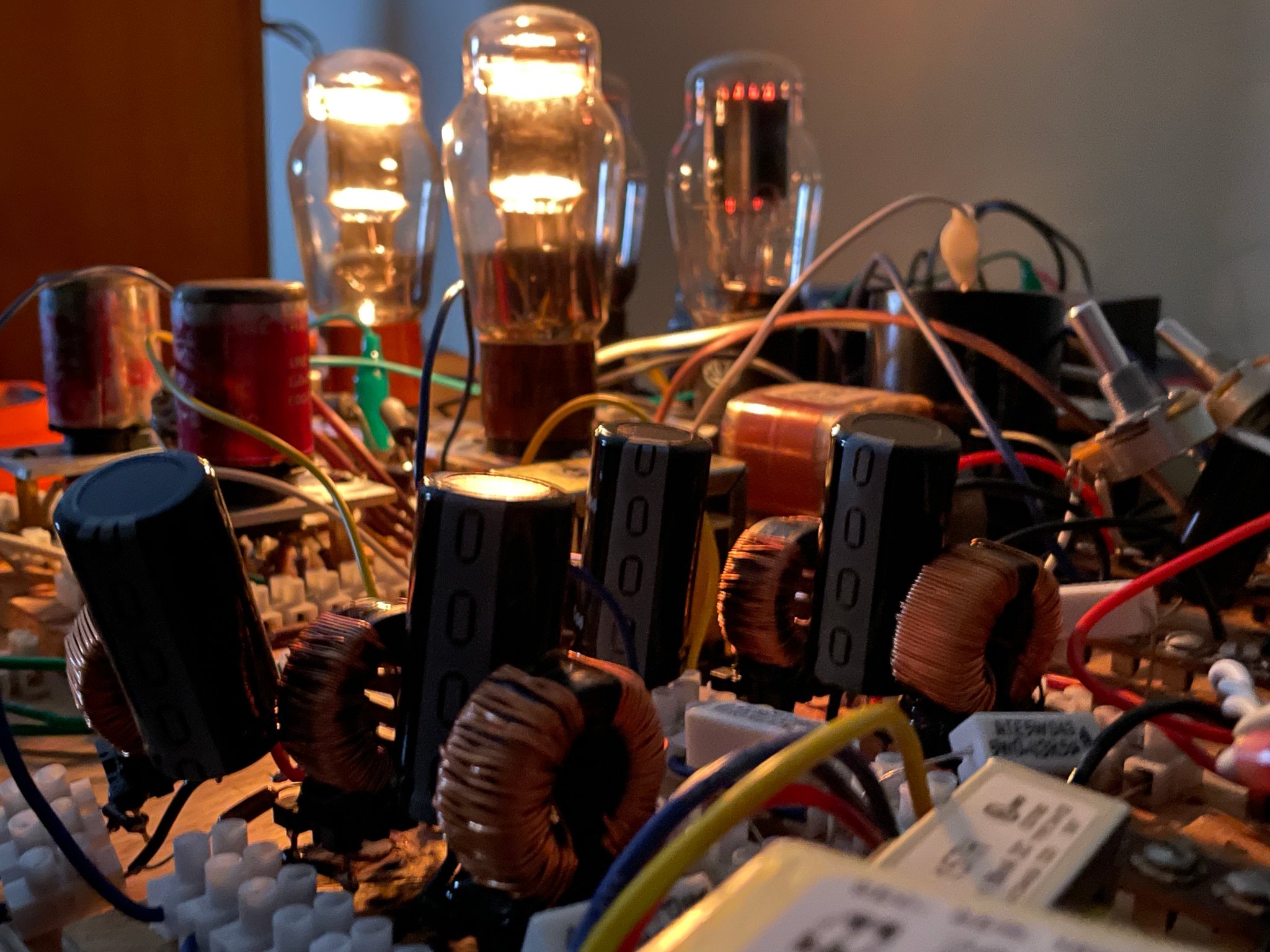

Success! I tried a symmetrical, passive filament supply on the 10Y with common mode chokes, caps, resistors, and a hum pot. The filter section is floating, with the hum pot wiper connected to the cathode resistor and bypass cap, which in turn go to ground. It's dead quiet and sounds very good.
Schematic is attached. At euro21's suggestion, I wired the negative leg of the CMCs in reverse, so that the opposite direction would cause ripple and magnetism to cancel out.
I wonder if the pot is really necessary because I can only hear the slightest amount of hum -- with my ear up to the speaker -- when rotated to the extremes. A virtual center tap might be fine.
So nice to be able to power up the breadboard and simply listen to music again.

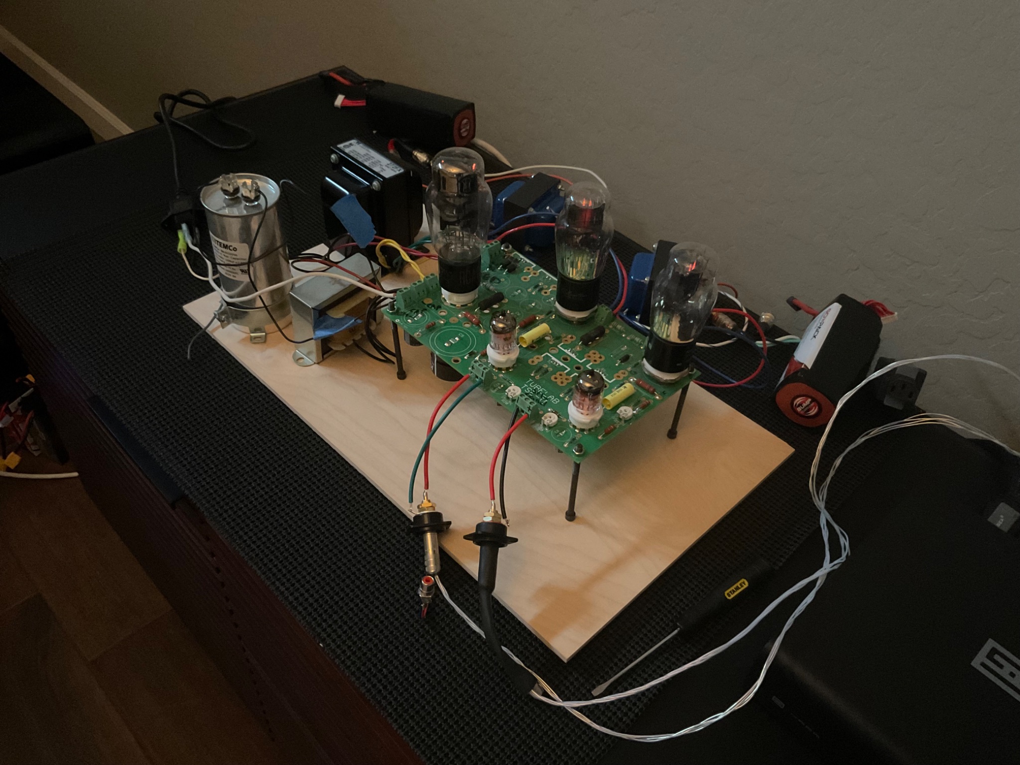

Brief report on a recent change in the circuit. Again this is the choke-loaded 10Y direct-coupled to 2A3 with a stacked power supply and input transformers at a 1:5 step up. The 2A3 is always run at 250V/60mA, the standard operating point and also my personal preference after trying several other ones.
The 10Y had been running at 260Vak/14mA and sounded good.
I wanted to aim for the middle operating point on the regular type 10 datasheet, which is 350Vak/16mA. So I swapped in a 650Vct power transformer and a GZ34 rectifier, and now have it running at 335Vak/17mA. I'll adjust it further until it reaches that op point from the datasheet but already the improved performance is very audible. The 10Y definitely likes to be run at higher voltage with higher current, so that will guide the next sequence of adjustments and tests.
