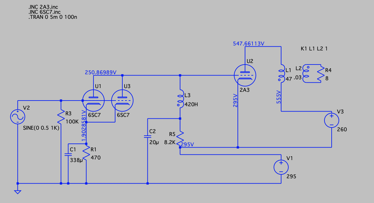

Your schematic in Post # 479 has some very wrong values.
Voltages, resistances, or both.
2A3 self bias resistor is 130 Ohms
342V - 335V gives Only 7V bias across 130 Ohms. That would be 54mA, but . . .
592V plate to 342V filament is 250V p-f.
A 2A3 with 250V p-f, and Only 7V bias would cause 250mA plate current. OUCH!
Please correct the schematic to working voltages and currents.

Using stacked power supplies the mixed bias (fixed bias due U1+U3 anode current via L3 and R5//C5 bias) IMHO is unnecessary.
Series resistor with L3 (AC decoupled to ground with few ten uF capacitor) performs the same ... and always problematic R//C in cathode is omitting.
Euro21, did you mean something like this? The attached screenshot has the 6SC7 running at about 250V/4mA and the 2A3 at roughly 250V/60mA

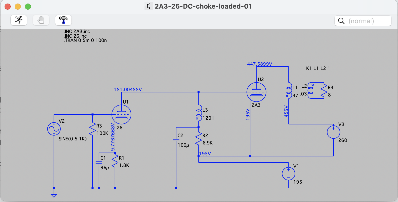

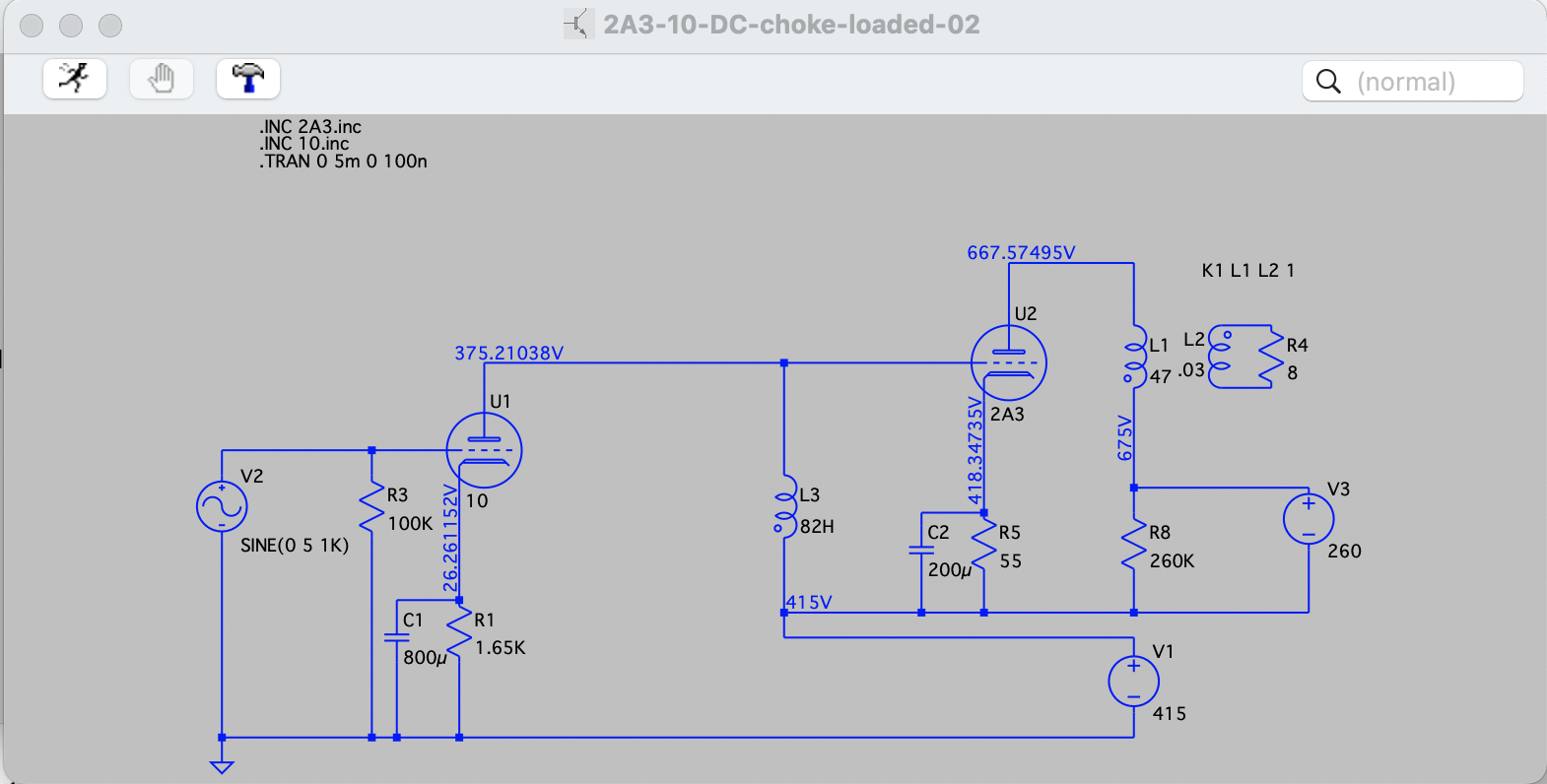

More playing around with choke-loaded, direct-connected and a stacked power supply. I read back through the discussion of DHT input/drivers in this thread and modeled circuits for 26 (140V/5.5mA) and 10 (350V/16mA) into 2A3 (250V/60mA).
Input sensitivity in both is 5V, so either one would need the 1:4 input transformer as discussed earlier.
Yes, I thought so.

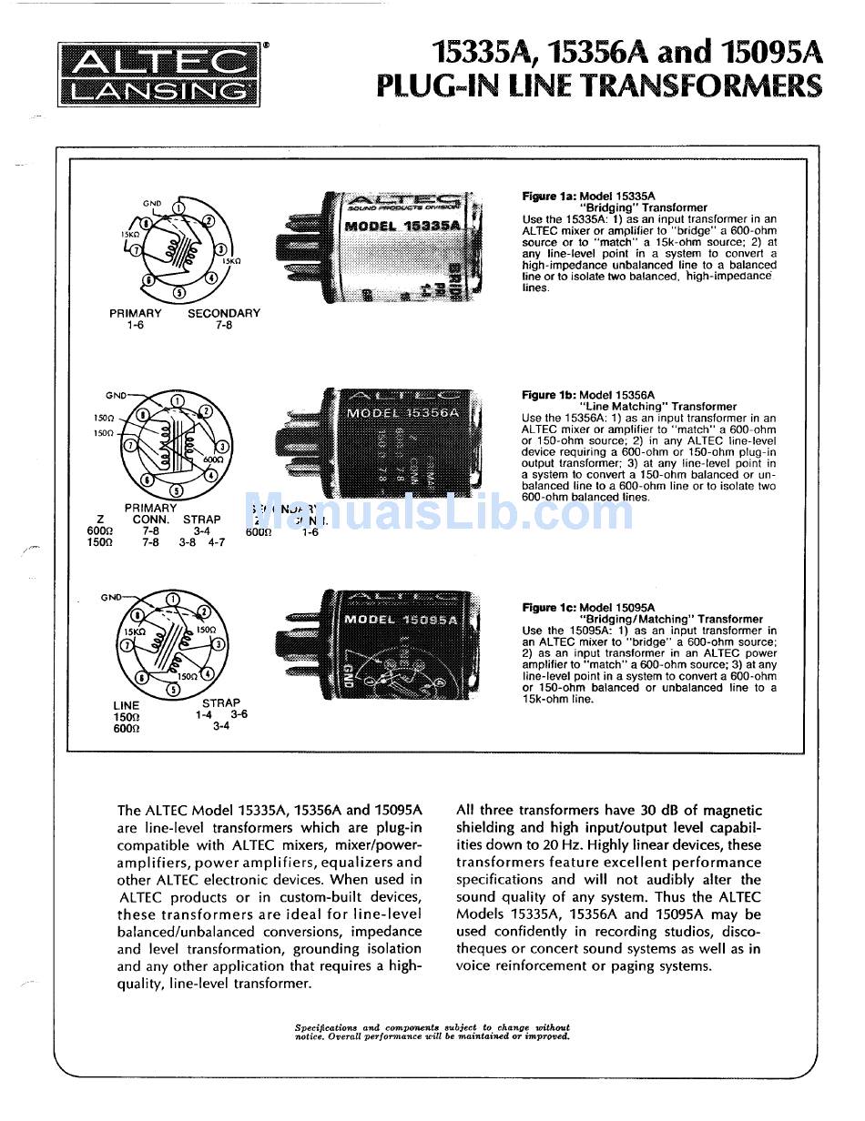

Does anyone have experience with Altec 15095A input transformers? Can be configured for 600:15K (1:5), and might be usable to connect 600 ohm source (DAC, laptop) to the grid of 26 or 10/10Y.
https://www.ebay.com/itm/225945901901

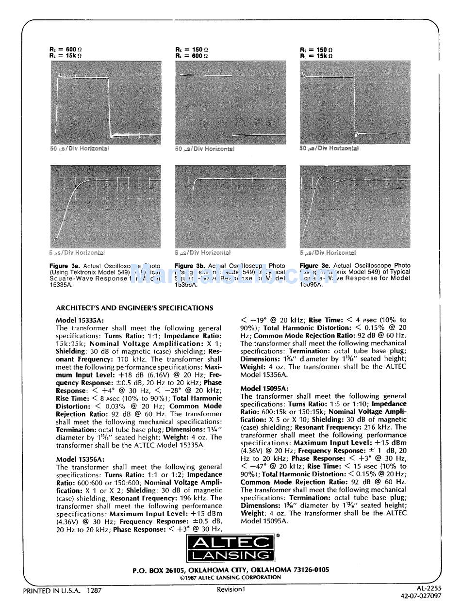

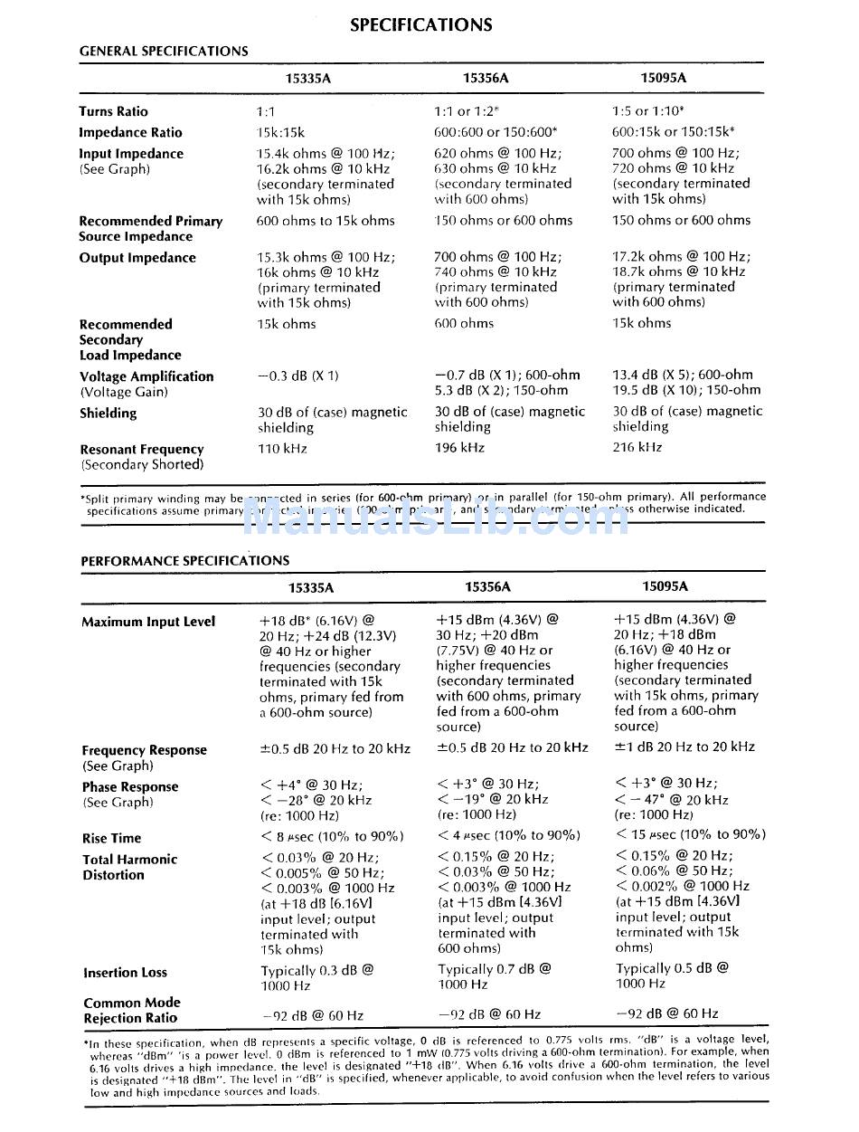

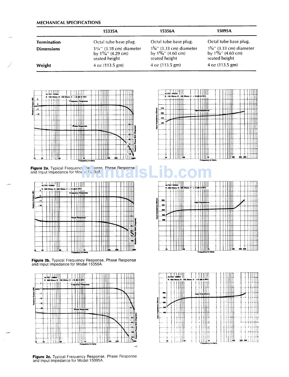

The old manual I found online (attached images) describes it as a "Bridging/Matching Transformer: Use the 15095A: 1) as an input transformer in an ALTEC mixer to "bridge" a 600-ohm source; 2) as an input transformer in an ALTEC power amplifier to "match" a 600-ohm source; 3) at any line-level point in a system to convert a 600-ohm or 150-ohm balanced or unbalanced line to a 15k-ohm line."
Looks like it should provide enough bandwidth. Any drawbacks to using something like this?

There is no miracle.
This Altec SUT represents technology limitations at that time where this device developed.
Not really "20Hz" compatible, at lower side the distortion is significant (core limitations).
At 20kHz the -47 degree phase shift doesn't mean much good.
See -for example- Jensen JT-6110K-B datasheet.
I suspect these Altec transformers were made by UTC as they look exactly like UTC P line, and have similar characteristics. In my experience, UTC O- and P-line transformers are OK, they have limitations at extreme audio frequencies, but what one would expect from such tiny transformers. They don't have sufficient inductance (compared to the more upscale A, HA, and LS input transformers). so LF distortion is relatively high. High frequencies are also compromised because self-resonance frequency is close to the top end (hence phase shift of 47 degrees at 20 kHz). I like how they obfuscate on measuring self-resonance frequency with secondary shorted, which is NOT how a transformer is used in real circuits.

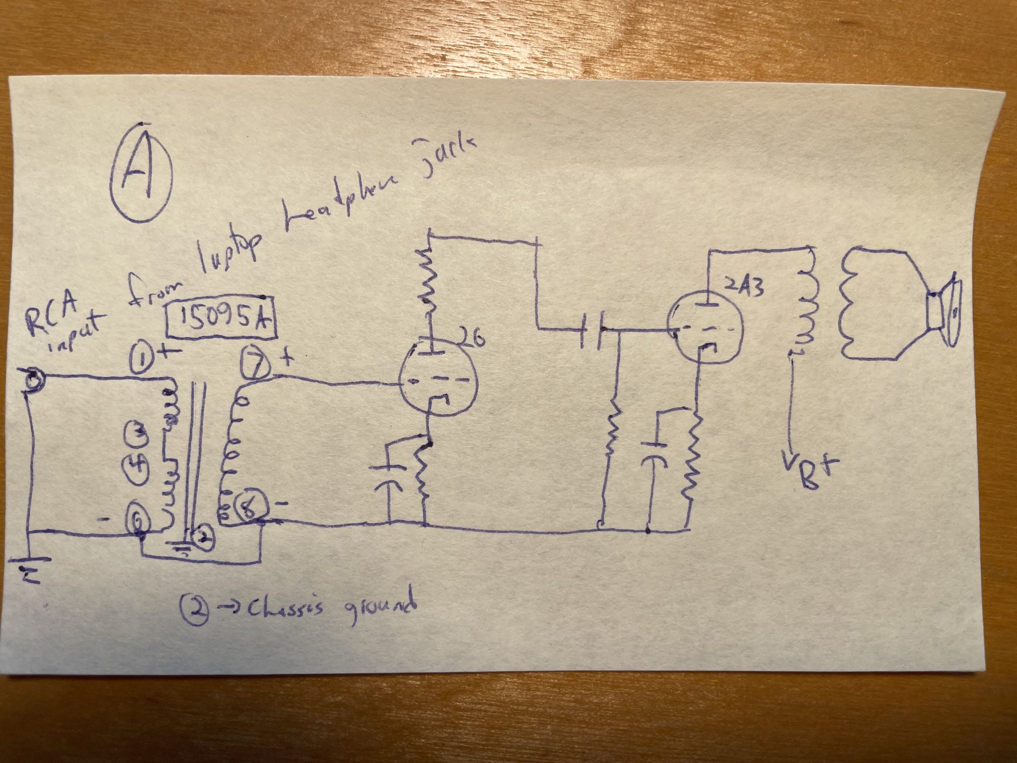

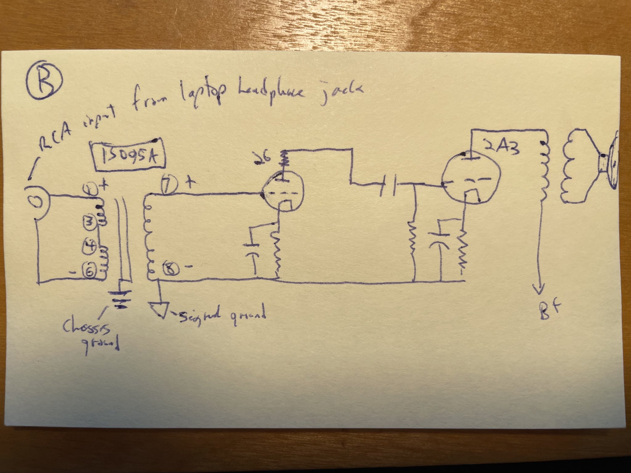

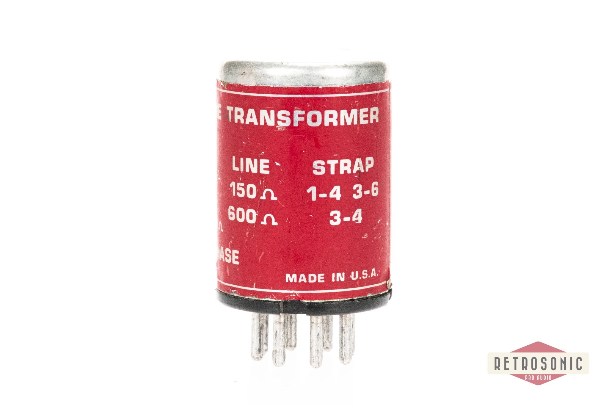

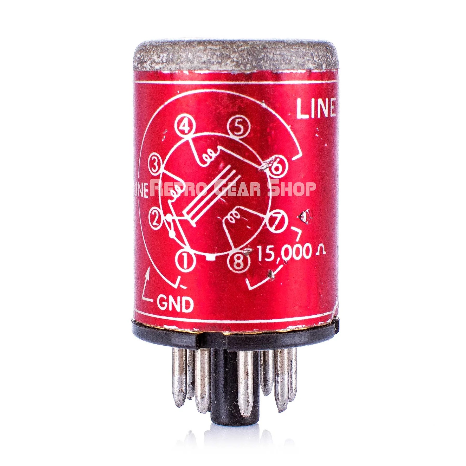

OK, I'm back with a newly built breadboard and in need advice on wiring an input transformer. I picked up a pair of Altec 15095A line input transformers for use with DHT driver stage, in this case 26 into 2A3.
I got all voltages dialed in on the new breadboard and then tried to play music but there is no sound. A laptop headphone jack connects to the amp input by RCA jacks (single-ended). Everything on the tubes seems to be connected correctly, so my guess is that the input trannies are where I've made an error.
The attached pics show the 15095A pinout and the instructions on the can for wiring it 600R : 15K -- you strap pins 3 and 4 together. There are two versions of the wiring that I've tried. At first I had everything going to signal ground through the primary negative lead, so I thought maybe the input signal was getting shorted to ground. So I tried wiring the primary negative only to signal return, while the secondary negative goes to signal ground. Still no dice (pics attached):
A. Signal input hot to pin 1, signal output hot to pin 7. Pin 3 to pin 4 for the two primaries in series (600R). Pin 8 (secondary negative) connects to pin 6 (primary negative) and then signal ground. Pin 2 (internal shield?) to chassis ground).
B. Signal input hot to pin 1, signal output hot to pin 7. Pin 3 to pin 4 for the two primaries in series (600R). Pin 8 (secondary negative) to signal ground. Pin 6 (primary negative) only goes to signal return. Pin 2 (internal shield?) to chassis ground).
Any help would be greatly appreciated. Thanks!

Thanks. Are you saying both A and B should work?
To check the coil impedances -- using my laptop, I played a 1Khz test tone at 1V output. It measured as follows on my digital multimeter:
  • Primary (pins 1 & 6): 0.473V
  • Secondary (pins 7 & 8): 2.37V
According to the Sowter FAQ Page, "The voltage ratio is the primary voltage divided by the secondary voltage you used. The primary impedance will be the ratio squared x the secondary impedance." The rated secondary impedance of the 15095A is 15K. So...
  • Voltage ratio: 0.473 / 2.37 = 0.1995
  • 0.1995 x 0.1995 x 15,000 = 597.00375
So, it would seem the rated ratio of 600R : 15K checks out.
Maybe I screwed up at the 26 tube. Will check tomorrow when I'm not tired.
I don't typically measure signal voltages, but now that you've got me doing it, I should measure the AC signal voltage while the amp is in operation, to see where it cuts out. Will try tomorrow when I'm not tired.
UPDATE: I was too curious, so I turned on the amp, did the 1V 1Khz test tone, and while the amp was running, there was virtually no AC signal at the same pins as above. I must have somehow introduced a short to ground, or something, up the signal chain?
