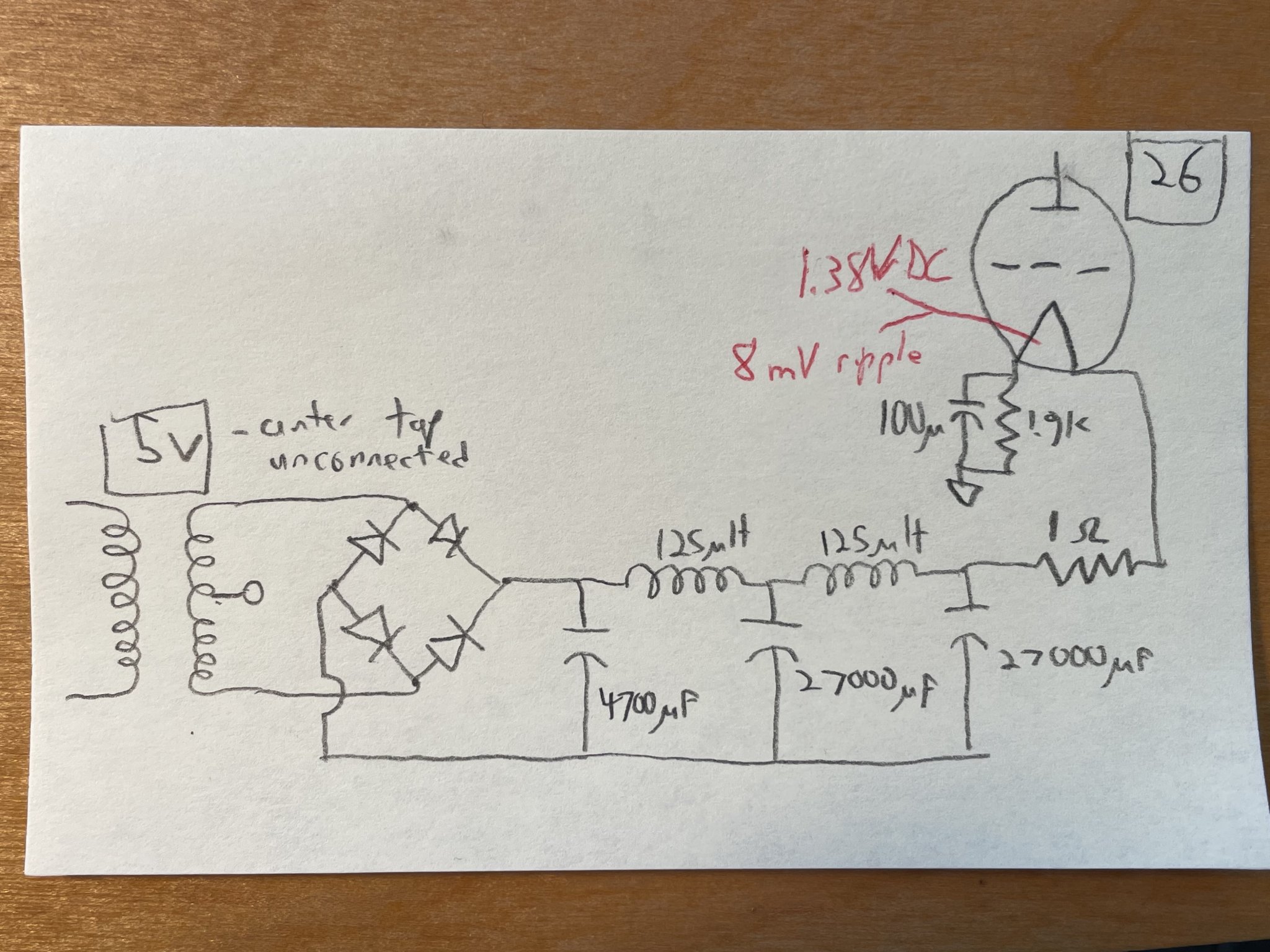

Thanks 6A3sUMMER. Given your experiences with the 300B filament, an RC filter with several stages makes more sense than purchasing a component I'm not familiar with. I need to order some resistors to make that happen.
In the meantime, I figured I'd see what kind of filtering I can get with the 125uH chokes, given that successive stages have a multiplying effect. So I added the highest value caps I had on hand. Now, instead of an LCL filter, it's a CLCLC filter with a dropping resistor (attached).
4700uF -- 125uH -- 27000uF -- 125uH -- 27000uF -- 1 ohm
The 26 filament is now running at 1.38VDC (a little low), with a measured 8mV of ripple using the digital multimeter. Quite a bit less than the 45mV of ripple I measured earlier, and the hum is nearly inaudible now (have to put my ear to the driver in order to hear it).
This will certainly do for now, and it hasn't changed the character of the sound.

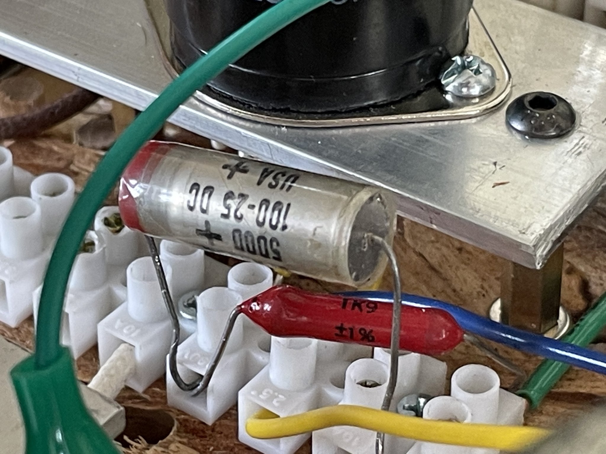

What's the type of the cathode resistor?
There is practically no need power, so even -very- good 0.5-2W resistor can be used here.
I like tantalum resistors (Shinkoh, AN), Z-Foil also very good.
BTW 1k9 isn't typically used value, paralleled 3k9 resistors are more easily accessible.
The cathode bias resistor is a 1% wirewound or metal film. I bought it at a local electronics store that didn't specify the type. I've got 1.8K and 2K resistors I could use too, but might have picked this one in part because it matches the color of the Sprague redhead capacitor that also worked at that location. 😆

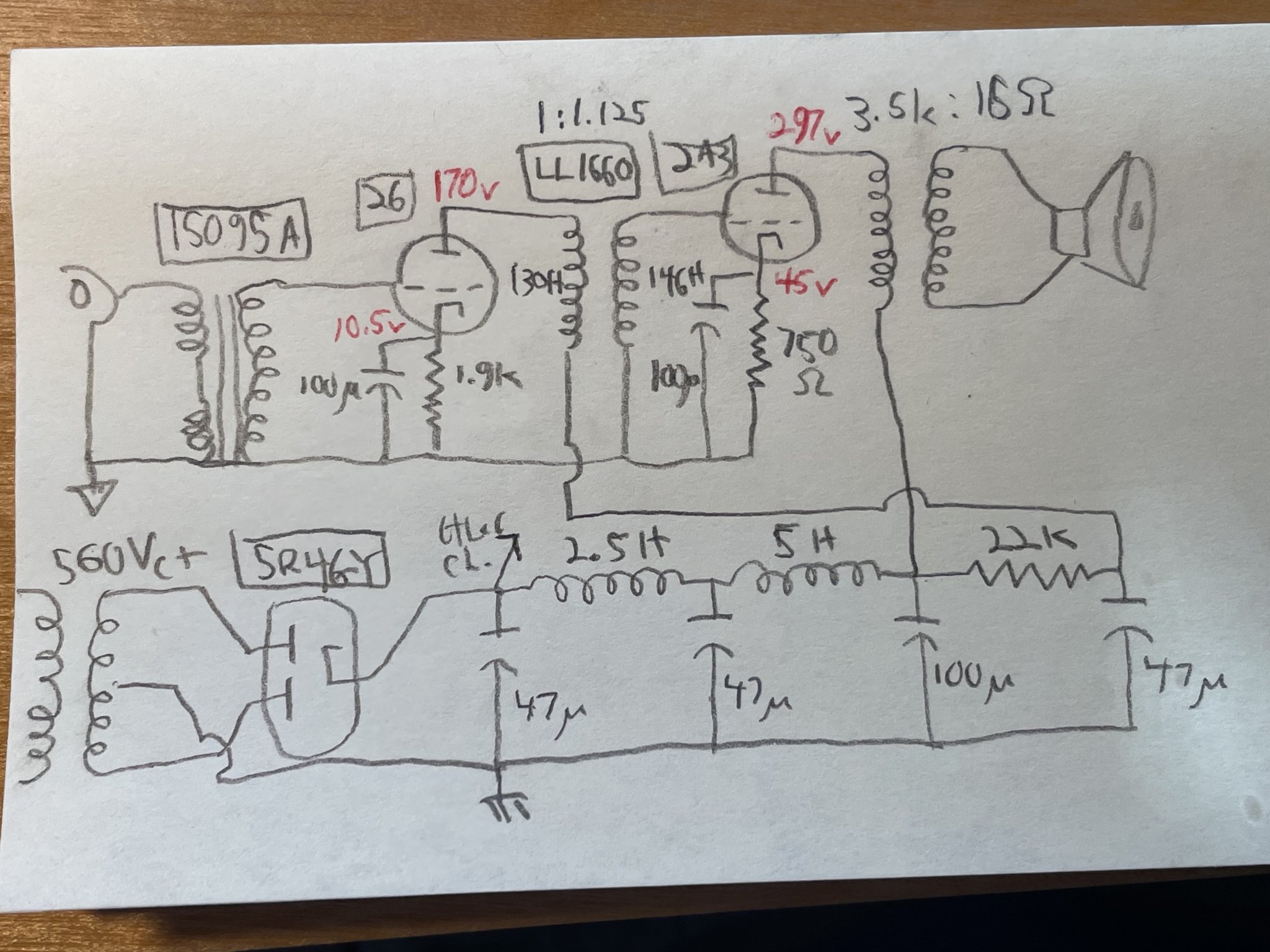

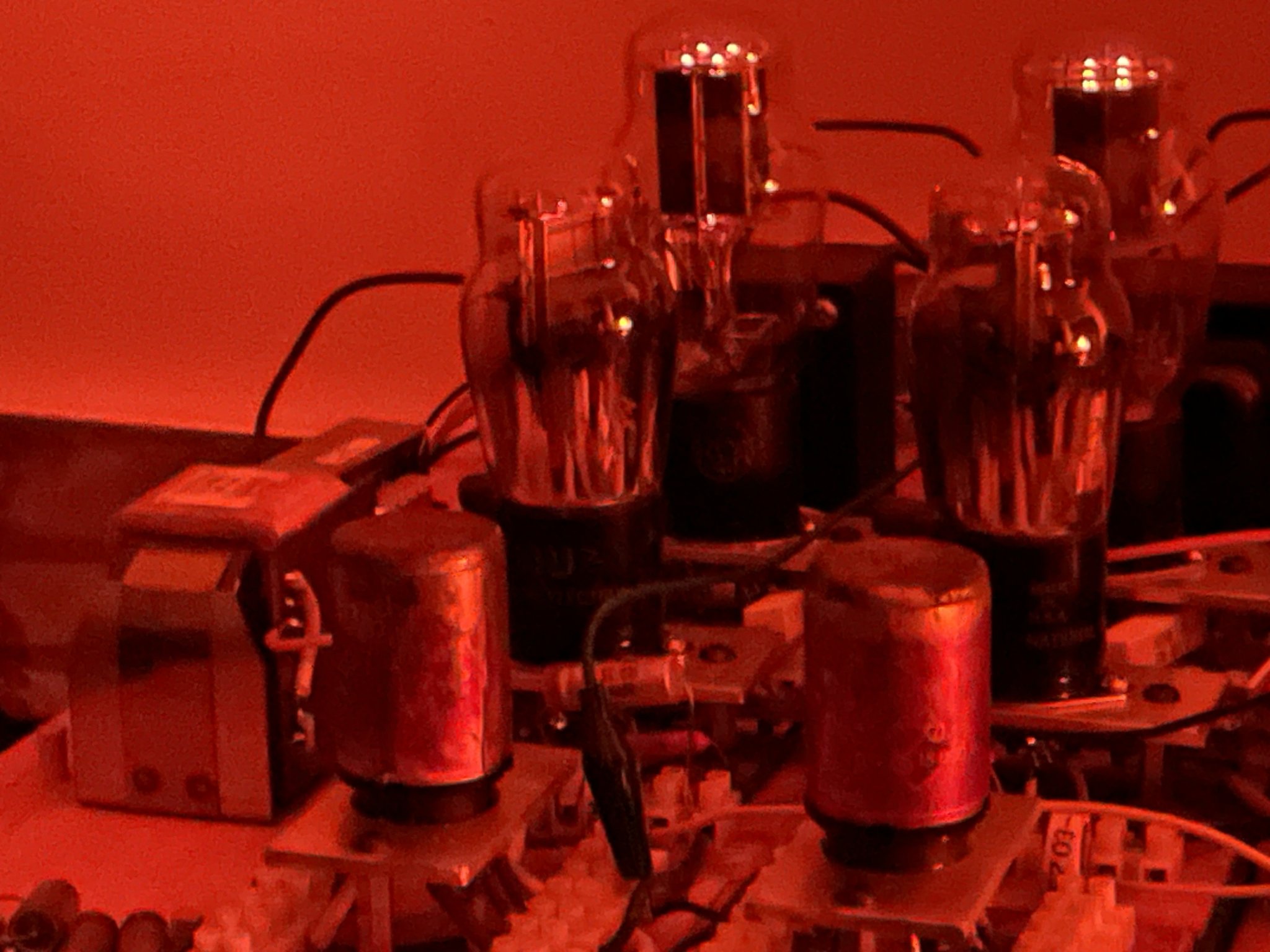

I've now switched from the choke-loaded 26 cap-coupled to the 2A3, to an interstage transformer. It's the Lundahl 1660 wired in the "S" configuration. It provides a slight step up (not needed) of 1:1.125, with 130H on the 26 anode and 146.25H on the 2A3 grid.
I might flip the IT around so that the slight step down would decreased the drive impedance a little, and also provide more inductance on the 26 anode. It doesn't need any of that, though.
26 -- 160V/5.5mA
2A3 -- 250V/60mA
It's difficult to articulate the sonic difference from the choke-loaded, cap-coupled version. Most of the performance is similar: snappy, incredibly detailed, very easy sounding. From the resistor-loaded to the choke-loaded 26, the shift in character was more inward -- it brought out more of the inner life of the music (i.e. the timbre and internal resonance of acoustic instruments, tonal complexity) and had a much faster-sounding response. The IT is a step further in that "inward" direction and I like it very much. It's hard to say, but I think I prefer this even over the choke-loaded cap-coupled version. It has all the benefits of the choke-loaded cap-coupled but sounds more fluid.

I've now switched from the choke-loaded 26 cap-coupled to the 2A3, to an interstage transformer. It's the Lundahl 1660 wired in the "S" configuration. It provides a slight step up (not needed) of 1:1.125, with 130H on the 26 anode and 146.25H on the 2A3 grid. It's difficult to articulate the sonic difference from the choke-loaded, cap-coupled version. Most of the performance is similar: snappy, incredibly detailed, very easy sounding. From the resistor-loaded to the choke-loaded 26, the shift in character was more inward -- it brought out more of the inner life of the music (i.e. the timbre and internal resonance of acoustic instruments, tonal complexity) and had a much faster-sounding response. The IT is a step further in that "inward" direction and I like it very much.
I have a pair of good amorphous core NP plate chokes, 130H. In my case I went back to resistor loading. The sound was more natural and free. The plate choke was a little more closed in with a more wooden piano tone. But I used a B+ of at least 360V, a resistor of not less than 39K and a very good NOS resistor. Under 39K didn't sound good. More would be better still with a higher B+.
I used a LL1660 in step-down with a 10Y and that turned out pretty well. But that wasn't driving a 2a3, it was just as a preamp. Thomas Mayer, who uses a lot of Lundahl iron, only recommended the LL1660 in step-down.

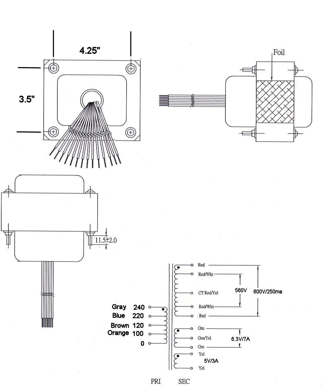

Thanks, yes working on that stacked PS now. This is probably a stupid question, but I’m going to use one rectifier tube and power supply to run the 26 and another rectifier tube and supply to run the 2A3. I have a power transformer with an HT secondary that has a pair of leads for 560Vct and another pair for 300Vct (attached). Can I use the 560V winding to run the 26 and the 300V to run the 2A3?
The center tap should connect to the PS negative, so I imagine that would have to be for the bottom rectifier (which operates closer to ground potential). I’m guessing it would not work because both HT windings have the same center tap and the upper PS would be erroneously referenced to ground.
Just wondering what’s possible and don’t want to hose any components.

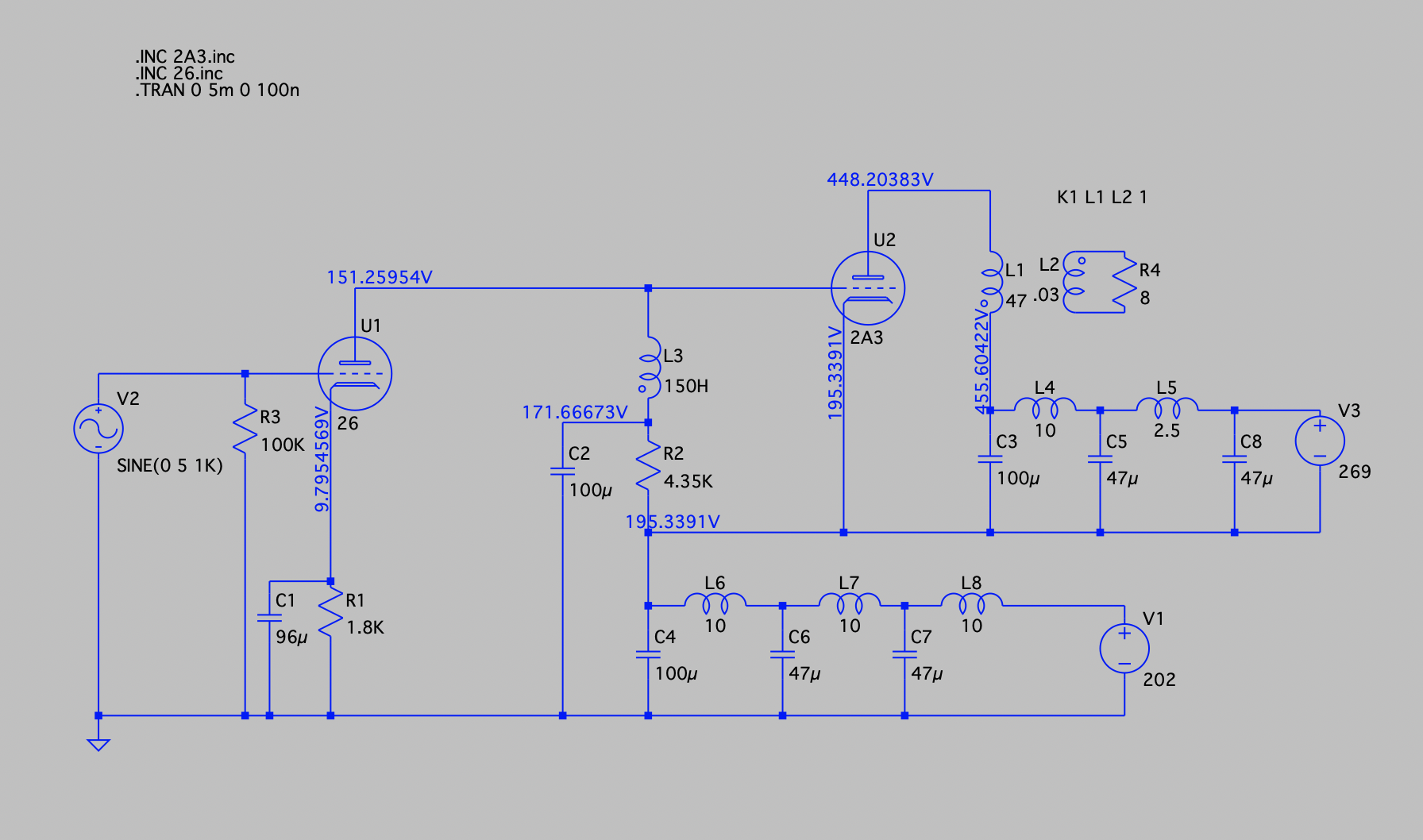

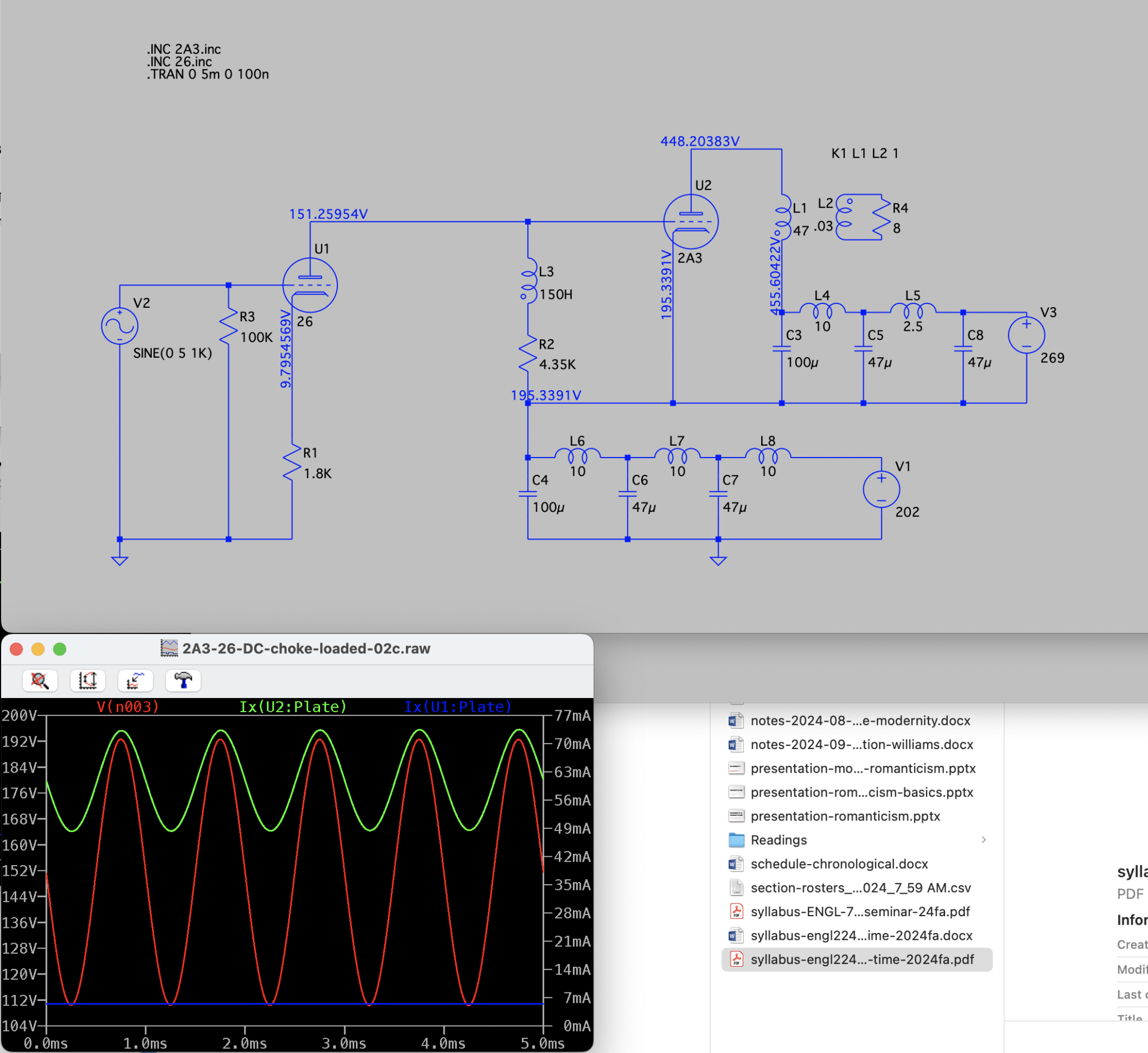

After some more calculating, I'm not going to bother trying to use both HT windings on one transformer. I have two others on hand that I can use with choke-input power supplies, which required different voltages than the PT above. I'm going to start with 660Vct and a 5R4GY to run the 2A3s, and a 190Vct with B-H cold cathode rectifier for the 26s.
Here's an LTSpice model of what I'm going for. It runs the 2A3 iat about 150V/60mA and the 26 at about 140V/5.5mA.
I've assembled substantial portion of it on the breadboard and plan to start testing it in a day or two.

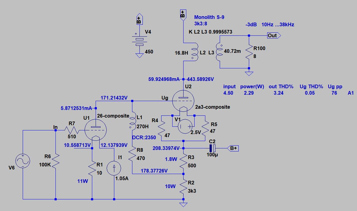

@J_Perkins : You mean like this (attached)? I'm curious to know your rationale for the suggested changes.
Removing C2 did not affect the voltage or current measurements, so it seems to be unnecessary unless maybe it would have an effect on frequency response.
C1 (26 cathode bypass) was there to increase gain, but removing it from the model has no effect on gain from the 26. Leaving it out would mean lower parts count and, I guess, theoretically more bandwidth, although F3 at that node was set to less than 1Hz. I suppose it can't hurt to remove an electrolytic cap from the signal path, too.
The placement of R2 and L3 (left unchanged here) is intended to choke-load the 26 tube. Are you suggesting that I swap places, to make it resistor-loaded?
Removing C2 adds 4k5 to the effective anode load (at all frequencies).
Switching R2 and L3 will help decouple the capacitance of the choke, so long as C2 is removed it is still choke loaded.
R1 at 1k8 will add >15k to Rp, it really needs a capacitor across it. Was meaning to find a way to reduce that resistor value (shunt some current through it).
