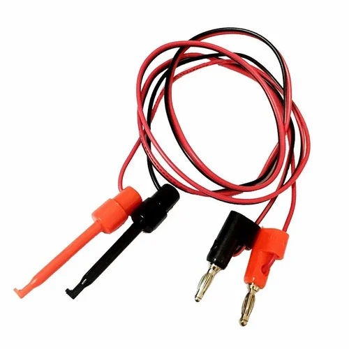

I made several hook clip-banana cables.

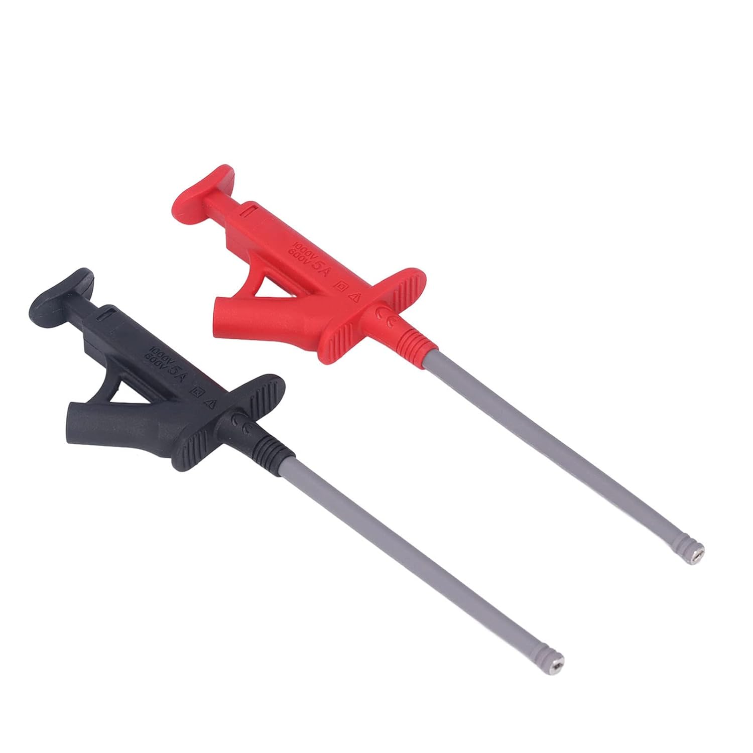

For HV (over few hundred Volts) I use kV certified testing probes.

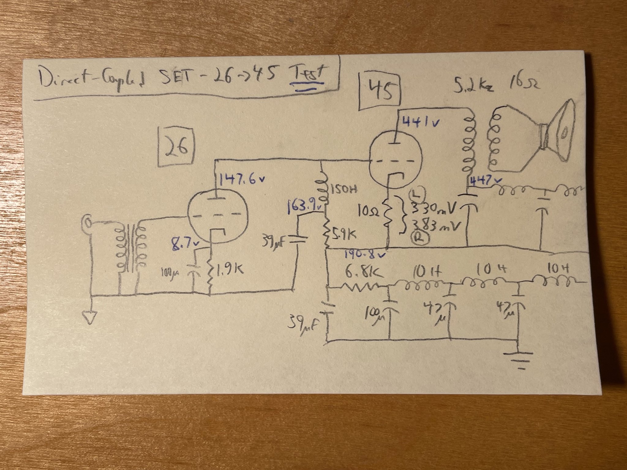

OK, update on the question I posted above in #557, about how to measure the plate current of a grid-biased output tube (2A3) that is also in the top rail of a stacked power supply. The question was essentially whether I should pay attention to the voltage difference between grid and cathode, or whether I could use the DCR and voltage drop across the OPT primary to calculate it using Ohm's Law.
euro21 suggested putting a 10R resistor from the 2A3 cathode to "ground" and measuring the voltage there. Since posting that question, I made a version of the same circuit using 45 output tubes, which required few changes to run correctly. The attached image shows the measured voltages in blue pen (sorry for the crowded drawing). What I found is that the voltage drop across the DCR is consistent with the voltage drop across the cathode resistor, so it seems the OPT is a reliable way to measure plate voltage, at least in this instance.
With only about -42V bias on the 45 tube, where I expected a -50V bias, I measured 33mA of plate current in one tube and 38mA of current in the other. These were consistent with a 6V and 5V drop across the OPT primary (DCR 154 ohm) respectively.
So, especially with direct-coupled circuits, where the network "below" the output tube has a complex effect on its bias, you can't just go by measured Vgk and the tube datasheet.
I need to bring the current down in the 38mA tube. But this is a very good sounding circuit, just like the 2A3 version.

The cathode resistor was just a temporary installation to measure the plate current, which I did by measuring the voltage across it. The resistors were a true 10 ohms (according to my Klein DMM), and at 330mV (left channel) and 380mV (right channel), the plates therefore were at 330/10 = 33mA and 380/10 = 38mA respectively. This is a temporary detour with a 45 in the output stage, just to have something to play around with until the anode chokes arrive for the 10Y, at which point I'll put the 2A3s back in.

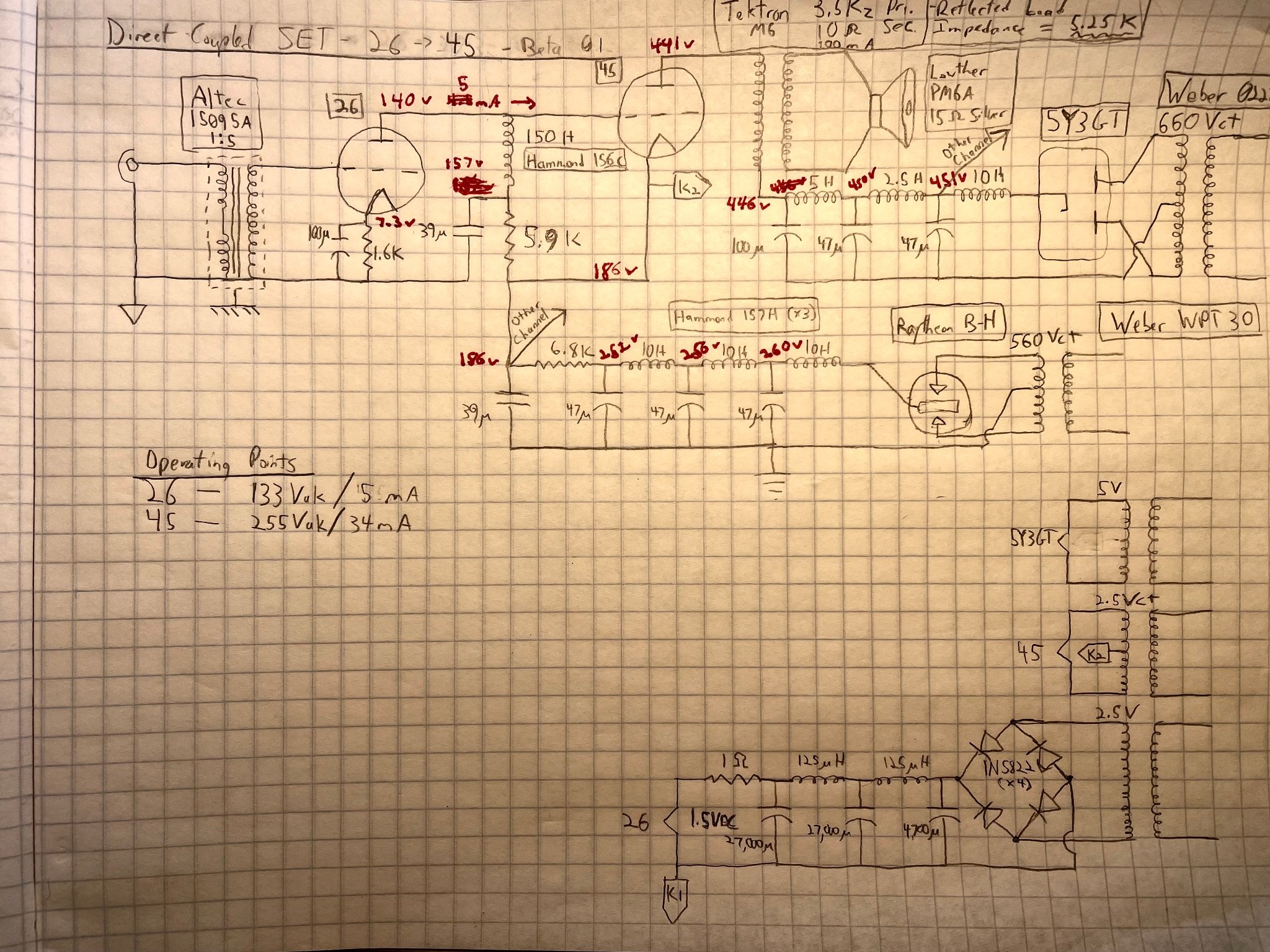

Here is the schematic of the 45 SET that's on the breadboard, which I've been listening to for the last couple months while waiting for the Lundahl anode chokes to arrive. I ended up adjusting the voltages so that the 26 is operating around 133V/5mA and the 45 is at about 250V/34mA. Experience has shown me that the Goldilocks Zone for the 26 is 4.7mA to 5mA, and no more than that. After many trials of various operating points on both tubes, this combo is just right.
This sounds excellent. I plan to build it as a standalone integrated amp once all the experimenting is done.
The schematic is descriptive, as I used parts on hand so as not to purchase any more for now. For a final build, I would probably boost the two 39uF caps (Axon polypropylene film) to 100uF film, but that's about it. This is an amp I could happily live with in my small home office with the single fullrange driver setup in here.
A note about the OPTs: these are custom units that a friend ordered from Tektron in Italy and sold to me a few years ago because they no longer suited the project he was working on. They were spec'd for 3.5Kz primary impedance with secondaries at 6ohm and 10ohm, rated for 10 watts, and have M6 laminations. I have the 15ohm Lowthers connected to the 10ohm secondaries, which produces a 5.25K load impedance on the 45 tubes for an estimated damping factor of about 3.28. The 6ohm secondaries connect to headphones via an L-pad with two 3-ohm non-inductive wirewound resistors per channel, which sounds surprisingly good as well. Overall this design is a very good use scenario for these Tektron OPTs that were customized for someone else's project, and that feels good!
