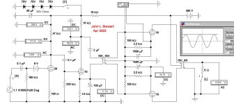

OK, I gave myself a break and breadboarded the Fi X. Actually I started with lower voltage versions just to make sure it was safe, and then got to the point you see here, which sounds the best. The 2A3 is running at about 274Vak/30mA and less than 9 watts. Pretty far below a normal op point.
The attached screenshot shows the signal circuit and voltage readings, which are within a volt or two of what I'm measuring on the board. It sounds pretty good but I need to listen for longer in order to form a stronger impression.

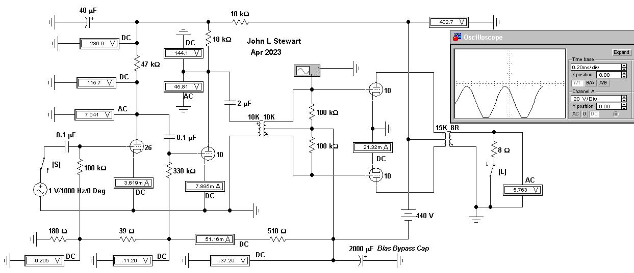

There appears to be quite a bit of interest in the 10, so here is a first pass that uses three of them.
The performance is somewhat disappointing, with a 1.1V input grid current is reached in the PP 10s.
And only 4.3 watts of audio before losses in the OPT. All even tho I picked a somewhat steep PP loadline for 10s.
To complicate matters, four different DC heater supplies are required for this configuration.
There is a slick fix for that, something I found useful on a project about 20 yrs ago.
Coming to these pages in a couple of days. 👍
A quick look at the PP Class B numbers look impressive until we realize the power gain is only 10 db.👎

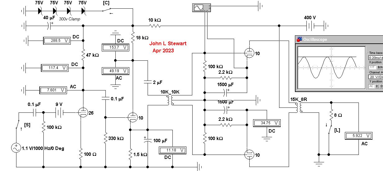

10/10Y/VT-25 is less usable as output power tube (as driver -especially as DC coupled- it's perfect) due to the less power.
Instead of its usually used (oxide coated filament, larger plate surface and dissipation) VT-25A, mainly as PP amplifier.
See in Thomas site:
http://vinylsavor.blogspot.com/2012/02/tube-of-month-10y.html
20W plate dissipation (thoriated tungsten filament) 801a is an alternative.

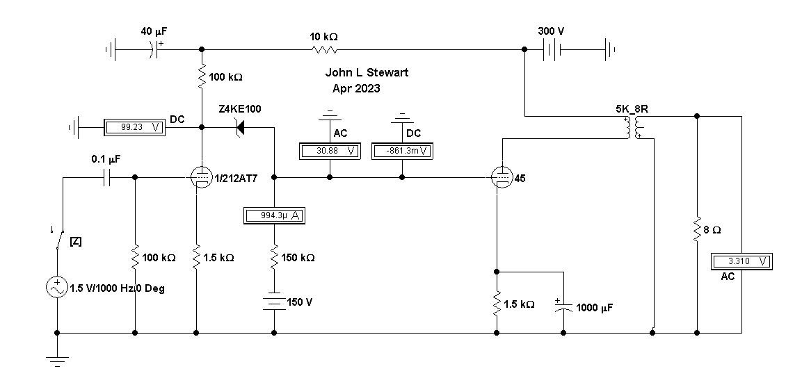

Here is what I had in mind, direct drive to the 45 by way of DC shifting.
In this Sim by a 100V Zener, we used to use selected neon bulbs like the NE2.
Some folks will worry about the Zener noise, that can be minimized by a small cap across the Zener.
The cct depends on a -150V supply but only one mA in this case. Real easy to do when using a common HV CT PT.
And very minimal RC coupled hum filter. I've used neg supplies for many yrs with zero problems. 👍

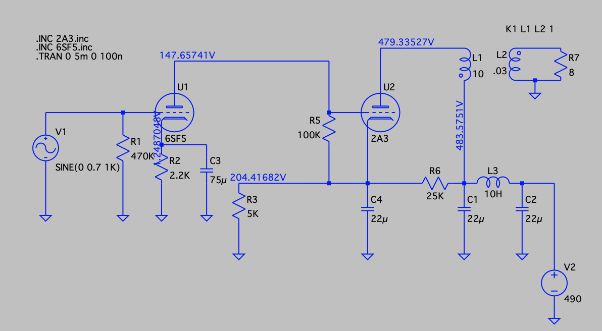

6SF5 is basically the single triode in a 12ax7. It is really a poor choice to drive 2a3. It's a wimpy driver.
Now let's see why with some simple math.
1. Let's calculate the 2a3 reactance. Total reactance X = Xc + Xi , where Xc is the capacitive reactance and Xi is the inductive reactance. For sake of simplicity, we will ignore Xi and just consider Xc (however, Xi can be significant in some circuits).
Xc = 1/2(Pi*f*c) = 15915 Ohms. - where f= 100kHz and c= 100pF. Let's just call it 16k Ohms for simplicity.
Why 100KHz? Because if the driver can't drive the Miller capacitance at 100kHz then 10kHz will be phase shifted and distorted.
2. Now we know the reactance, we can do a simple calculation to find out how much current the driver circuit needs:
For 2a3 we would probably like to swing 100V RMS for full power. And we know from the above that that the Reactance required for 2a3 will be around 16k ohms. This means we need 100V/16kOhms = 6,25mA minimum. From personal experience, you should try for 10mA for 2a3.
Your 6SF5 is not going to do this. Perhaps if you don't turn up the volume much then it might sound ok enough though.
You could try to reduce the 2a3 miller capacitance by going for fixed bias instead, but then you need a whole re-design. It's easier to use a solution like a MOSFET follower, or use one of those triode strapped pentodes, or maybe choose an input/driver that has less gain but runs more current, etc.
One nice triode strapped pentode is the D3a. But they are getting pricy. There are a few russian triodes that can drive 2a3 and even 300b, but getting a matched pair of 6C45P-E can be challenging and they are also getting pricy. Maybe you can find some 5842's instead of 6SF5. Gain will be less but the sound will be much better with 5842 running 10mA.
Or go for the MOSFET follower.

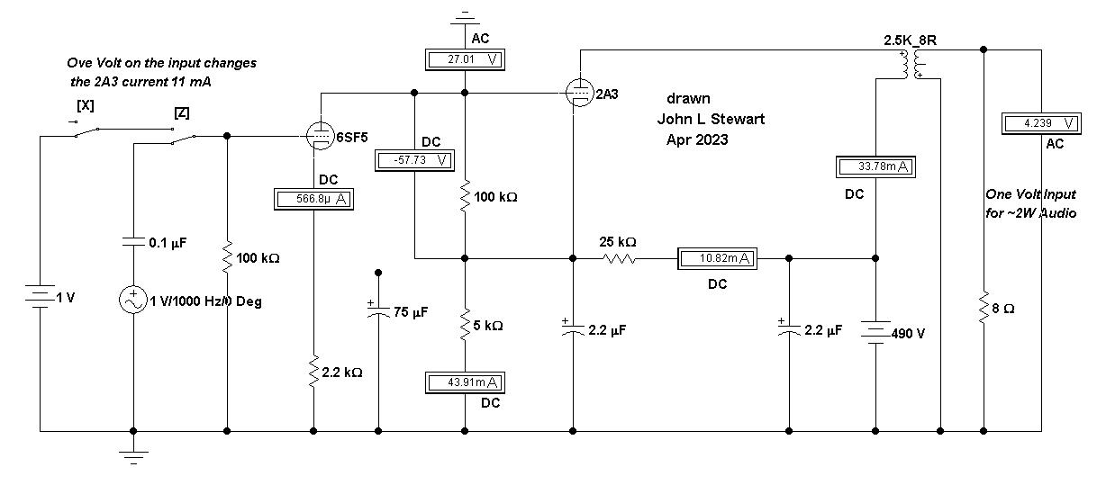

The circuit on p381 clips with only 0.5 v in. That shifts the 2A3 operating point toward cutoff.
In the Sim the 6SF5 cathode bypass has been unhooked so that a One volt signal in works OK.
The input spigot is DC coupled & needs to have a cap to isolate for DC. A one volt DC change at the input causes the 2A3 current to change by 11 mA.
The 490V supply & only Two Watts audio for me is an end to the project. But many others have built this & are happy.
In previous work in these pages a few months ago I found with the 2A3, the drive tube had to contend with up to 200 pF,
2A3 Miller C, 2A3 input C & wiring strays, Add to that the 6SF5 output C, Half of an ECC88 would solve that problem.
The circuit wastes a lot of power, especially in the B+. So the required PS is heavy.

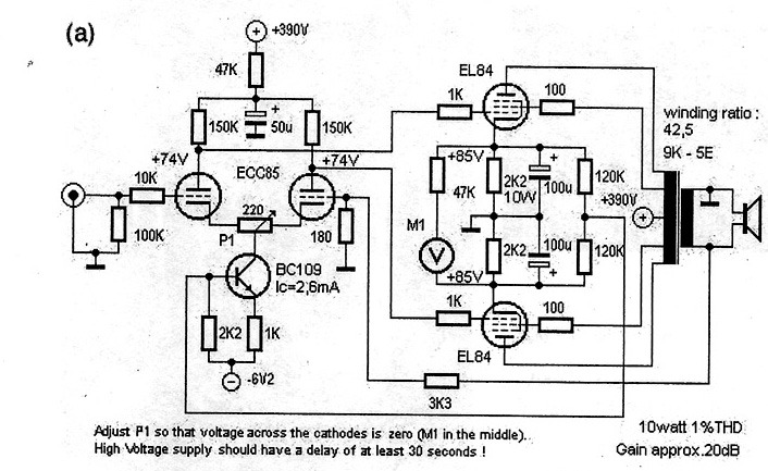

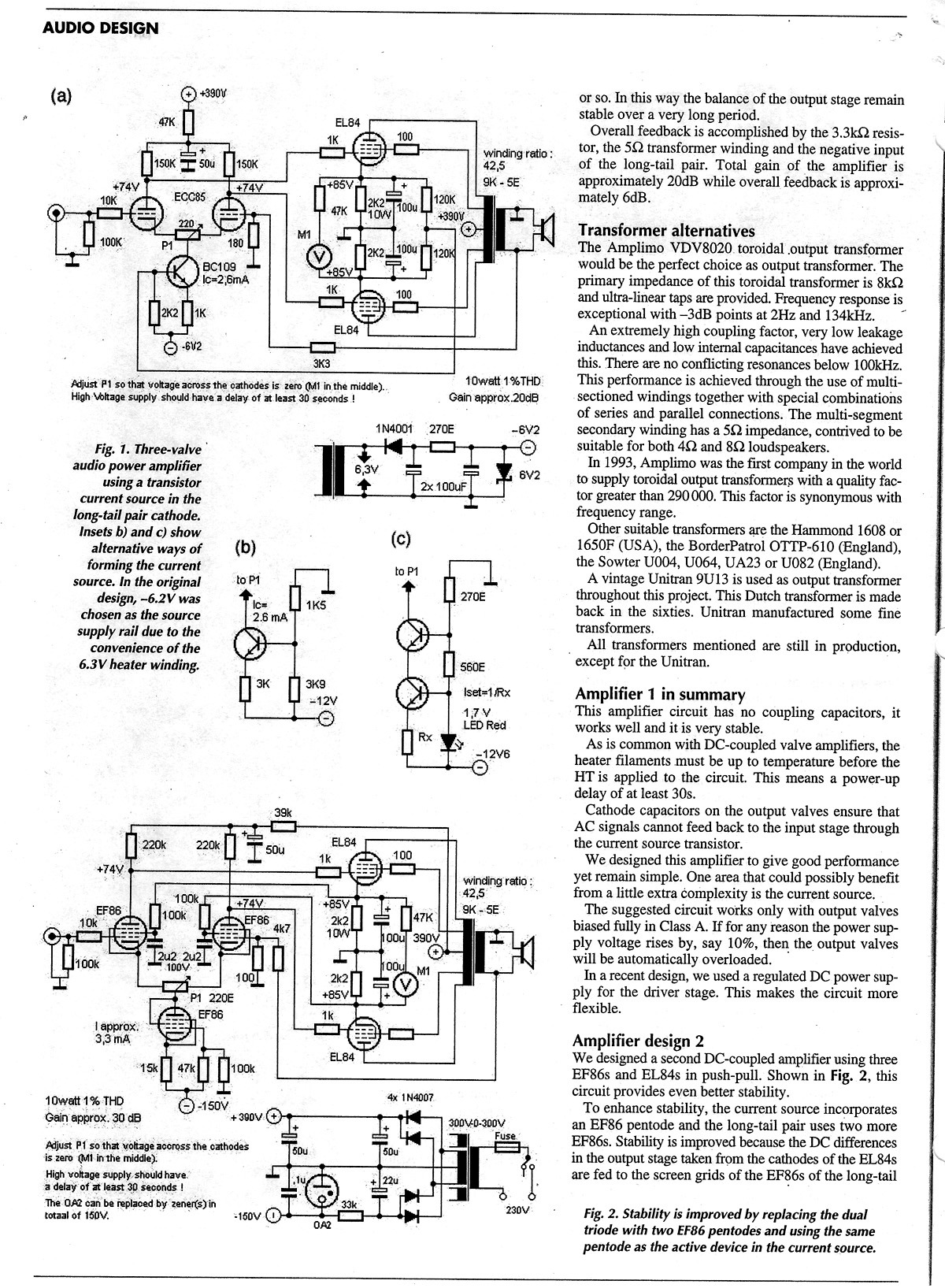

PP versions of this configurations have also been published.👍
