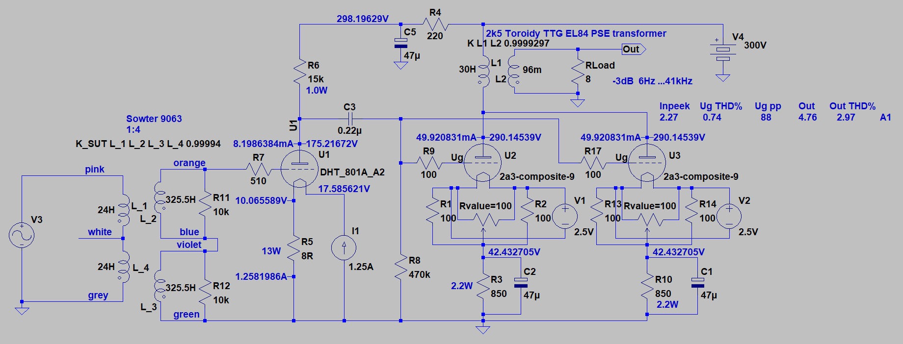

IMHO 10Y/801a a bit overkill to drive 2A3 PSE, but it's working.
The B+ is low for R loaded 10Y/801a (low anode current), so it's distortion in the higher side.

euro21, thank you for this scheme.
I just realized this is not a loose thread, it's Jdruin's thread. Sorry for the intrusion. I'll ask the last question and leave.
Euro21, so what should be the optimal B+ for a driver?
In the new amplifier I intend to build a separate power supply for the driver and the output tube. And one more question, where did you make this diagram that you have now presented here? Is it some kind of simulation software???

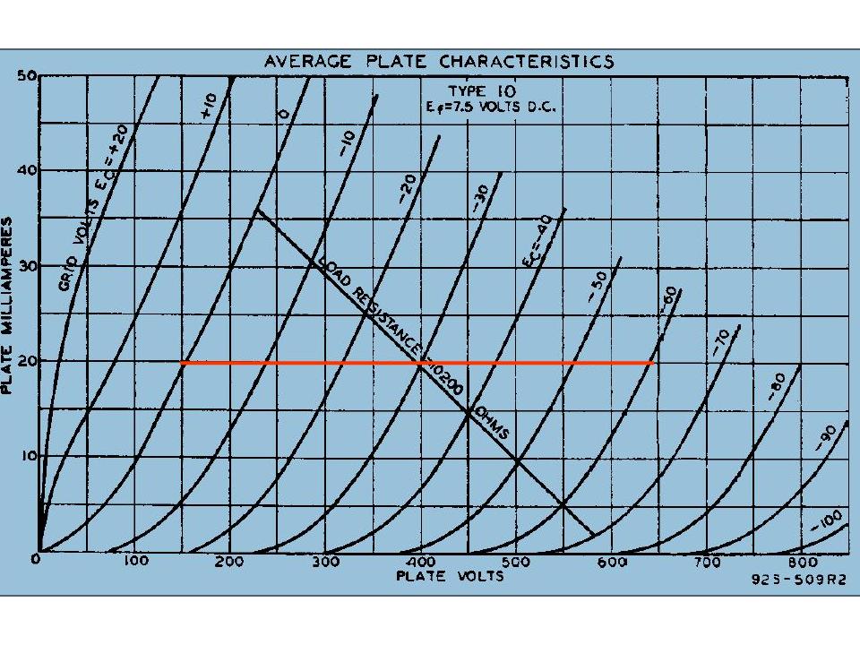

My biggest problem is that the Ua and current is low, so optimal operating point (see 10Y curves) is relatively far (mainly due to the resistive load).
If you want it as driver (150-200Vpp), the Ua must be about 300...400V.
These tubes requires large impedance load, so if it's resistive, it must be -at least- 10..15k.
If you choose the simplest load (resistor) and want to set enough large anode current (in 10Y/801 family is about 15..25mA), the plate load resistor dissipation will growing, and required B+ go to the sky:
Rload voltage: 15k*0.020A = 300V (300V * 0.02A= 6W)
Required Ua: 400V
Summarized B+: 700V !!!!
As you can see, better option to use choke loading (disadvantage large induction: 150..200H), or active load, like CCS/gyrator.
The red line represents 20mA CCS, so the 200Vpp swing (from 0V curve to about -24V curve) feasible with this operating point:
-12V, about 275V, 20mA.
The required B+: 275V + 100V (swing pp/2) + 30V spare for CCS ... about 405V, so 410..430V is appropriate.
As you can see, it's easier to implement than 700V.

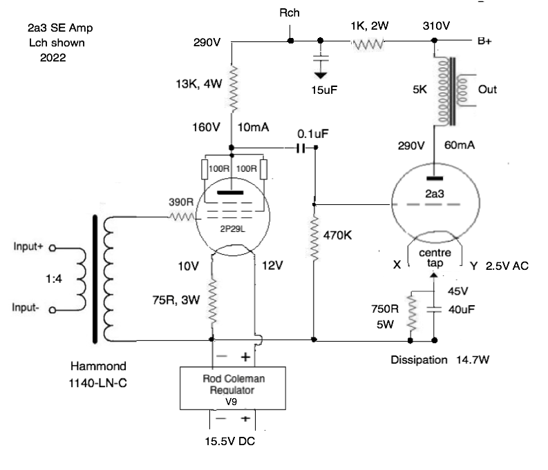

Yes - I ran CV1135 into 6C4C for several months before replacing it with a DHT and the 1140-LN-C front end. Very good indirectly heated tube - probably the best I've used. DHTs were better, though, even the 2P29L which is very easy to use in filament bias. I use a resistor load on the driver stage with FT-2 teflon caps.

As for the 10Y in filament bias. It's what I use and I like the sound even at 8.5mA with 15K anode resistor and 196V on the anode and 330V B+, 10.7V bias. I don't use active loads because I don't like the sound, and I prefer coupling with a FT-2 teflon cap rather than use a LL1660, which I have and have tried. I've tried all these alternatives and I chose the best sound for my taste, which is classical music, opera and jazz. Acoustic instruments and voices must be pure, clear, smooth and detailed with nothing artificial in the sound. I didn't get that with active loads or the LL1660. I do have some amorphous plate chokes which I haven't used for a while and they would enable a more obvious operating point, but I'm not in a rush to put them back because I like the sound as it is. The operating point is an endless juggling act in filament bias, especially with a resistor load, but I like the sound of it with no cathode bypass cap.

Your using a 0,082uf cap with a 470k resistor? That is just one break point in the ssytem.
You are losing a whopping ~17% of the bass at 20hz. 8.5% at 40hz, 4.2% at 80hz, and 2% at 160hz.

My calculation was that the low frequency cutoff would be 4Hz, plenty for just about any listening situation.
159,155 / 470,000 / 0.082 = 4.12
I typically find that smaller value coupling caps have a faster and more dynamic performance than larger ones of comparable design. I use vintage PIO almost exclusively (as in this case).
The breadboarded 2A3 amp is driving a pair of Lowther PM6A in self-built trapezoidal Onken cabinets, no filter. They produce plenty of bass to my ears.

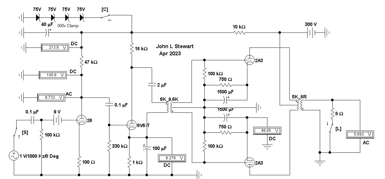

Something for Andy J's notebook who had commented how he had built many SE amps but was somewhat unfamiliar with PP.
This one has a DHT frontend that many audiophiles favor. In this vers the bias is simply a 9V battery.
There is a 300V Zener Clamp in the HV cct to prevent PS overvoltage at startup from damaging the 26.
There are many possibilities for the IT & OPT on the market.
The 2A3's are independently biased to minimize difference in their plate currents.
The 6V6 driver circuit is common & used by many audiophiles for a long time.
CG McProud, one of the founders of Audio Magazine used a similar driver in his circuit published in the March 1948 Issue of the magazine.
He added a limited degree of NFB in the driver part of the cct. But did not include the output section.
With a One Volt input this vers makes about 4 watts of audio before losses in the OPT. 1.8V gets about 10 watts of audio.
Something to think about. 👍

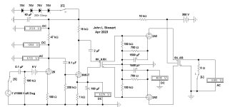

In the schematic I see that it is only used for the 10y tube, would it be a good idea to use it also for the 2a3 tube?

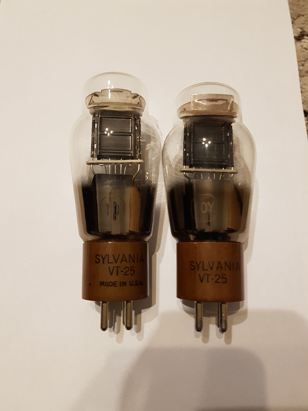

The difference is in the base.

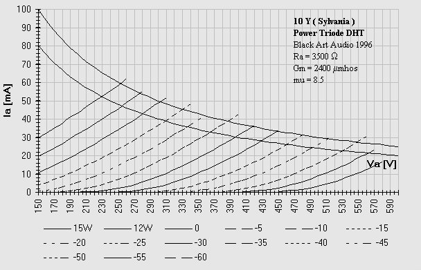

RCA Type 10 and -for example- Sylvania 10Y curves are quite differs.
See current at 400V, -30V, or 0V curves.
10Y curves shows even 15W dissipation limit (12W is more reliable and safer), my 10 tubes "saturation" never reaches 7.5W.
BTW all of my Sylvania (or Hytron) 10/10Y tubes has similar base.
