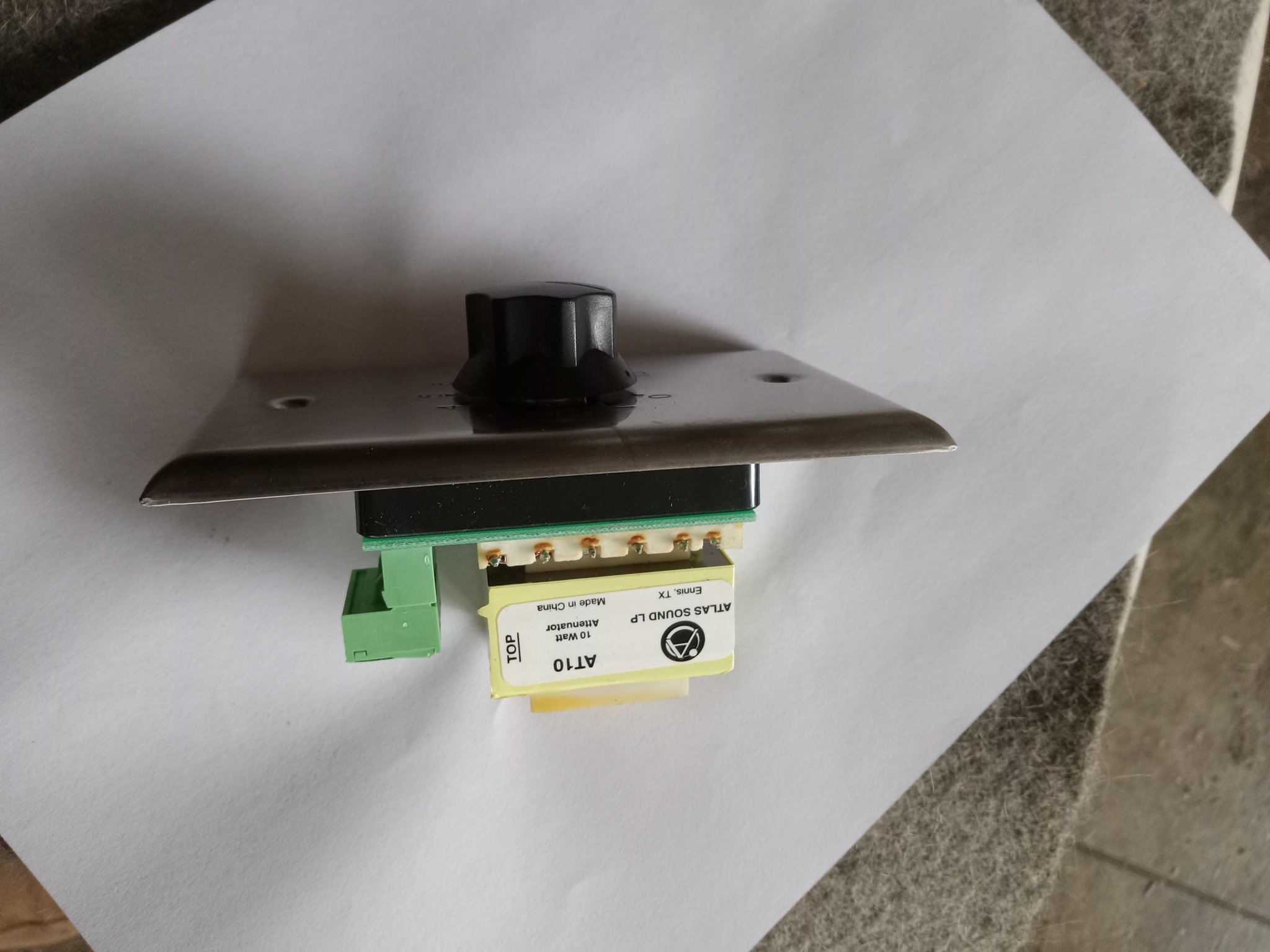

For those who want a basic auto transformer volume control without robbing a bank, I would highly recommend Atlas Sound AT-10. It is 600 Ohm and has ten 1.5 dB steps. Within 1 dB 20-20,000 Hz. Full winding inductance is about 130 H. It works well in front of input transformer. It is transparent and does not add any coloration. The price is $15-20.

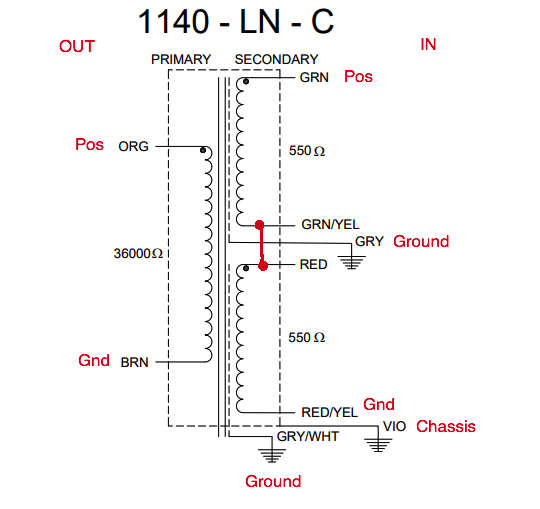

how do you wire the 1140 LN C - do you parallel the 500ohm secondary? I have not used an sut before.
And is it possible to use battery bias with it?
Yeah, I'm using the Hammond 1140-LN-Cs with battery grid bias in the directly coupled amp I've got on the breadboard.
Just wire the orange wire (positive output from the Hammond) to the positive battery terminal and the negative battery terminal either directly to the tube grid or to the grid stopper resistor if you're using one.

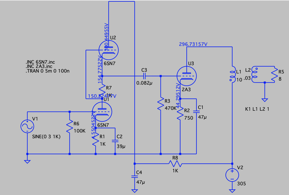

I'm installing the 6SN7 SRPP on the breadboard now. Going to start with 1K resistors for an operating point in each section of 150Vak/4.5mA.

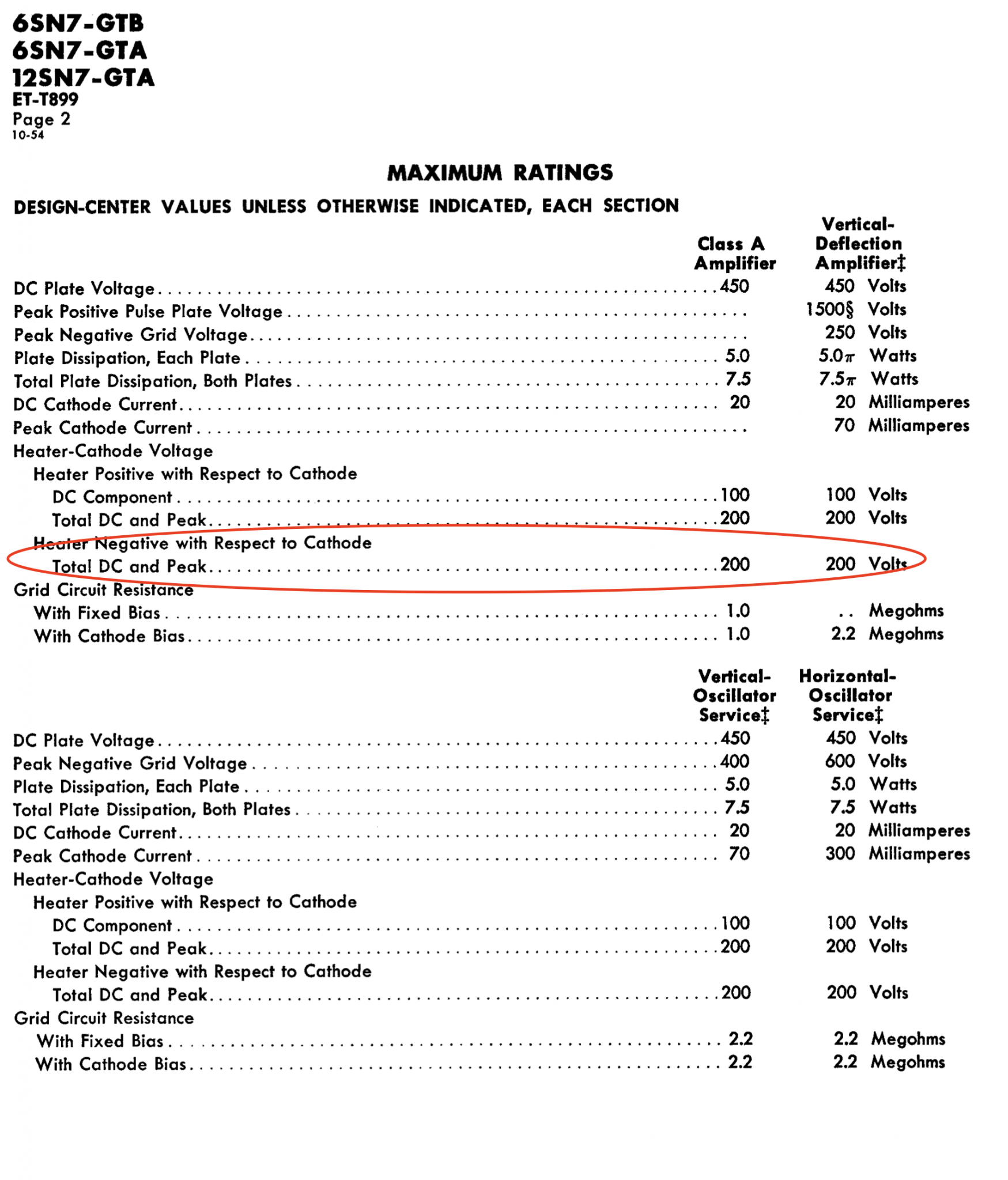

I was assuming that I would need to elevate the 6SN7 heater voltage so that the cathode of the top triode does not exceed the heater-cathode limit (as you need to do with 6SL7). However, the datasheet says "Heater negative with respect to cathode -- 200 volts" (schemo and datasheet screenshots attached). If the heater transformer center tap is grounded and the top cathode is at about 155V above ground, then I don't need to elevate the heater voltage, correct?
Seems like a silly question but for some reason my gut doesn't trust it. Maybe it's time to sleep.
Some people including myself tie the heater center tap to the top of the power amplifier cathode resister.
That elevates the heater cct somewhat & relieves to a degree the concern you have.
The amp here in the workshop built in 1968 runs that way everyday, never a problem. 👍
Like we tend to do to politicians and preachers, we tend to have a TBMF (touching, but misguided, faith) in some valve specs from old manuals. Some things are very process sensitive, including excess noise, grid current and heater-cathode relations. Basically, these many decades later, modern production has no real relation to the specs in some old valve manual, and original valves from that manufacturer and era are not necessarily the same anymore themselves. We long for predictability, but we can't always get what we want.
Decouple from the cathode with something like 100K & bypass that to common with 0,1 micrioF.
That way if there is a problem in the heater line it does not remove the bias from the power audio tube.
