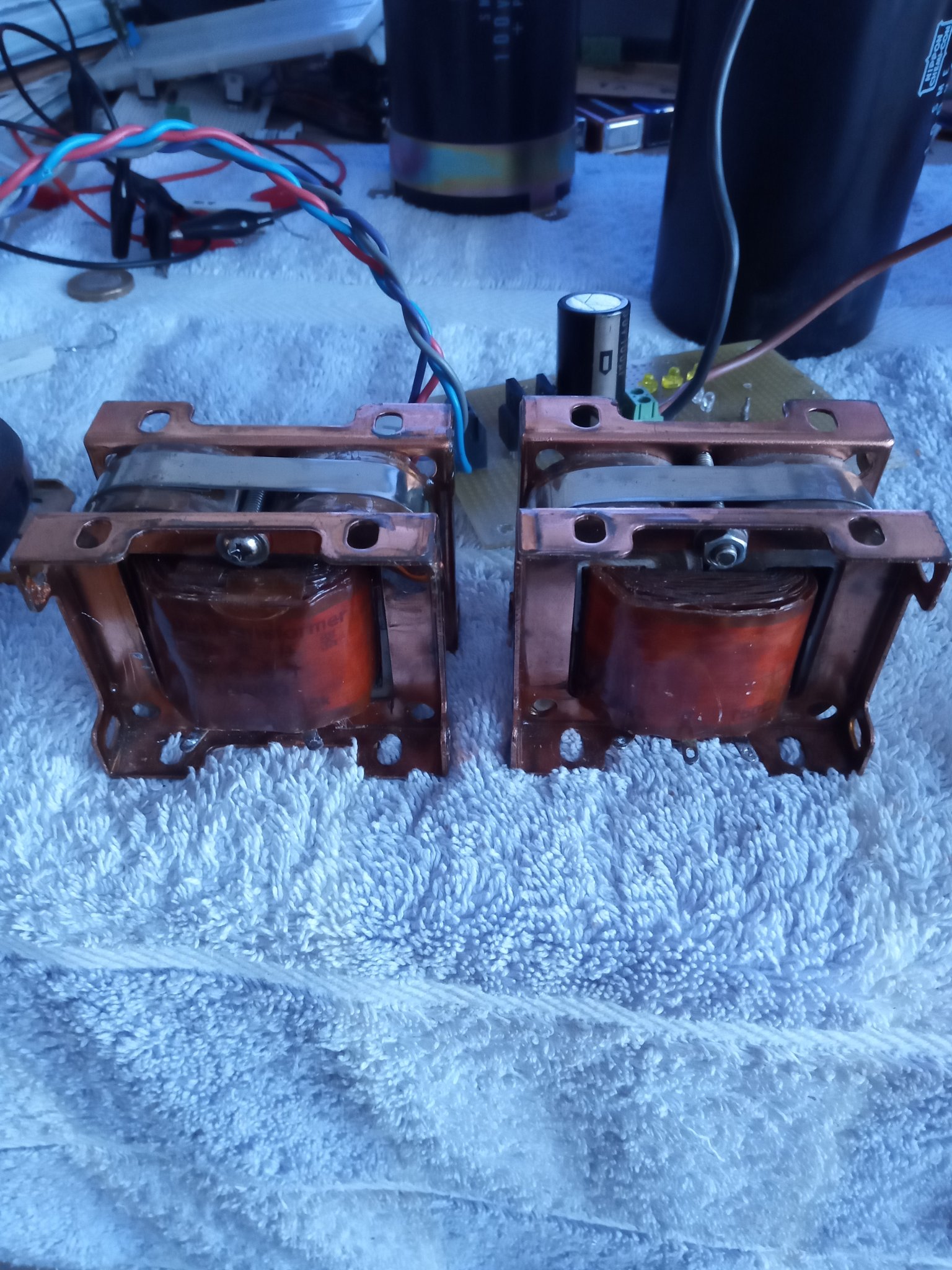

I own these 15K-300R double c-core amorphous so 7:1 and sounds very very good the primary inductance is 54H

I load the 15KΩ primary with 50Ω source impedance & the secondary 300Ω with 100KΩ or more, so no problem.
