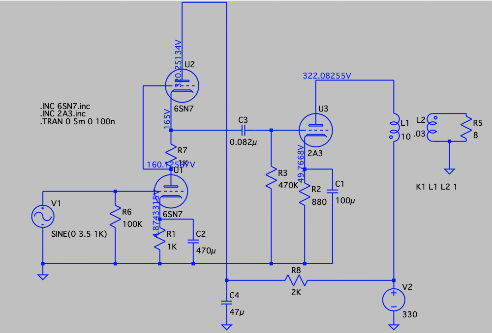

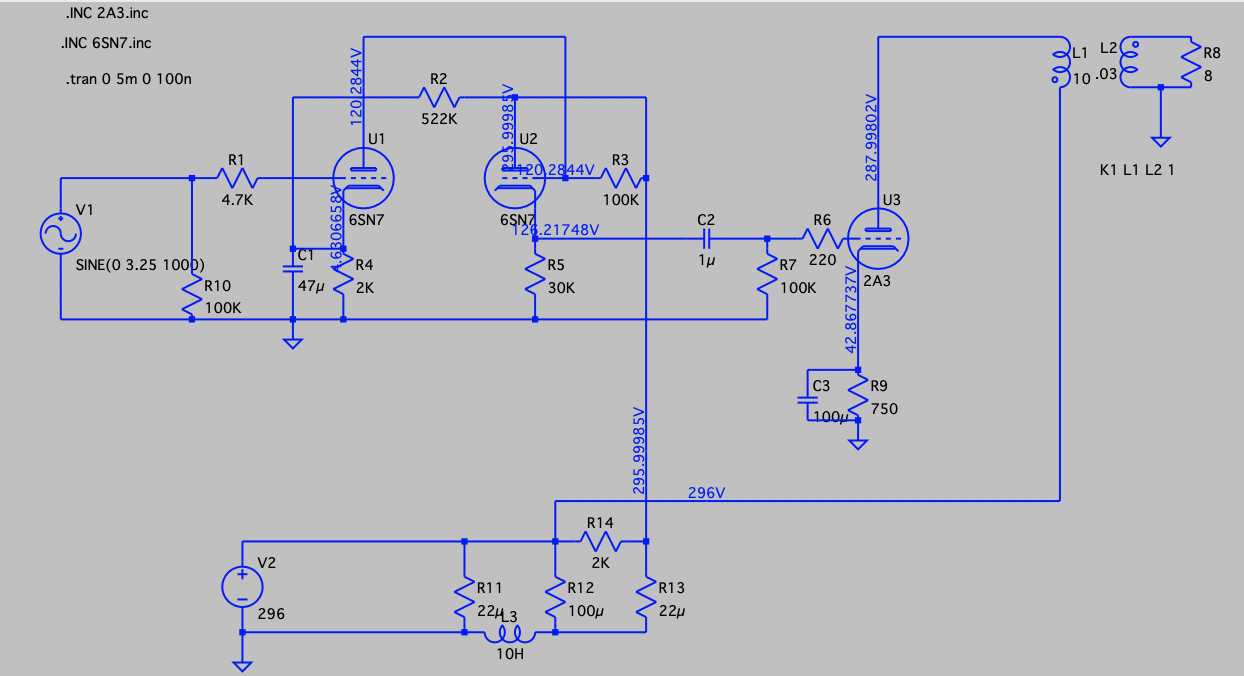

It's possible to drive a 2A3 with a 6SN7 in SRPP (biased at 4.8mA in the attached screenshot). That leaves an input sensitivity of 3.5V and would require a preamp or an additional input stage. Might not be a bad option.
Anyway, I'm going to keep thinking about how to get enough drive current and lower impedance out of a 6SL7 -- cathode follower maybe?

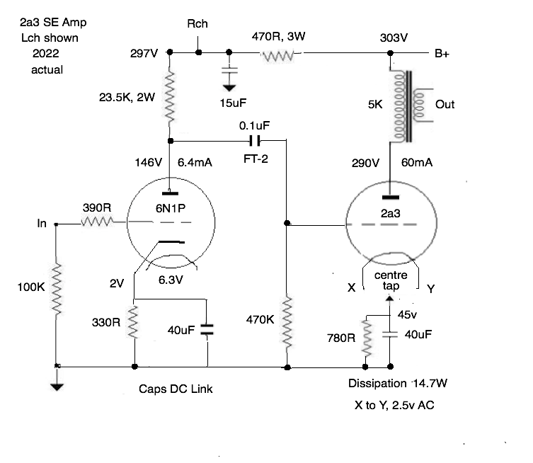

On a 45 SET amplifier I built, ultimately settled on a (gyrator-loaded) 6N1P for the gain it provided and the bias point flexibility it offers.
You can use it for full amplification with a 1.4V RMS signal as well as a 2V RMS input. The 6N1P hit the "sweet spot" for full volume/output on every recording from my DAC streamer (2V RMS).

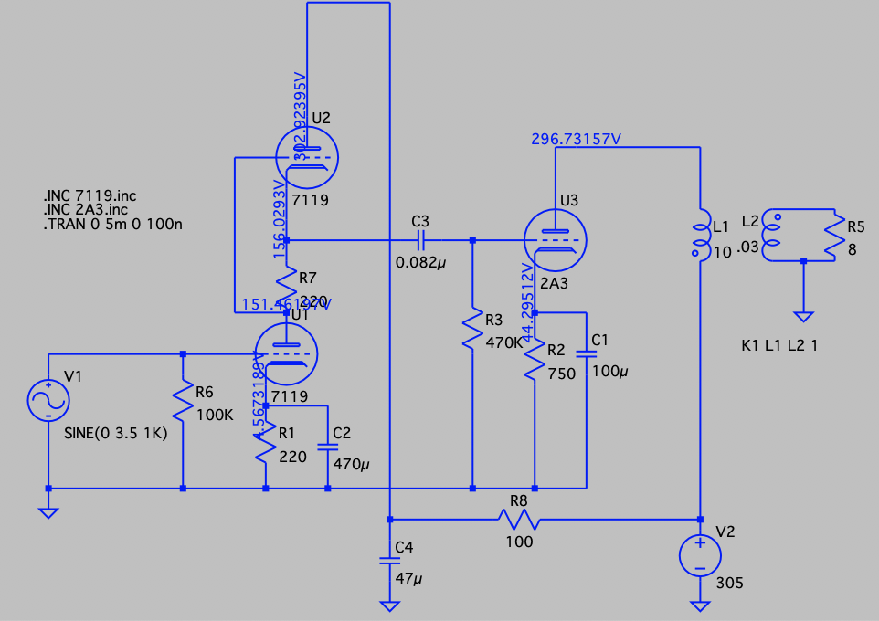

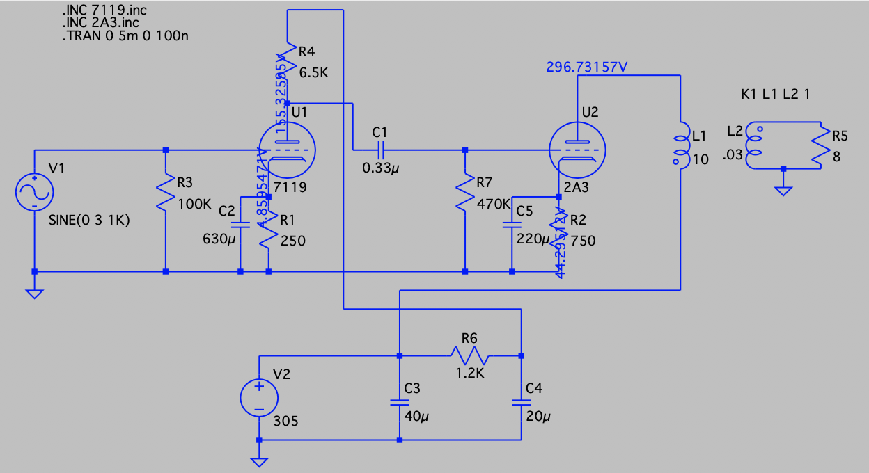

For the heck of it, I modeled a simple VA and SRPP versions of 7119 to drive the 2A3 in LTSpice. 7119 is a computer tube, but very linear, and designed to run at around 120V/36mA. The datasheets I've found do not list the plate resistance, but this site claims it is 1.6K, which is pretty low and might work well as a simple VA:
https://www.homecookingwithvalves.com/Vacuum-Tubes/Tube-Tables-and-Tube-Parameter-Values.html
Looking at the plate curves (datasheet attached), I figured 20mA would be above the elbows enough with 150V across the tube to operate in a very linear region. 20mA seems like overkill to drive the grid of the 2A3, but anyway screenshots are attached for the curious.
Perhaps a cathode-follower would work well with 7119 too.
However, I've already got a 6SN7 cathode follower stage in the mono blocks that drive my main system, so I'd prefer to try something else for the sake of experimentation. I reverse-engineered George Wright's WPA 3.5, a 2A3 SET, but am running a 300B instead (with MQ TFA-204 OPTs). The 6SN7 cathode follower stage puts 4.7mA into the 2A3 (300B) and it sounds great (screenshot attached).
The 7119 and 6SN7 have similar amplification factors -- 24 and 20 respectively -- so any way you configure them the input sensitivity is between 3.0-3.5V, meaning they need a line preamp or an additional input stage.

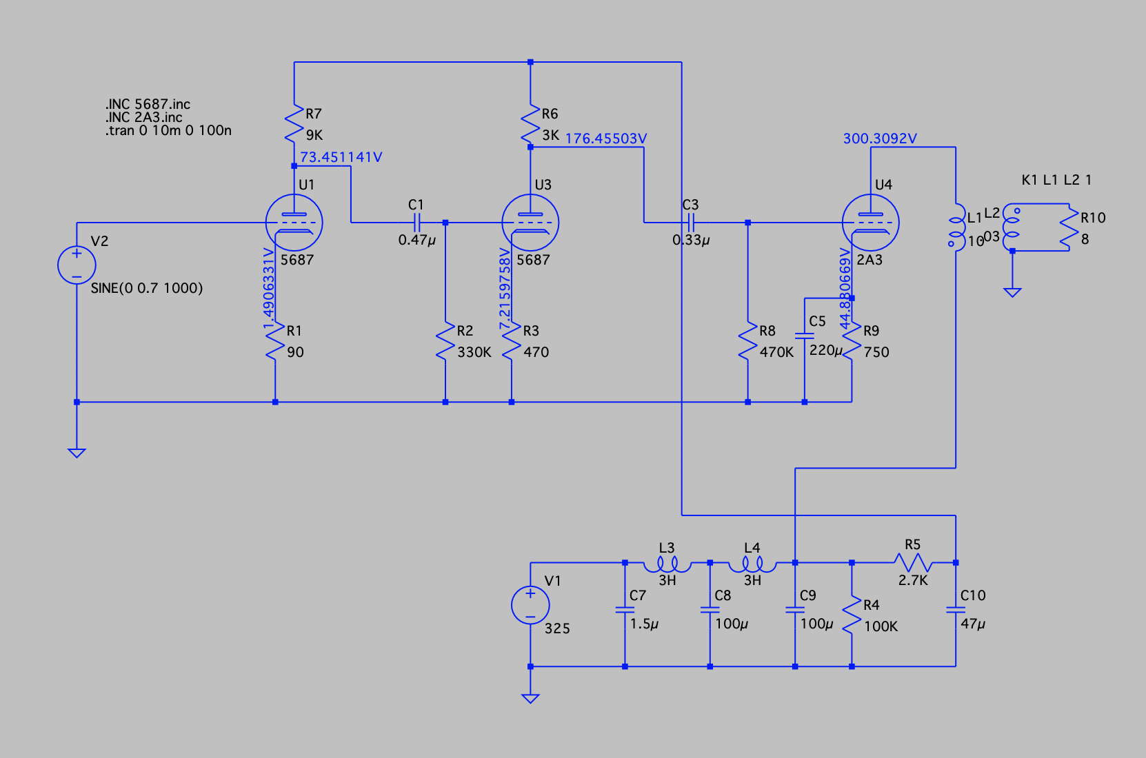

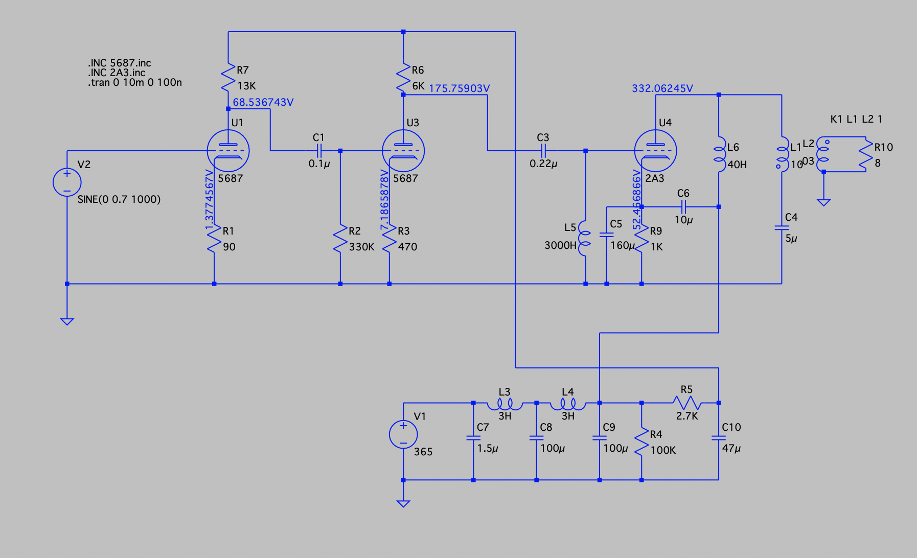

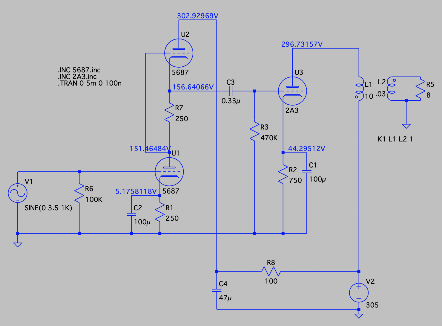

I came across Jean-François Lessard's Horus 2A3 circuit a few years ago, a parafeed design which uses 5687 for two voltage amps in series. The datasheet reveals 5687 to be a very linear tube with plate current in the range of 12-36mA during typical A1 operation, and plate resistance of 2K-3K in the operating range we'd be considering. It is also characterized by high perveance and high emission capabilities. My limited understanding of perveance is that it essentially refers to the amount of current a tube can handle, but I don't know how perveance might factor into audio circuit design.
Anyway, attached here are three quick 5687-2A3 designs in the following order: Lessard's original Horus, a non-parafeed version of it, and an SRPP version. I tried doing a cathode follower but it doesn't seem possible to get the required 120VDC or so on the 5687 cathode to drive the 2A3 grid. Operating voltages shown in the attached screenshots.
  • Horus: 5687 @15mA ea., input sensitivity 0.7V
  • Traditional VA-VA: 5687 @16mA ea., input sensitivity 0.7V
  • SRPP: 5687 @146V/20mA ea., input sensitivity 3.5V
The VA designs would work well as integrated amps while the SRPP would of course need a line preamp in front of it -- not the worst thing.
I dunno, does 15-20mA driving the 2A3 grid seem like overkill?

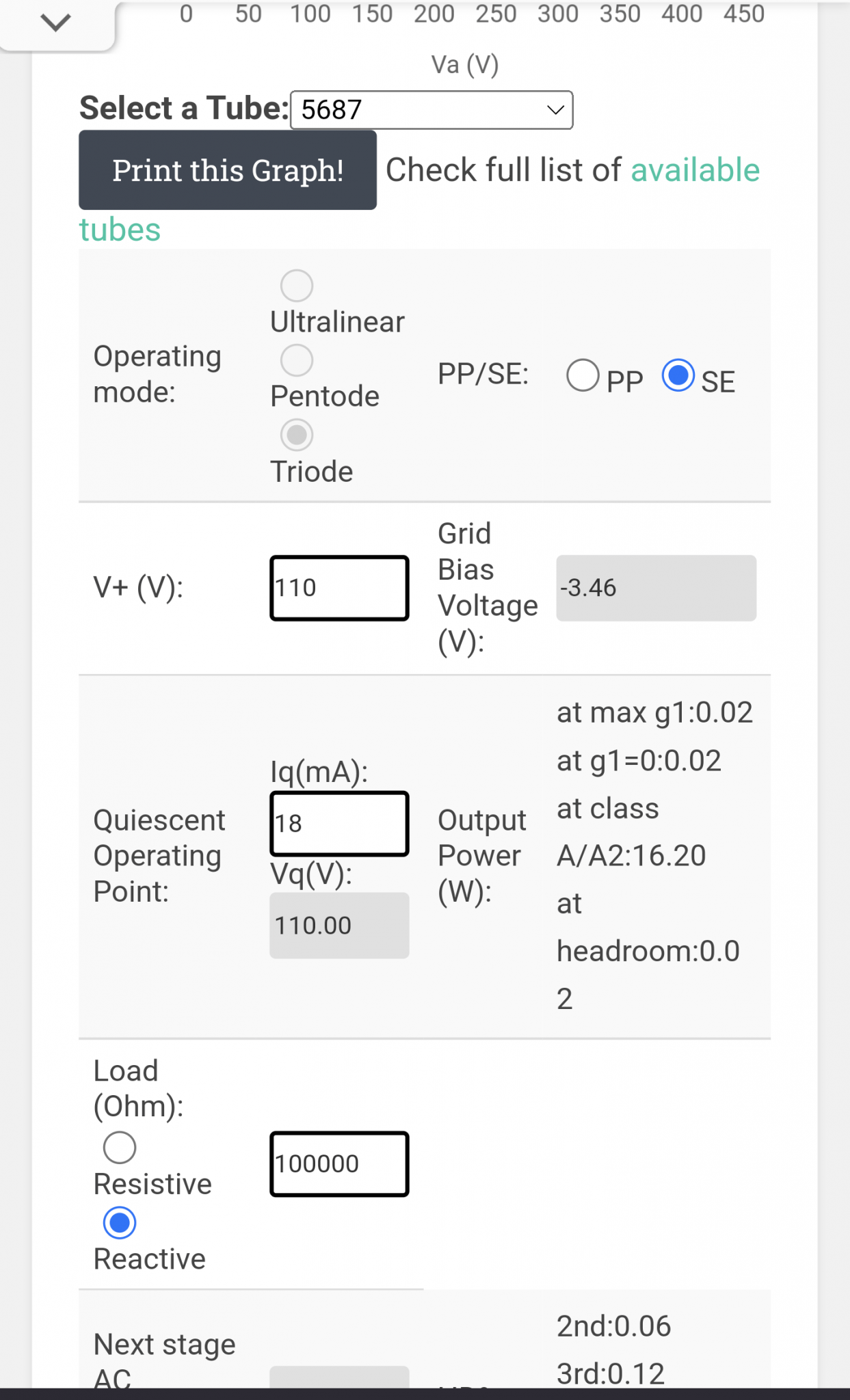

Attached image is from vtadiy.com.

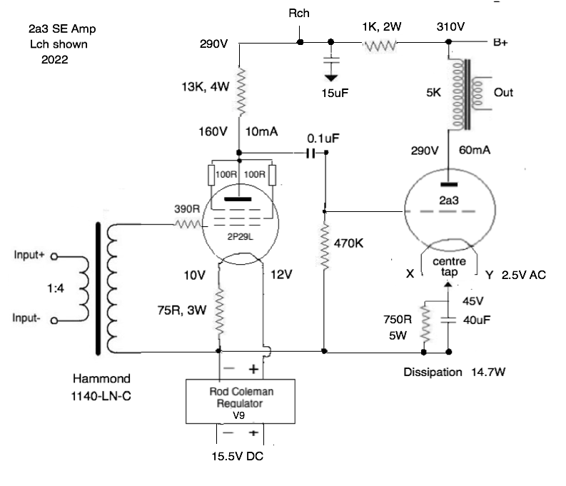

I think the true answer to "how best to drive a 2a3" is to start with a 1:4 SUT on the input. My whole concept of a 2 stage design changed when I bought a pair of Hammond 1140-LN-C, their broadcast series and good devices well priced. With this I was able to take my pick of DHTs - 26, 4P1L, 2P29L, 112A, 10Y..... I settled on the 10Y and it's marvellous, best amp I've ever made. The 10Y isn't cheap these days though it's the best DHT I know of as a driver. But the very cheap and available 2P29L is going to sound better than all these medium mu 9 pin tubes. Better than a 6SN7 too. Example shown. Filament bias is the way to go here.

Andy, if you don't mind my asking, at what operating points did you operate the 10Y? Seems it would need more supply voltage than the 2A3!

I just use a 2 stage amp. 1:4 SUT > 10Y > 2a3. The DAC goes straight in and volume is in software on my Mac.
You can do the same with the 26. You don't need the output transformers. I've tried the 26 instead of the 10Y but I prefer the 10Y - more inner detail and more neutral. The 26 is a bit warm for me. Much cheaper, though. The 1:4 SUT makes all-DHT amps possible and definitely sounds better than 3 stages to my ears. I like the Hammond 1140-LN-C, broadcast quality.

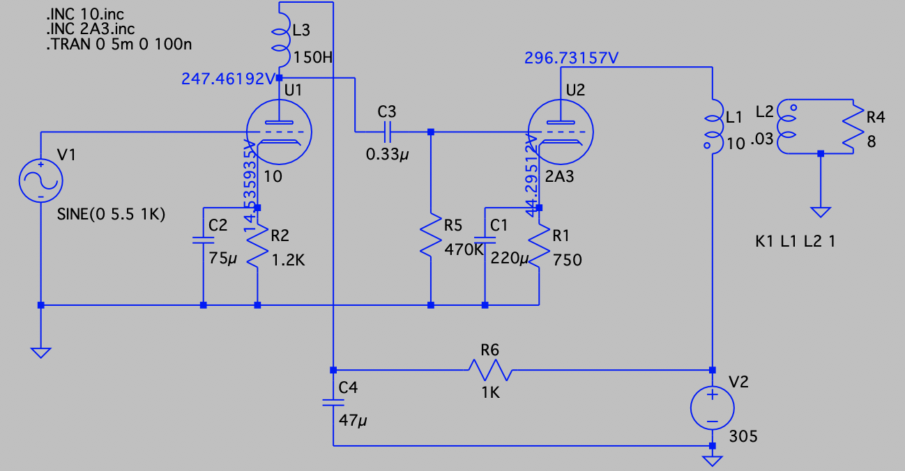

Andy, in the 2A3-10Y schematic, are you sure the 10Y cathode resistor isn't something more like 1.2K instead of 8.2R? To get 8mA from 10V you'd need 10/0.008 = 1,250. Or perhaps the value of 8.2R is related to the Coleman regulator?
If I put the 8.2R resistor in LTSpice the cathode is at 98mV/12mA. With 1.25K it's close to the op point you posted, with about 8.25V input sensitivity.
For the heck of it, I replaced the 15K plate load resistor with a choke (150H and 3.75K DCR), and the 10Y is operating at 233V/12mA, which is closer to the manufacturer's lowest published op point of 250V/10mA, and about 5.5V input sensitivity.
