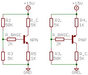

Probably you are measuring with a Chinese tester, if you measure at a base current of 10 ma, you will get an excellent result.
Can I do this like this:
What are the values of the 10 mA base current resistor?
Dear dmarget5 when I measure with my dy294 tester these transistors for a base current of 10 ma they show 5 percent
DUOYI DY294 Digital Transistor Tester Semiconductor Tester Multimeter Tester Electrical Instrument - Multi Testers - Amazon.com
This tester?
Why would he want to match them @10mA Ib when in the circuit they work at less than 1mA?

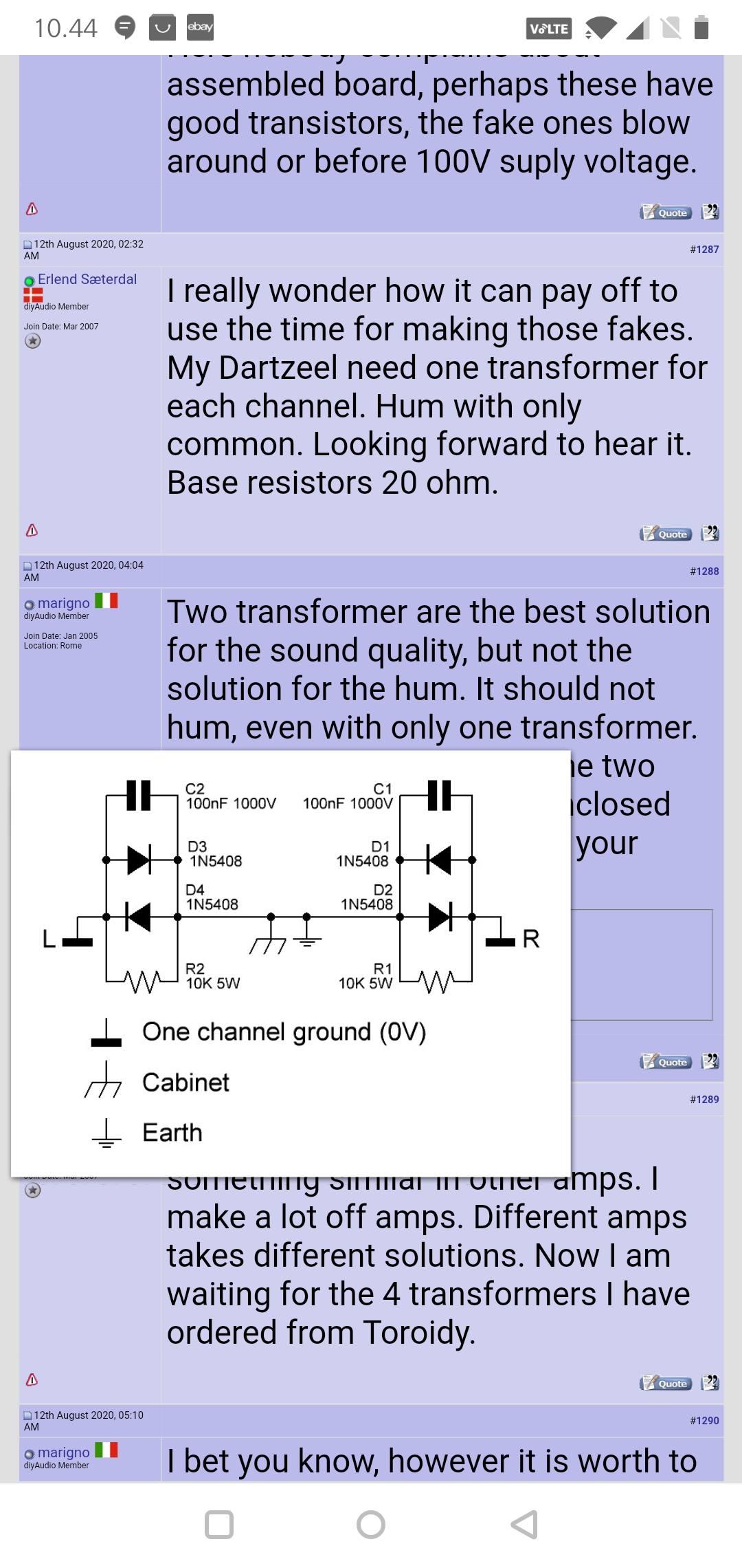

I'm in Utah. I opened the distribution box some days ago, without paying too much attention to the cabling, and I think you're right, neutral and ground are connected together. I'm using a 3KVA auto-transformer because, coming from Italy, all my stuff works with 230Vac. I see we have 230Vac also but it is used only for the stove and I don't want to do the job of extending the cabling. So my audio set is working with mixed voltages (all sources work with 115Vac) but I don't see any problem.
That is a very good clue! I didn't know. Thank you!
I'll open the distribution box again to better understand the cabling and, If I can find two outlets, close to the audio set, having different cablig, hopefully thier phases could be inverted. If so, I could disconnect the auto-transformer that, being chinese, runs hot.

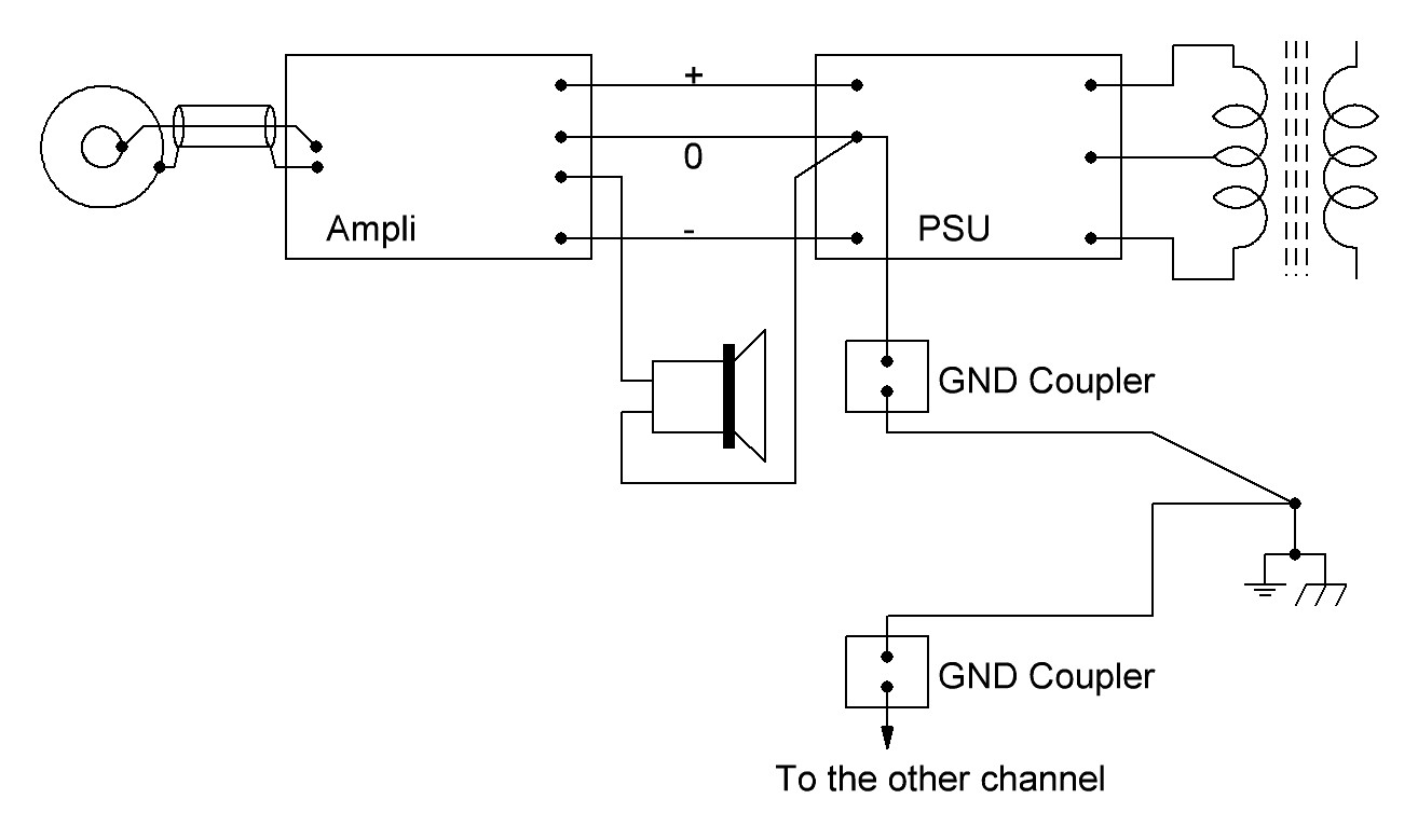

Still have a Hum problem when using two channel input. I use seperate transformers for each channel and separate capacitor banks. Should I mount earth common as soon as possible after the rectifiers maybe? Get more grey hair from this.
I’m using the same coupling as “marigno” no hum.
As the GND coupler I’m using two CL-60.
It works for me every time.
