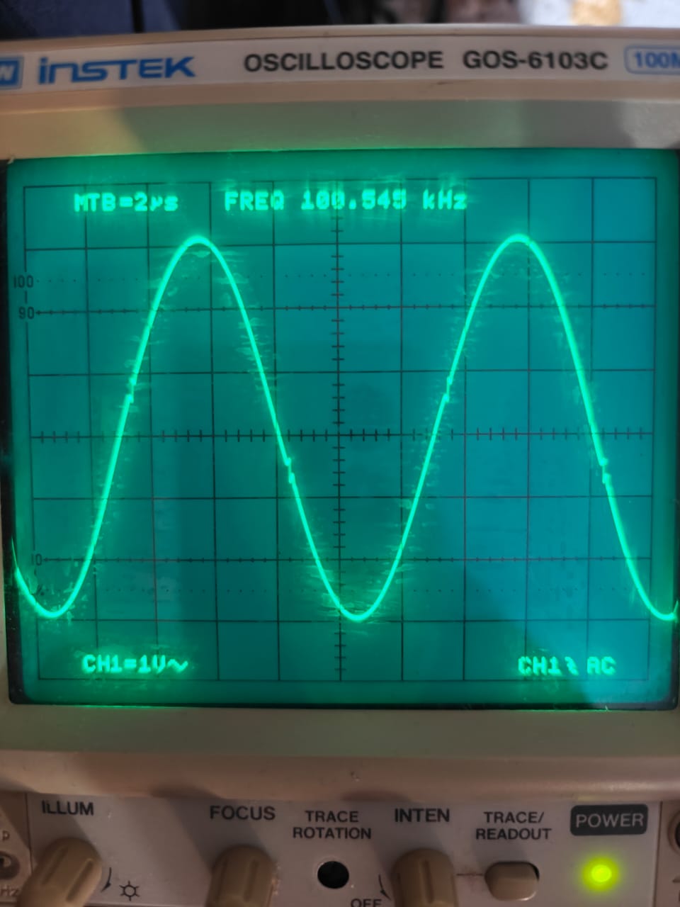

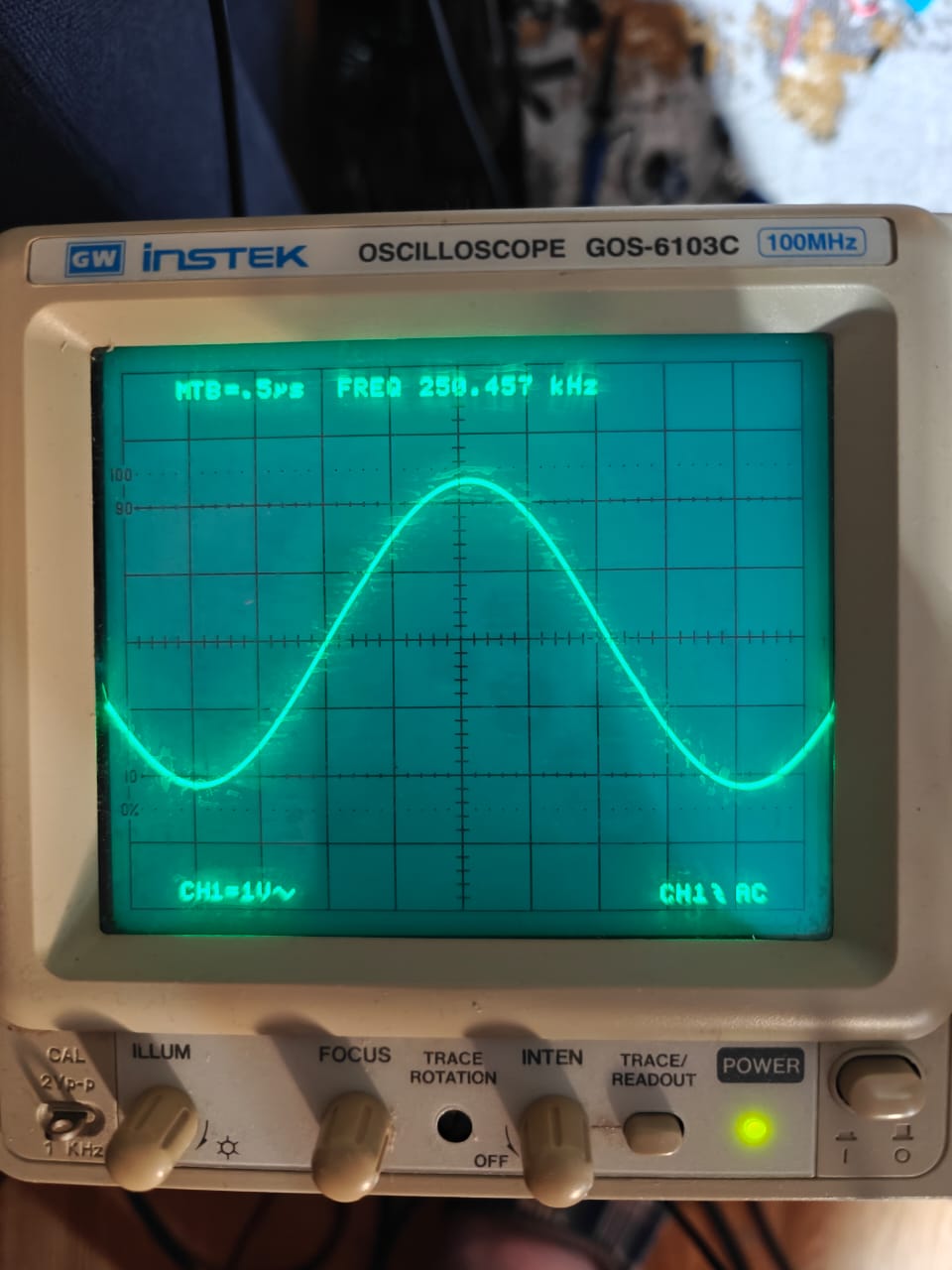

Every scope picture should contain the information about frequency and amplitude settings and the load should be specified.
I notice a contradiction in post 2374 "Amplitude 10 volts" compared to the photo.
It is hard to decide the blurry pictures hint at an additional problem or its is only the deviaton in crossover range.
Apart from that we can not know which schematic you used and it is modified or not.
In a circuit like in post 7 bias is dependent on the choice/type of Q9..Q12 and the CCS setting in Q90, Q100.
If you test with very high frequencies and high amplitude it is possible to destroy the output.

10 volts in the cell, frequency at the top of the picture, load 4 ohms.Every scope picture should contain the information about frequency and amplitude settings and the load should be specified
The circuit is not changed.n a circuit like in post 7 bias is dependent on the choice/type of Q9..Q12 and the CCS setting in Q90, Q100.
Distortions occur in the voltage amplifier.

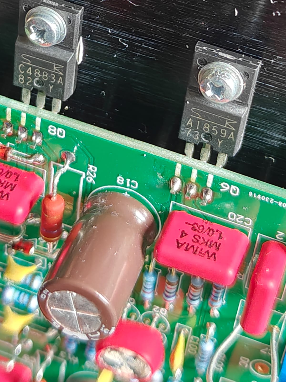

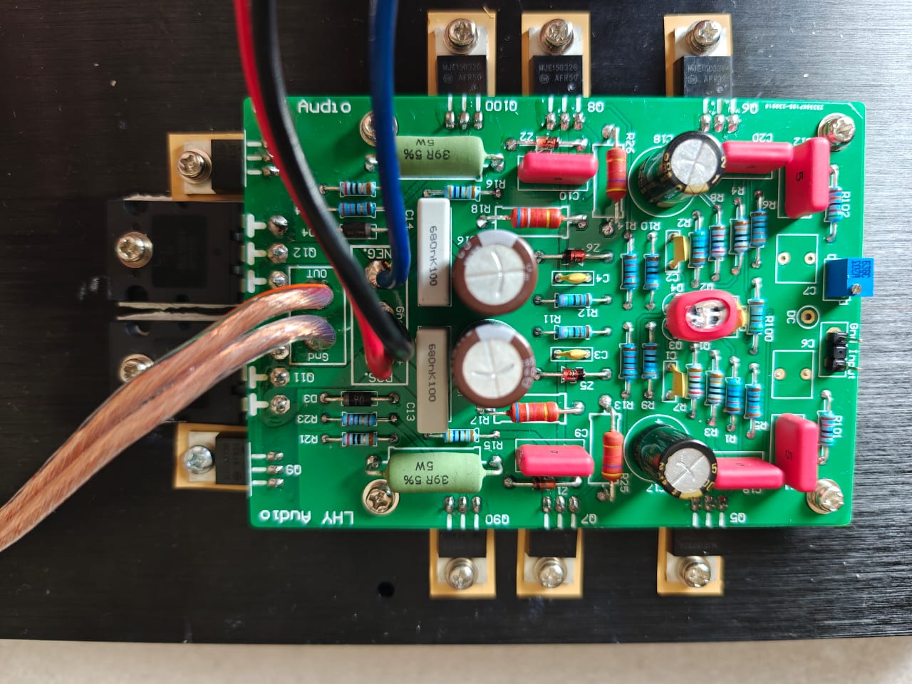

The board is from Ali Express, the transistors have been checked (other ones, not from the set, have been installed).
This is how the phone takes pictures. In fact, the picture is clear.It is hard to decide the blurry pictures hint at an additional problem or its is only the deviaton in crossover range.
Do you refer to the schematic in post 7 ?

"Distortions occur in the voltage amplifier" so how can we know where you got your scope pictures ? The output stage has no feedback, but the voltage amplifier has.

When I have time, I'll try to change the correction.It is hard to believe the voltage amp has this form of distortion.
Yes, I checked EVERY part.Вы уверены, что ваша печатная плата Ali и используемые вами детали соответствуют посту 7?
В противном случае мы будем ходить по кругу.
