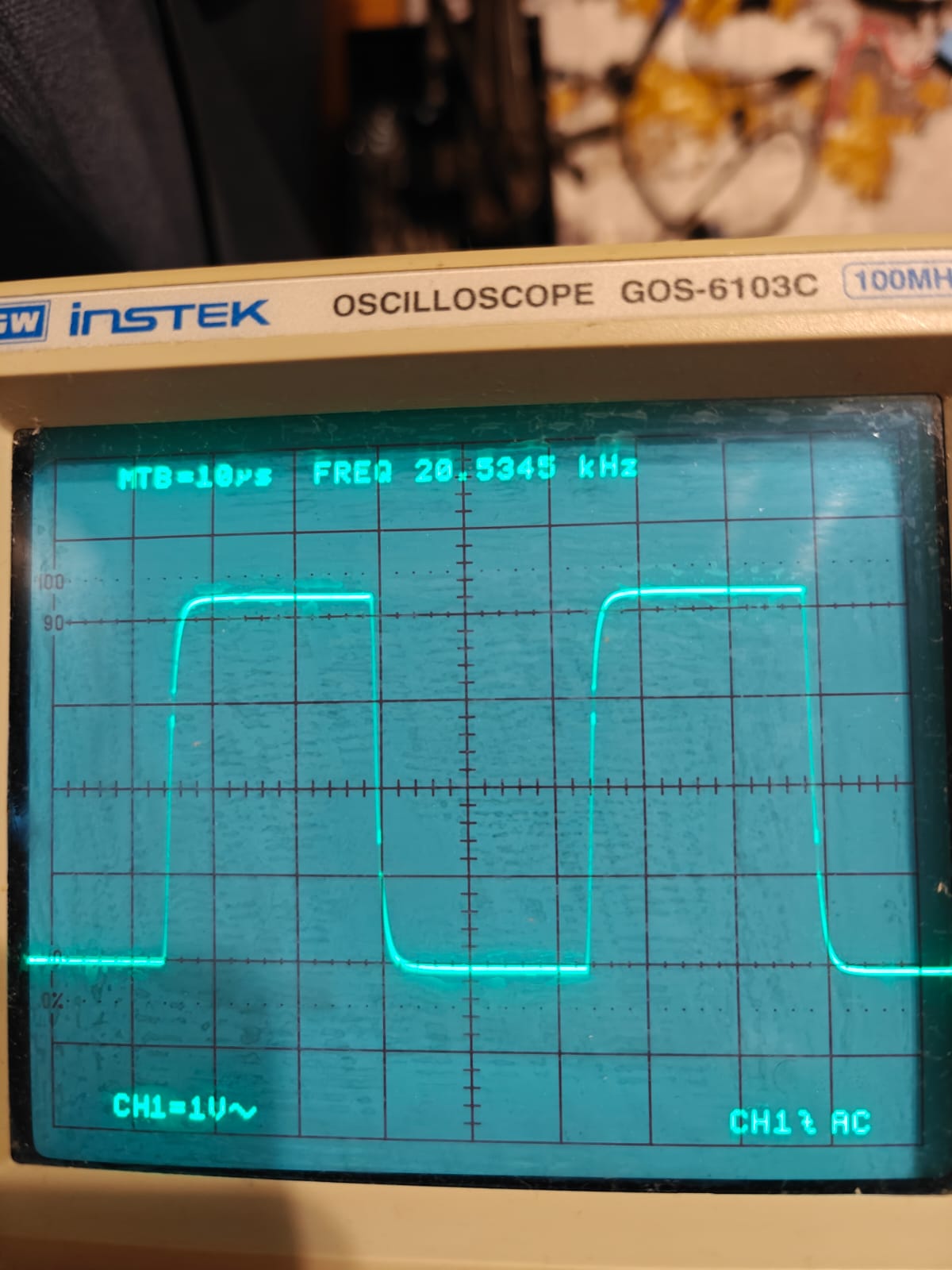

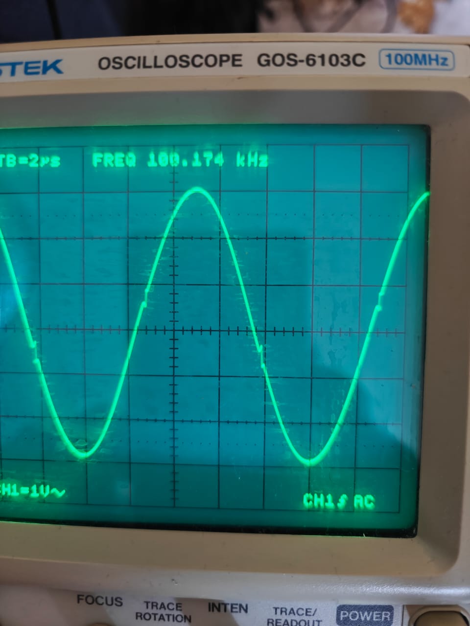

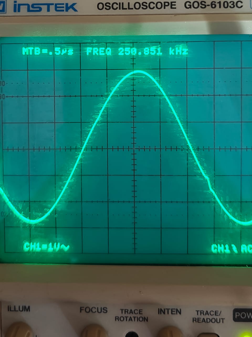

Do you get these notches on the drivers?
With or without load?
Это на выходе усилителя напряжения.
Перед выходным каскадом.
English please:
This is at the output of the voltage amplifier.
Before the exit cascade.
On a rectangular signal, it looks like this:
Amplitude 10 volts in the cell
Crossover distortion can be seen at both sine and square shots. This is not a good amplifier.
This is from the output of the voltage amplifier, and it operates in class A without current cutoff.
Are you sure or you just assume it operates in class A? This looks like the absence of bias.and it operates in class A without current cutoff.
