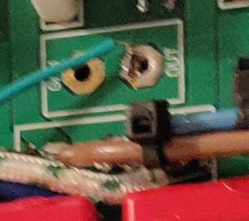

I am really amazed. It's the only amplifier ever that is dead quite. Absolutely no hiss and no hum with the ear totally in to the speaker. And I have made many amplifiers. I wonder why. Bias 68 ma in each transistor pair.

It's LF 353 in the servo. All transistors are on the same Aluplate. I have a downstairs and a upstairs. I use the circuit as told with 2.2 kohm, 100 nf and antparralelled rectifiers between the input ground for the two channels capacitor PCB. Two 500 w transformers 2 x 40 vac. Rectifiers for AC/ DC is Mur 3020.

I have added 20 kohm Vishay after the 51 ohm input resistor to ground.
Not a good idea as far as sound goes. The virtual ground provided by the DC offset network is much better, at least with the ground plane the original board uses. Combine several such improvements and you can run the sound this amp makes into the ground.

Ok then I will try with and without the 20 kohm
Thank you very much analog_sa. But it seems more "relaxed". The DC network never worked properly in my amp.

I don't understand. I think you have seen the sensor conductor from the servo? I can't possible see there could be a problem with that. Orange or green conductor.

So disappointed this evening in Copenhagen. With signal -not shorted- as earlier there is huge hum. So have to work with it. Sound is to the dark side. One little speaker only wich I always try before using my expensive Duelund speakers.
One channel with no signal there is no hum. So maybe 4.7 - 10 ohm on the ground inputs.
