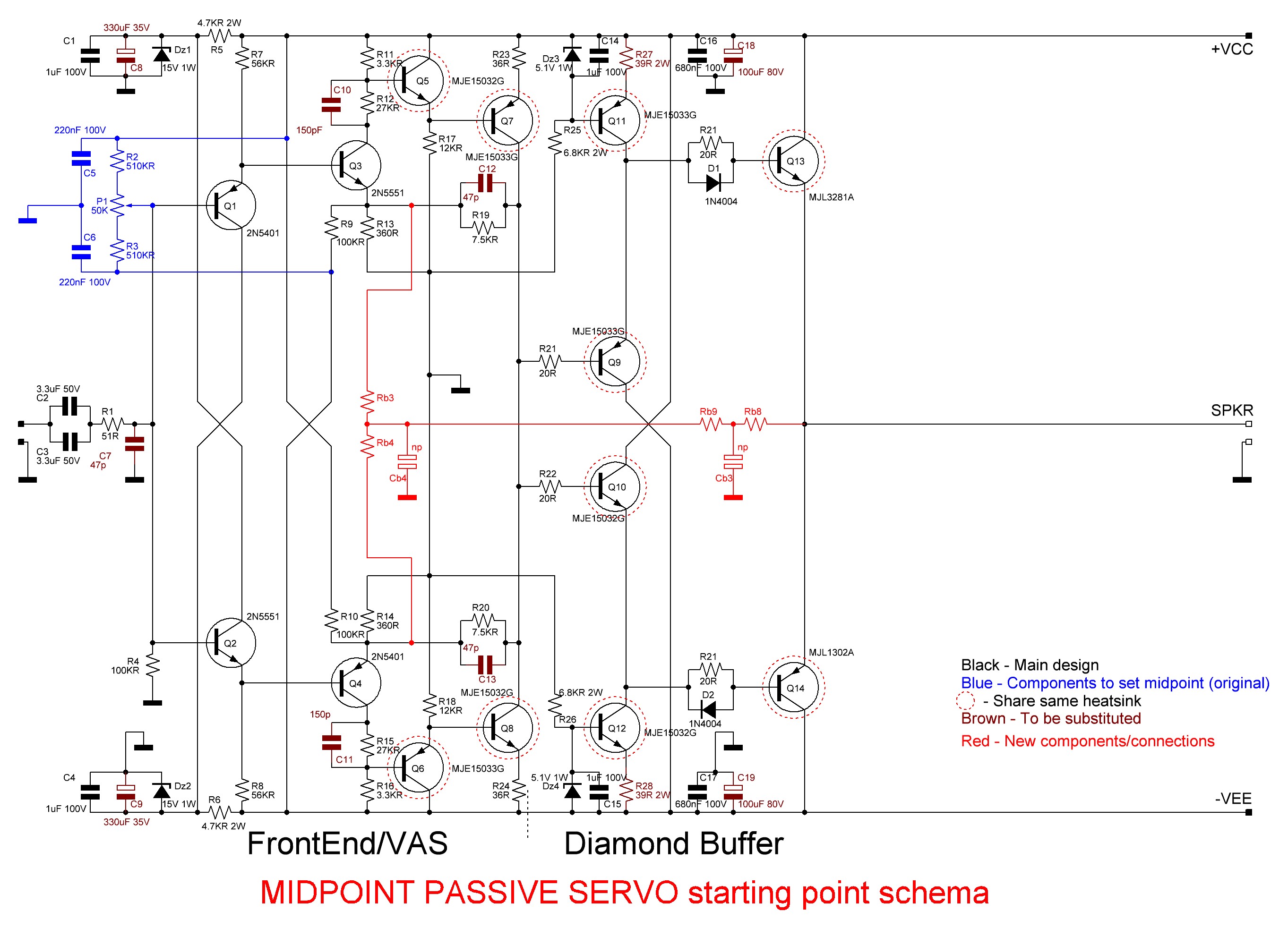

I need another couple of pcb to use better quality components, to try to improve the main circuitry and to get rid of the mid-point servo board. Here are some more mods to be experimented, the schema and the values are a starting point. I think I'll buy pcbs on Aliexpress.
Any comments will be appreciated.

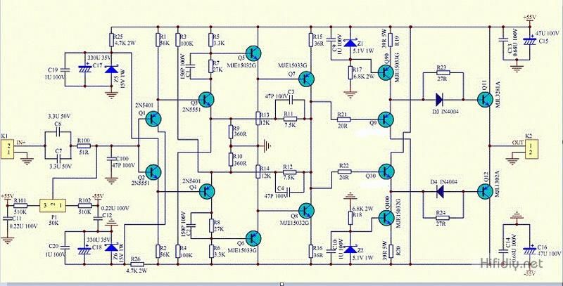

it depends on what you want to do and how.
IF you want the Dartzeel or 108 clone you can take the Chinese cards from Alipress and add the 22 MILLIFARAD supercap to check the offset, plug in the power and walk.
If instead you want - INVENT - or try to improve (offset control!!) The Chinese board you can intervene:
- entry cap (the Wima is dark, rumbling and very slow), there is much better
- the first 4 TO 92, 2N 5551 and 2N 5401 which must be almost perfect as a selection, which the Chinese card ignores. Now you have two options, either you select 2N, or you go for excellent chips, like
EMZ1 FHA, which have bjt PNP and NPN industrially matched, OR you buy FMBM5551 and FMBM5401 and cross the bjt. So either you remake the PCB or try to intervene on the Chinese PCB, but only if you have manual skills.
PS / NB

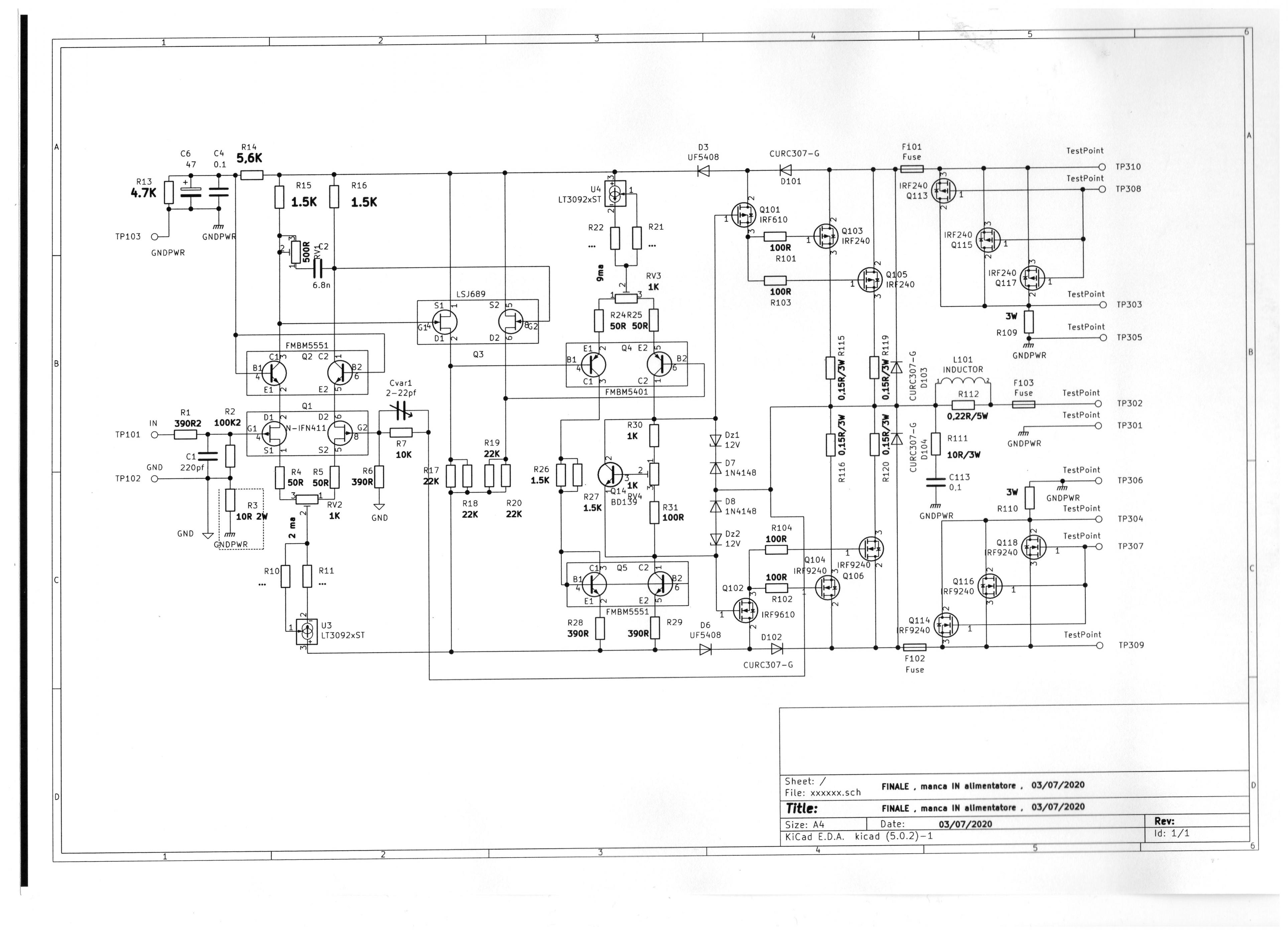

the scheme you posted appears to be a scramble of 108 and not too well done

Dear Domenico,
any suggestion to improve my scheme will be well accepted. But you must be precise, saying "the scheme you posted appears to be a scramble of 108 and not too well done" is not any help for anybody here. I like to share my experience when it leads to an improvement, at least in my opinion; don't you? So, please, share your idea.
There are some targets I want to achieve: I have 2 transformers 50+50Vac 625VA and 1 transformer with a double 60+60Vac 1KVA that need to be used; at least 200Wrms of output power on 8Ohms; no global feedback.
Searching the net with these targets, I found this clone on eBay. But I'm married with my targets, not with this clone. Should I start from scratch, I would use the Aikido project as front-end/VAS and a triple darlington NSCB back end. But is is not that simple to design the servoes needed to control current drawing and midpoint, even worse (and dangerous) if you try to design with the cc coupling as a target. I'm not a factory!
Other than my ears, I have no instrumentation here, in Utah, where I moved; all my lab equipment is in Rome, where, for the foreseeable future, I have no way to go.
Coming back to our topic, during last days I came to the decision of drawing myself the pcb to use better quality components, that will be bigger. But I still need the chinese pcb to continue experiments before finalizing my design. I think I will use the transistor arrays you said (this is a good and precise suggestion but the EMZ1 FHA that is too low on breakdown voltage, good perhaps used in cascode). I have no idea where to buy MJE1503x matched transistors from, with confidence; the hfe of mine are quite different among NPN and PNP (this could be another good suggestion).
In my post #1377 I forgot to enclose the schema of a starting point solution of a passive servo (subsonic feedback) to try to trash the active servo, I'm posting it here. However I don't see that big problem with the chinese servo, at least not with my mod; I never tried the servo "original".

I think this is the pattern of 108, the pattern sold on Alipress from China
mmmmh ......
I think you know how 108 sounds, NOW, well. It is an open loop with only one pair of power amplifiers ... nothing to object, but the final performances can be predicted in percentage terms.
If you've listened to the original, you know what I'm talking about.
I have modified the Chinese card purchased from Alipress, perhaps modified too much to the point of being quite different, in terms of sound, from the original scheme.

the schematic I posted is not complete:
between R 9 / R 10 and mass there must be a cap, the supercap, of 22 MILLIFARAD, not MICROFARAD! ! ! , to check the offset and hope to cut with this high pass as low as possible, although it is always nonsense to cut
very low and hope you don't feel the cut.
For this scheme you can do a little without changing it:
- change the entry cap, a fetenzia like sound, MY OPINION, but aligned with Dartzeel thinking
- the 4 input BJTs to be replaced with a chip or two chips as I mentioned (if you are interested you can learn more) to try to better control the offset; if one really wants to select the 2Ns, audiophiles are closely linked to similar customs, at least place them attached to each other, 2 to 2
- the diode in series the final.
I add :
