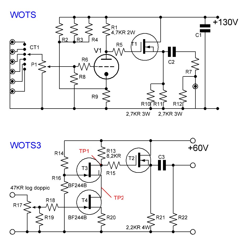

Finally I totally agree with you, I don't like CCS and, when possible, I prefer to use resistors in place of them and I like designing with BJT too.
A short off-topic, two designs of mine, demonstrating the use of resistor (R1, R10/11, R13, R21) used instead of CCS, with their value as low as possible, to maximize the current in their stages. The sound of both is very close and outstanding, not in my opinion, but in the opinion of a lot of people after listening at them. The distortion is written in the circuitry to be not that low!
