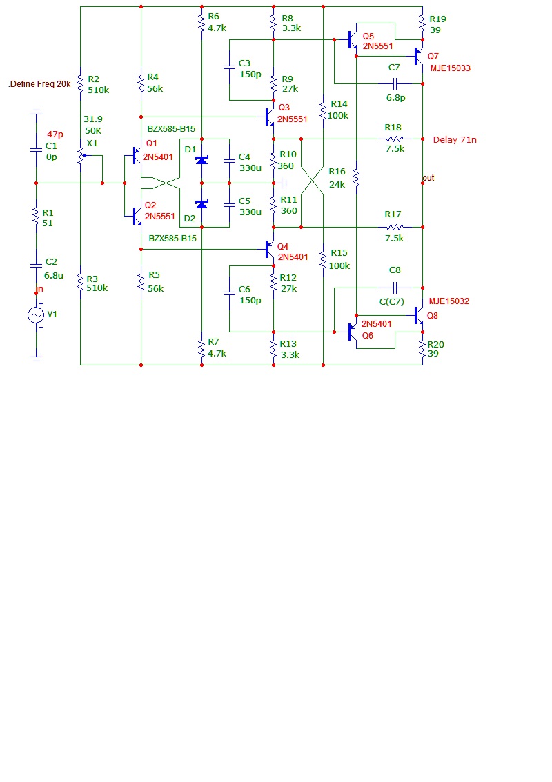

Martin Colloms has reviewed the 108 Model 2 and there are some measurements. Distortion appears much lower than anticipated which means that our attempt to recreate a Model 2 based on the well known schematic glimpsed on Herve's screen and drawn by Shany is defective.
Which perhaps should have been obvious as there is just not enough current gain not to overload the voltage gain stage. Of course this is most severe at low impedance loads. My speakers drop down to 2.5ohms which times x100 for the output transistors Hfe means 250ohm load at the VAS (acronym used loosely). Clearly low distortion will be impossible without a darlington connection at output.
Not sure why it took me so long to realise something so simple. No excuse really.
On the bright side, adding two more transistors reduces the distortion 3-4 fold. The question is are these extra transistors present in the original?

Domenico, this is about the 458 circuit, it is not a discussion of 108 model 1, but model 2 which is supposed to be a 458 with only two parallel outputs. Your version of the 458 circuit suffers the same fatal flaw.
dartzeel sounds good, but due to the large distortion it is still unclear. To get rid of this turbidity and add "air", there it is necessary to modify the driver and apply an output stage with two pairs of output transistors, also without applying global feedback. In this case, it is necessary to avoid the use of current-equalizing resistors in emitters.
The signal flow rate in this circuit is of the order of 370ns, of which 350ns is a driver and 20ns is a parallel output stage. If we use a pair of Baxandal in the output stage of the driver, its speed will decrease from 350 to 90ns, which has a favorable effect on microdynamics.

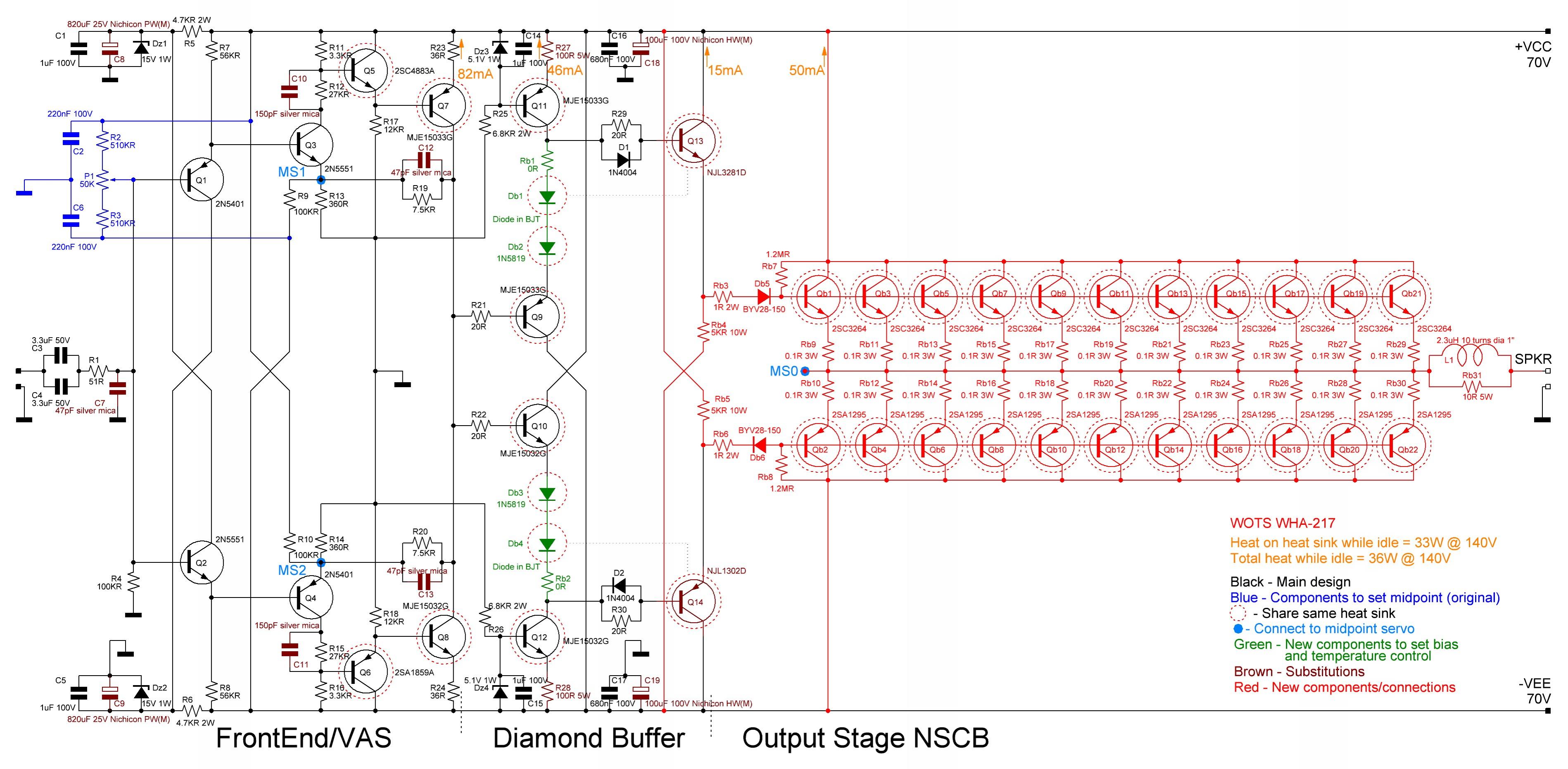

I've been messing around with this amplifier for several years and I have learned this circuitry well. As a result, in order for this device to fully sound, I applied my own output stage, and the voltage amplifier was also slightly modified, as a result I got 0.03 percent distortion without a global negative connection. And now this beast really sounds good. 🙂
This is quite impressive if at full power. Even in class A with triple parallel outputs this is an incredible achievement for powers above 10W into 4ohms.
The voltage amplifier has a very low distortion on its own, not much to be gained there.
We were discussing philosophy going far away from the subject, overall because of my fault: everything is knowledge exchange, and Domenico and Analog_sa are always interesting to be heard. But your post takes us back to the topic of this forum. I posted my mod at #1267, would you please like to share yours? Did you try to lift from the ground the common point of emitter resistors (12KOhm) on the first MJ1503x?
I will not go deep into the theory, my opinion is that first of all it is necessary to increase the signal transmission speed in the voltage amplifier. To do this, you can use a simple modification right on the board itself. I used 2sa1208 2sc2910 (Q5, Q6) transistors. Even leaving the output stage the same, this refinement improves the sound quality in this amplifier.
