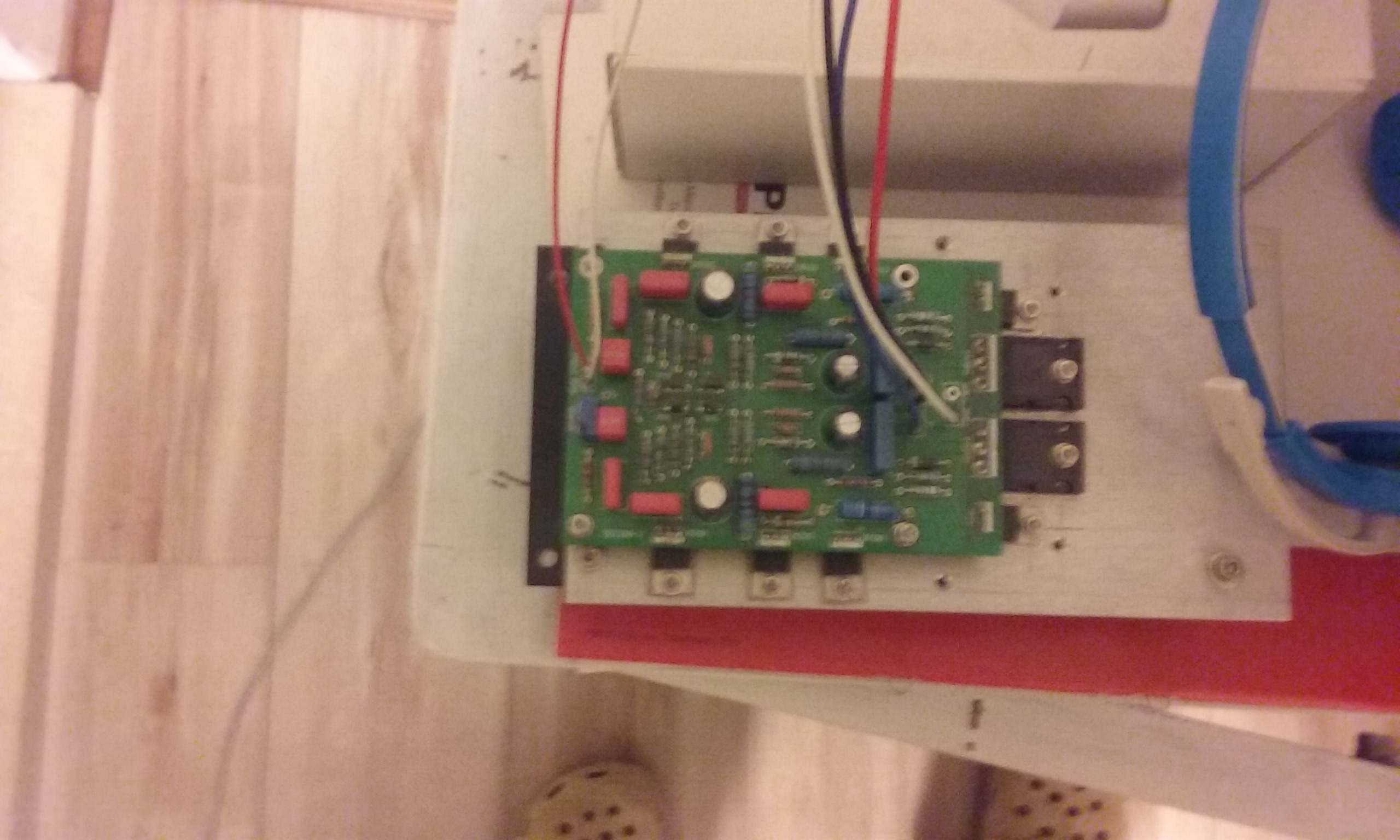

I used Chinese boards with a thickness of 2.4 mm I indicated the refinement of the voltage amplifier in post 1500, this revision can be used with the original output stage, the correspondence of the elements will have to be solved in a logical way)

In your post 1500 the picture of the board shows NO transistor at Q5 and a wire from the R5 to transistor Q7. There seems to be a a Capacitor? by Q7 as well? Is the Q5 underneath the board?
I will not go deep into the theory, my opinion is that first of all it is necessary to increase the signal transmission speed in the voltage amplifier. To do this, you can use a simple modification right on the board itself. I used 2sa1208 2sc2910 (Q5, Q6) transistors. Even leaving the output stage the same, this refinement improves the sound quality in this amplifier.
Your mod is to be tried! You connected Q5/Q7 and Q6/Q8 as Baxandall couples. Super easy to do in the board. I see you lifted from GND the common point of the two 12K resistors using a 24K one, like I said in my #1497. Any collateral (oscillation or instability)?
IMO, the original schema does not allow more than one output couple being useless adding others, the driving current is however limited by the two CCS.
My goal was to achieve at least 200W but I would have added the output NSCB stage even with a 100W goal, obtaining to move a lot higher the current limitation imposed by the two CCS, a Class-A driver, and non switching class-B output stage capable of very high current.

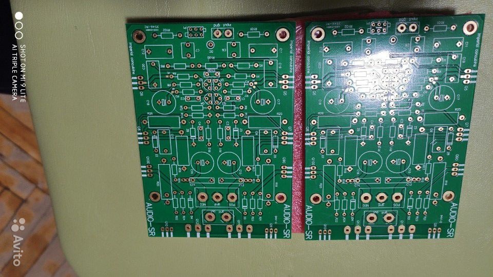

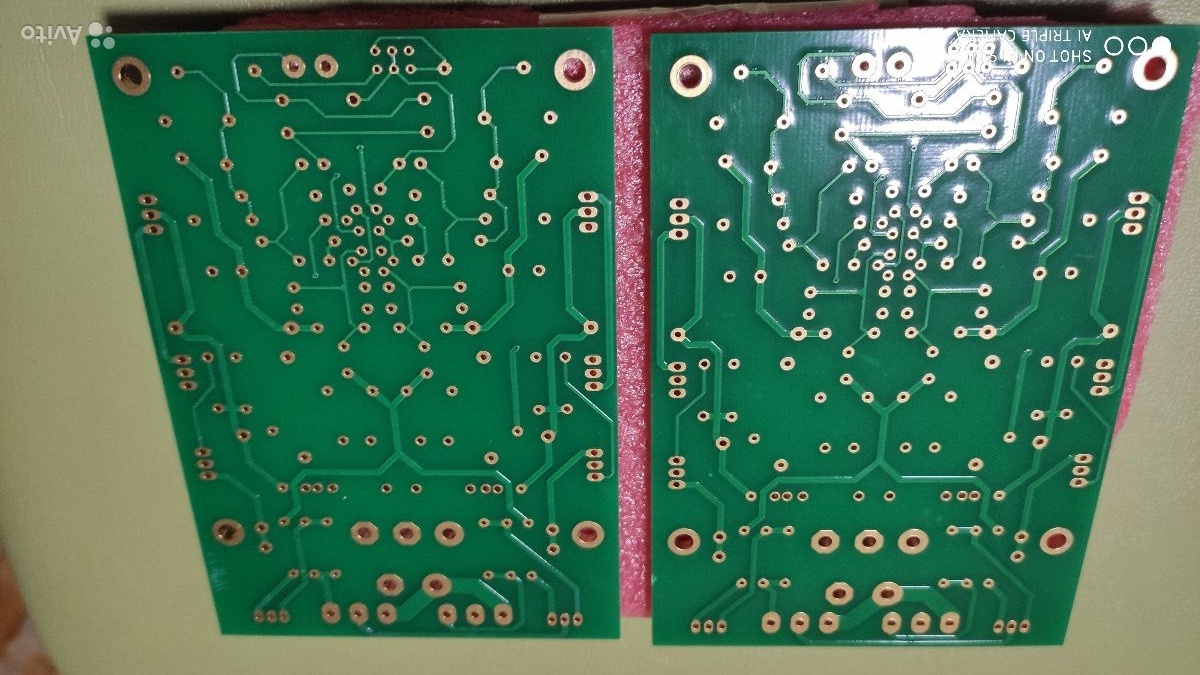

Ok guys, you all moved me.
I ordered 3 couples of the 108 pcb on Aliexpress; on eBay they do not list them, not even on demand. I want to try the two mods that are on 3SSS scheme and apply Domenico's suggestion about 2N5xxx:
- the Baxandall mod on Q5/7 and Q6/8 and moving the comp. capacitor;
- to lift from GND the common point of the two 12KOhms resistors;
- use the transistors array MMDT5451-7-F.
These mods are simple and should be reliable.
