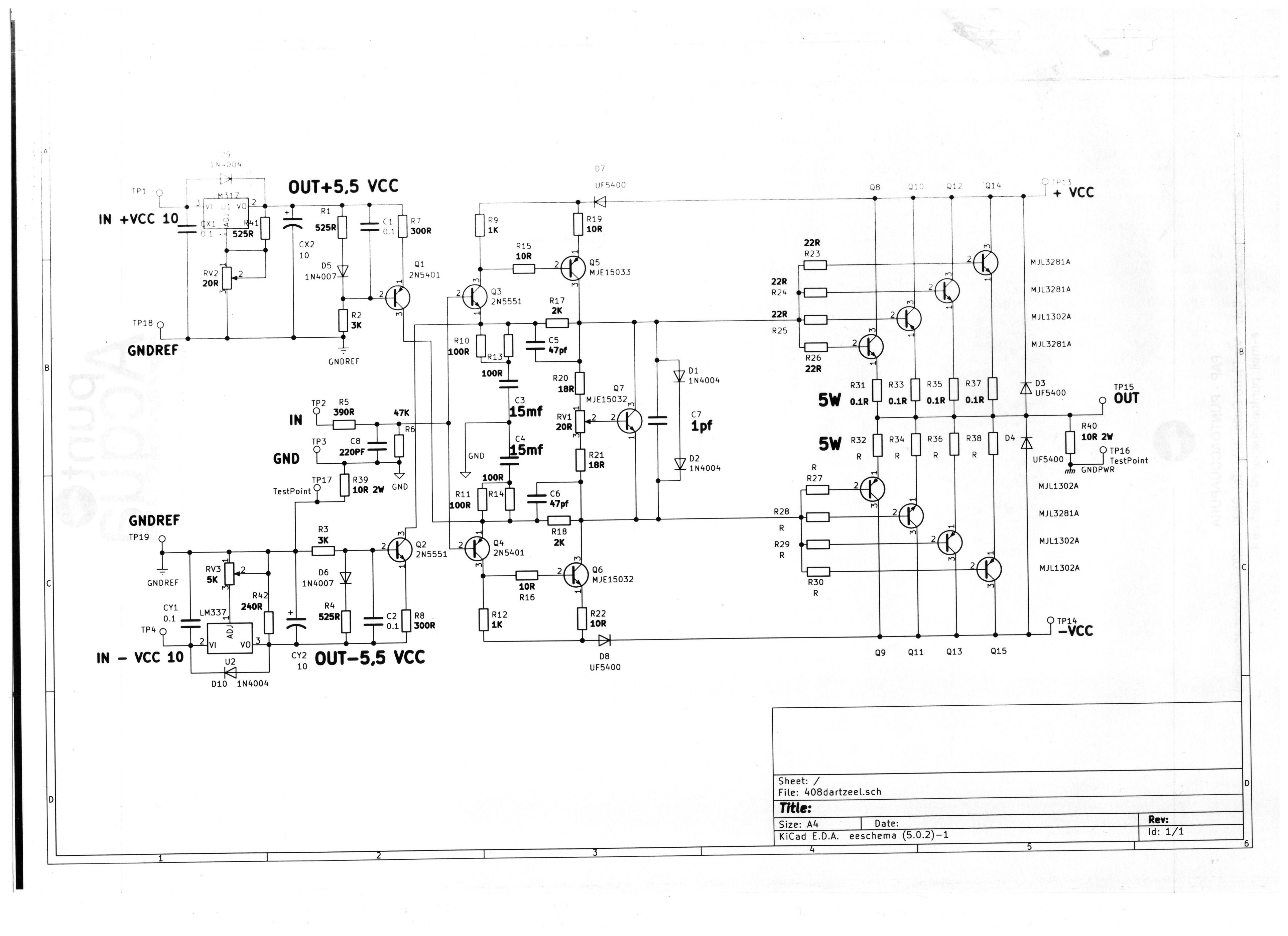

Thank you for sharing your interesting circuit and write up.
These however don't explain how you managed to get such a low distortion. I realise you never mentioned the power or load, so perhaps it is just 1W/8ohms but 0.03% thd is still a remarkably good result.
Yes you are right. Distortion of 0.03 percent is due to my output stage. The output stage in the original circuit provides 0.12% distortion and a fairly impressive range of high harmonics. So far, I'm in no hurry to share the output stage circuit in the public domain. But I can say that it is parallel on two pairs of output transitors, with modified current sources and positive power feedback to correct the minimum distortion at the first watt.

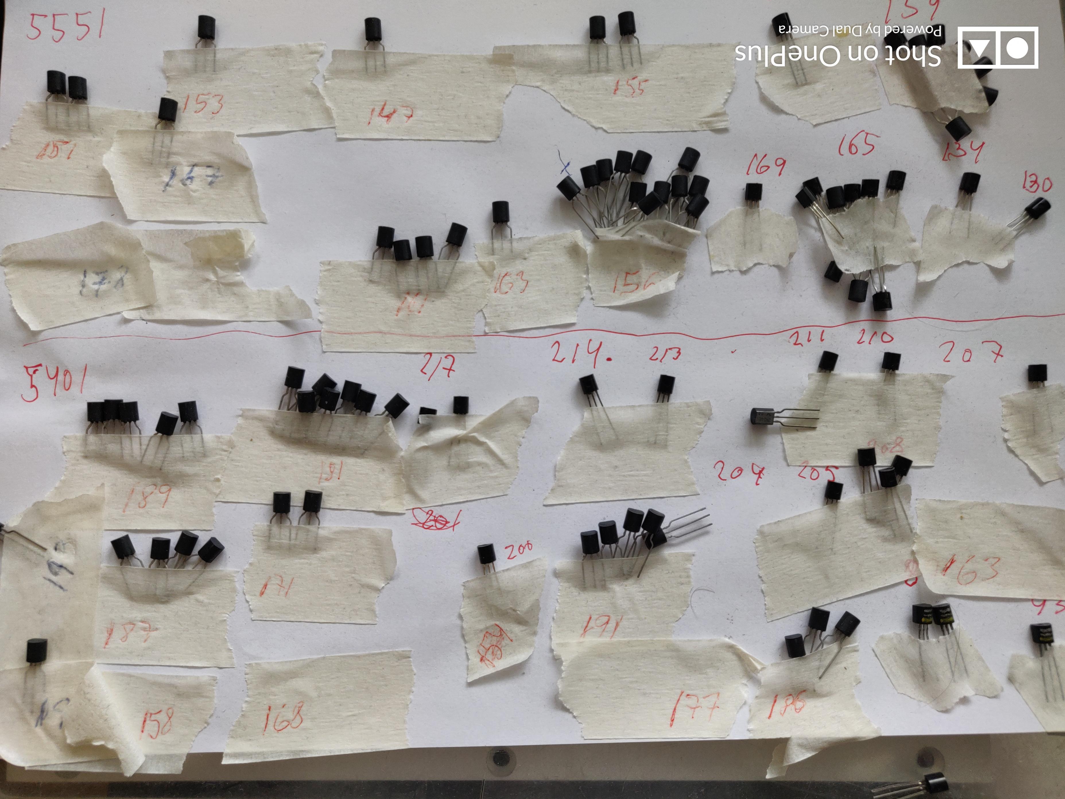

I ordered 3 couples of the 108 pcb on Aliexpress; on eBay they do not list them, not even on demand. I want to try the two mods that are on 3SSS scheme and apply Domenico's suggestion about 2N5xxx:
- the Baxandall mod on Q5/7 and Q6/8 and moving the comp. capacitor;
- to lift from GND the common point of the two 12KOhms resistors;
- use the transistors array MMDT5451-7-F.
These mods are simple and should be reliable.

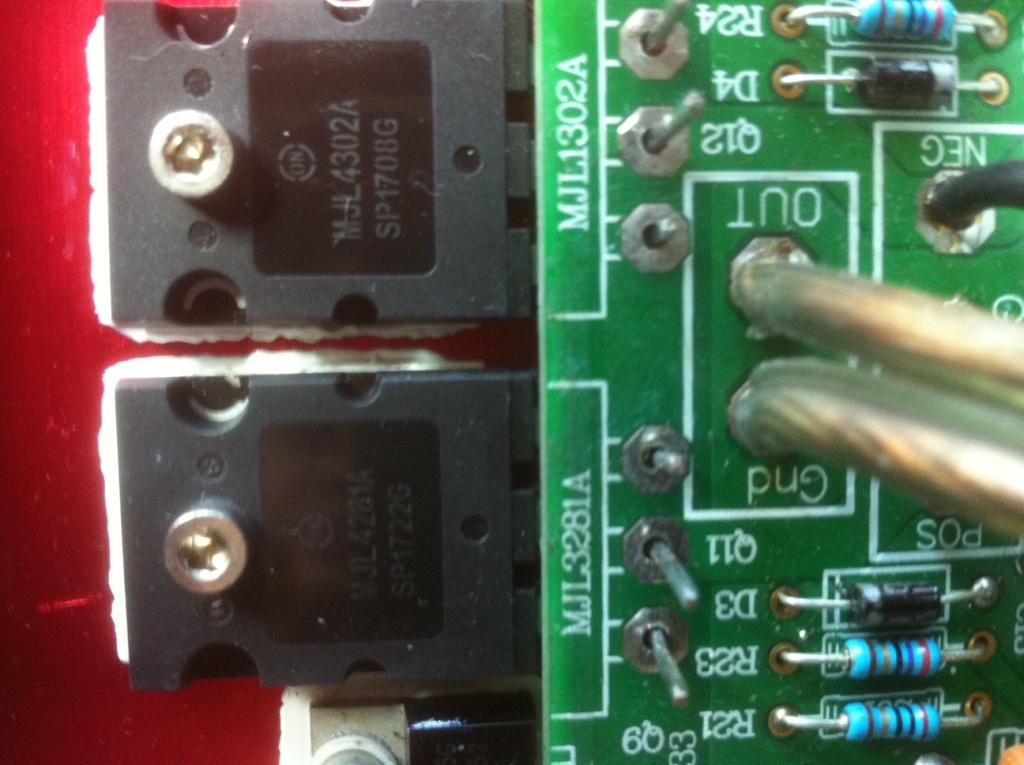

I completely agree with Hattori, agree to raise the quiescent current of the output transistors. Domenico do your boards have 2 grounds? I do not think these will be better.![]()
my PCBs are purchased on Alipress or Aliexpress, in short, we understand each other.
Then, in a frenzy, I developed it with 4 output pairs, changed the polarizations, of course, resistors on the emitters, VCC stabilization for the input BJTs with LM 317 instead of the zener, stabilized power supply for the driver and final stage, diodes fast recovery on lines and exits, another final than 108, but always a mess to check the offset without the supercap , this scheme

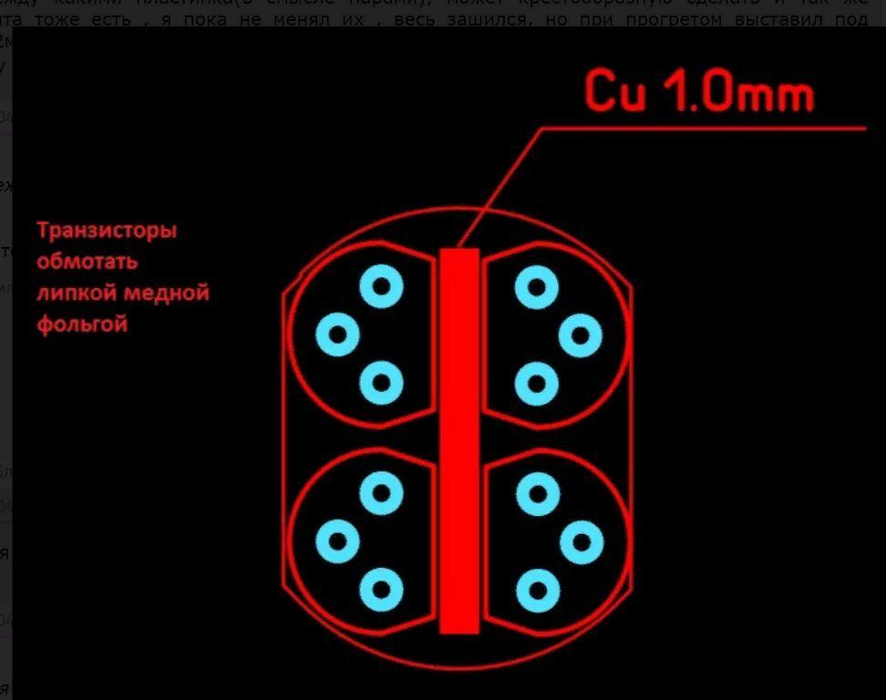

I'm just watching from a distance, but isn't the DC offset a thermal issue as the junction temperature fluctuates so does the offset, right? I'm think that part of the solution is to thermally couple the semiconductors with a smaller slab of copper and keep them warm/hot deliberately so that the junction temperature does not fluctuate with load.
A huge slab of heat-sink just makes the thermal difference bigger between the semiconductors. It's need so the temperature doesn't run away, but nothing is said about running hot at 85C (185F). Any thoughts?

I found this russian build thread ????????? Dartzeel NHB-108 (????????? ?????, ?????? ????????? ? ????) [2] - ??????????? iXBT.com
Looks like they have been looking at thermally coupling things as well.
![1291058w.jpg](https://ixbt.photo/photo/1280688/63199mdpG3T1Flk/1291058w.jpg)
Dear piotrkundu, you did not read this forum well, I have long shared this photo and others, how to reduce the constant drift at the output without a super-duper capacitor. My amplifier is built just on such transistors, I will not say anything bad about them, the letter G means lead-free technology manufacturing.
