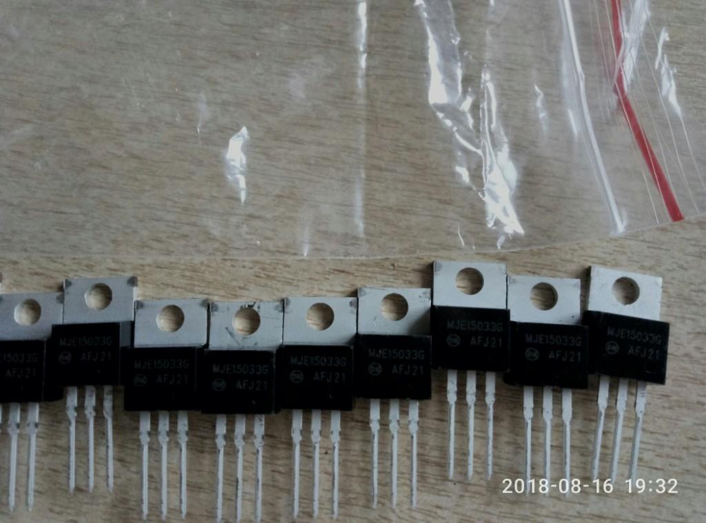

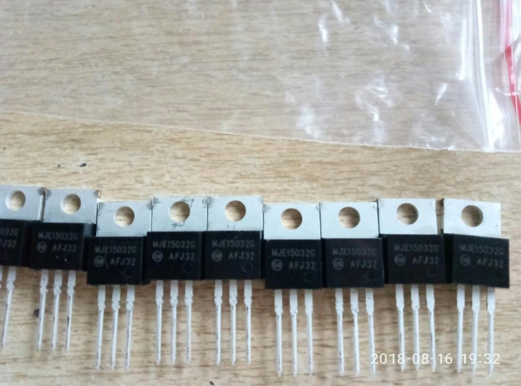

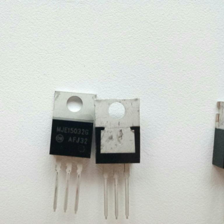

Guys, you can't identify a fake or an original from the photo. The Chinese make fakes well. Check for a simple break and see the size of the crystal, measure the capacity of the junction b-c, b-e and compare by datasheet. In Russia there is a forum for fakes, here are mine, determine.:)

if they imitate it they do it very well, they seem to be of the same hand
The first two are identical in cases, the second is a little bit worse in Vce breakdown (however within specs) and CE capacity, perhaps both are good originals. I blew a lot of the second kind but I am almost sure it was my fault trying to use a Vbe multiplier. I didn't blow any of the first kind (but I used a solution far better than the Vbe multiplier).
The third has a different case and marks. It is a disaster in Vce breakdown and Vcesat; its CE capacity is one third than the good one. I lost the count of how many I blew trying to have the 108 work, when approaching the 100Vdc with the variac. I will trash all of them.
