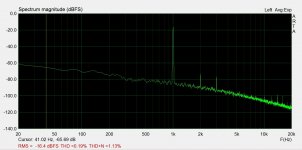

In picture 3, transistors -15032 - hFE 130,131 participated
15033 - hFE 180.181
1302 - hFE 115
3281 - hFE 99
small - hFE 214
15033 - hFE 180.181
1302 - hFE 115
3281 - hFE 99
small - hFE 214

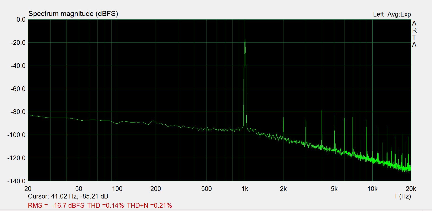

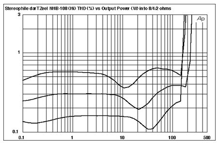

I think the Russian guys from the forum will not mind if I post pictures for you. They show a graph of the original and the blue board of one of the participants, a photo of which I threw off earlier. This is for those who understand.😉
Dear Paroxod, dear Bogdan,Well, that is very good, it looks exactly same, so cloning is successful, great job!
That's lot of distortion but it's 55W. I've seen here high distortion measured at 1W if I remember correctly?
Thank you very much for this extremely useful information - you have brought this conversation to a higher, scientific level. I do appreciate that.
What I can understand from the published graphs is:
1. THD is rather high for both the original and the clone NHB-108
2. Even more troubling is the presence of considerable amount of odd harmonics in the frequency domain.
Could you please post a link to that Russian forum - with a little help from Google Translate I would like to learn more about this essential subject.
Now, with this valuable data there is no need for further "audiophile" talk. Facts are in front of us.
By the way, last week I received my new Rigol 1074Z-S plus. I also consider purchasing a license of ARTA software to be able to perform frequency analysis which is far beyond the capabilities of my oscilloscope. From pure listening there is virtually impossible to make a reliable analysis of equipment.
1W and 50W dist into 7.4ohms
