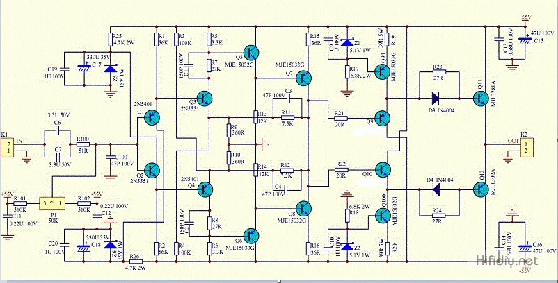

Have the original schema as a base, I reposted here, that is the mother of all variants.
Since you (plural YOU) have the knowledge of simming, there are a lot of "core" aspects you could investigate on this original. One of them is about the heavy (for the signal) L-pad R7/R5 (R8/R6). But we are now dealing with the way to drive the final stage across the diode. So let's point our focus on this first goal: presence/absence of the diode and varying the resistor value.

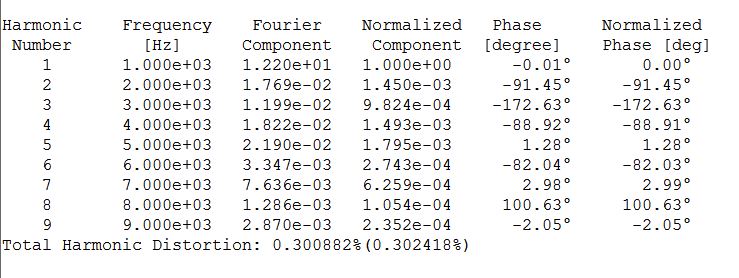

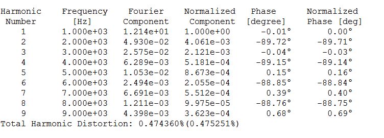

There is no easy way to automate this in LTspice, so each instance has to be run separately and cannot be displayed graphically.
The base resistor value and the bias current are shown on top. 20W/4ohms

27ohm, 224mA
no diodes 0.474%
diodes 0.3%

It looks quite fascinating. 27ohm seems to be a sweet spot where the diodes become really helpful.
Selfy is also right: at lower resistor values/higher currents the diodes appear detrimental to distortion.
Could this be a distortion compensation mechanism where use is made of the diode non linearity?
In a real amp the optimal value is perhaps different and may be worth the effort to adjust.

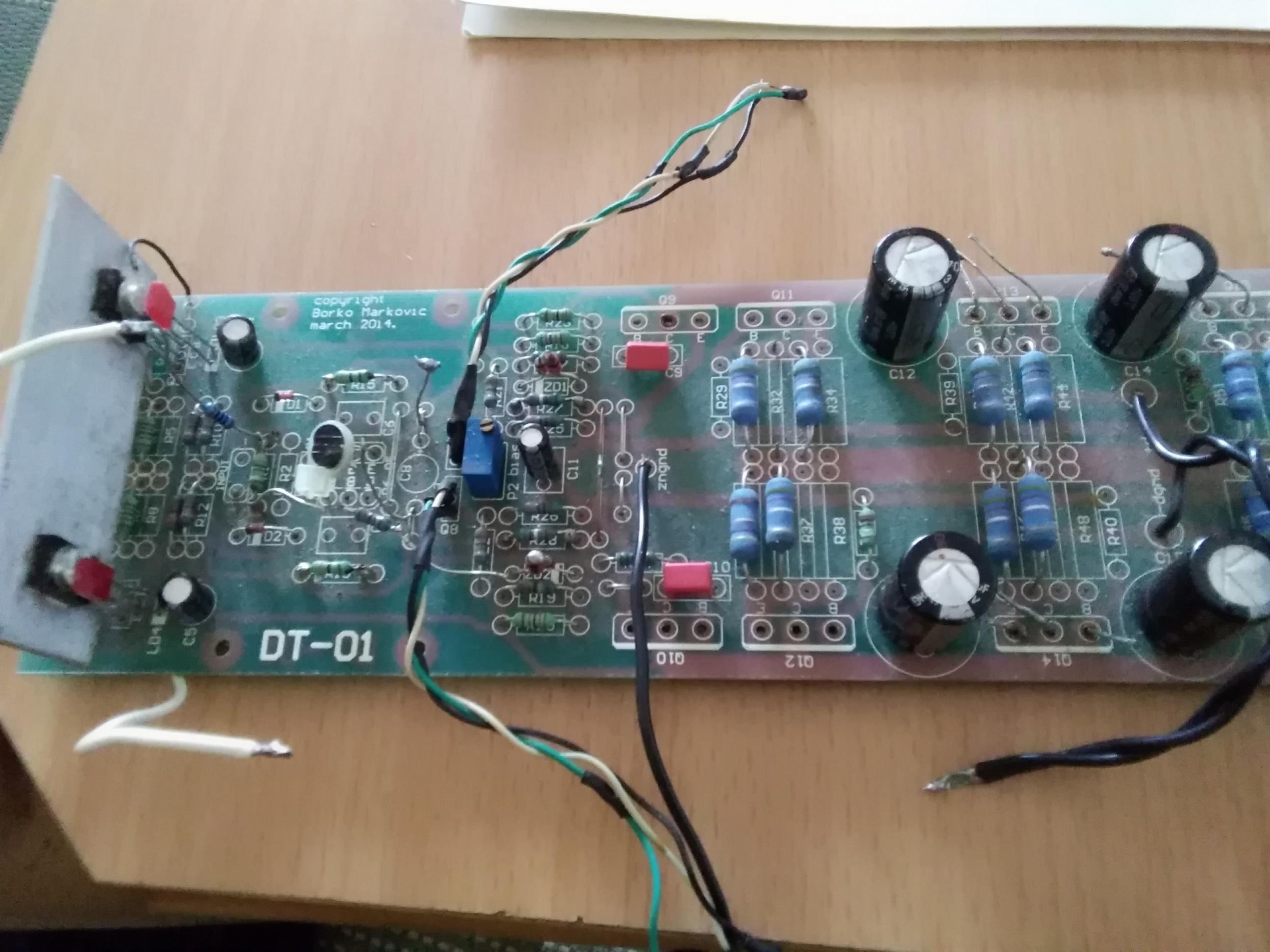

I've made power diamond buffer triple 6 years ago with 3 output pairs that worked in open loop and still have the boards collecting dust.. It sounded good with no noticable distortion and it was abused at several parties in open space with load <4 ohms with no problem. Then turned to hi eff speakers and small amps for home use and forgot about it until I've seen this thread...
