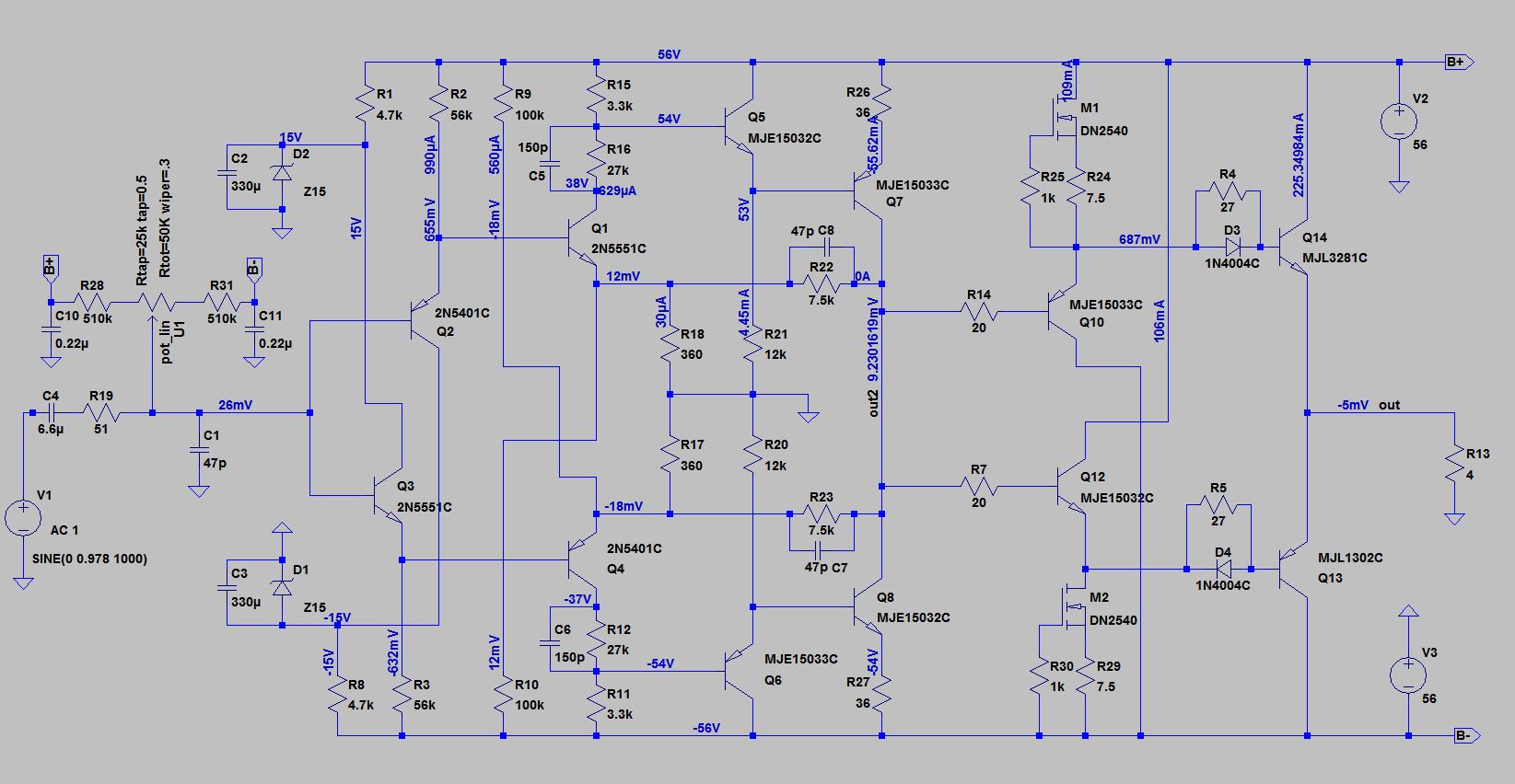

Somewhere along this monstrous thread i mentioned replacing the CCS with a depletion mosfet. It definitely brought some modest improvement.
The 10M45S is not very good sounding imho and nor is the Dn2540. At the moment one of my Dartzeels plays with my favourite IXTP01N100D but i see no reason the cheaper T0-251 part won't work just as well.

What's the bias current per pair in that 11pair thing? I guess it sounds better then original cos it's working in class A for the first 5-10W.

i'm I correct if I say, about the positive rail, drain (of the depletion mosfet) to +B, gate to the user, and source to the user (with gate) through a resistor (value)?
My goal is to obtain the lightest possible load for the VAS.
my favourite IXTP01N100D...
I searched on the net and could validate my idea about the resistor placed at the source.
I compared on Mouser different MOSFETs and found out that the IXTP01N100D performs as the best, among 11, in capacitance (the lowest). But performs at a low level in transconductance and shows the highest Rds(on).
Looking at SOA graphic @75C: for my application, it must deliver less than 50mA @140V possible swing, it could be OK even if very close to the left limit imposed by the Rds(on) but, in the original circuit, it must deliver 118mA @100V possible swing, that seems to be over the Rds(on) left limit. Right limit is respected in both cases.
Am I wrong?
Look at the datasheet, that mosfet won't work as ccs at Vds lower then 20-25V (at least). Btw Rds(on) is irrelevant for intended application.
Absolutely. And the more extra volts, the better.
A bigger Rds on is probably beneficial in this application
Never drew a circuit, but here it is now, obviously with the wrong model. The source resistor for this current is around 20ohms and due to dissipation should not be a trim pot.

analog_sa, I thought you were using mosfet css as a dynamic load on the input transistors, now I see you use them in the diamond.
Has anyone bothered to try CSS for the input pair instead of the 56k resistors?
You are right. My intention was to try them at both spots. I think i got distracted
Otoh, current sources do not necessarily sound better than resistors at all positions.
And talking of zeners, i agree with Domenico: those at the input must go. Even made a pcb with a 317 only never got around using it.
