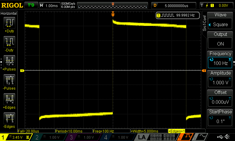

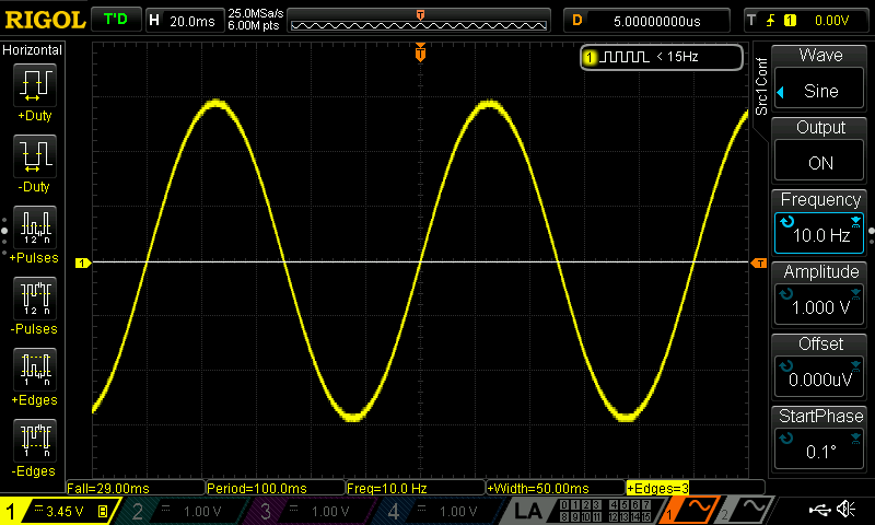

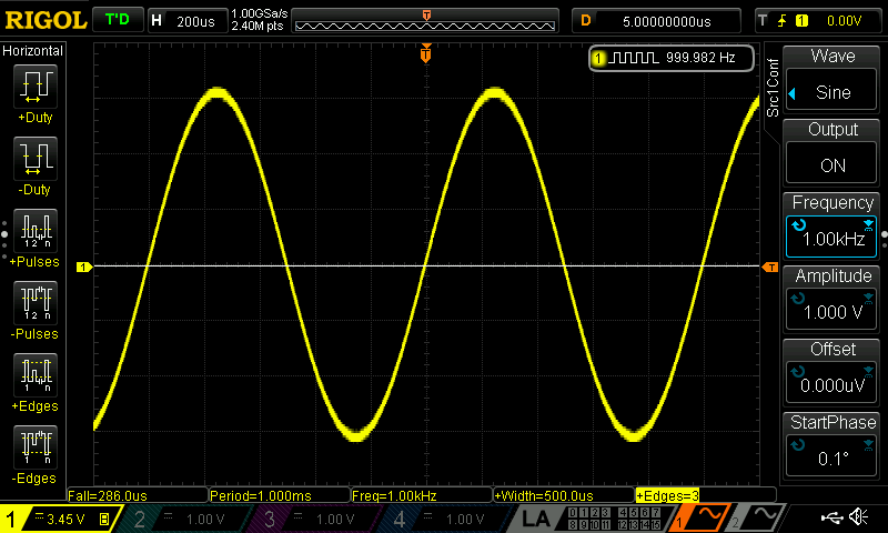

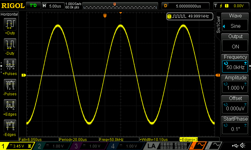

Today I have made several measurements of the amplifier based on Chinese NHB-108 board populated with components from reputable source. I have used good +/-25 VDC power supply.
I have attached snapshots of several measurements. Measurements indicate that the amplifier has adequate frequency response over the range between 5Hz and 50KHz. Falling slope of response to 100 Hz 1V square wave indicates moderate low frequency attenuation.
Hooked to speakers amplifier creates virtually no buzz, whine, hiss, chatter, or any noises. The amplifier is dead-silent. So silent that I was affraid that it doesn't work at all.😱😀 (Just kidding - Meanwhile I have learned how to make an adequate power supply)

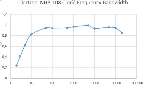

Seriously now: there was a word about the frequency bandwidth and Dartzeel has a plenty of it. Even at 200 KHz it doesn't even show signs of roll-of. At the other extreme, the cut-of frequency is at about 5 Hz.
Below you can see the results with the use of +/-42 rails into a pair of 22R 100W resistors in parallel. Just observe how it delievers plenty of power at 200KHz, more than 10 times beyond the audible region.

@Erlend
Ah, I understand - the graph is in logaritmic scale, for clarity. Hence the impression of signifficant rise. Observe, that the distance from 1 to 10Hz equals to that from 10 to 100 Hz. Logaritmic scale provides more resolution at the lower part hence making possible to show data over the wide range from 1 up to 1.000.000 Hz.
I think 5 Hz cutof is not so early, it's a normal and expected behaviour. If we go up to to the audible region, the roll-of is insignifficant. Normal electrical bass guitar has the lowest tone 41Hz, only the pipe organ goes close to 20Hz. Harpiscord goes slightly below 30Hz. Of course, there are inaudiable frequencies that we "hear" as the sound pressure but, still 5 Hz cutoff is fine to me. During the measurements I've "heard" inaudible frequencies as objects vibrating on my bench - not the sound but these object just jumped as the vibrations have moved them.
Thanks but I have been told 0.5 Hz is to be preferred for the reason off the attack in bass. And roll off starts 10 times higher then the -3 dB point. Anyway does the servo also harm the attack. All in in all I think the amp is really good now. I use 47 uf bipolar as series capacitor at input. Looking forward to your review off the amp when you Finnish it.
