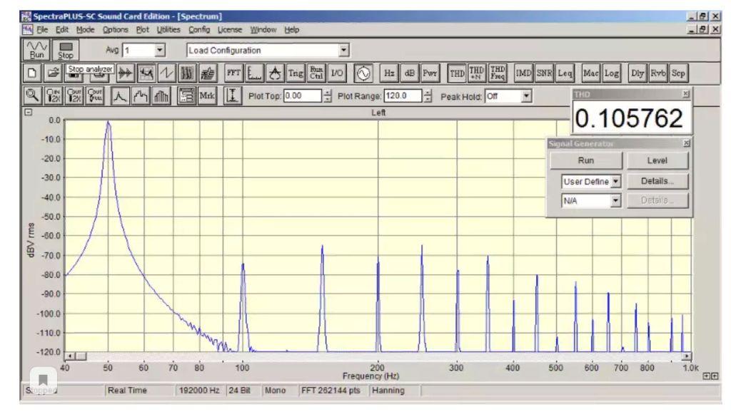

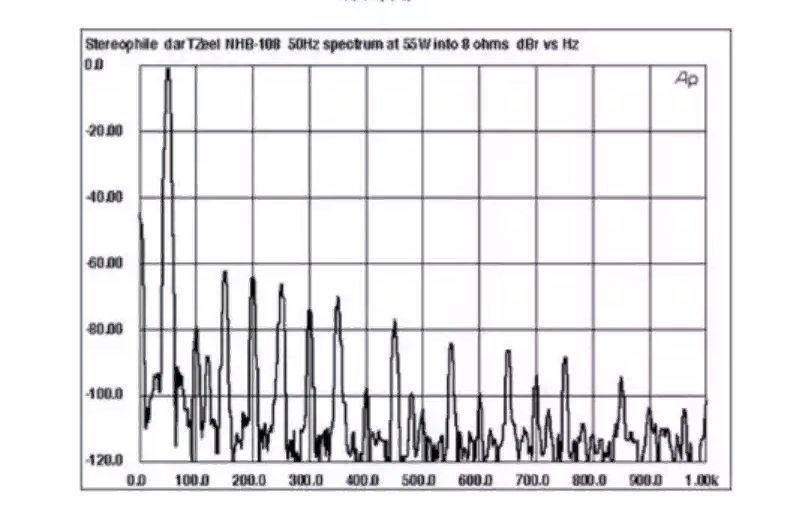

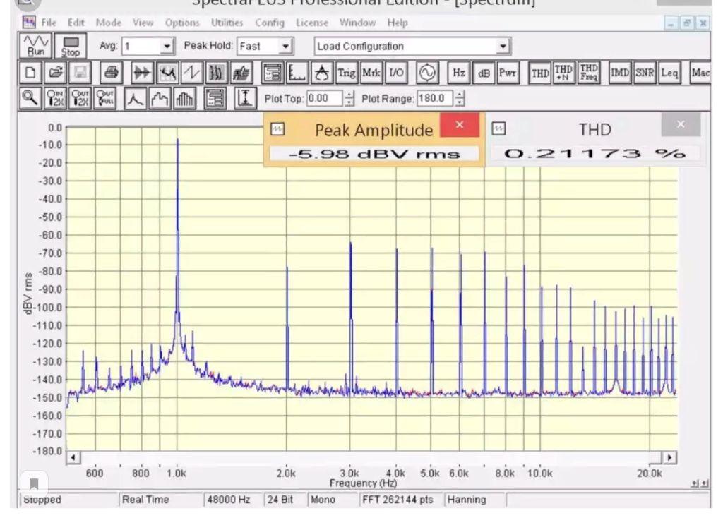

It's fairly large thread and I don't get it what is happening..? There's a clone based on schematic and it's close in measurements to original or not? Optimizing the circuit to measure better wouldn't be hard but that's not a clone then... So what is the goal of the thread?
I think the Russian guys from the forum will not mind if I post pictures for you. They show a graph of the original and the blue board of one of the participants, a photo of which I threw off earlier. This is for those who understand.😉
