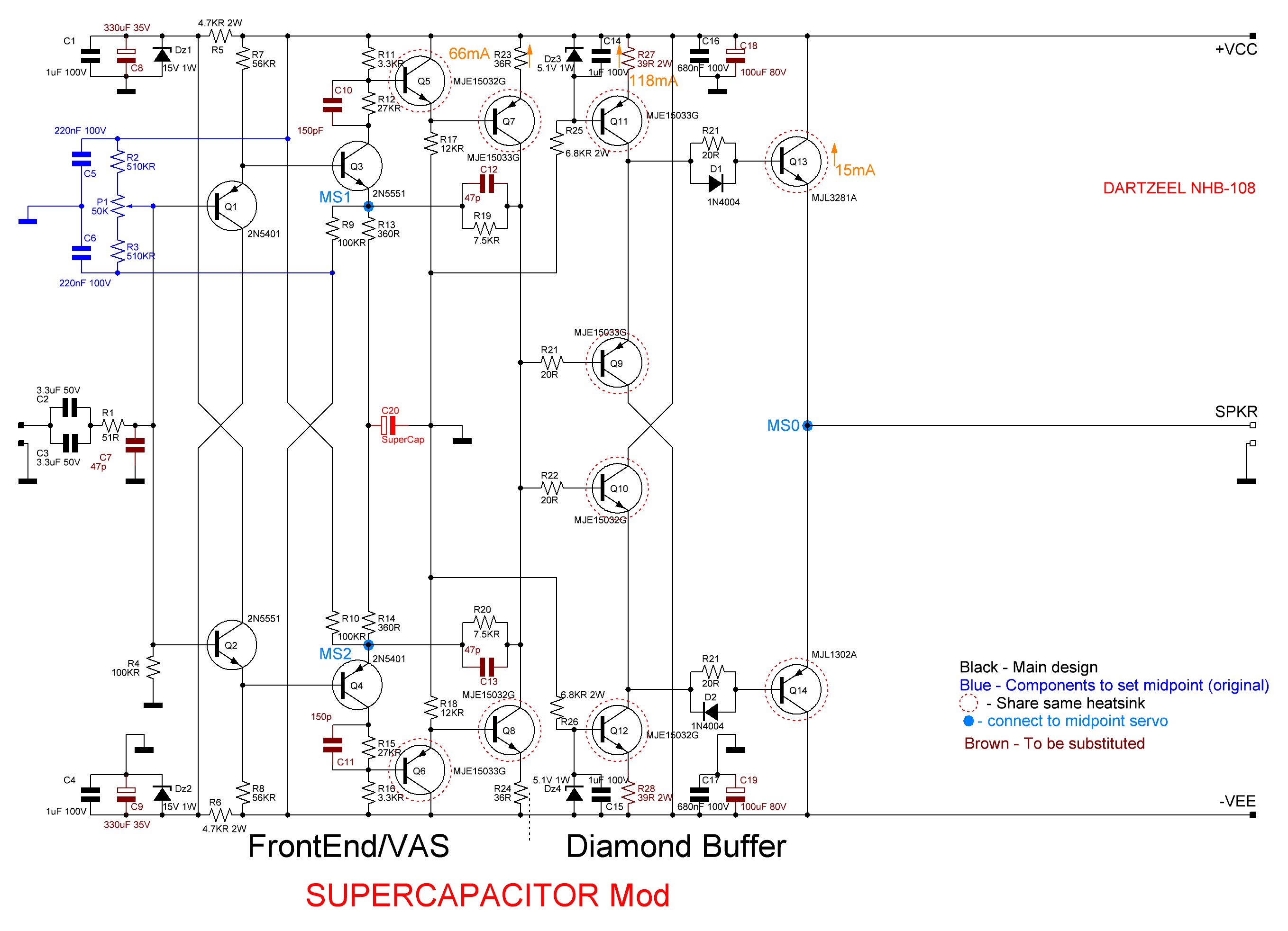

I dont remember if I got the scheme of the servo somwhere or I reverse-engineered the assembly. A thing seems strange to me: perhaps a resistor is missing berween the OpAmp output and the inverting input. Mine are mounted in the amplifier and I do not want to dismount in order to check. Could any of you do the job, please?

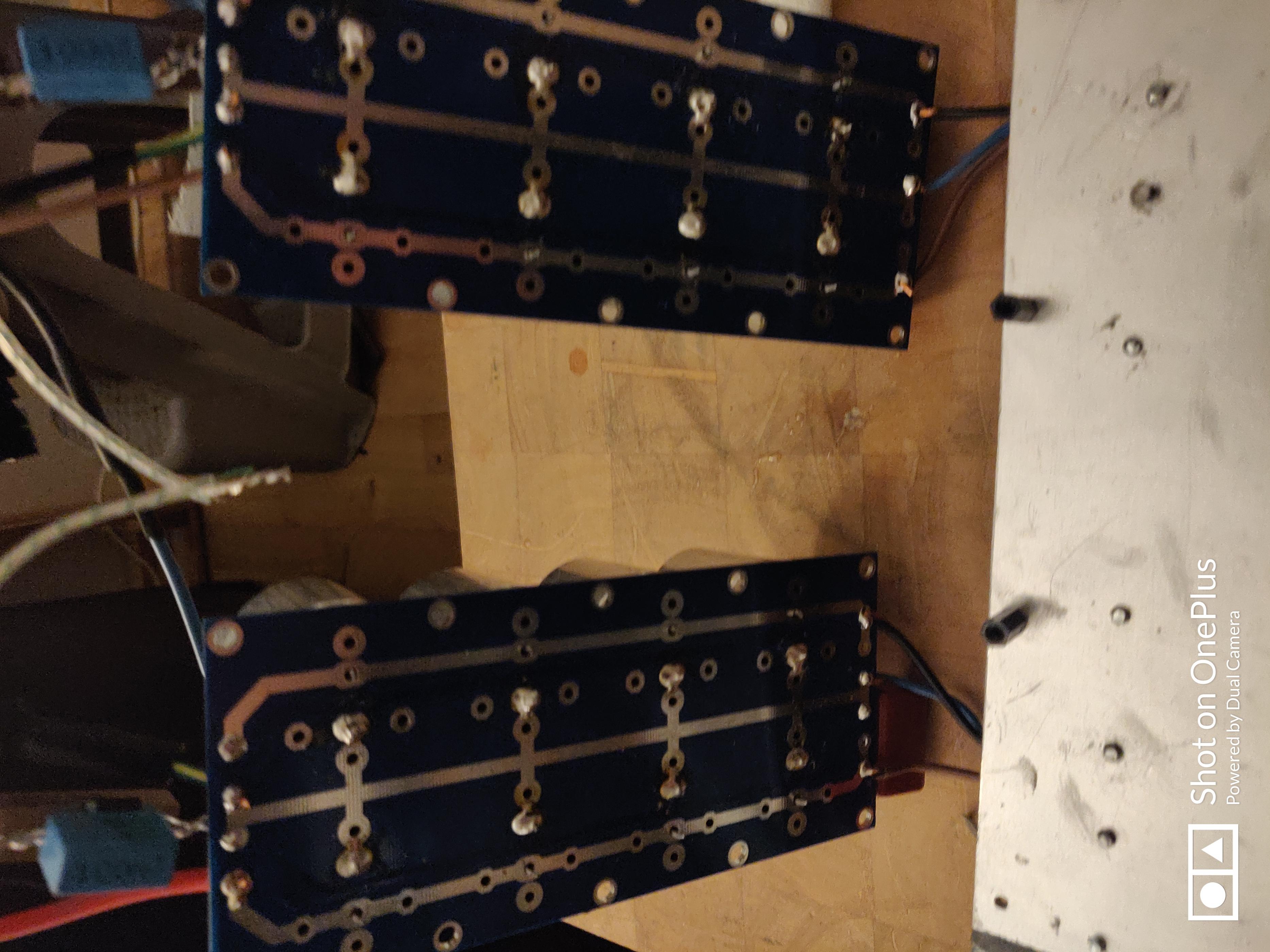

Hum - found the reason and it's crazy.
Had the PCB for a year or two. I did not discover the missing solderings 🙄. It's absolutely crazy. Offcourse I have hum. It disappeared and came etc. I guess there was momentary contact. Tomorrow I will Finnish it.
Your schema don't miss a resistor between the output and the negative input.
The differences with my original are only :
R1 R2 R3 R4 = 1M not 100K
R5 R6 = 33K not 10K
do you confirm these changes of value in the new schema ?
You're right! My values are wrong.
I don't know why I reported those wrong values.
However, the only things I changed are in brown and red colors in the schema. I could not check original values on my servos because they are mounted and not accessible that easy; I checked the pictures you can find by Googling them.

Is this the Supercap mod?
If yes, you see, it can't work.
In order to work, you must sense the CC offset at the speaker output, not at the end of the voltage amplifier.
Could any of you that knows the mod for sure post it?

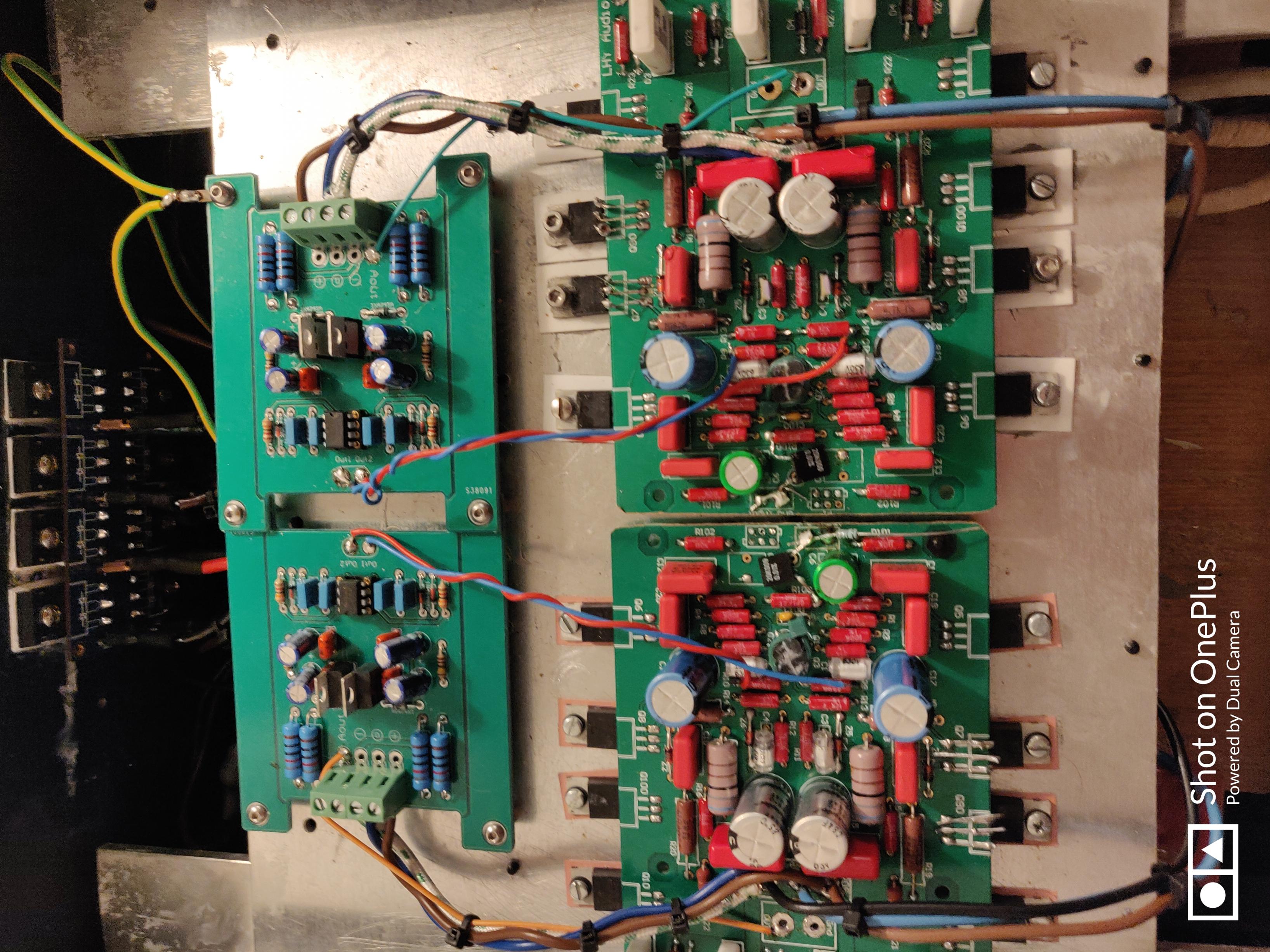

Up and going and use 0.85 A from 230 vac. Everything looks ok. So looking forward to listen tomorrow.
I hope this is an experimental assembly. DO NOT TRUST THE METALLIZED HOLE as a conductor! I saw you soldered a wire on top of a pad allowing the current flow thru the metallized hole. Do not trust it, it could burn and bring with it some other stuff. I'm used shorting all pass-thru holes.
And let us know!

Some minutes ago I finished servicing my WHA-216, in my lab, adding a couple of fan inside. Then I connected it to the lab speakers (awful indeed) and they started sounding incredibilly good (Sheffield Lab Lincoln Mayorga Vol III). The amplifier I have in my lab is a LJM L20 with some light mods, its sound is not a miracle but decent. But the WHA-216 really pulverized the L20. Not for power, that scares me to raise the volume (I was able to burn a woofer recently) but for sweetness and absolute control of the speakers. I was in a hurry so I was not able to dedicate the right time to listen carefully but, usually, the first impression is the right one.
So the servo cannot be that bad, at least with my mod. I cannot imagine how sound quality could improve removing the servo. One thing for sure, I really hate to have the midpoint floating, and it floats a lot. I think selecting carefully the 2N5xx1 and coupling them thermically would be a good idea to limit midpoint excursion. I will do on the next assembly. I want to experiment carefully and without any hurry, on the NHB-108 because it is very worth it. And even because I have a double 60+60Vac, 1KVA transformer looking for a job.
I was a follower of Bartolomeo Aloia (Italian engineer) and watched at all amplifiers he proposed: they have no total feedback (some - the elder ones - have a very low fb) and have the servo connected as a phase inverter. So, on those amplifiers, you must use an operational or equivalent circuitry to invert the phase. On the contrary, in the NBH-108 the servo is used in phase because it is connected to negative input (emitter of first MJE1503x transistors). So, why do you want to use an active circuitry? Perhaps you need some voltage gain to generate the due correction signal? To be verified.
By the way, dear DEOUNE, I could check my assembly: the resistors on the servo are 1MOhm and 33KOhm, no 100KOhm, no 10KOhm. I confirm I was wrong.
And let us know!
I don't understand. I think you have seen the sensor conductor from the servo? I can't possible see there could be a problem with that. Orange or green conductor.
