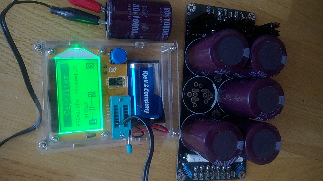

I just tested one of the six capacitors on one of my two power boards:
ESP=0.21Ohm, Vloss=1.3% Capacitance 9120uF.
The capacitance reading I understand but are ESR and Vloss acceptable?
Thanks!

ESR of 0.21 ohm for a PSU cap seems high ( not ideal). You want something in the 0.04-.08 range or lower

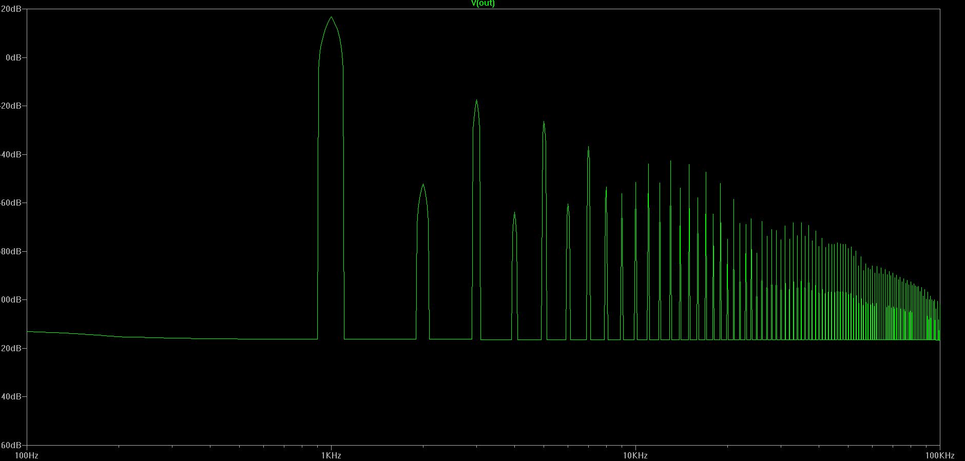

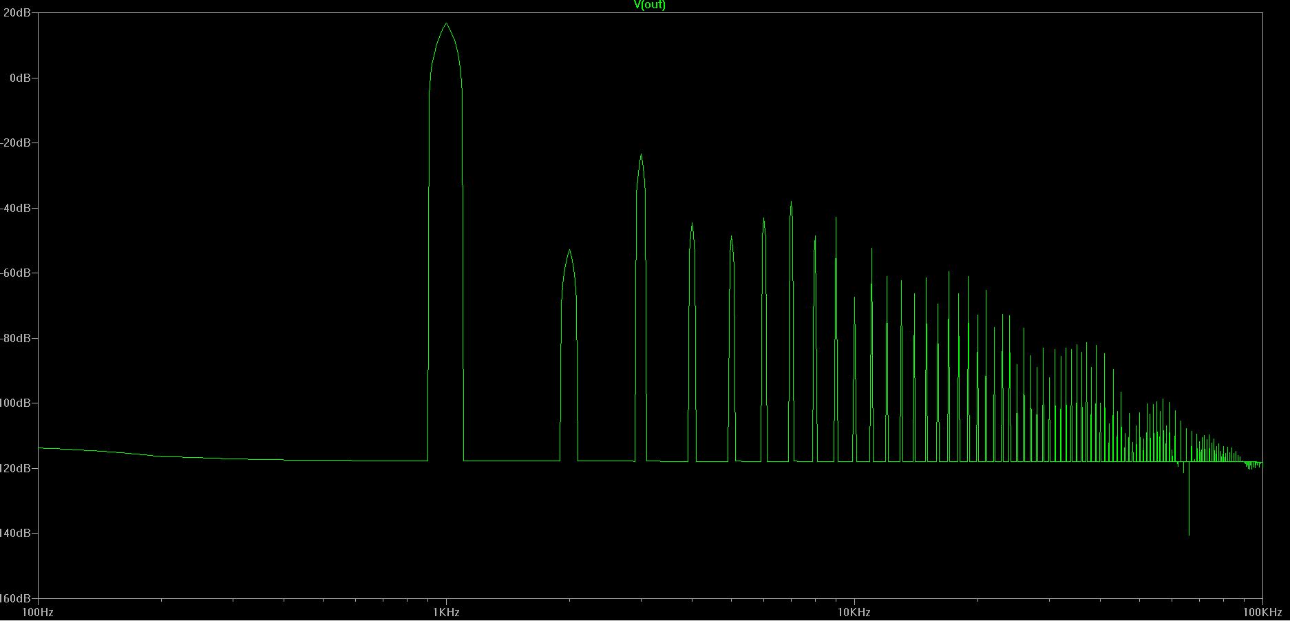

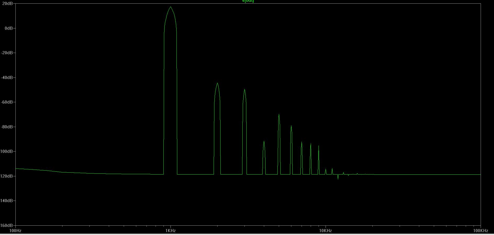

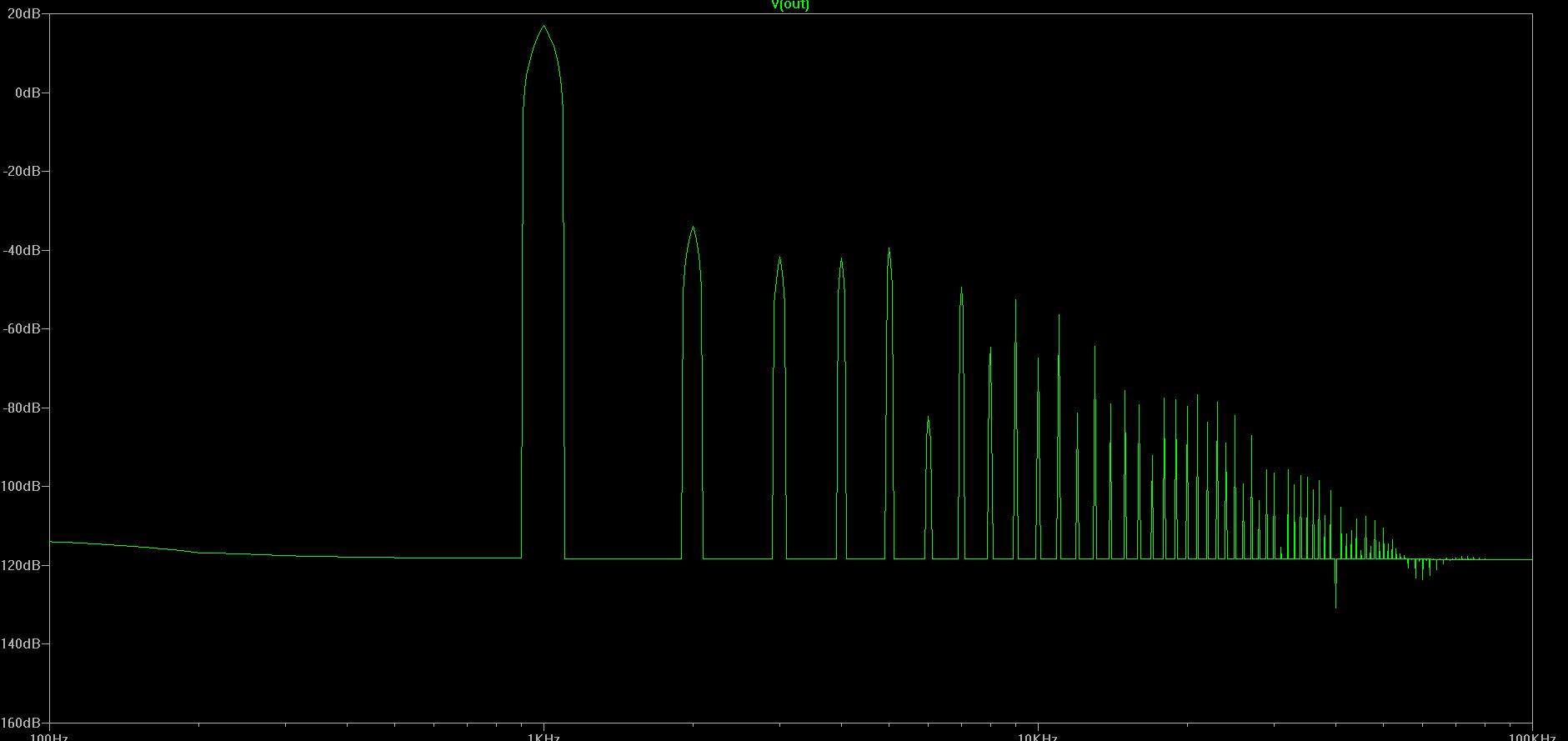

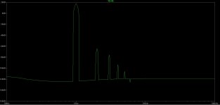

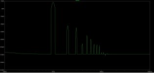

Yet, simulating the 108 circuit shows that increasing the bias leads to a reliable reduction in distortion and especially the high harmonics.
Obviously multiple output pairs will be essential and possibly a reduction in supply voltage. So, probably 3 output pairs and +/-25v supply would be great if one wants to experiment with a lower power class A Dartzeel.
The original seems to have the outputs idling at 220mA, so here is a comparison from left to right of the distortion spectrum @15W/4ohms for bias set@ 80mA, 130mA, 220mA, 770mA, 3.2A

You have believed a lot of BS from those Self books. No wonder he hates audiophiles and good sound with a passion
You never cease to be amazed by how mesmerizing purely simulation-based theories can be.
You have believed a lot of BS from those Self books. No wonder he hates audiophiles and good sound with a passion 😀
I'm trying to buy another pair of empty pcb that I will fill with better quality components. Also, I have to place the thermal tracking elsewhere because now it senses always the heath produced by the board (small transistors) that is hot, and the output pairs are only warm. Now, working in B class, any automatic bias control would never go under the actual bias. But in the future I will see. However @ 3A it shows the good distortion but it is crazy, I would need far bigger heathsinks. Since it is not my intention going lower than 200W, 3.2A+3.2A @ 140V are 900W in heath. Good during winter, cannot listen at music during summer, or power up freezing air conditioning adding some more KW.
No, this is not really an option if you need 200W. I lived for a long time with an amp which dissipated 600W idling and it wasn't much fun in summer, spring or autumn.

before measuring a capacitor you must short it. Try it again. For our purposes, to keep it simple, the ESR is like a resistor in serie to the speaker; the Vloss measures the ability of a capacitor to store energy, look at Capacitor Voltage Loss Vloss | Capacitor | Resistor

I dId short the capacitor before measuring. I did try several times. The reading changed slightly for each test but landed around the same figures.
I ordered a simple Transistor/ESR tester and was curious if the €32 ea including air freight power boards are good enough to keep rather than returning them within 30 days. It was impossible to test the Total capacitance of the board so I removed one random capacitor labeled 10.000 uF. I guess a 9200 uF reading is acceptable?
The ESR and Vloss readings are more of academic interest. I am curious how significant those readings are to sound quality + I guess the 0.21ohm reading is not a bad enough reading for me to return the boards?
