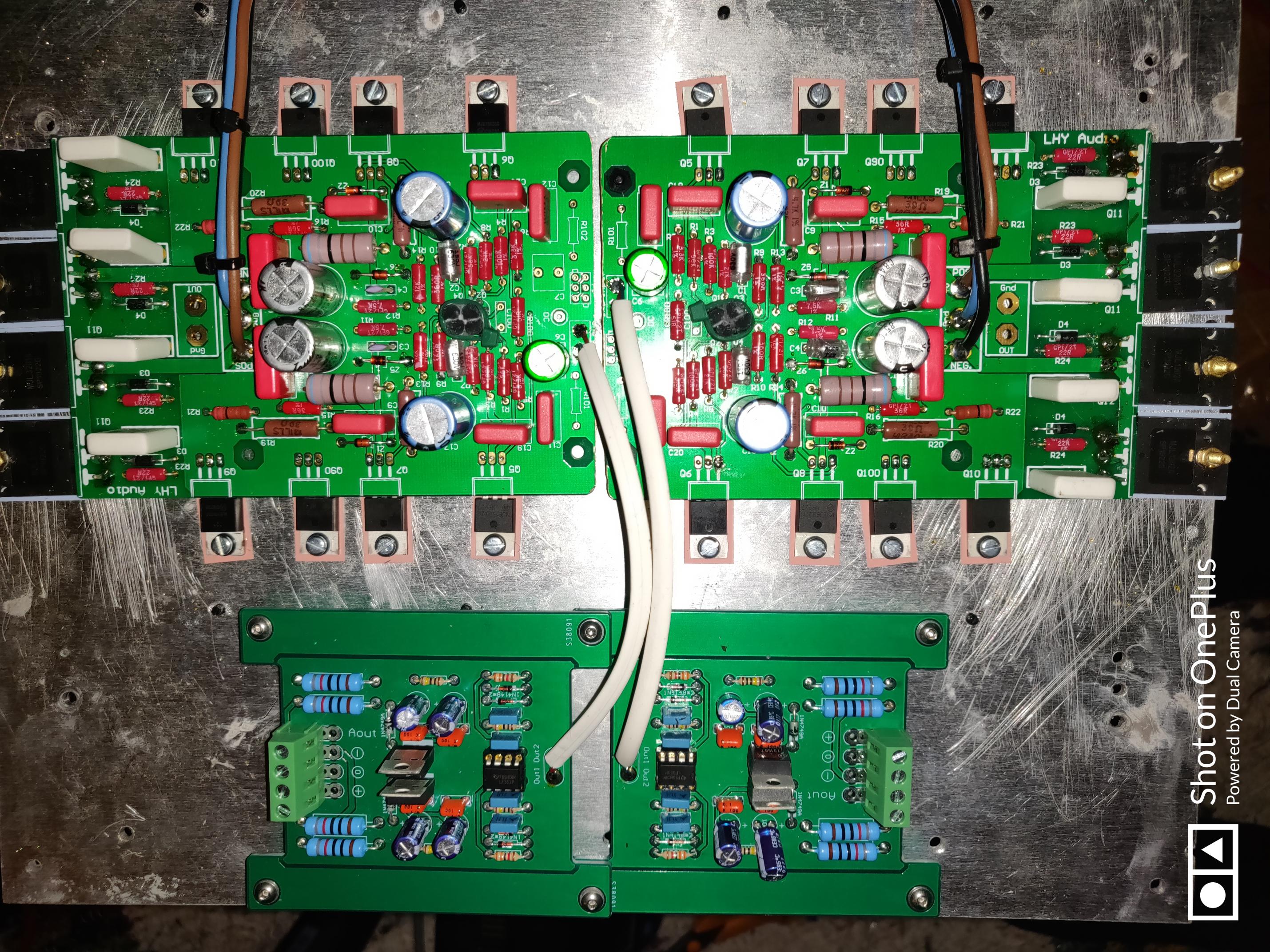

Do You see anything wrong with this board?
1pcs Luxury Power Amplifier Board AUDIO Imitation DarTZeel NHB 108 Power Amplifier Circuit Board|Amplifier| - AliExpress
It has the DC servo, Standard NHB 108 design - but three output pairs.
I was thinking of buying just the board and get components separately. On the other hand, this seller claims they use matched Original Onsemi transistors and that the board is designed for AC voltages up to +-45V.
So maybe I can get this readybuilt board, after all, and just modify/change/add a few components according to your schematic? Will three pairs of output transistors be enough?

As output pairs I used Sanken MT200s 2SC3264/2SA1295 that are obsolete and no more available; you could use the couple MJL3281A-MJL1302A and the couple NJL3281D-NJL1302D, for thermal tracking purpose, as drivers, sharing the same other couples heat sink. At least 4 output pairs, while I consider 6 to be the optimal number; let’s have a low damping factor and not go lower than LJM L20!
Because of Douglas Self explained reasons, you must use 0.1Ohm emitter resistors and a 2.3uH (14awg wire, not thinner) coil paralleled with a 10Ohm 5W resistor before speakers.
The board you linked has 3 output pairs. Provided they are the same transistors as MJL3281A-MJL1302A, I can say that, with respect to one only pair board, they will work under better SOA condition but, if they didn’t reconfigure the two CCS, nothing changes respect to the one pair board. The original CCS supplies around 115 mA, you can use as many pairs as you want, they are driven with nothing more than 115mA. And they miss the Deletraz’s goal to eliminate the Re, because here they must use it. But, for a modding purpose, it should be a good choice even if bulky. An empty board! I do not trust anymore any transistor coming from China.

About the mid-point servo: take a look to my #1278 post, there is the schema I modified; with that mod no more bad effect on sound should occur.
About speaker protection: in your picture you show only one; in order to build a dual mono project you must use two of them, the two grounds must remain separated. So buy another and use the two relays in each merged in parallel for each channel. Use a ground decoupler similar to the one I posted at #1288.

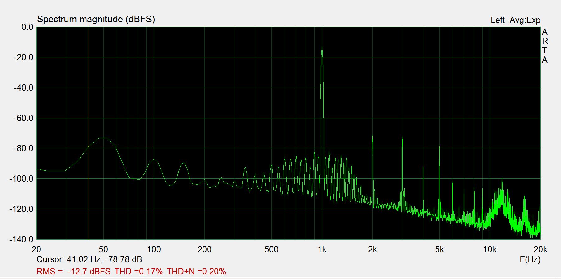

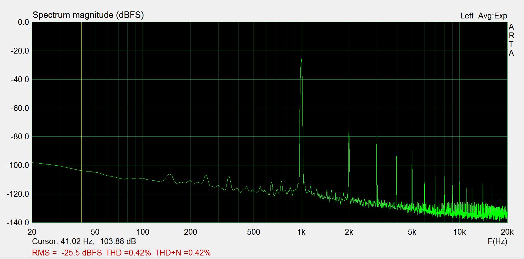

Talking of tube amps, here is a distortion comparison: 5W into 4ohm. Left is the original Dartzeel schematic, right is a pp 2A3 amp with a transformer phase splitter.
I learned you can only measure the distortion in tube amps by your ears. Ugly graphics, worse on PP, even worse with pentodes. Always lovely sound. Mine are PP of EL34 on Acrosound and EL84 on Trusound, both ultra-linear. I left them in Rome, too far from me to compare with the modded NHB-108. I love them all. Ogni scarrafone è bello a mamma sua (Italian for "any ugly cockroach is beautiful to his mother")

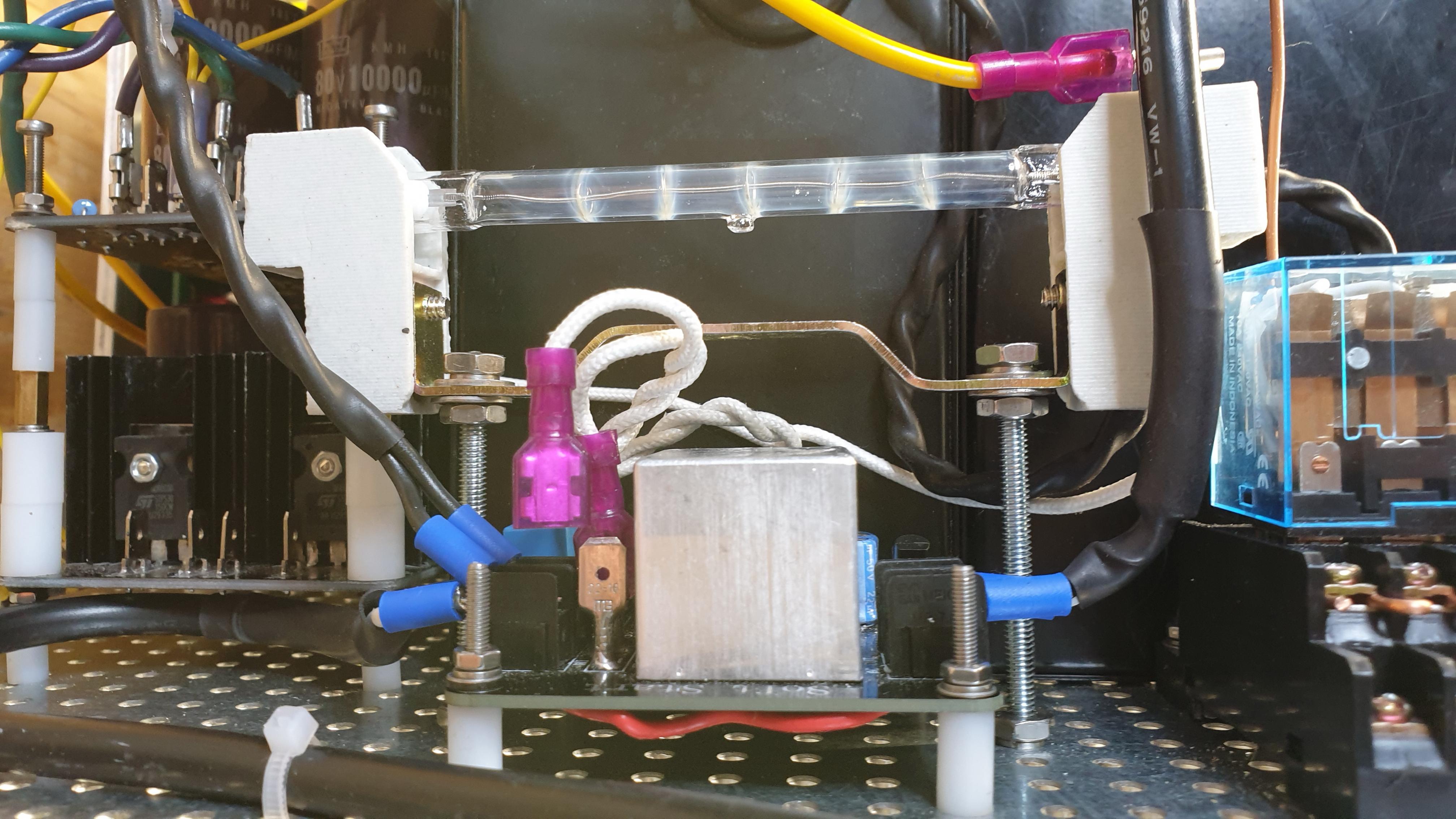

Hattori, you're right, the relays on your board are the same as the ones on a speakers protection I used for another amp. That is a soft start. On my soft start I changed the NTC with an halogen 300W bulb (see the picture), the inrush current is very high, perhaps too high for the tiny NTC with two 625VA toroidal transformers with primaries paralleled. So you have to buy two speaker protections boards. Choose the 30A ones and, on each, use the two relays paralleled for each channel. I used a couple of 4 ways 10A Chinese relay (paralleling the 4 ways) getting confused on the brand: "ONROM" instead of "OMRON" wich is the original brand; the relay is good enough except for the ugly internal wiring that I had to substitute with a true wire. You will need a 15Vac small transformer.

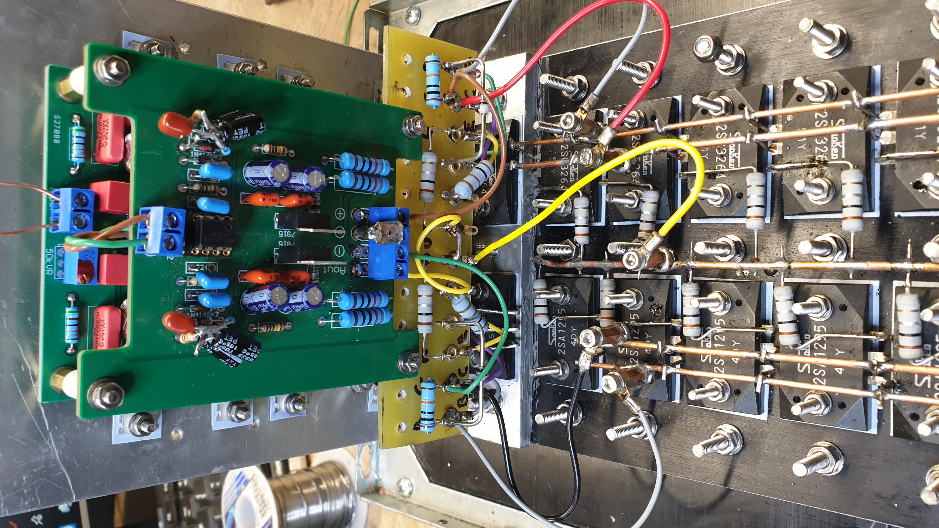

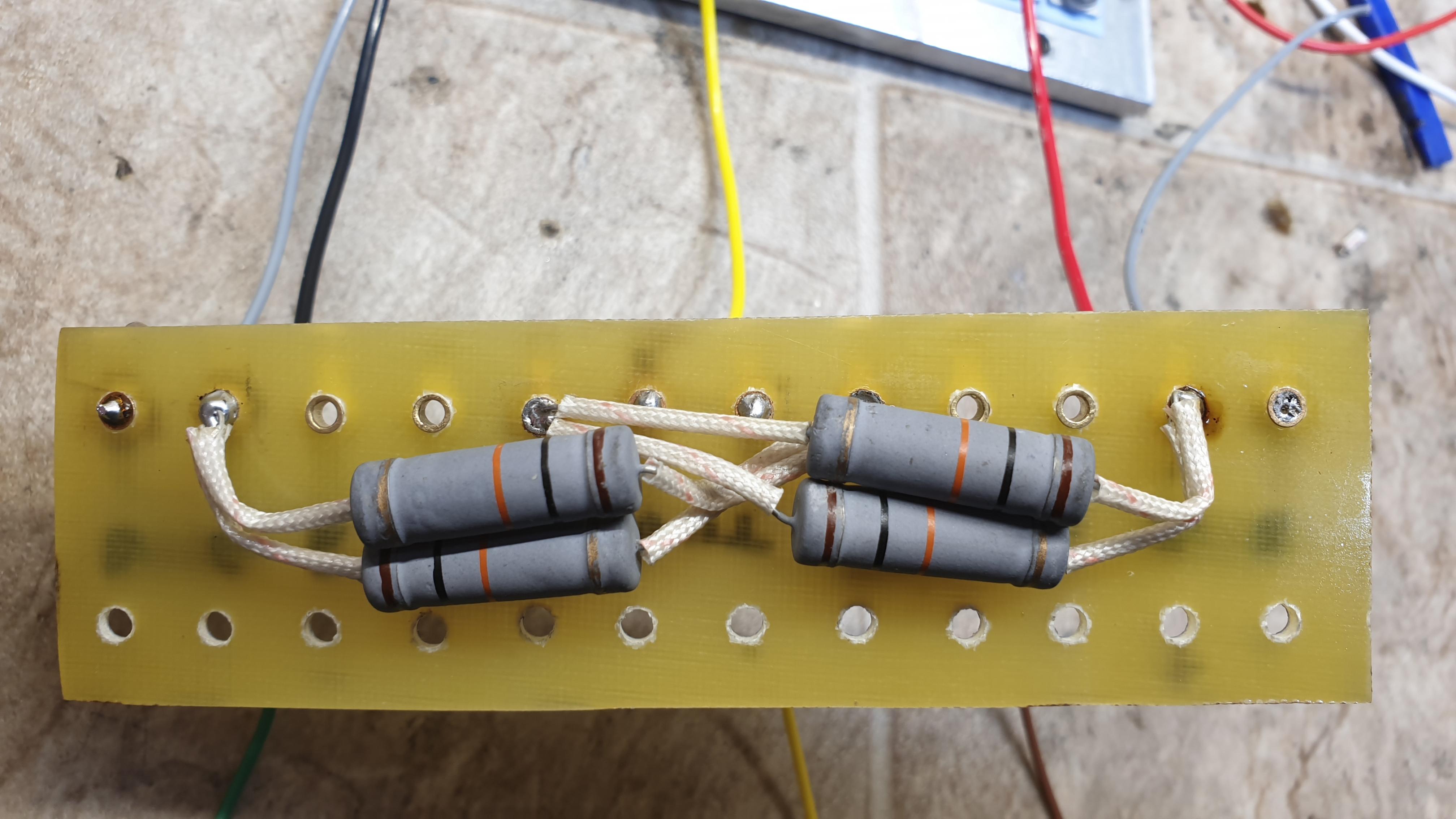

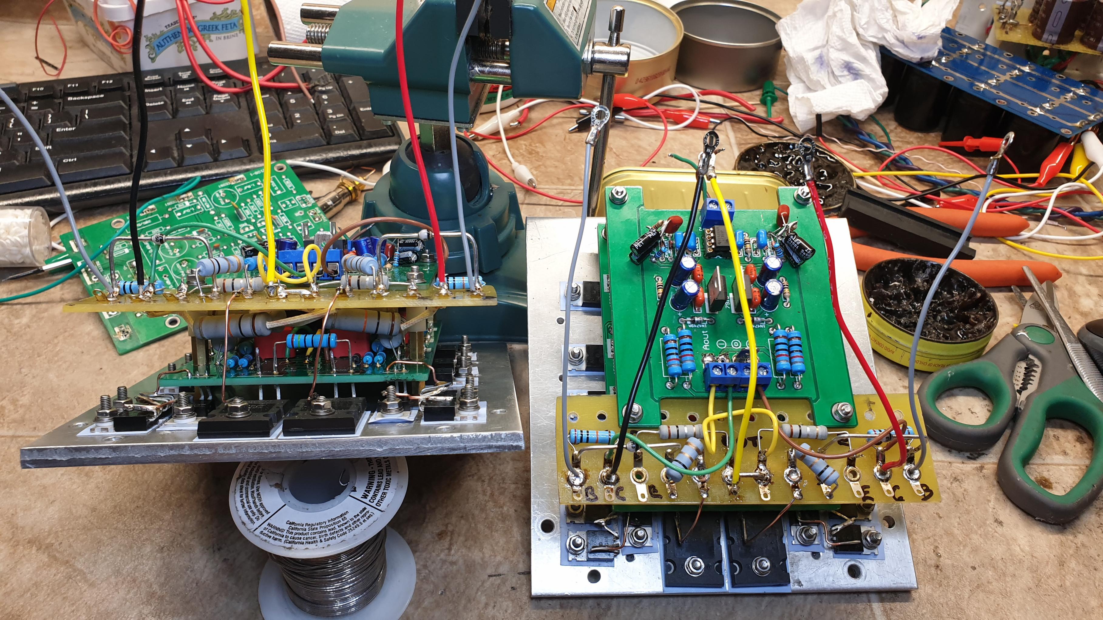

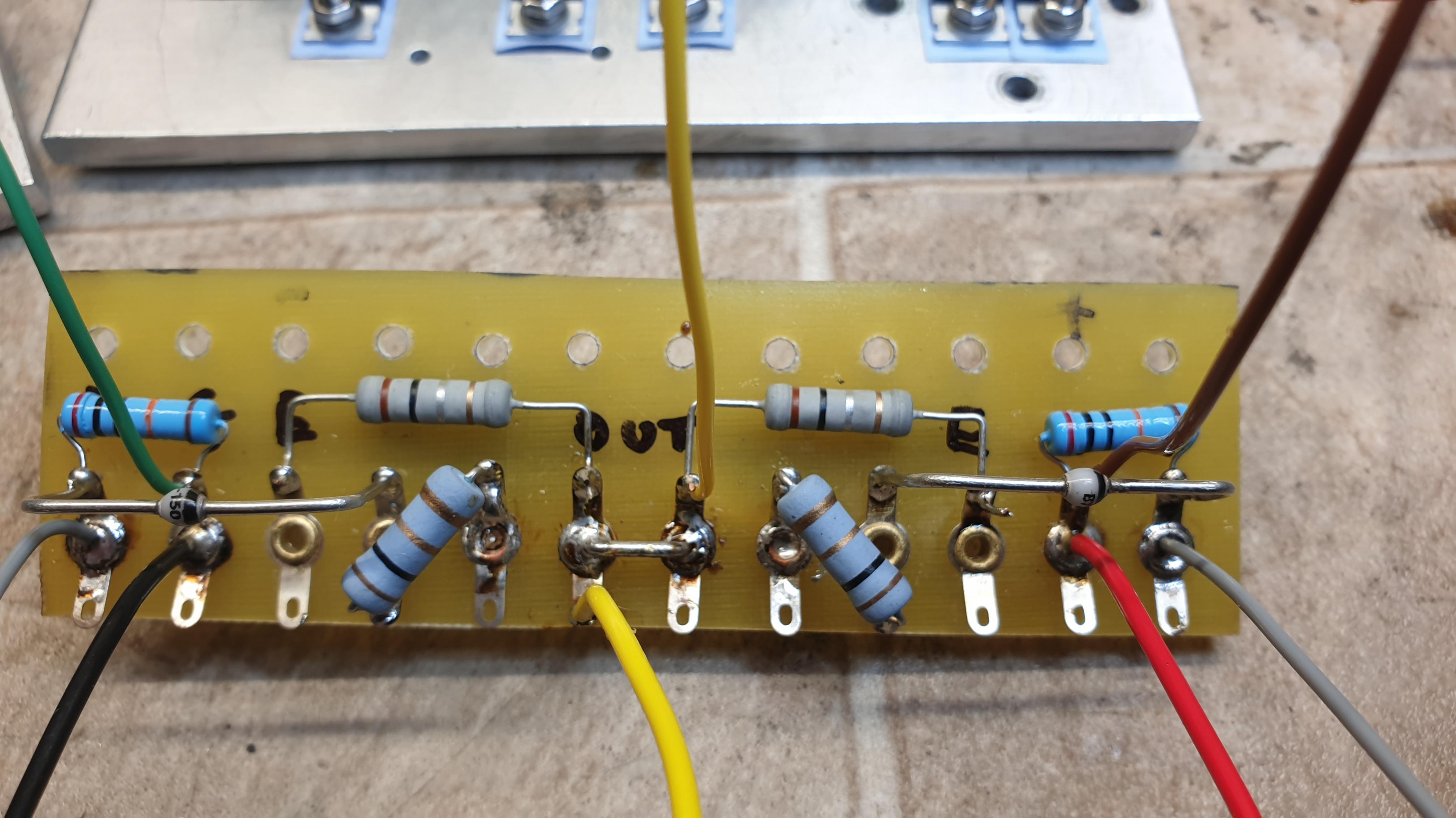

Hattori, these are the pics of how you can organize the added components on a small board. The two 0.1Ohm resistors you see, have the purpose only to test the assembly with one only pair of output transistors you should have on a small heat sink, just to test because you do not want to risk a whole string! Once tested, when you connect the board to the real string of output pairs placed on the big heat sink, the two 0.1Ohm resistors will remain unused, you can remove them, I didn't, you never know. Grey cables are the bases, black is the PNP collector, RED is the NPN collector. One yellow is the common point of all emitter 0.1Ohm resistors. The other yellow goes to the servo to bring the output to be sensed. I replaced the two 200KOhms resistors you see in the picture with 1.2MOhms, as you see in the schema.
