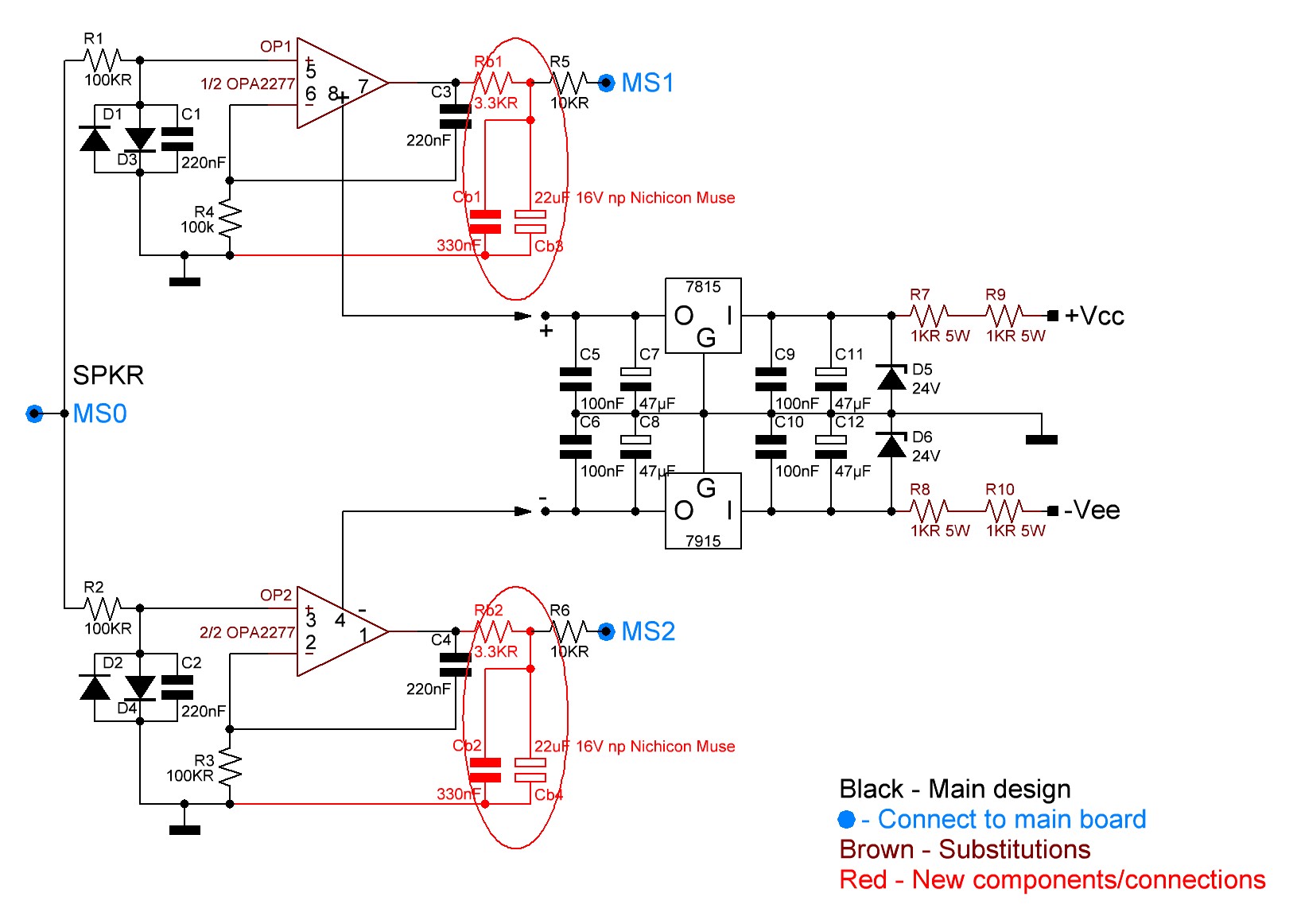

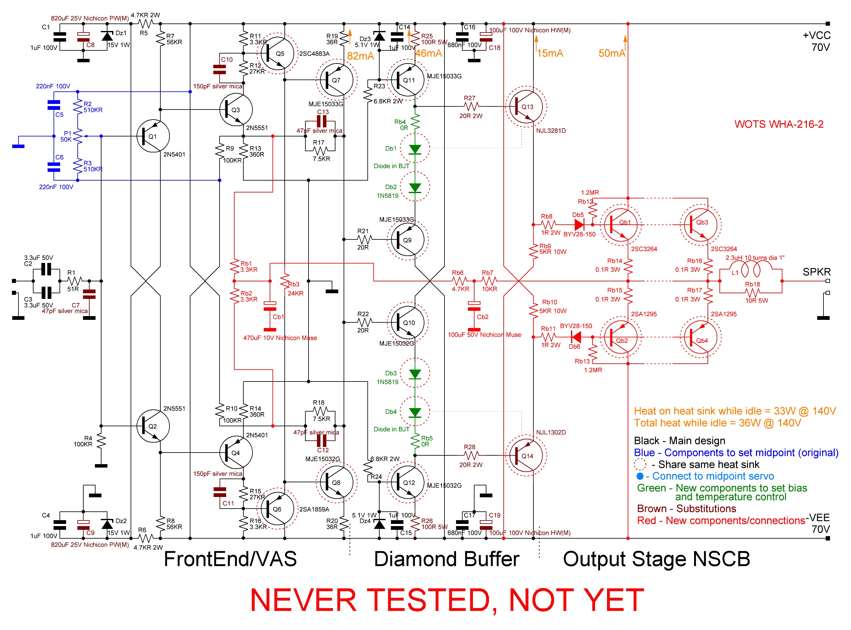

Even more mods
I need another couple of pcb to use better quality components, to try to improve the main circuitry and to get rid of the mid-point servo board. Here are some more mods to be experimented, the schema and the values are a starting point. I think I'll buy pcbs on Aliexpress.
Any comments will be appreciated.

If you think the servo sound bad could it be the bad supply for it? Thinking maybe better with a discrete supply!
Erlend Sæterdal, I can't hear any difference with/without servo. But I never used the original circuitry, I modified it as soon as I got it. However, as soon I can get a couple of bare pcbs, I will try to eliminate the servo by applying the mod in the schema. Even if I think it will not work correctly because the CC feedback should be higher in voltage. But it is so simple that it is worth a try.
I found it at my supplier Vishay SMA/MBB0207 0,6W, Vishay PR02 2W and
Vishay AC05 5W.
I will try to make an amplifier without a servo circuit first, and if necessary I will make it later.
Can you post a schematic of a modified servo circuit and explain what part of the change they are in and why it is so much better
He has added an RC filter at the output. Despite this i bet the opamp type is still clearly audible.
....and replaced the opamp, I believe? The modified schematic specifies OPA2277 and it is marked in brown color (as in Substitusions)
