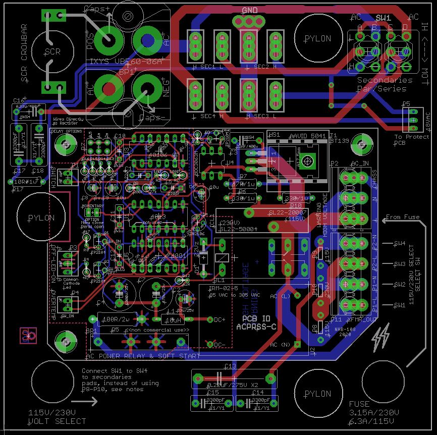

Hi. That could be my take on the NHB-108 pcb under the power transformer.
I used the already excellent Mark Johnson Power-On Softstart PCB design that I modified and Added the transfo surronding parts, including the 4 secondaries Parallel/Serie switch. It also include a high current rectifier that will be bolted on the amp bottom plate. The circuit includes:
-Mark's power-on and softstart with 5V SMPS standby power supply, this module support 85-305Vac so no need for the line voltage selection.
-The original Shurter 115/230V volt selector is monted on the corner of the transfo plate, and wires connect to the transfo primaries, replacing Mark's P8-P10 jumpers.
-The Shurter original fuse socket is in line with the main power before entering the Power-On section.
-Added pads for the Crowbar protection (to use or not) to connect the SCR directly on the Caps+ and Caps- to discharge the power supply in case of a fault. The SCR is directly wires to the protection pcb...
-Added Stackon connector option in addition to the 6.35mm pitch Phoenix ac connectors. We can also solder the transfo wires directly to large pads.
-Added AC input film capacitors option. Can be installed on just one pcb since the AC input is shared by both pcb...
-Added the hi-current rectifier with snubbers, taking its AC input directly from the transfo secondaries. It can be bolted directly on the amp bottom. The filtering caps can them be wired with hi-current wires directly conencted on the rectifier large screws...
-Added the 4 secondaries (using two dual 18V smaller transfo, with common primaries, making a possible 'clone of the actual custom Dartzeel transfo). A simple toggle 4PDT switch (rated at 6.0A) to select Parallel or Series connection.
-Added the inner fixed secondaries output AC (18-0-18Vac) to supply the futur protection PCB (as the original does)
-Added an Overtemp protection sensor (NC if temp < overtemp point). The input cut the <PWR_ON> signal on the circuit, killing the Triac and bypass relay, turning the amp off...
-In this version I kept the dual leds power-on, power-off, but they can be removed since they won't be use on the amp. Further mods such as the momentary jumper and softstart selection options could be removed, by selecting the correct softart and switch option.
-An other step could be to replace most of the logic with SMD parts to reduce the control section PCB footprint
But you get the idea...

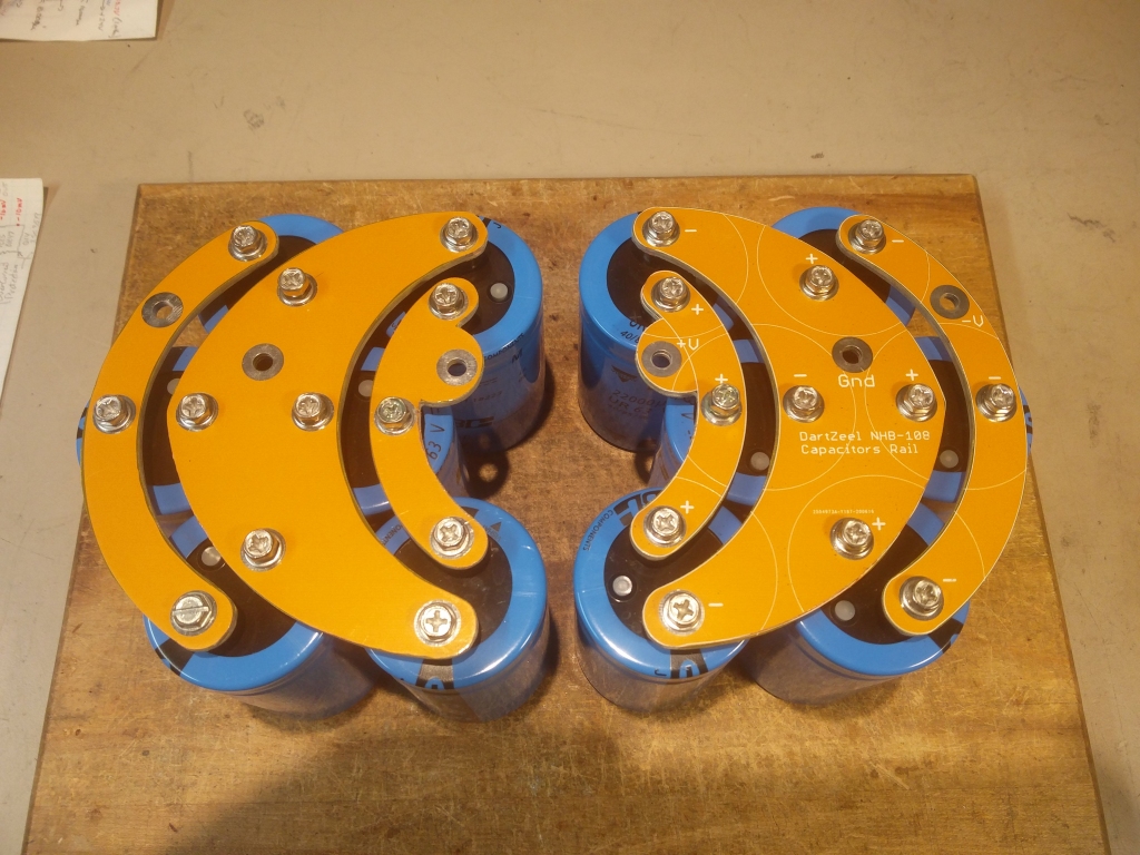

Capacitor Bank Brackets are working fine...
I get nervous when I see these arrangements. If you drop a screwdriver or your watch shorts these, its like an arc welder in your amp. Also whats the current thinking on these big caps. Do computer grade caps offer sonic advantages over snap-in caps? Sorry I don't want to get into another debate on caps a yes or know will suffice 😀
Seriously? The original copper arrangement is a lot more dangerous, yet it is being manufactured in the watch capital of the world 🙂
Comparing caps with screw terminations vs snap ins is not easy as those seem always different in more ways than just termination.
Per example, a direct comparison between Mlytic snap in and screw types with identical capacitance but different voltage ratings makes me prefer the snap ins.
This is nothing I use 600.000 uf in some amps.
