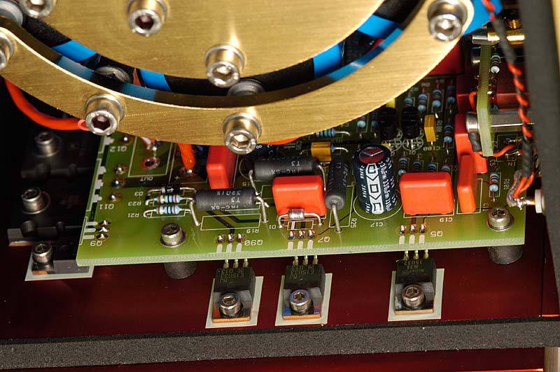

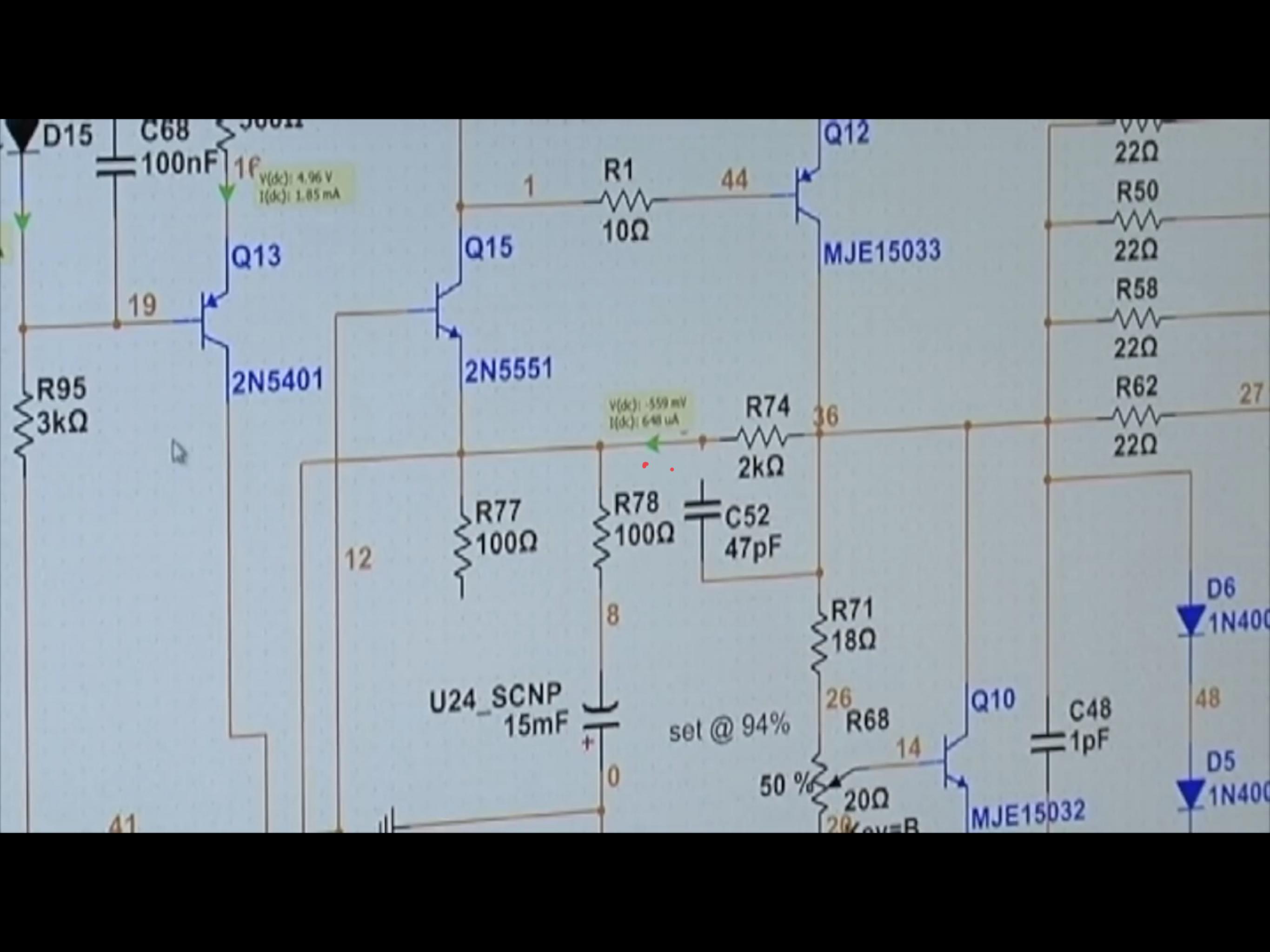

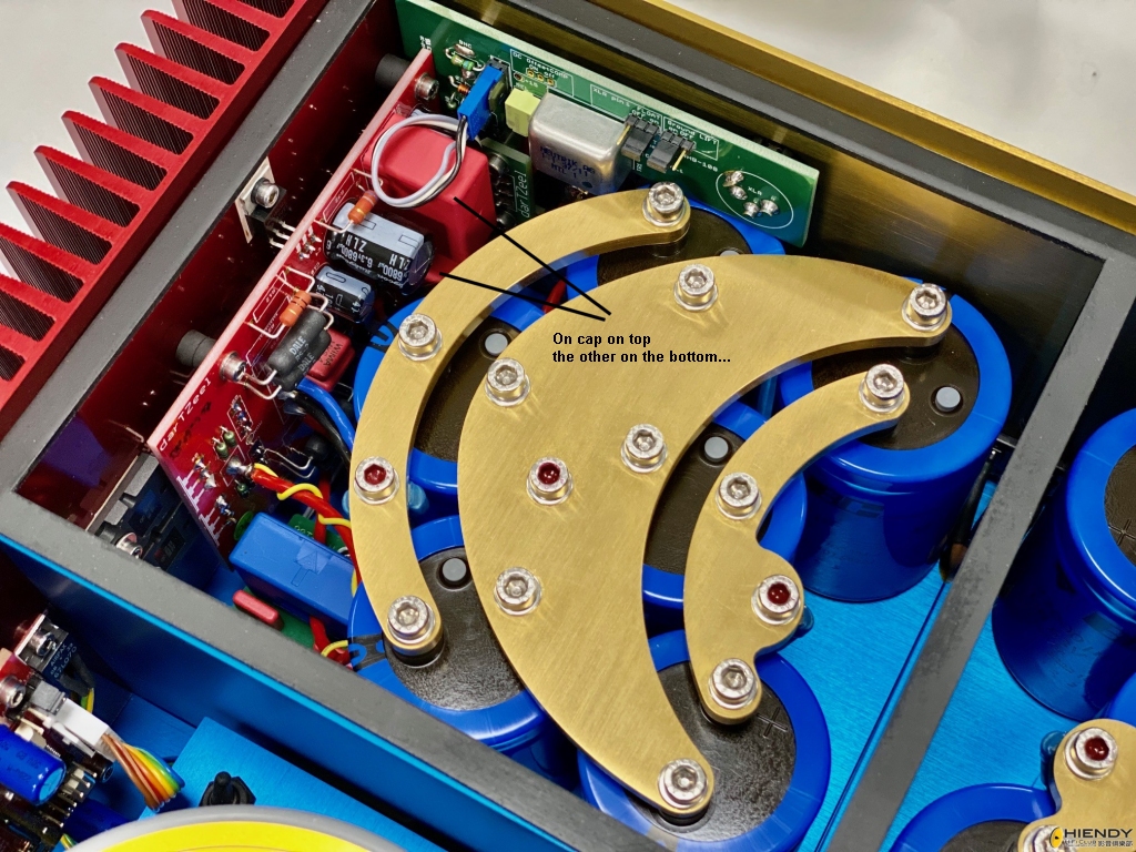

The Chinese two pair version is just the version 1 pcb with two pairs at the output (so not a ver2 circuit, but still ver1...). Look at the Ver2 pcb, you'll see there are a lot less transistors around the board than the ver1. Analog_sa came out with a ver2 possible schematic, based on what we could see on Dartzeel computer screen capture from their factory tour video, and what we can see of the Ver2 pcb. So our ver2 pcb is still just a guess, and a prototype to try out. The Spice simulation looks fine though. I already shipped a few ver2 pcb, and Analog_sa made his ownpcb based partially on my own layout. We will have to wait for the Ver2 builders to report of this new approach...
Ok, I see, from the short Matej Isak factory tour. Let's hope that screendump is not just Obfuscation by Mr Deletraz 🙂

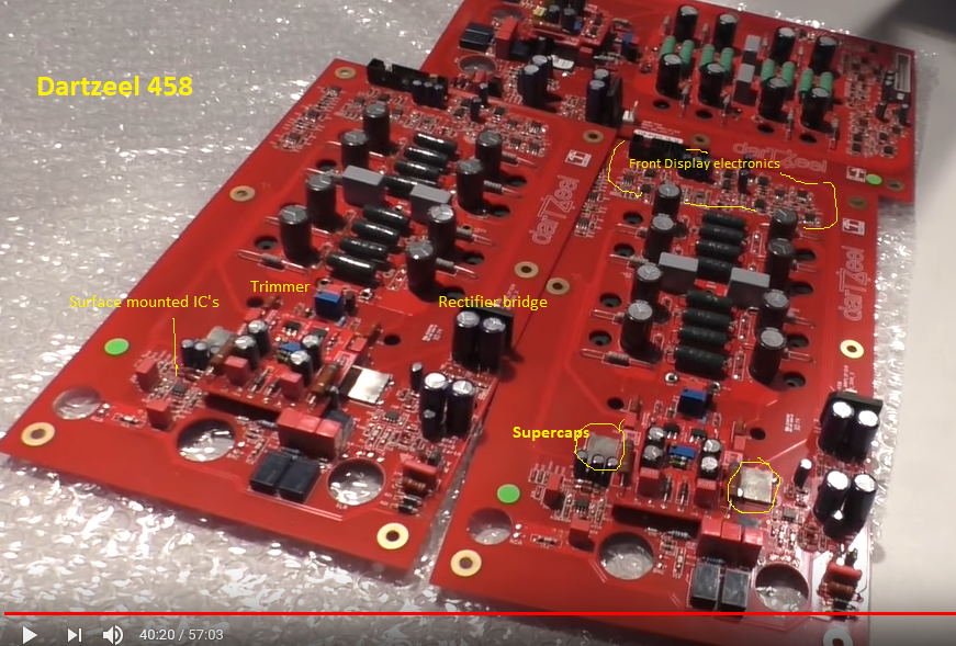

Approx 40 minutes into Michael Fremers factory tour they are showing retired 458 motherboards that are replaced by 468 MBs.
YouTube
Mr Dartzeel says they added more output Power Transistors to the 468, removed/moved the Display electronics function from the MB onto a separate board behind the front display.
On this screendump from the tour I marked some components.
It seems like the 458/468 is a total departure from the design ideas of the NHB-108.
IC input stage, two supercaps, tons of output power transistors, 6 large (Panasonic) electrolytic capacitors mounted on a separate board on top of the MB (no crowbar) 6 large resitors to slow down? the current rush when 6X22.000uF capacitors charge.
Dental! silver wire as conductor to input stage 🙂

Mr Deletraz also mentions they replaced the input balance transformers (of CTH 8550) with ICs.
Maybe input balance IC are at the bottom of the NHB-458 boards? SSM2141?
What do you think those ICs are?
There is a significant number of 8-pin chips on top, no need to search at the bottom. The SSM2141 is not really suitable as it has differential outputs - unneeded in this application. Any number of ICs can be used here, from INA types to simple opamps. Perhaps not an ideal solution but neither were the cheap transformers in the 108. I guess all the Dartzeels sound better through the single ended inputs.
