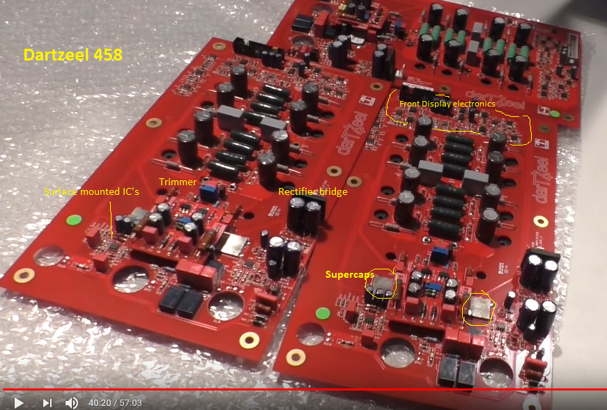

There is a significant number of 8-pin chips on top, no need to search at the bottom. )
Mr Deletraz mentions in the tour that the chips at the top of the 458 were part of the front display function and that they have been moved to a separate card at the back of the Front Display to make room for more power transistors on the 468 MB and for serviceability reasons! That part of the card probably got very warm..
That is the reason I mentioned only the ICs at the bottom/input side of the MB.
There is also that little daughter board in the 458 on top of the supercaps for which i have no explanation. It looks like it could be a regulator for the input, only there are no sensible PS connections.

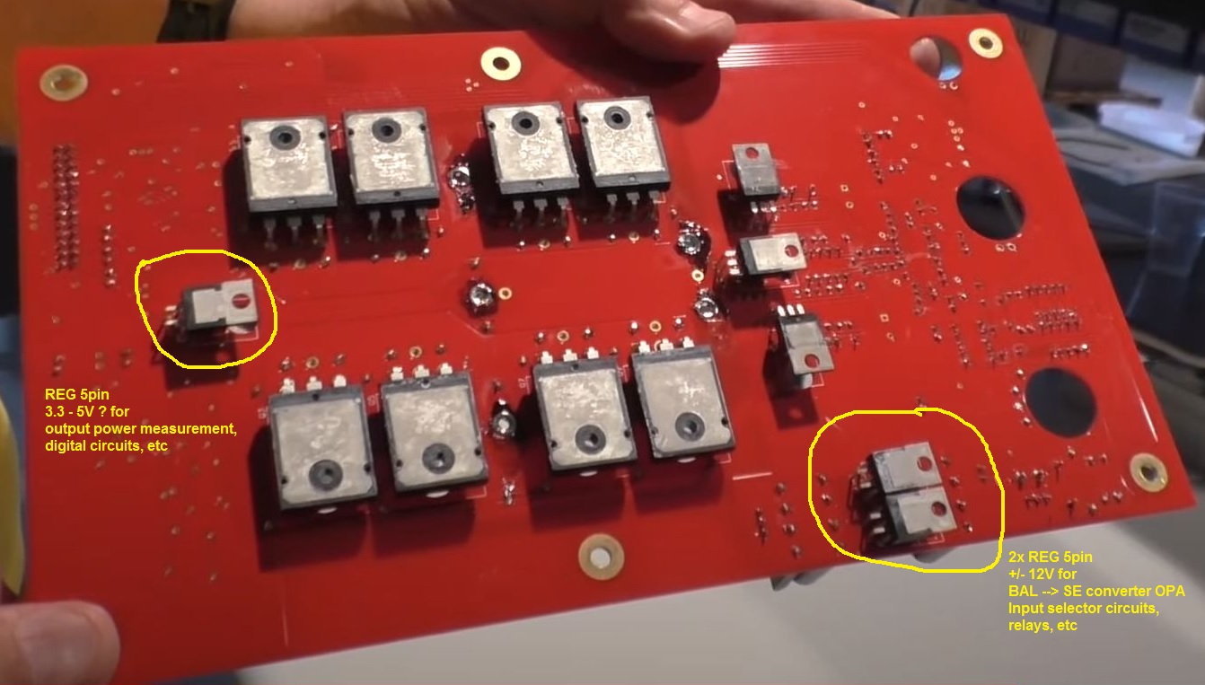

At some point in the video Hervé shows the bottom part of the "old" board and the number of power transistors (TO220 and TO-3P) do not match the "Hungarian schematic".
There are two ТО220 parts close to each other and far from the rest, which could be the power supply regulators for the protection circuit, but what about the rest?
PS: The daughter board is also a big mystery. Could it be the voltage amplification part? But why put it on a separate board, hmm?

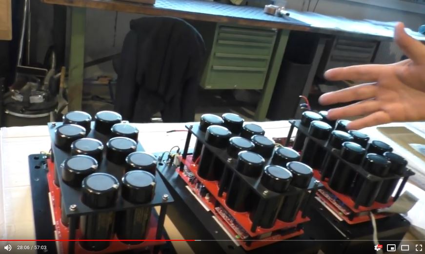

Tons of electrolytic capacitors in 468

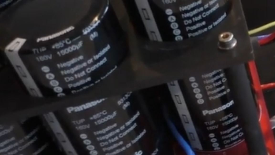

Correction: The 468 has 10 Panasonic 15.000uF 100V 85C electrolytic capacitors, mainly because the Chinese market demands tons of them, according to Mr Deletraz 🙂
And they are mounted on a circuit board placed over the MB, close to the power transistors. No more gilded metal crowbar.

Maybe...
5pin voltage regulators:
5pin capacitors in power supply ( 10pcs ):
Panasonic T-UP Series 15.000uF 160V - ECEP2CP153GA
in older models:
CDM Cornell Dubilier 382LX Series 15.000uF 160V - 382LX153M160B102V
Ok, 160V.
Which means the DC operating voltage over the power transistors is well over +- 100/120V?
The rectifier bridge on top of the lower part of the board + the regulator underneath the board is for a second, lower supply voltage for the input IC's because the very high DC voltage over the output transisitors cannot be regulated down to 5V?
And six large wirewound high power resistors mounted on the separate board along with a heavy duty rectifier (same type as in NHB-108) bridge slow down the current scrambling into those 10X15.000uF electrolytic capacitors when powering up?

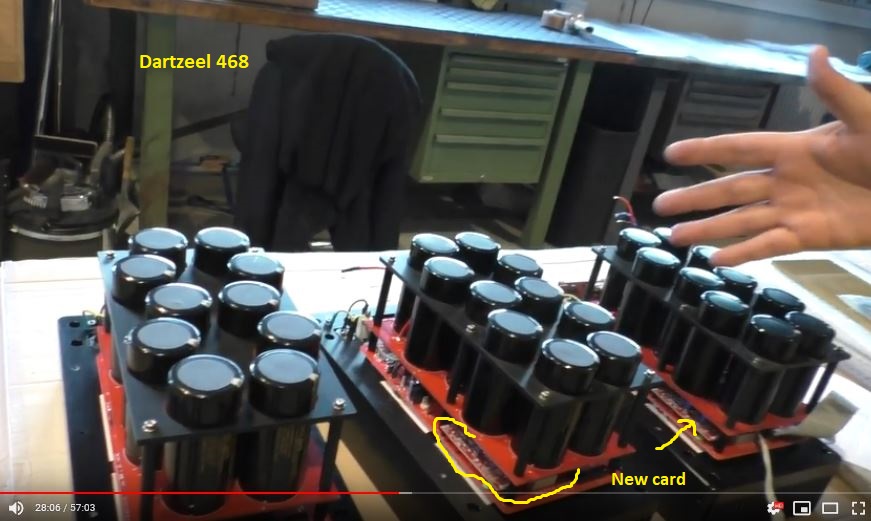

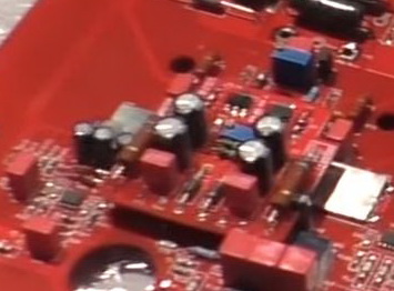

New daughter card
I just noticed a new daughter card inserted between the MB and the capacitor board.
Maybe Mr Deltraz meant this is where they put the 468 electronics for supplying info to the Front Display panel/moved it from the top of the 458 MB?
After Peter drew my attention to the pin numbers of TO220 devices I took another look at the video.
My guess is the two 5-pin devices next to each other are the PS regulators for the protection/monitoring circuit, while the separate one is the +5V regulator for the display logic.
