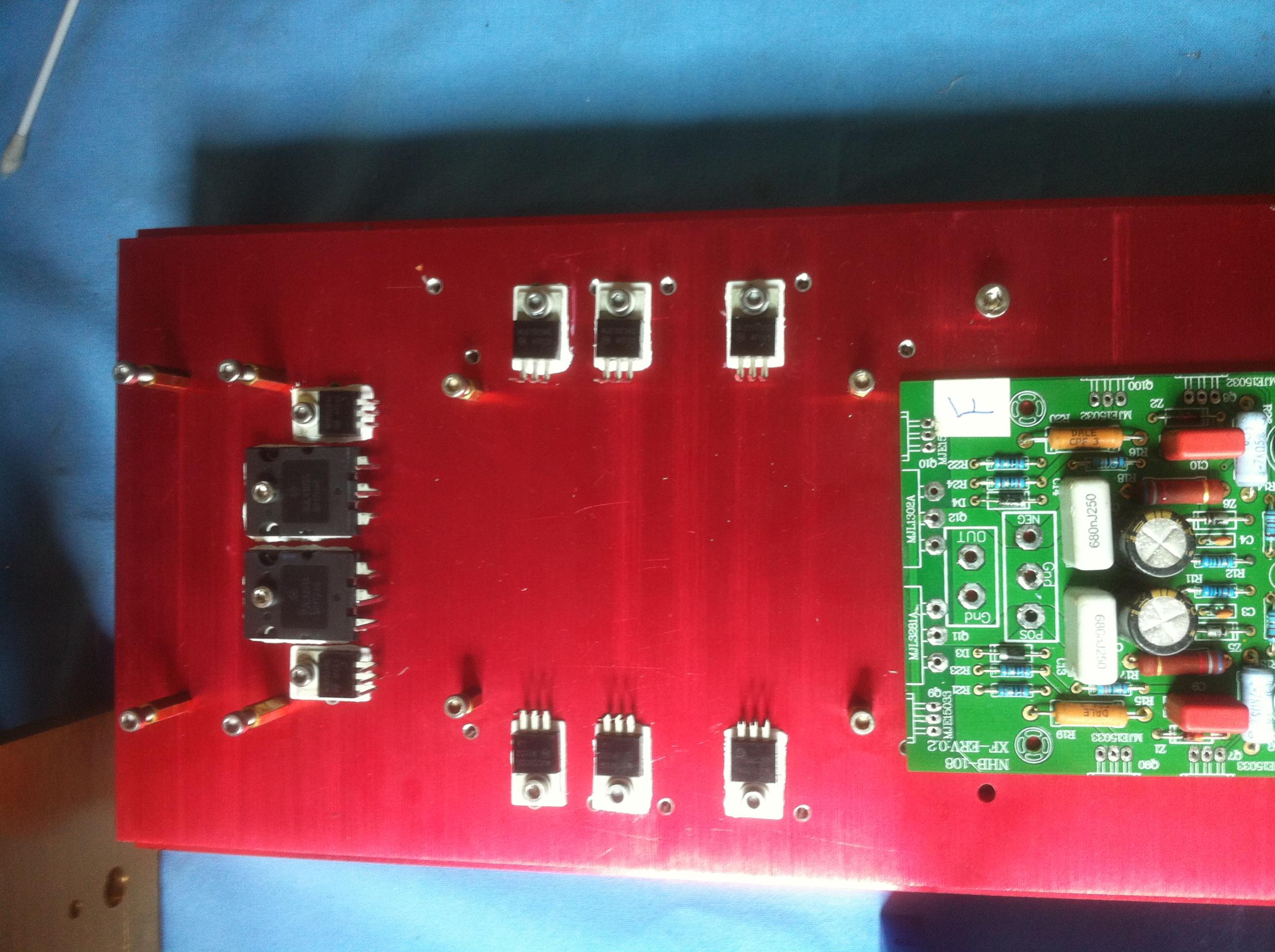

Tested my mods of Mark Johnson Soft start pcb to add the 'Overtemp' shutdown using a N.C. temp sensor, and it is working perfectly. Making progress on building a test prototype for the amp that will allow comparing both Ver1 and Ver2 pcb...

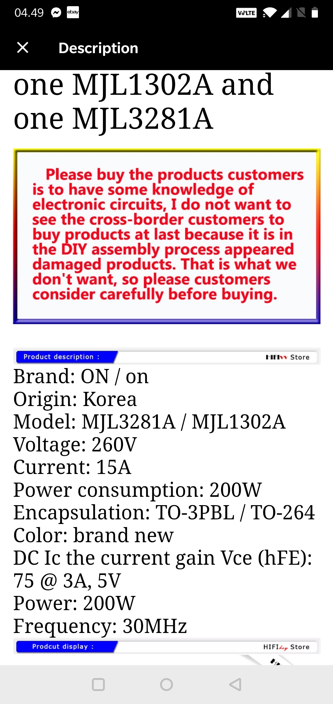

For your info I received directly from a contact in China, the set of matched semi they sale over there to build the DartZeel. Since I already curve traced and matched my own set from original parts bought from Newark/Mouser, I tested the semi I received. First good news, the parts I received seem to be original, laser engraved logo, exactly same body, legs, etc... The HFE are similar, and if you look only at the HFE value using a simple transistor tester they are indeed matched.
But they are not curve matched, as we can expect. Further more for my own set I matched the small signal transistors on the Curve tracer, then again using the same Ic value as in the circuit, I fine tuned the match using the 'Transistor Matcher' PCB, for value under 2mv.
So my kit will be pretty close for the small signal transistors, and even if these transistors have a small impact on the resulting THD% result, I hope that will improve the DC stability.
To resume the Chinese semi set I received is not complete garbage, seem to use original parts as well and can probably be used with resonable results. Not sure about the sound though, I'll use my own matched sets.

They are same marked HFE, but since HFE value changes with the actual current that the part is, it is really not that useful. The curves were not that matched. Don't forget either that NPN and PNP are not the same HFE in particular with power transistor. It is almost impossible to match NPN and PNP type, neither necessary in the output stage.. . They were genuine parts at least and will work in the circuit...
If you're building the ver2, then you need matched pair of the parallel output transistor... Don't know if these advertised pair were matched or not, since they were NPN and PNP, I would be surprised they are...
